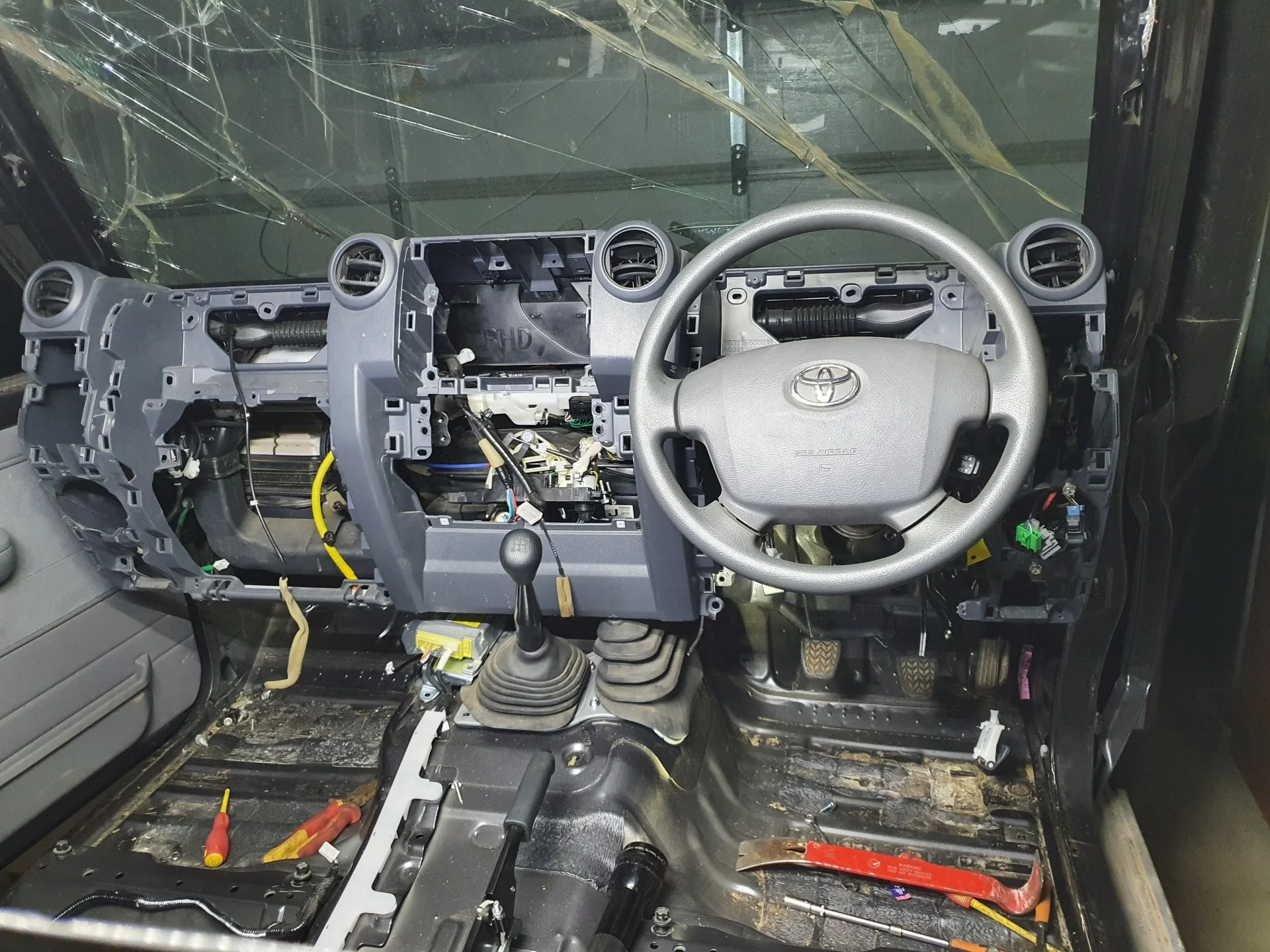

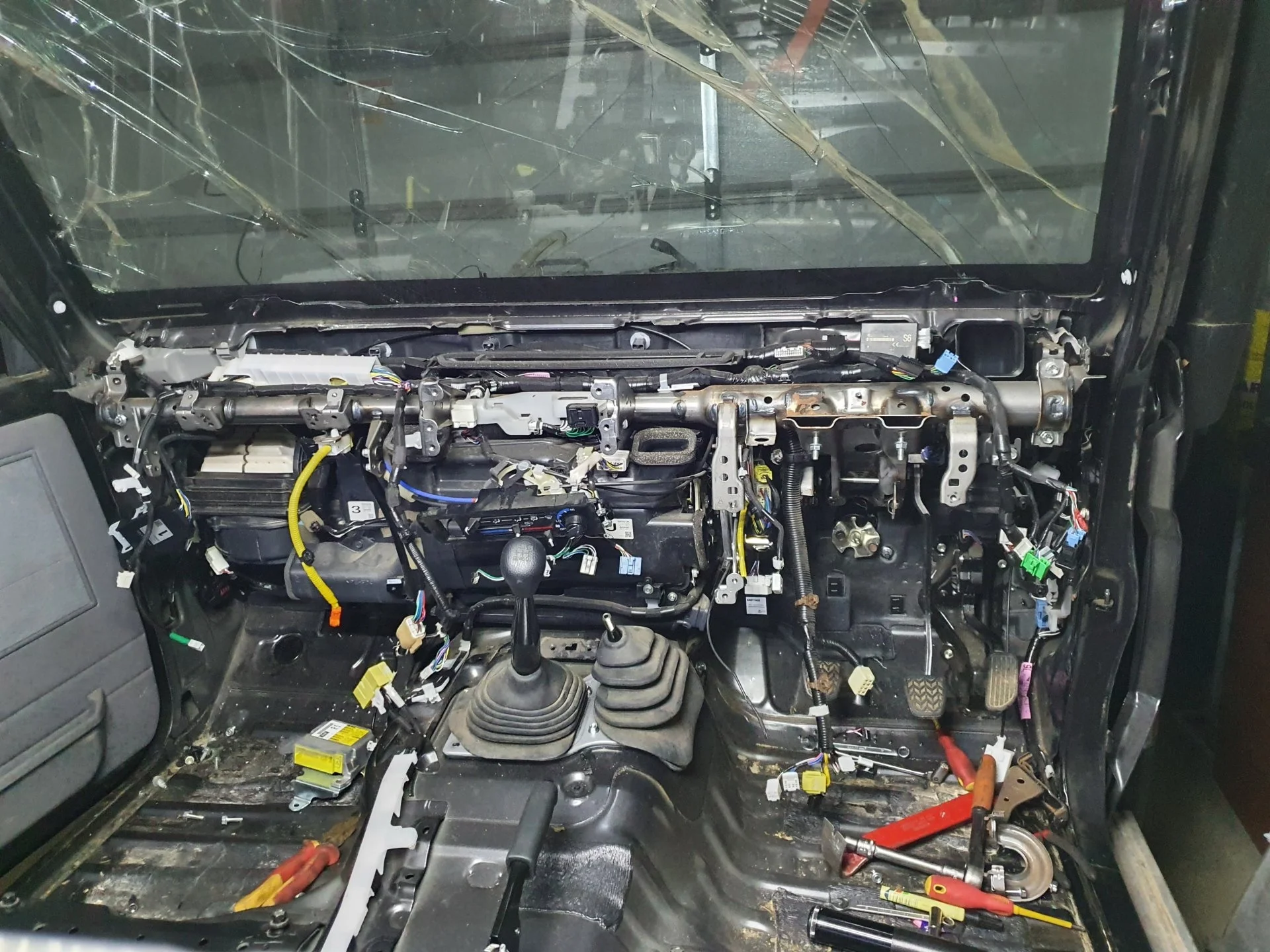

Pulled the cluster apart and cleaned all the contacts and electrical bits with contact cleaner gel and spray. My tachometer is now smooth and working.

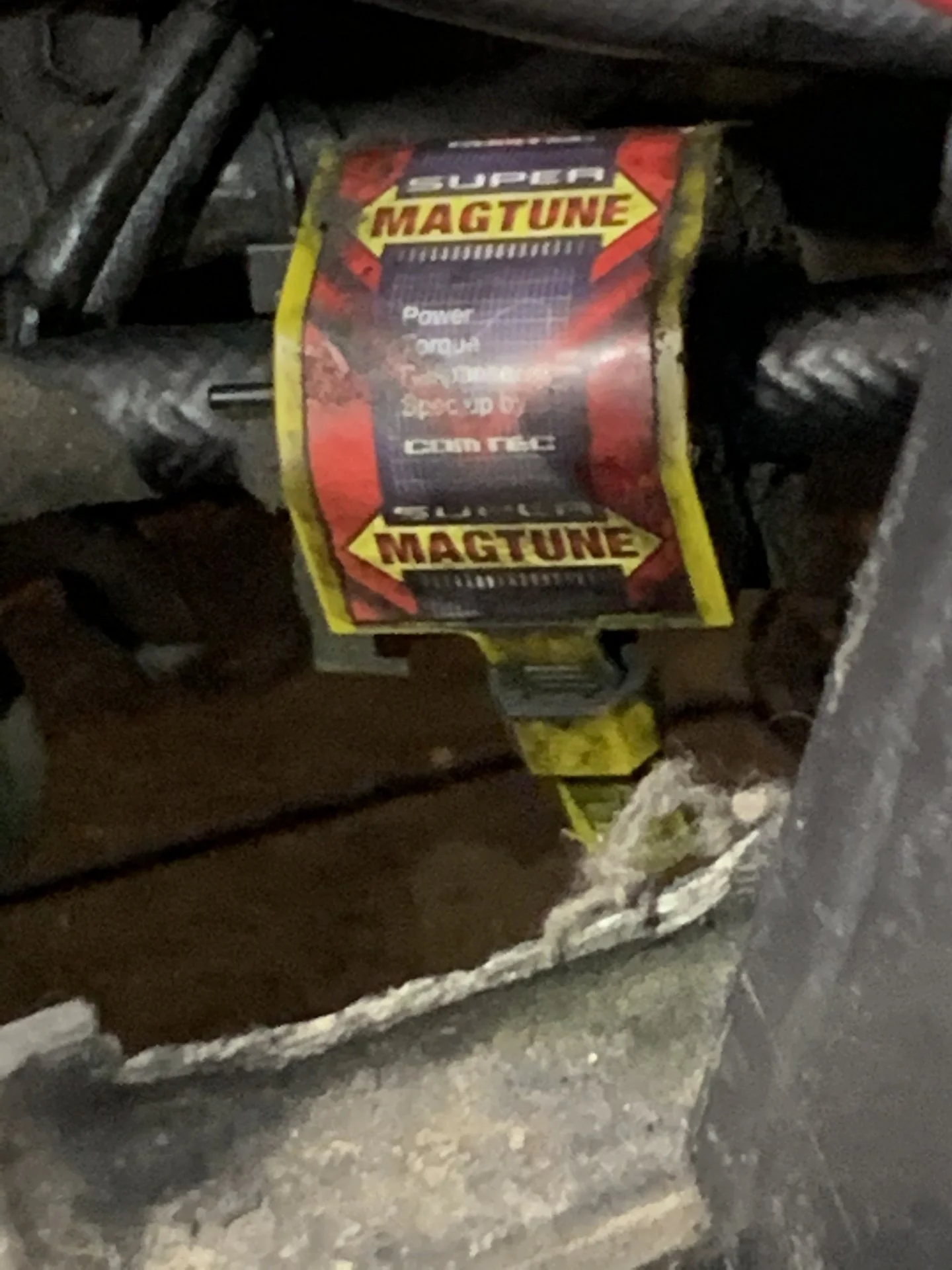

I also found this gem. Do I have a 400 HP 1HZ tune or is this some gimmick?

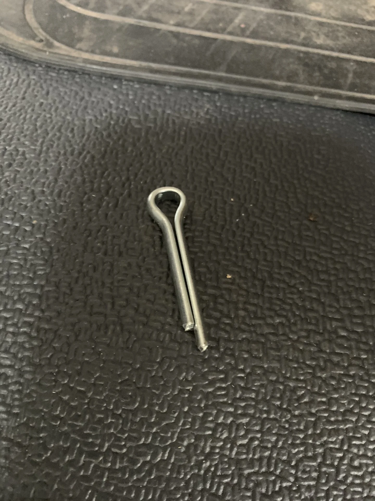

are your door limiters popping due to some worn out or missing pins... does the noise drive you to distraction?! find yourself some good old cooter pins in a 6mm diameter and slide those suckers in for a pop-free experience!
find them at the local hardware supply of your choice. i found these in a drawer of hardware at work...
