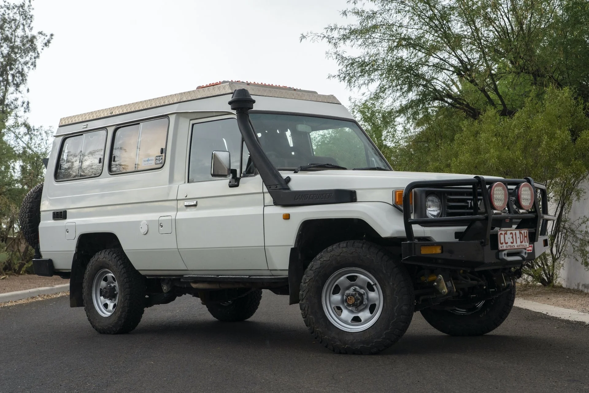

Thanks to the generosity of a friend who sold them to me for a pittance, I replaced the black wagon wheels we had on our Troopy through Australia and Africa with new factory wheels. Much better.

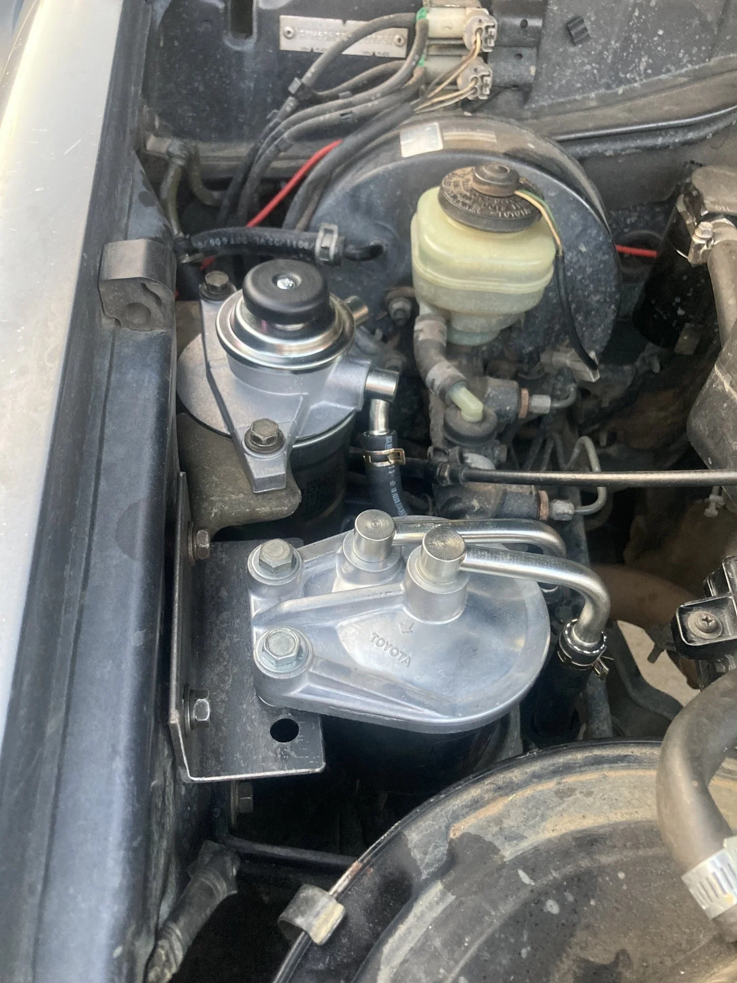

I was having some fuel delivery issues, I was directed toward replacing the filter top/primer since they reportedly leak and let air in. I also installed a factory prefilter on the ghetto homemade backet (PS was out of stock on the nice factory one)

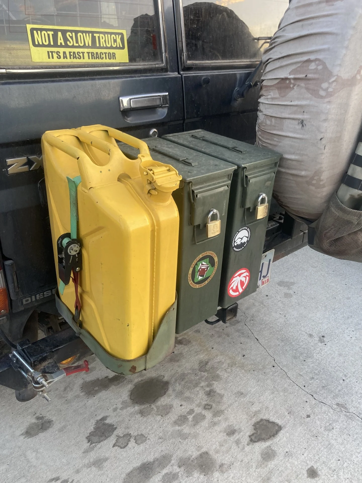

Also installed the "tall 50" ammo cans on my rear swingout to put recovery/winching stuff in

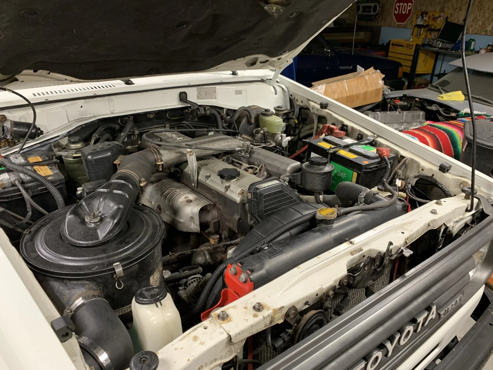

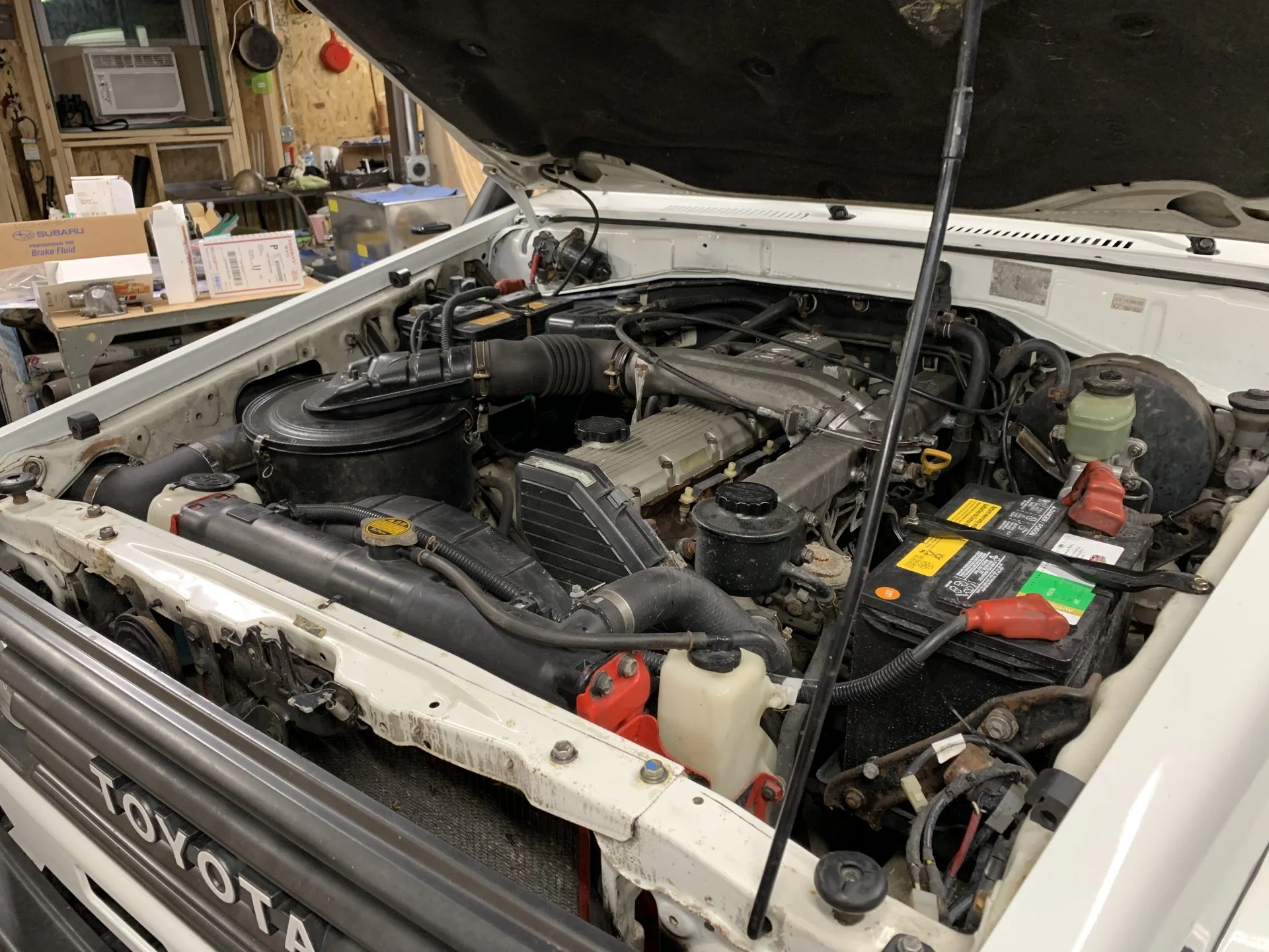

a little corrosion abatement in the engine room.
no photo's from before. just some fasteners cleaned up, throttle bellcrank, spring catches on the air box. worked some of the chalkiness off of the crossover tube and intake plenum.

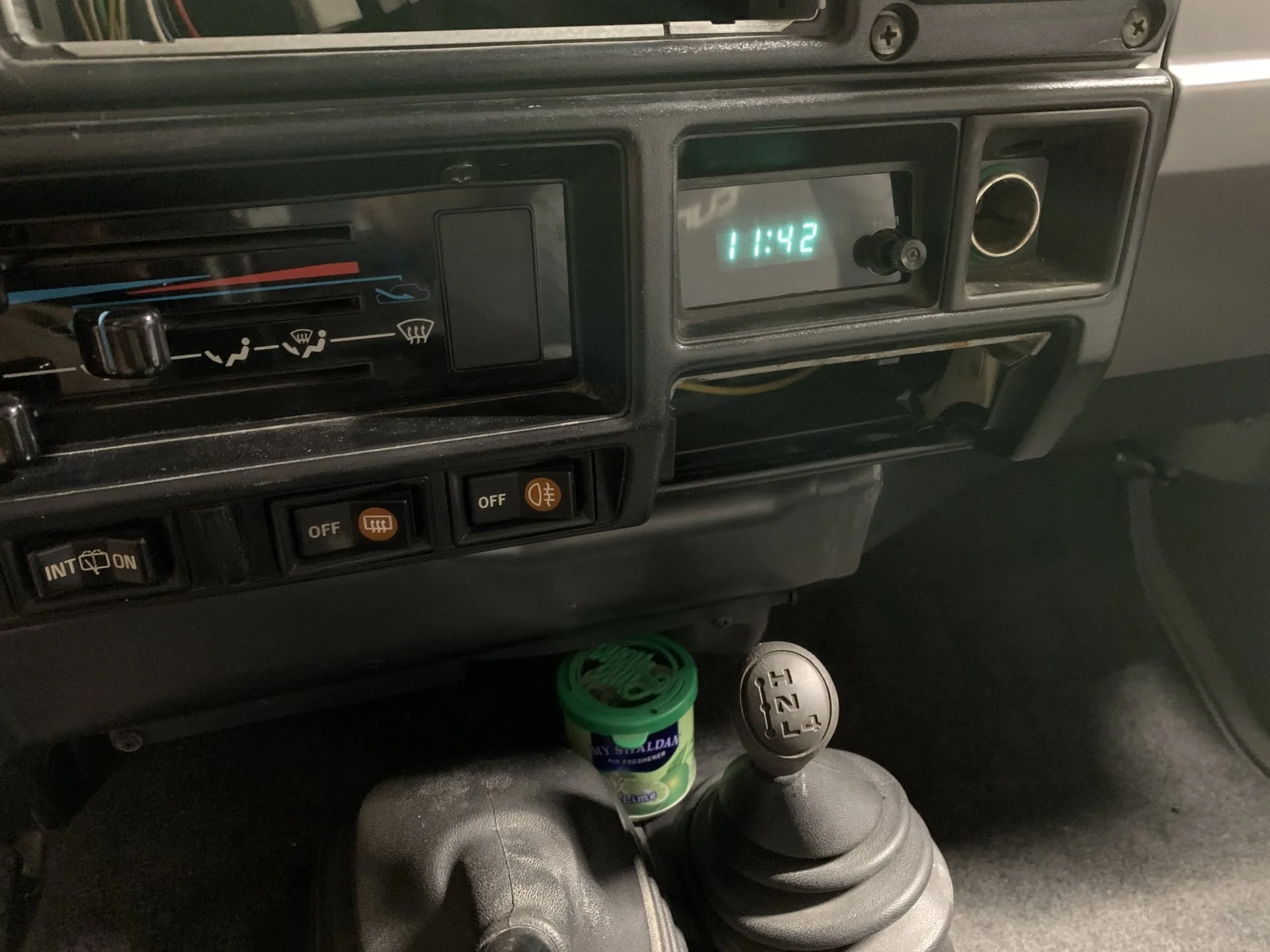

saving the wiring exploration for another night. might see if i can get the clock working yet tonight. firstly, checking fuses.

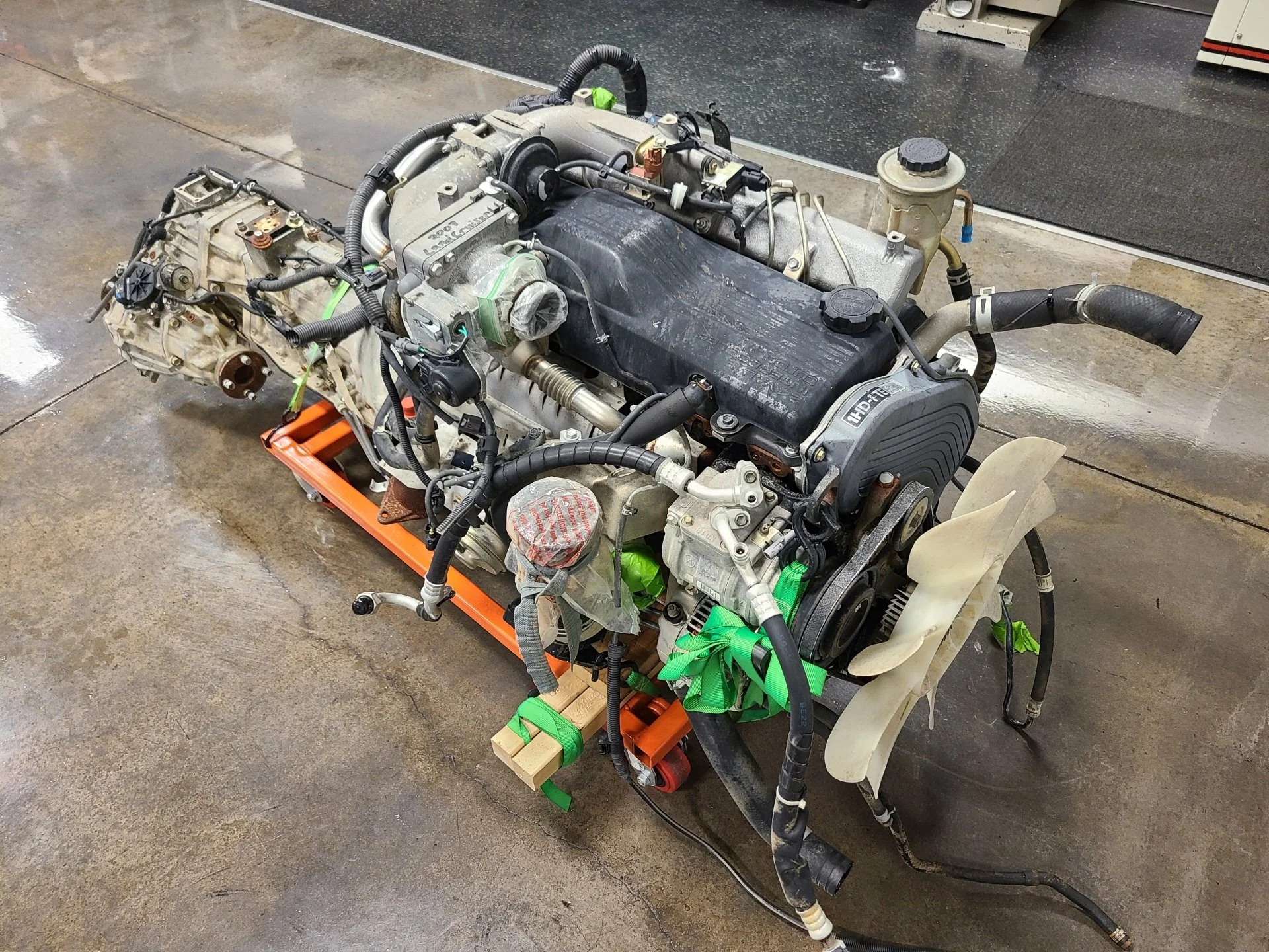

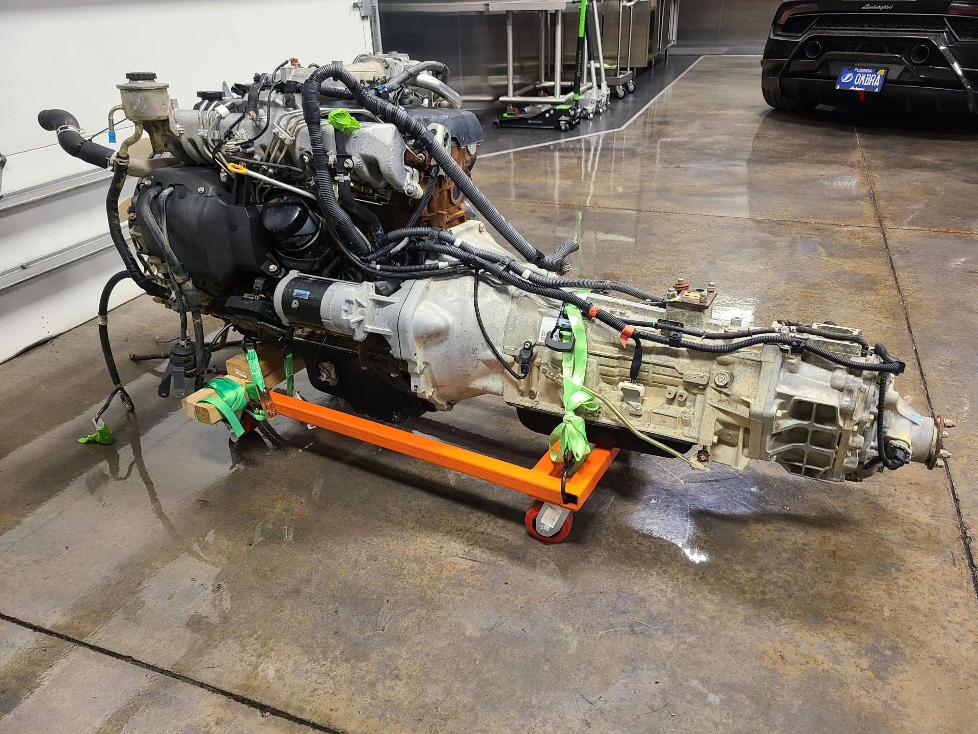

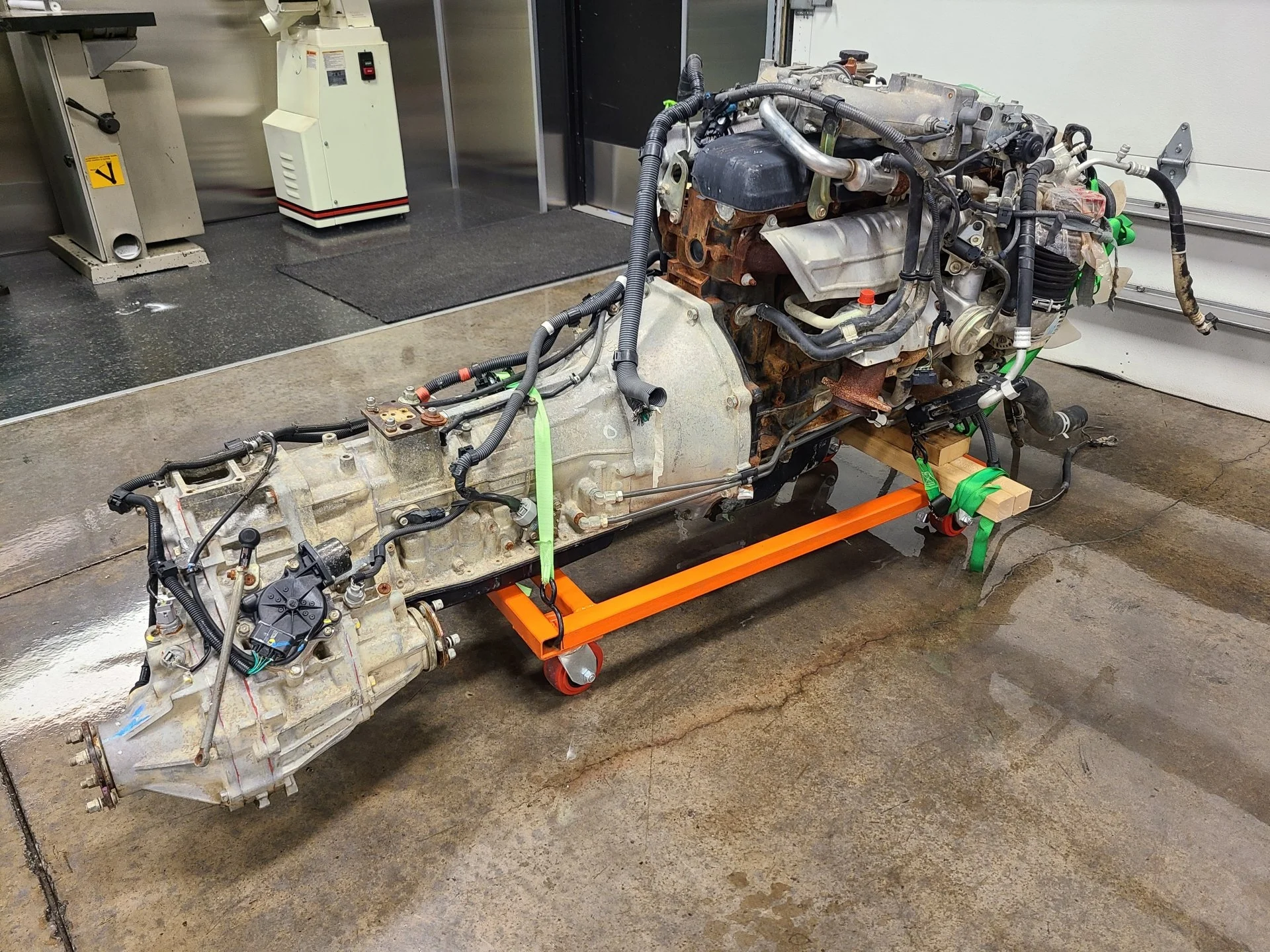

The FTE motor cleaned up really well. The block is really rusty....front cover faded....valve cover is chalky.....couple pieces on the trans rusted(some bolts, spacers). I'm guessing that this motor sat in the sun for a bit at some point....probably was never covered. Not a spec of grease or dirt anywhere on it(before we cleaned it obviously). Really curious about why so much rust on the block and so little paint. Weird.

Coastal where it came from?
I have not seen the best paint on blocks from Toyota, hit and miss and best.
Did you really mean to say that has 8000kms?

I picked it up near the water but not like the guy had waves crashing in his back yard....I think just being in the elements probably was the culprit of the paint loss....we have 3 motors in the shop now....they all have rusted blocks. Not quite like this one but not very nice. Oh well.....not a big deal.
Yeah, 8000 KMs. I told the guy that the miles were insanely low and if he had any idea why they were so low(he didn't)..... he then went on to say that he was a special forces guy who used diesel Cruisers where he was doing his special forces stuff.....and a lot of the trucks they used never made it to 3000KMs. Yikes. He said they would render quite a few vehicles when they were done with them, "completely useless to anyone".
Who knows what I got.....the special forces guy traded a car for it to a guy who owned a diesel shop....he was going to put a mechanical pump in it and use it in something. Wish I knew more to the story. My guess is it was a middle east take out that somehow got to the US....
