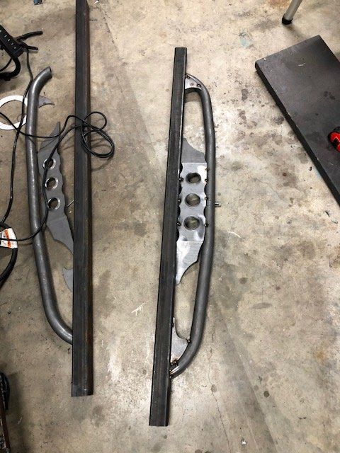

The BJ71 is in the shop to get some AC work done but after studying late tonight(grad school) I decided to tack one of the sliders together. Wheel to wheel is 50-51". When the BJ gets back, I'll start working on mocking them up and getting the supports built and welded up for install. Building these with 1.75 DOM and 11 gauge 2x2. Front to rear of the DOM is 45". I left a little extra 2x2 on each end for when I get the LC back. Probably overkill for the little LC but oh well.

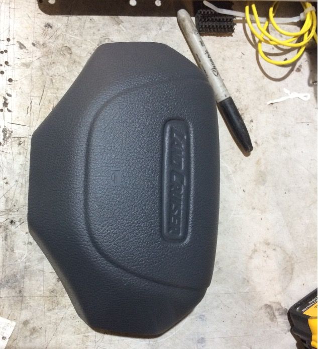

Some more goodies in the mail. :)
