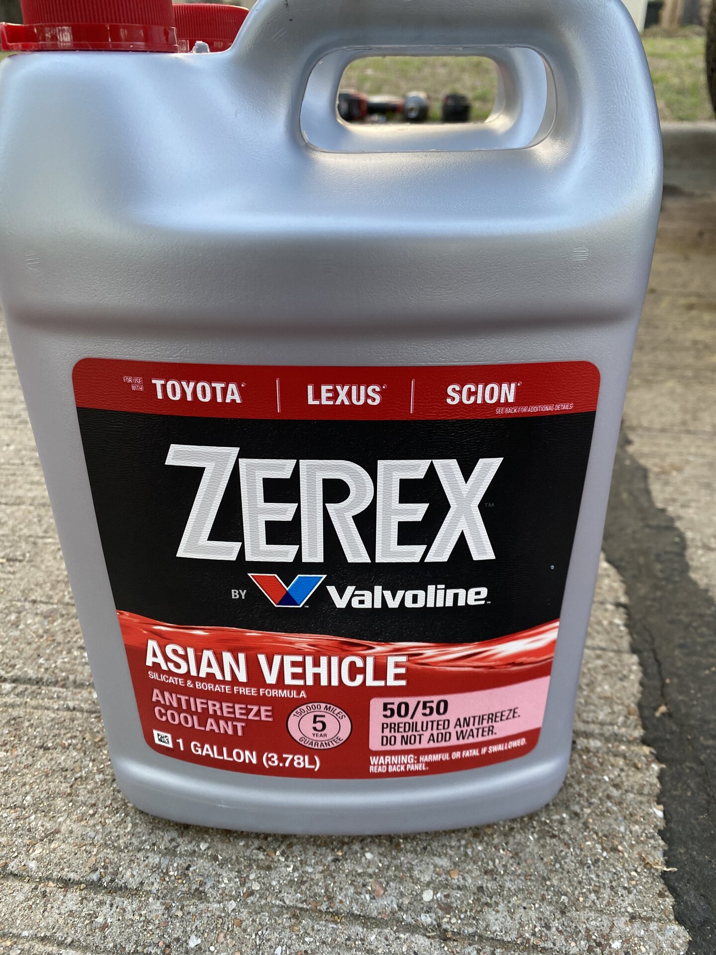

So I’ve read through multiple threads and haven’t seen a solid answer for my coolant question…My question is, I replaced the PHH on my 96 today and in preparation I pulled the lower rad hose to drain. What came out looked pink or light red. I was planning to flush with distilled (if necessary) and replace with this. Will this be OK? TIA
yes
