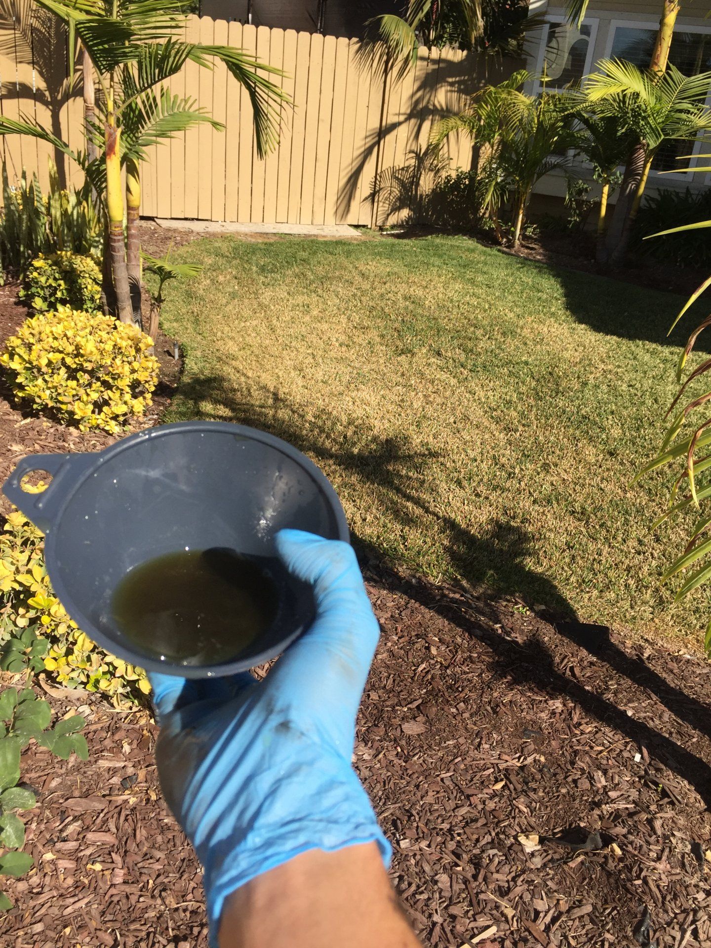

Its that time of this trucks cycle where I’m draining and filling the coolant back up. But after buying Prestone and Toyota and upon reading older threads I don’t know which I should use. So I’m seeking more modern/relevant input on what do you guys use. I know I’m not the only one that contemplates this. I’m hoping this thread becomes helpful for those who are unsure.What’s your 0.02 and why do you use the coolant you use?

Lol....Green but you should flush it a couple times first. That fluid looks like it’s got a lot of extra stuff in it.
Alright cool so the prestone should be fine? I checked the ingredients. Doesn’t have what other threads have warned against. Just not sure if anyone else has ran this specific antifreeze. Yeah I’m on flush #3 with same coloring lol
