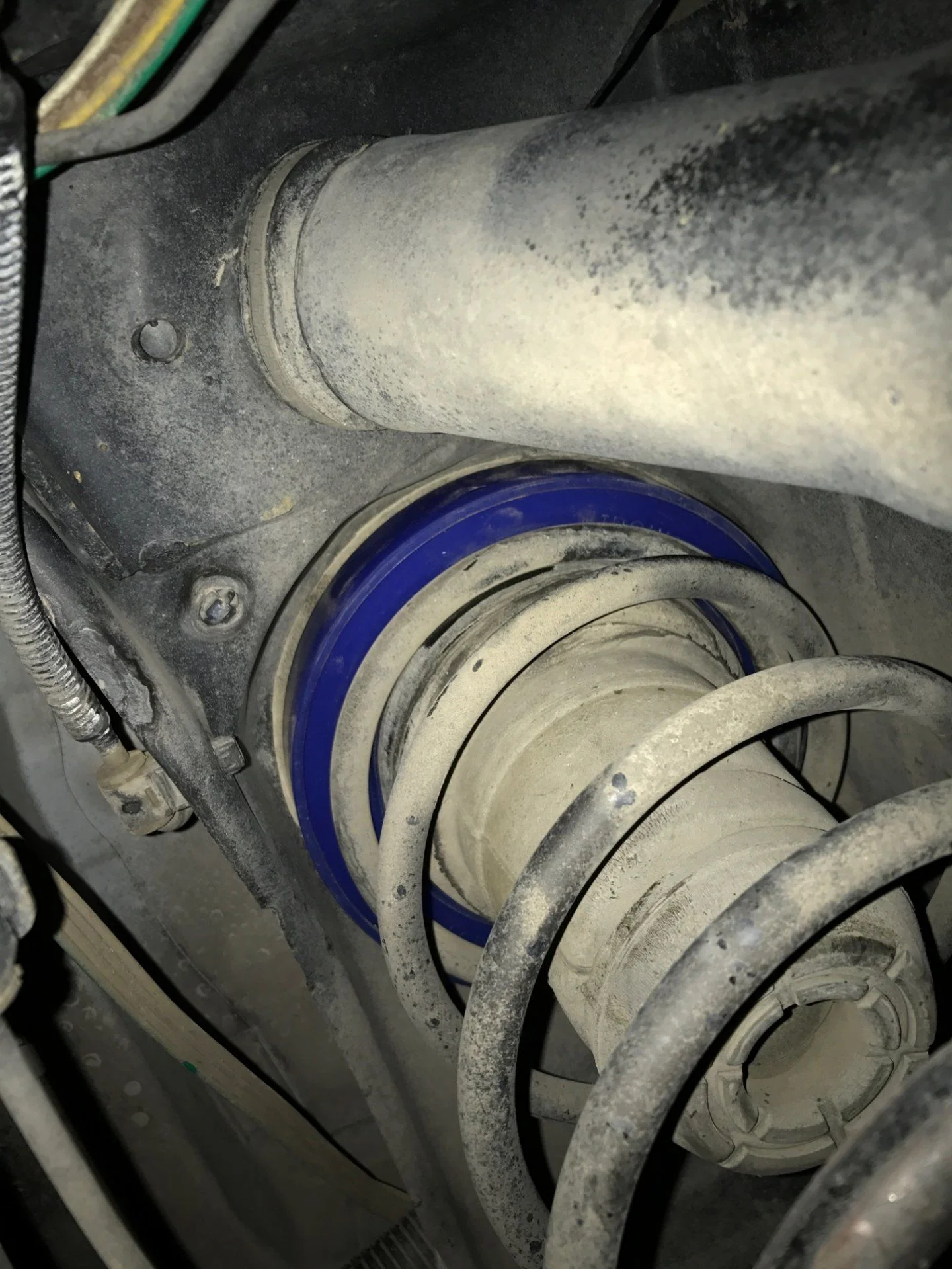

I also threw some 30mm spacers in, and that got the rear pressures down - w/in spec!

I finally figured out how to properly set height with the height sensors and measure vehicle height. After getting height correct and tweaking TBs a little more, I got my front pressures nailed, but the rears are high. At this point I felt I had been playing with the AHC too much - I saw the oil temp climbing up, perhaps causing increased pressure? Now I feel I have done all the adjusting I could, next steps include ordering a set of King springs and throwing those in w/o the spacers.
4-23-2017-4-44-21-pm-jpg.1446992
Spacers:

In July I threw some King springs in the rear before we went to the Black Hills Cruiser Classic:
img_1699-jpg.1496838
A bit thicker than the factory LX springs, but softer than 100 springs.
Having a forklift made for a quick install:
img_1700-jpg.1496837
More details here: King Springs AHC KTRS-79

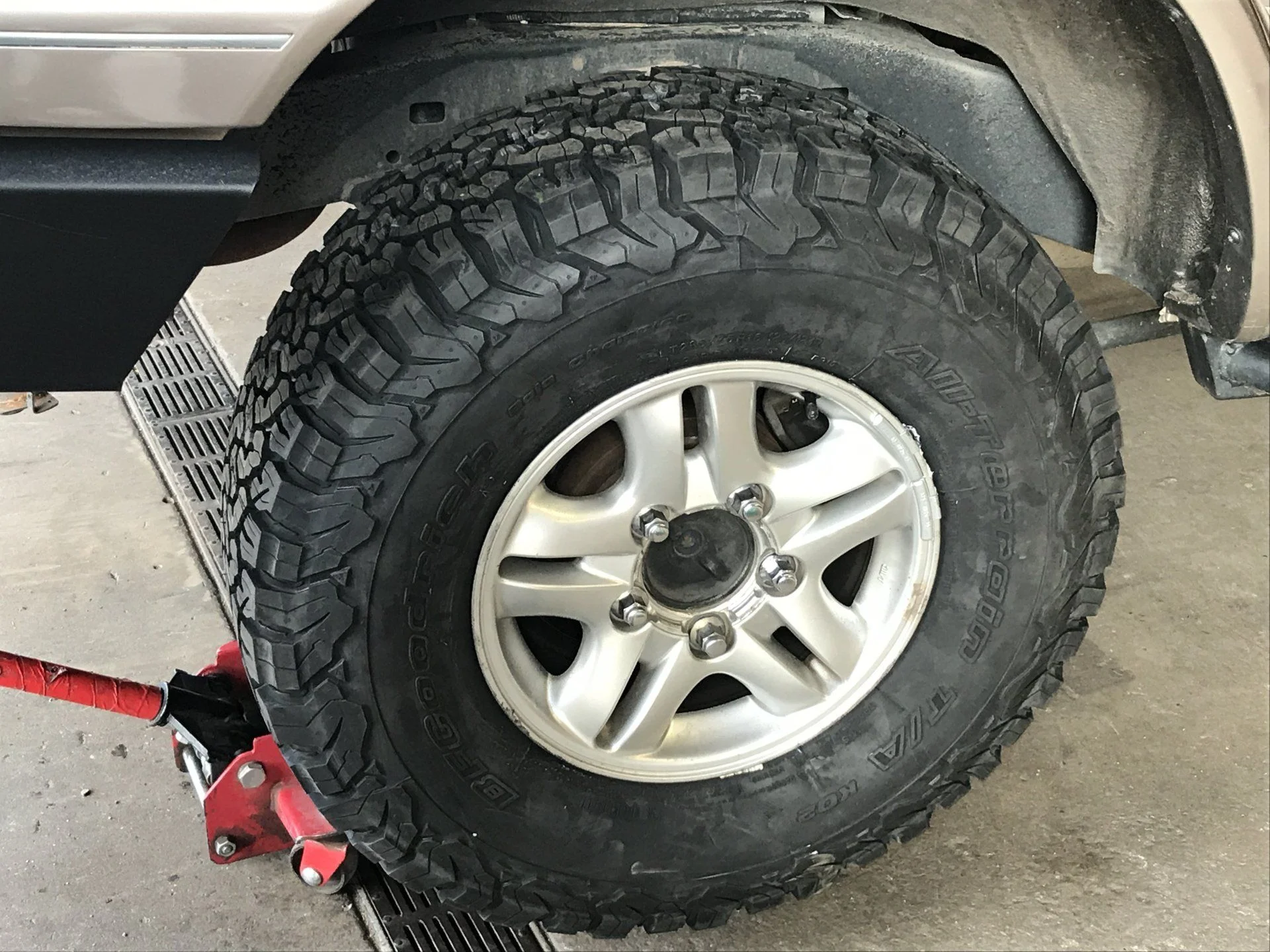

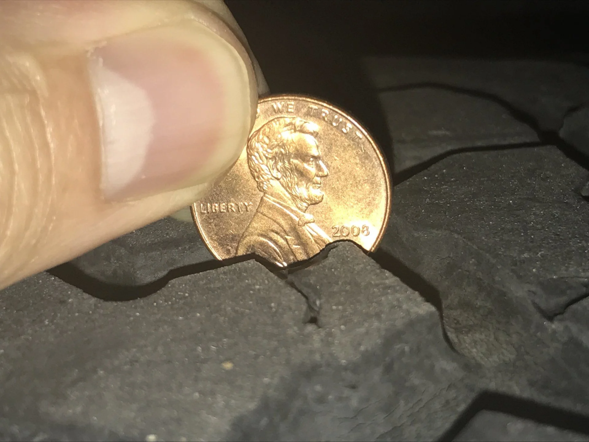

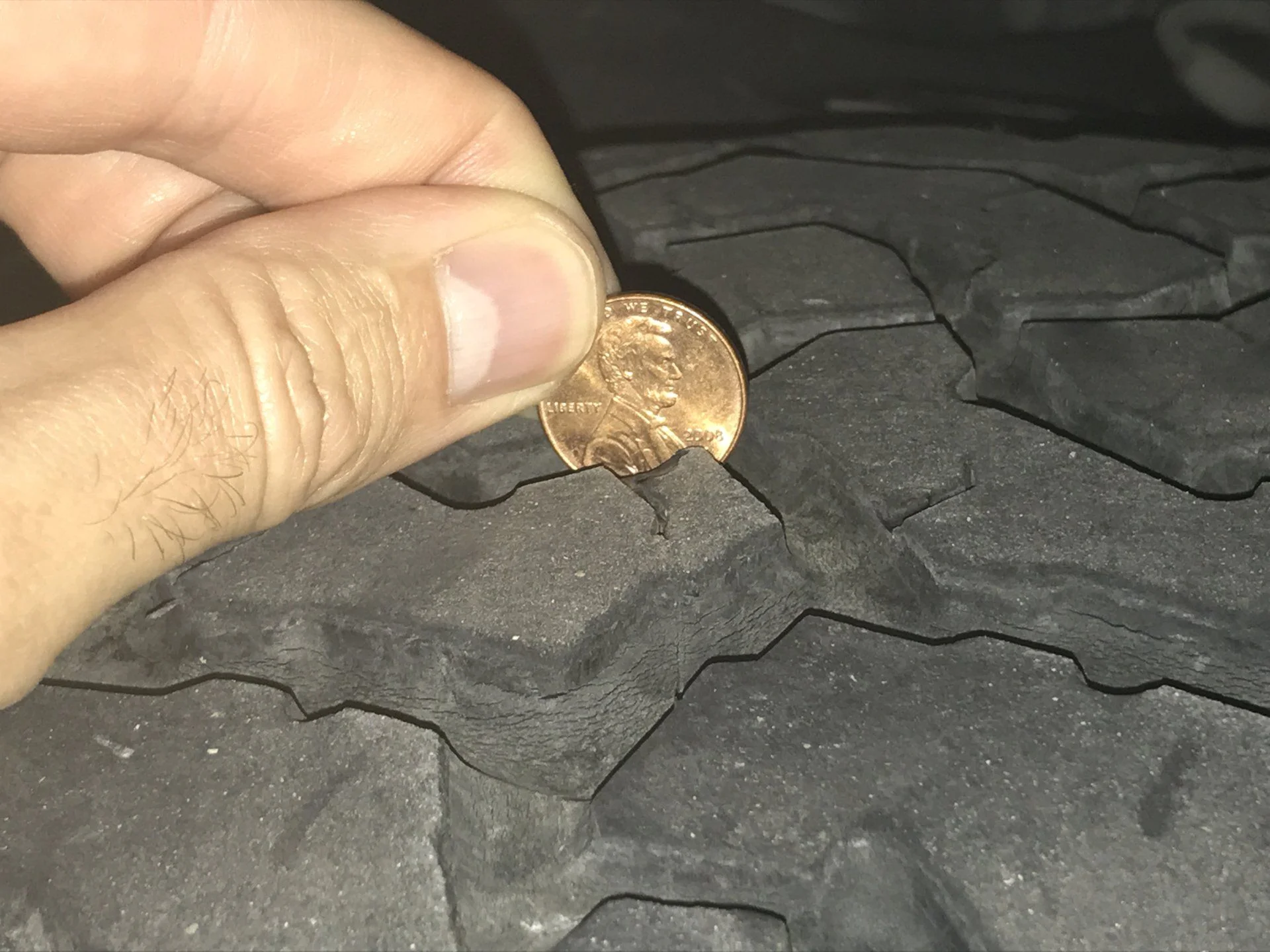

After all that time spent on the rack and rotating tires, I didn't feel good about going into winter on the existing BFG AT KOs.
Abe was showing a lot of shoulder. As best as I could measure, I was at 3/16's of an inch. There was also some dry rot or cracking in the tread.
I heard nothing but good things about the KO2s, so off to the tire store for some new shoes. 285/75 R16 seem like a good size for stock LX w/ AHC. A little under 33", no rubbing, not too wide, not too skinny.
She feels good with King springs in the rear, new rack & TREs up front, and new rubber. We will check alignment one more time as the wheel is a little off center now. Regardless, she feels like a good machine again! I have to figure out how to get TechStream working so I can look at the suspension pressures...

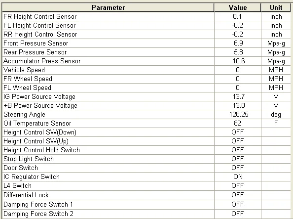

Back to this question...
First of all, I tried to aggregate all the AHC wisdom that @PADDO has kindly shared with us: Definitive list of AHC maintenance items
Next, I had get TechStream working again on my computer after my wife's little Chihuahua peed on my old laptop and killed it. Anyone in need of TechStream - I highly recommend this approach - huge thanks to @getco - How-To: TechStream In 5 Minutes
Now, on to the readings:
