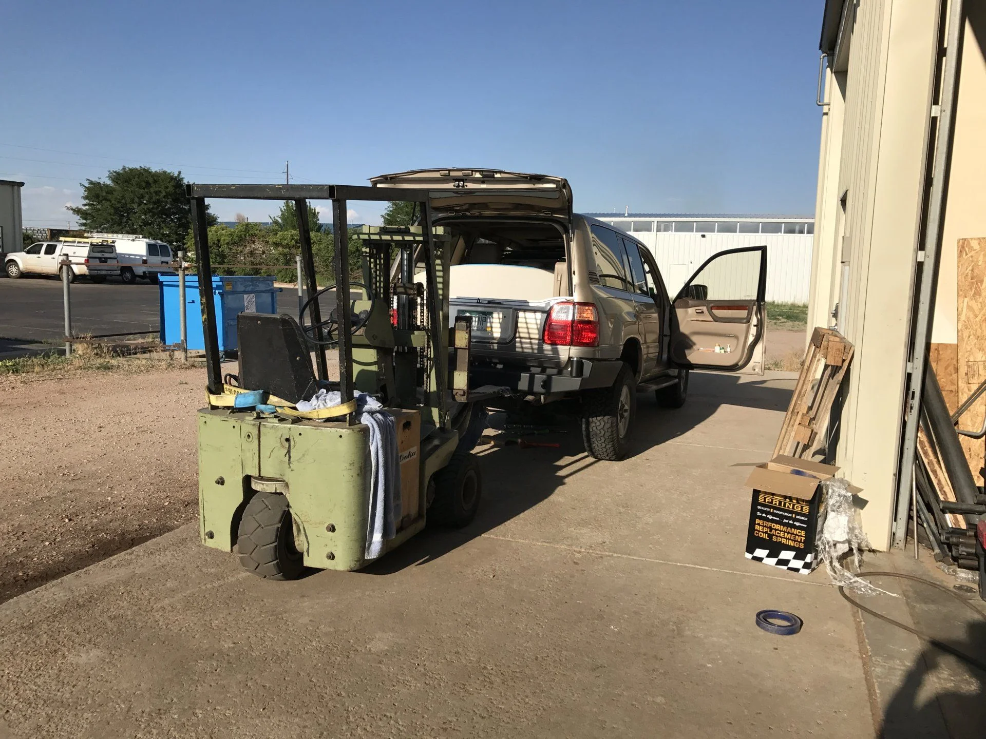

I think the easiest way is with a fork!
Definitely much quicker than 2 hours...

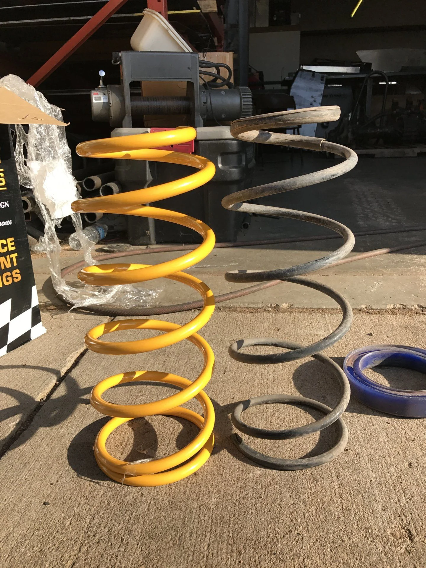

Thanks a lot @PabloCruise ! Just the info I was looking for. Seems to be about 1" of difference in the free height if you guesstimate the loss in the OE spring's free height due to age?
Could be, I am not sure. In the pics, the Kings look shorter, but the back of the LX definitely looks a little taller.
