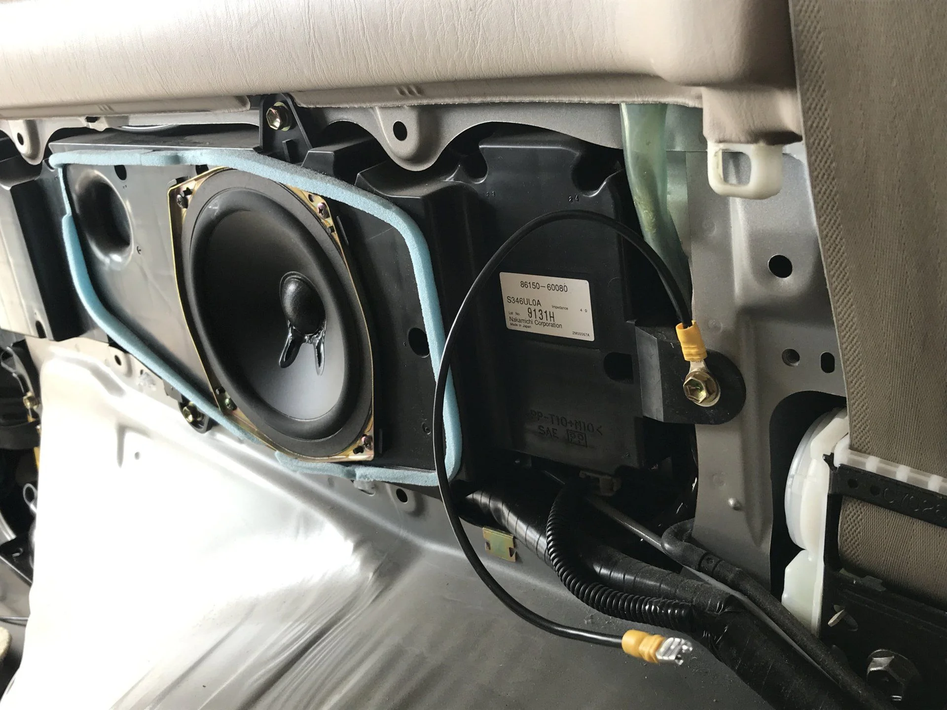

Nice to be able to read voltage at the end of the run! This will be helpful when the fridge is plugged in.
A bit more serious than the factory wiring to the cargo area power outlet:
