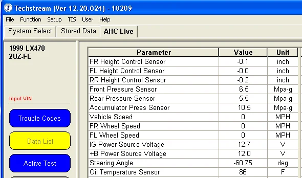

First, I took a look at suspension pressures. 7.6 F/6.4 R.
So I did the AHC Fluid Change: AHC Fluid Change How To -- Need Input
While I was under the truck, I gave each torsion bar 2 full CW turns, and then checked pressures again - now reading 6.5 F/5.5 R. I did not have the rear loaded with fridge and gear, etc.
Graduation test was 11-12 lines on the reservoir, so I am happy!

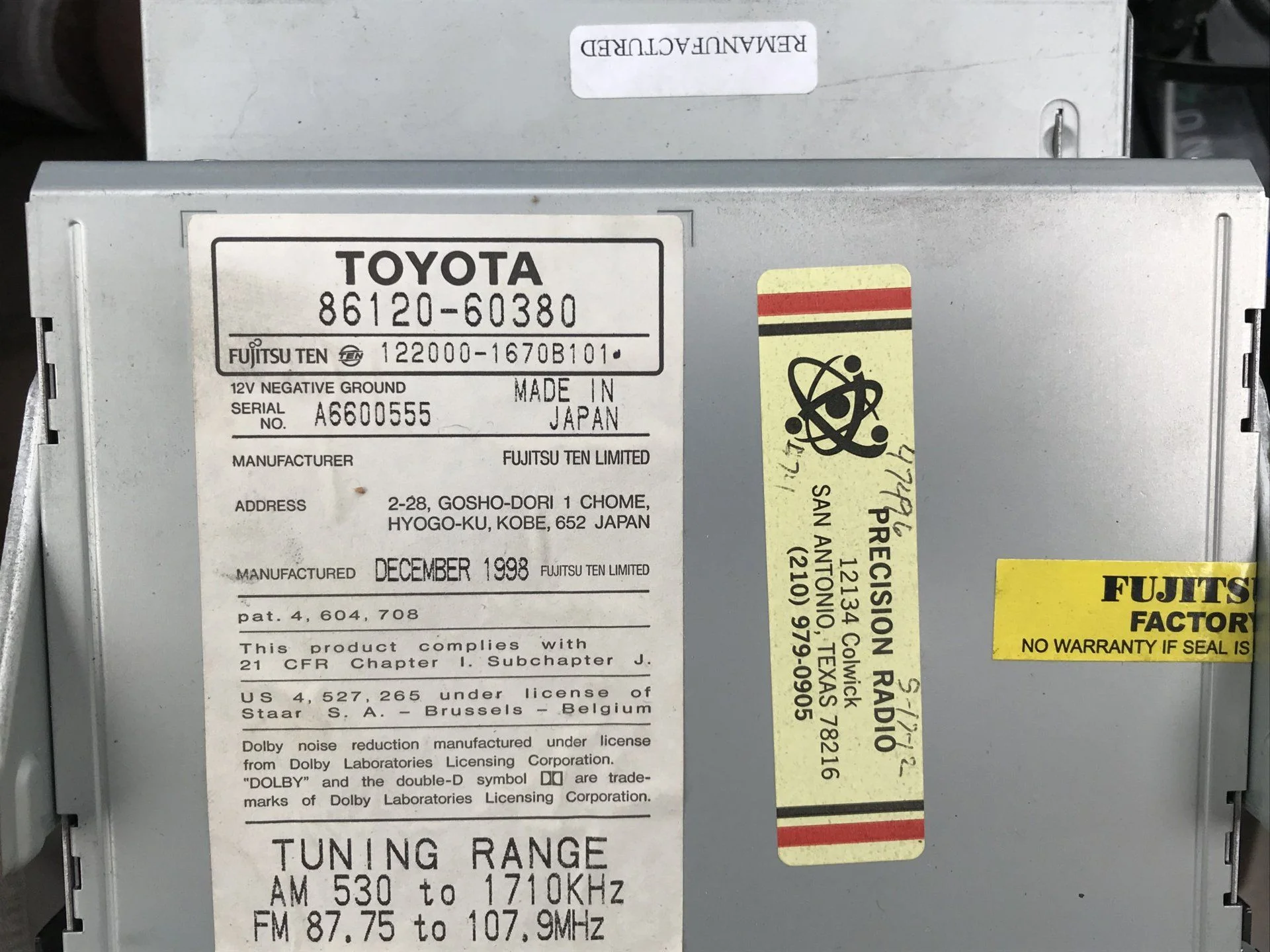

Next, getting ready to replace the Nakamichi with a Pioneer head unit. The Nakamichi was pimp w/ built-in 6 CD changer and tape deck, but any bump in the road disrupted CD palyback - it is time.
I took a look inside the dash and found the Nakamichi had already been refurbished once before! Back in 2012...
in this thread I am working on finding a factory connector to upgrade, so I do not have to cut the connector off the LX body harness: How To Find A Companion Connector - Electrical/Stereo/Nakamichi

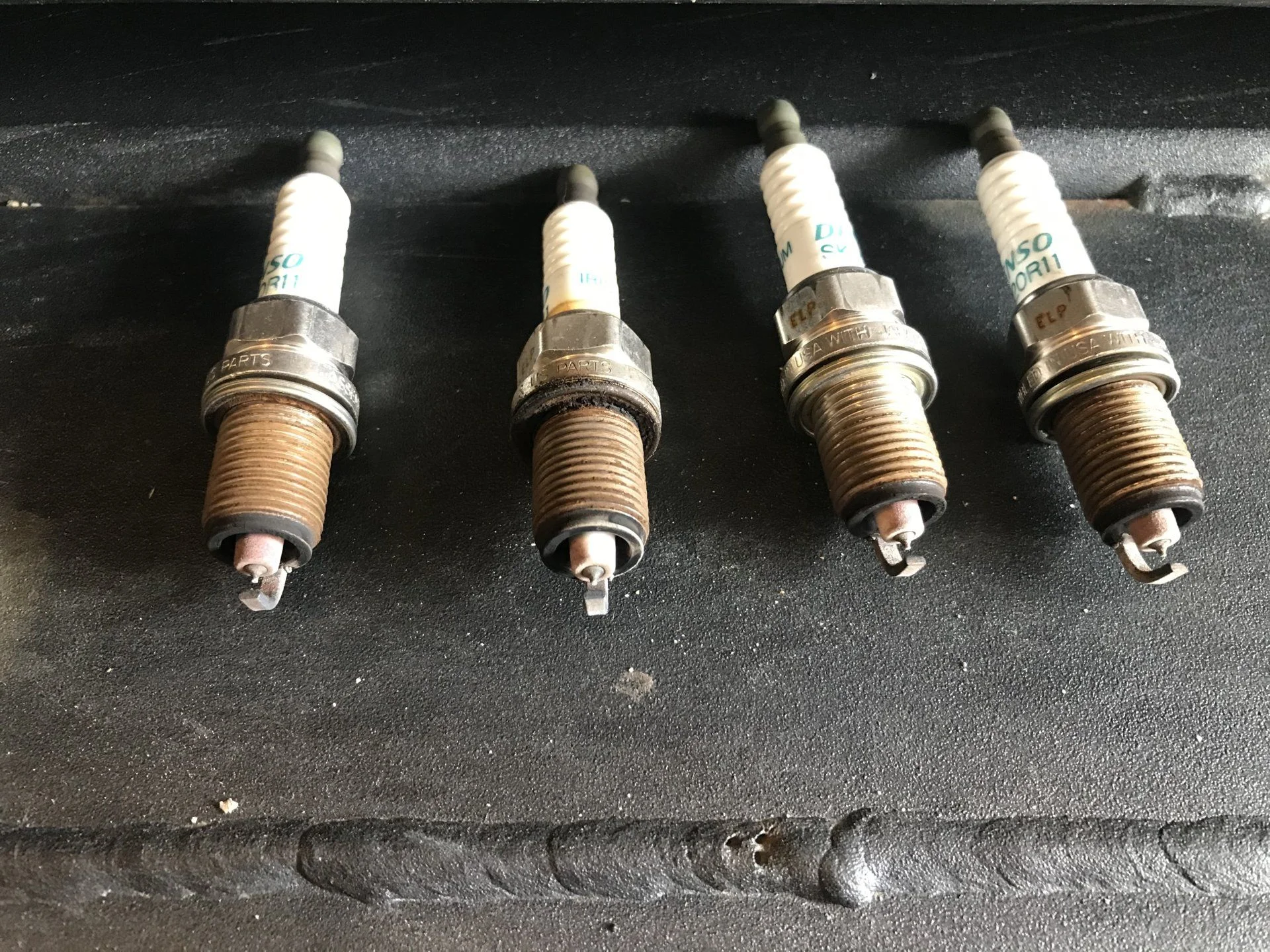

Changed out the plugs w/ some new Denso SK20R11. She seemed to appreciate the new plugs, ran a little smoother!

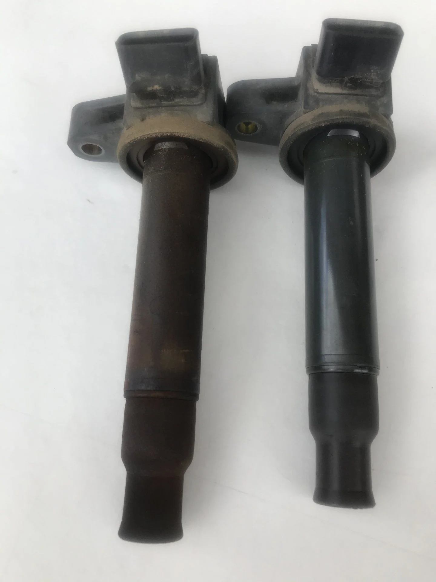

One of the coil packs looked discolored:

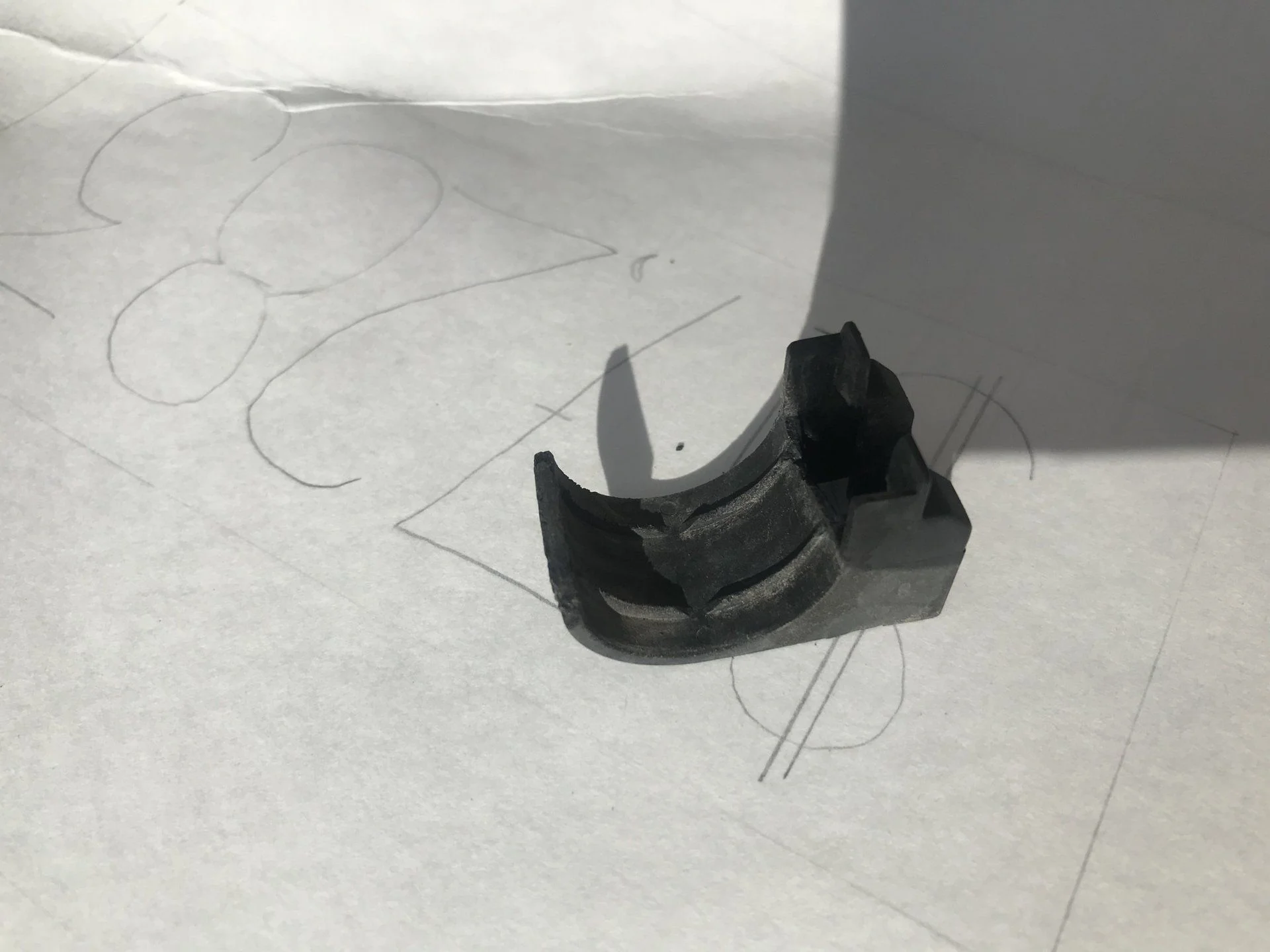

Does anyone know the p/n for the clamps that hold the wire harness above the coil packs on the driver side? Mine are toast!
