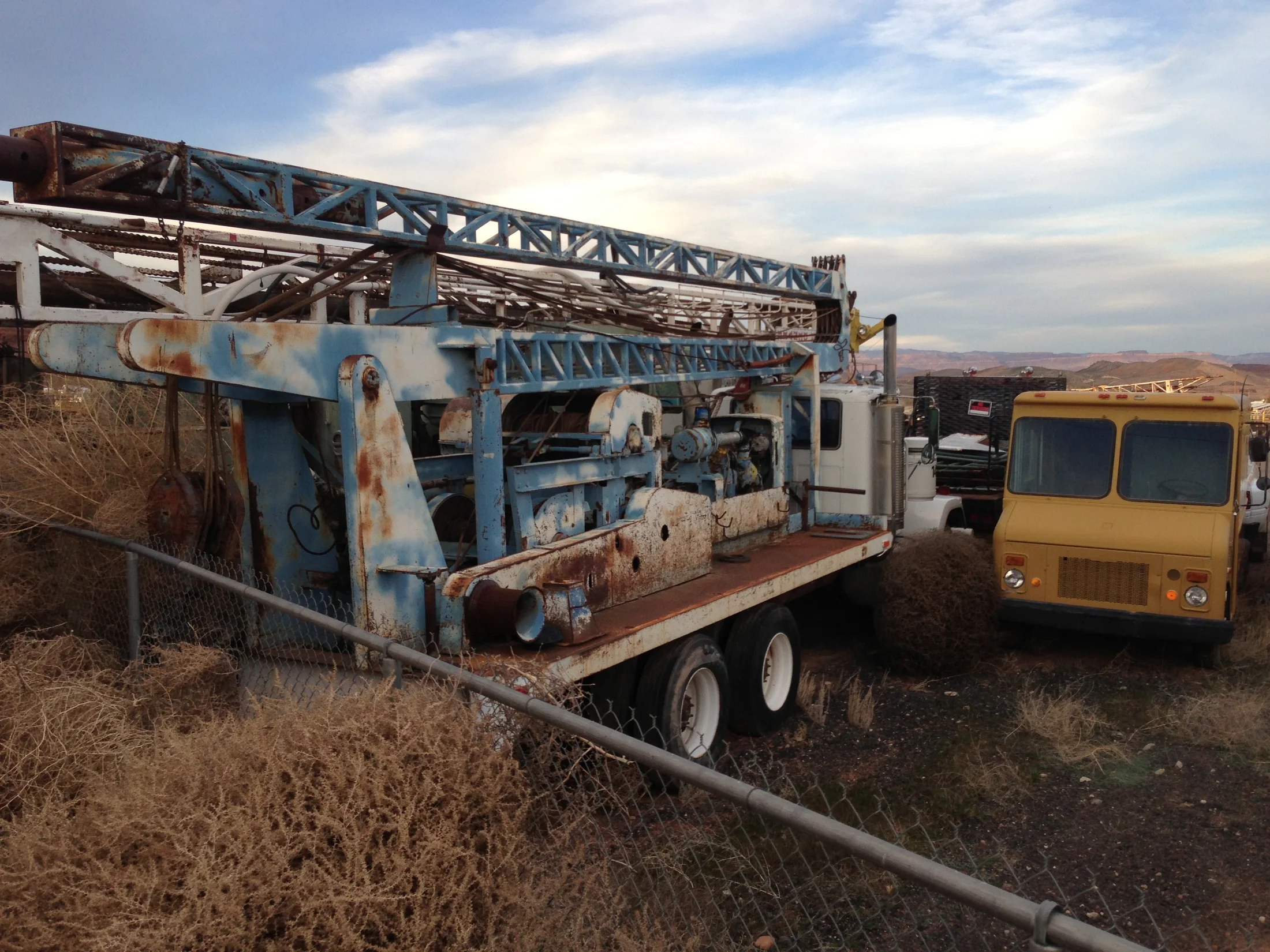

Making this pump rig was one whole summer under the hood in Las Vegas, and there were two of us on it. The other guy was the only person I ever heard dad say could weld better than him. (Grandpa had passed by then, but they always argued, sometimes about whose welds were better.) I can’t remember his name, but I do remember he could cuss better than anyone I’d ever met, and he was .. highly critical of my welding, but I learned some from him, including how to pull that derrick back straight when it started to move without tearing the existing welds.
That picture is from 30 years later when I had to help dad repo it from the POS that tried to use the law to steal it from him. Last I heard it’s somewhere in the panhandle of Texas, still working.

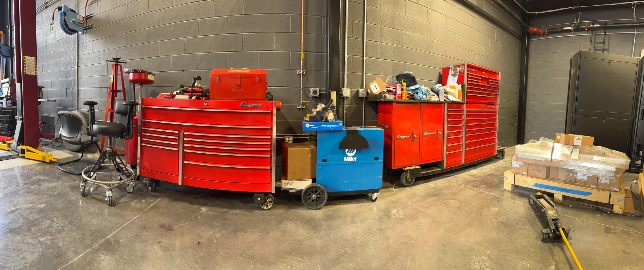

I found a little early 80s millermatic 35 in Boise and Mark has a hobby giving old miller welders a home. He insisted on restoring it for me, which I appreciate.
You can see I’ve not even unpacked it yet. Time is in short supply. Apparently there are papers inside one of the boxes with a bunch of drawings of ‘e’s and ‘x’s and whatever looped together.
