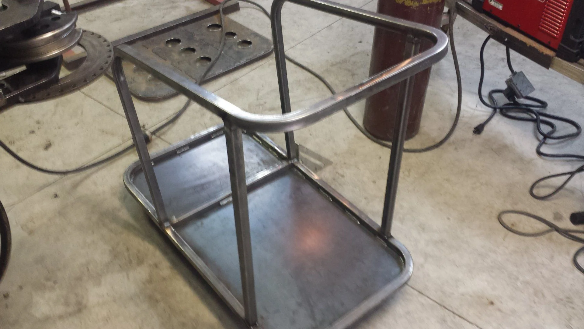

Built a welding cart for the new lincoln 210MP. I sold my large ESAB Migmaster 250 when I moved to WYO and needed something smaller, and this welder kicks butt. It welds extremely well out of the box, runs 110 or 220, and can do stick and DC tig. I have had no problem with any welds thus far with the settings it provides. Its the first welder Ive owned with the auto settings, and it works great.
Fired up the CNC table and bender and got to building.
On to pics:

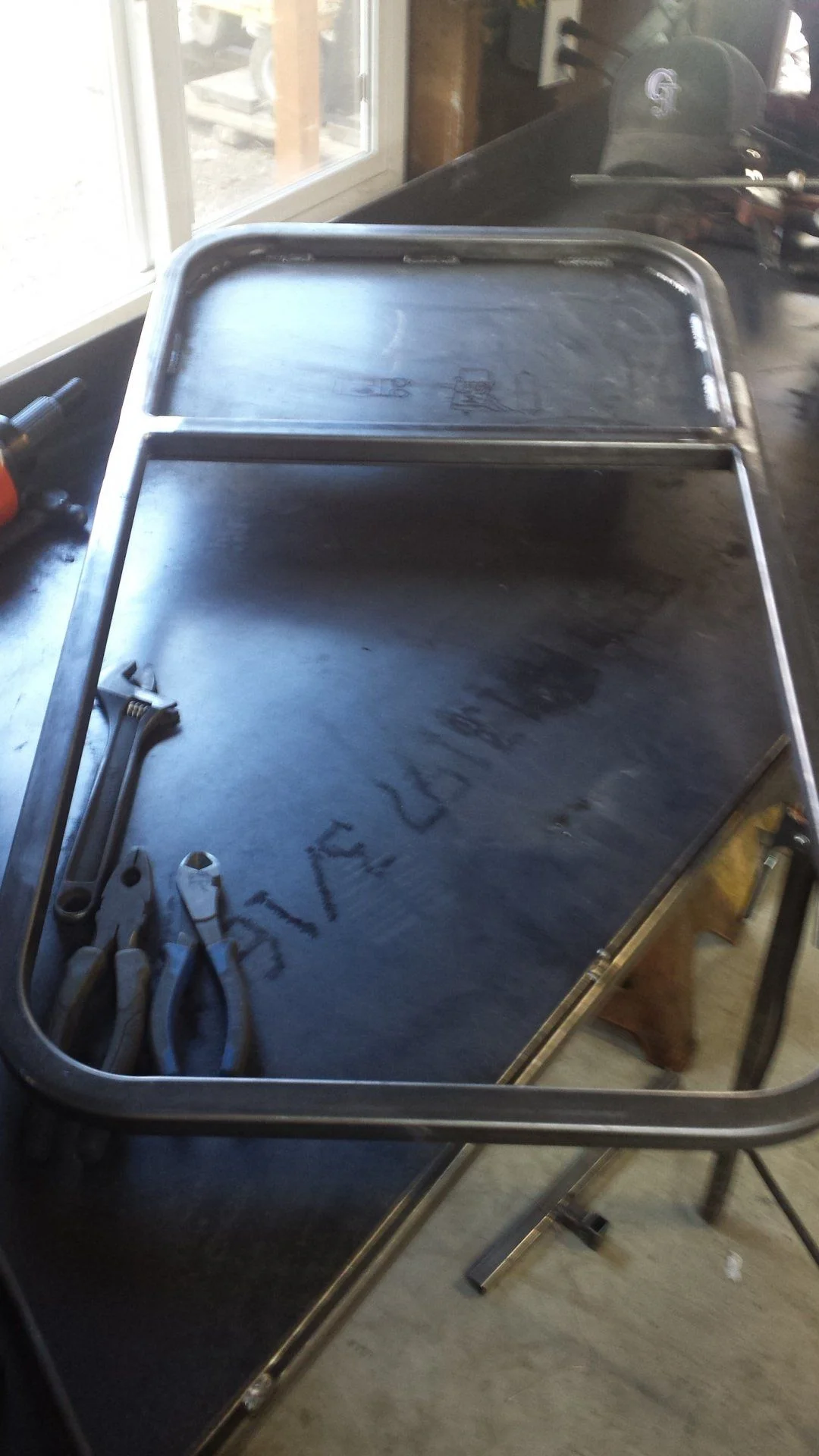

I wanted it to hold two cylinders so I could set up the tig side of the machine and do both with no changes...
full
full
full
full

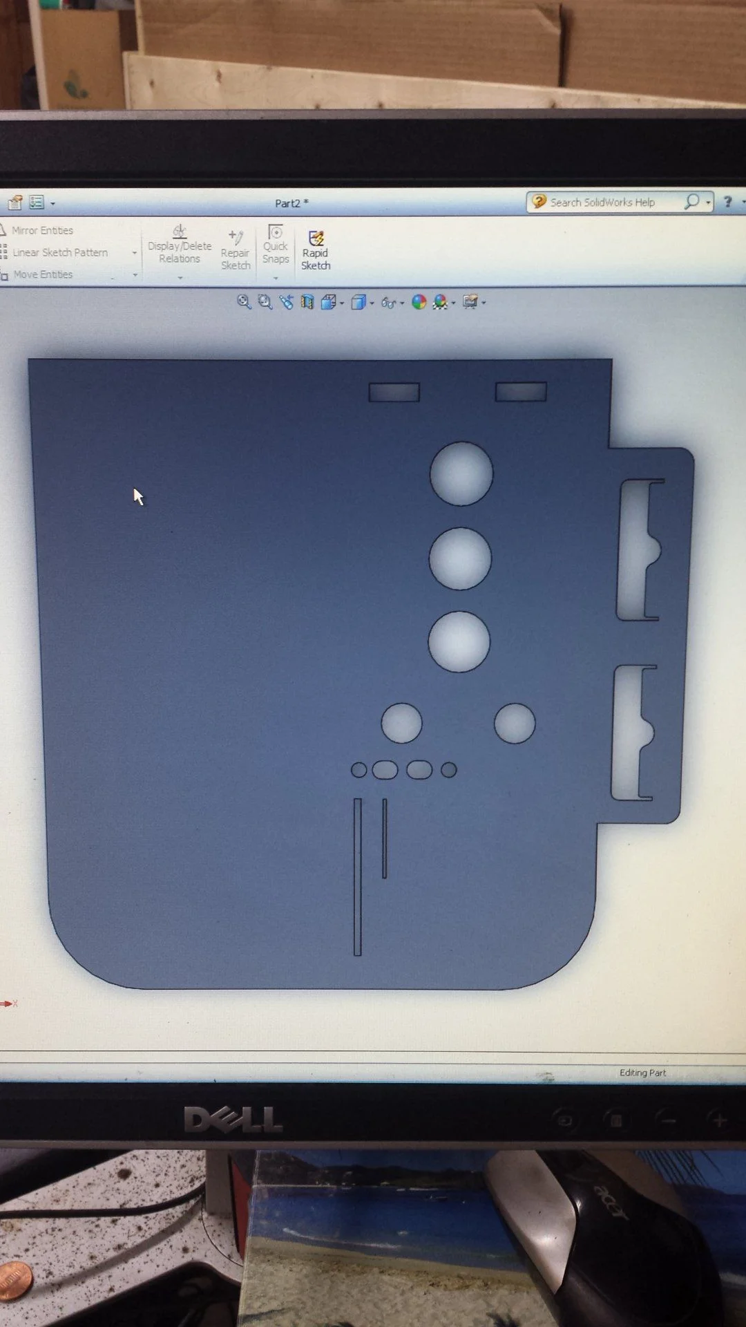

Drew up the top on SolidWorks:
full

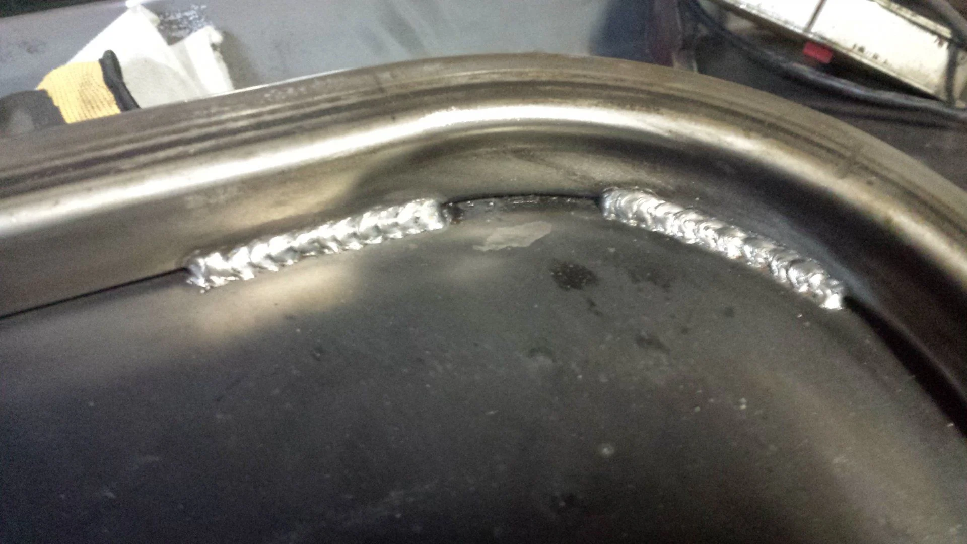

All done with the big work:
full

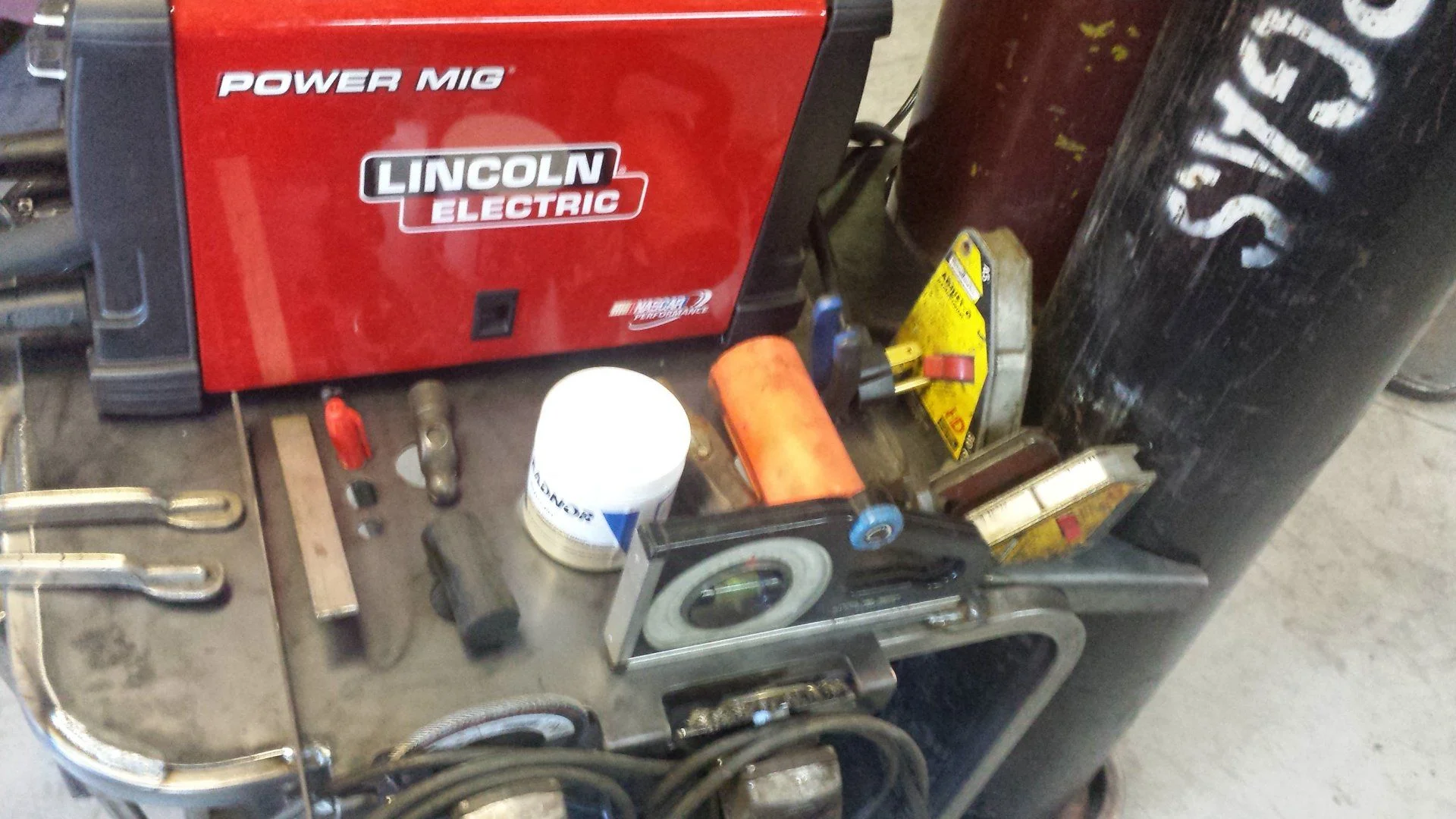

Added the handle and lead hangers, Will add in a shelf eventually....
full
