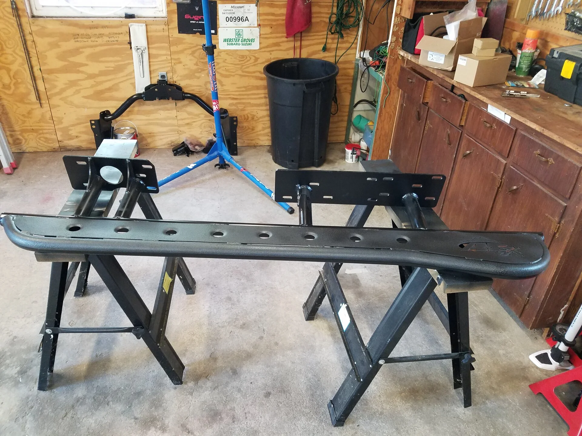

Pic of my Apex sliders (for a KDSS-equipped 150-platform vehicle - I added 6-7 rivnuts to each side of the frame in my 120 and they fit perfect). If you don't go with your local guy, these should bolt right up and are great sliders for the price.

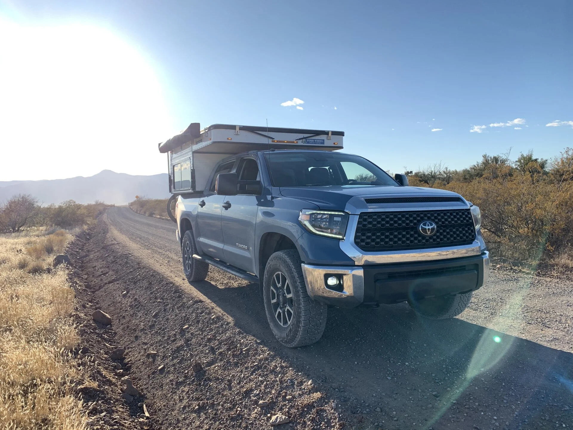

I’m more of a “highway boys” but sometimes I send. Just one more point of reference. Love alt country right now 👌🏻

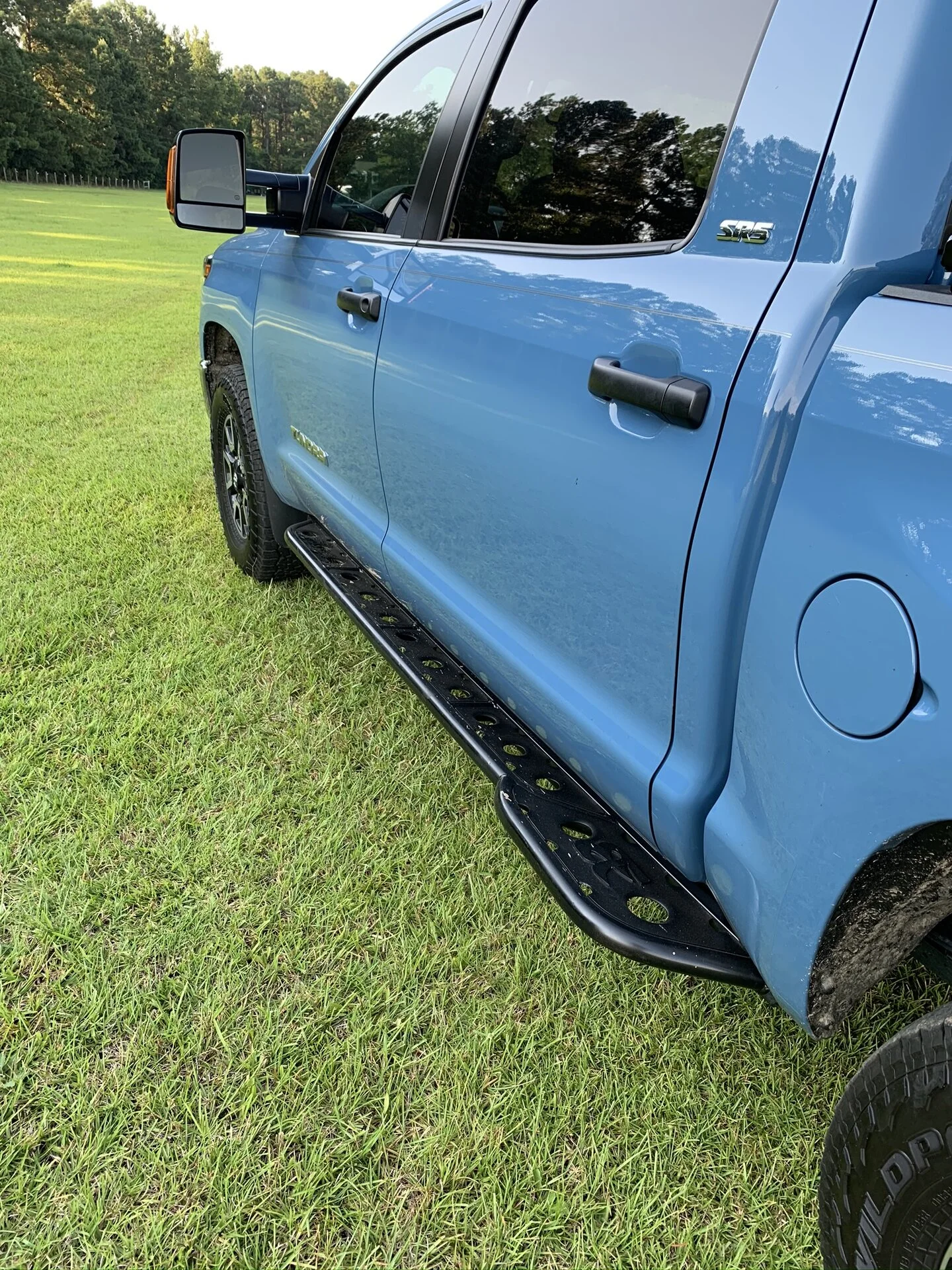

I like those slee sliders on this truck. I’ll add a reference pic of “Daisy” too.
