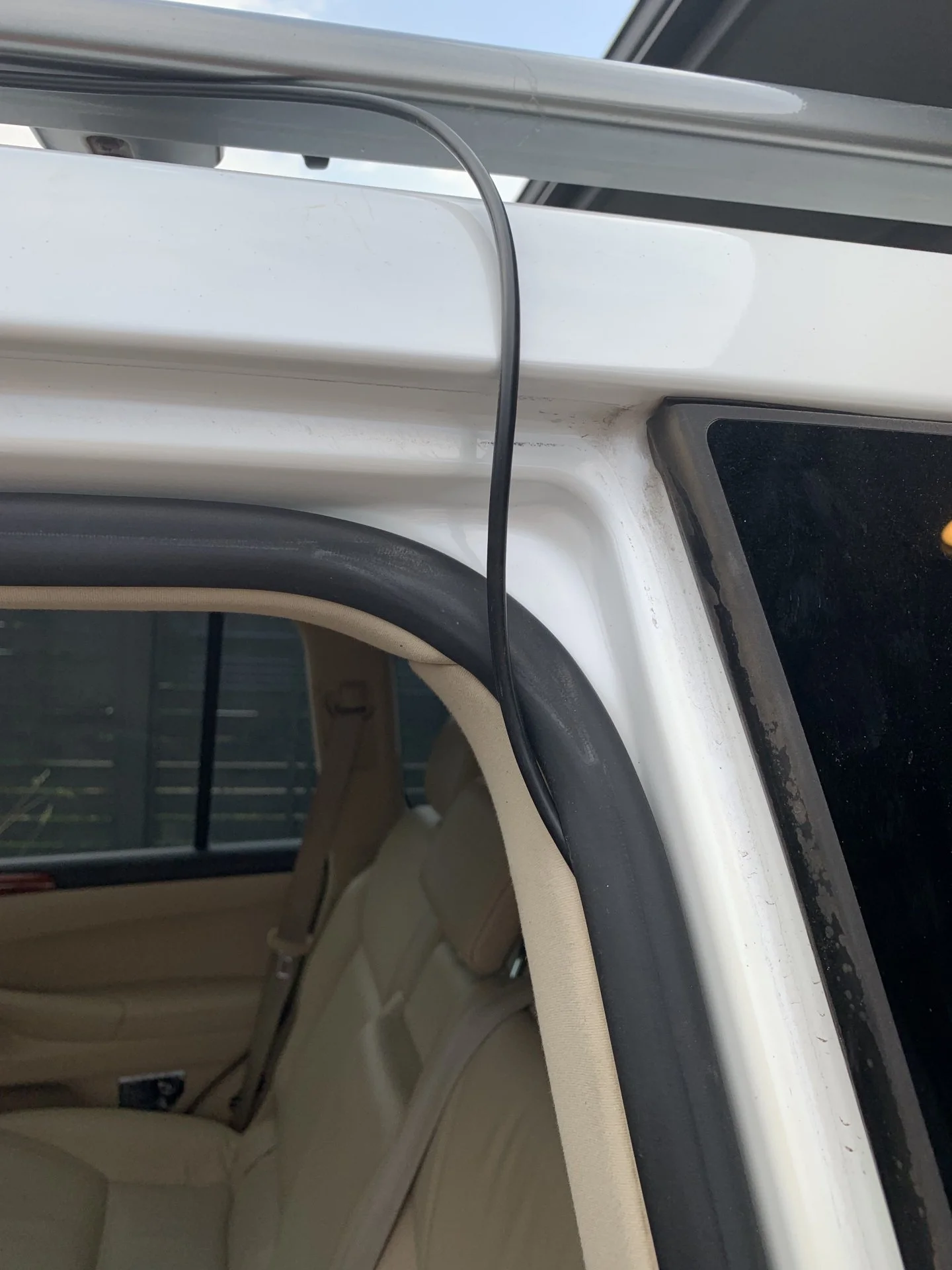

Hi all,
I have a 2008 LX. I am installing a Weboost Drive Reach OTR. I decided to put the Booster into the bottom of the center console. The included antenna wire isn't long enough to run out the back hatch. Is there a clean way to run the wire to the roof via the door molding? The molding fits pretty tight, no doubt part of why the LX is so quiet and I don't want to compromise that. Wilson does have extension cables, so I can run the wire out the back hatch if the door can't be made to work. Thanks for any advice
Put mine on the back hatch, and ran the wire up to the hatch hinges, and then down the body to the tailgate. From there along the passenger side under then qtr plastic and trim channels. I put the amplifier under the passenger seat (US, R), and the inside antenna in the ashtray.
I bought a 2m extension, but 1m would have been enough for the hatch mount. My stock wire made it to the b pillar.
