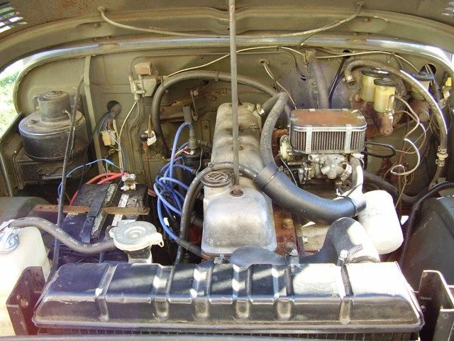

Hi guys...
My weber carb is using a filter that I think is gauze...its white and wrapped in a fine wire mesh. I've heard that these things are washable....but how?
Then, if I do wash it....is this the type of filter that requires oil?
Thanks for any insight....
Doug

BTW, is that a new radiator?
...good one Dave!
I haven't ordered the kit yet, but I'll let you know. Actually, I'll just bring it to a meeting and you can use it.
That is the radiator that came with the truck...why? Is it in good shape relative to yours?
