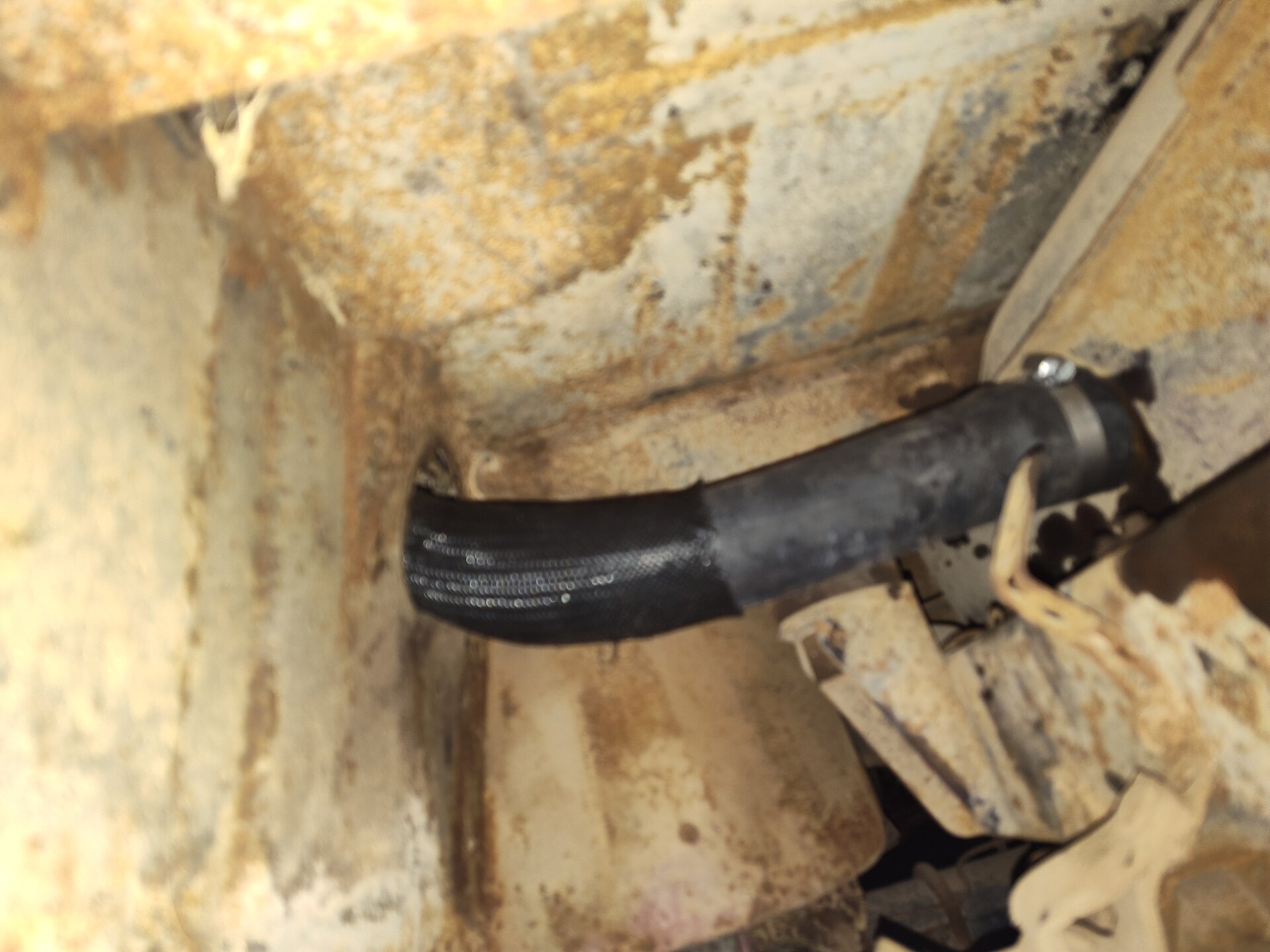

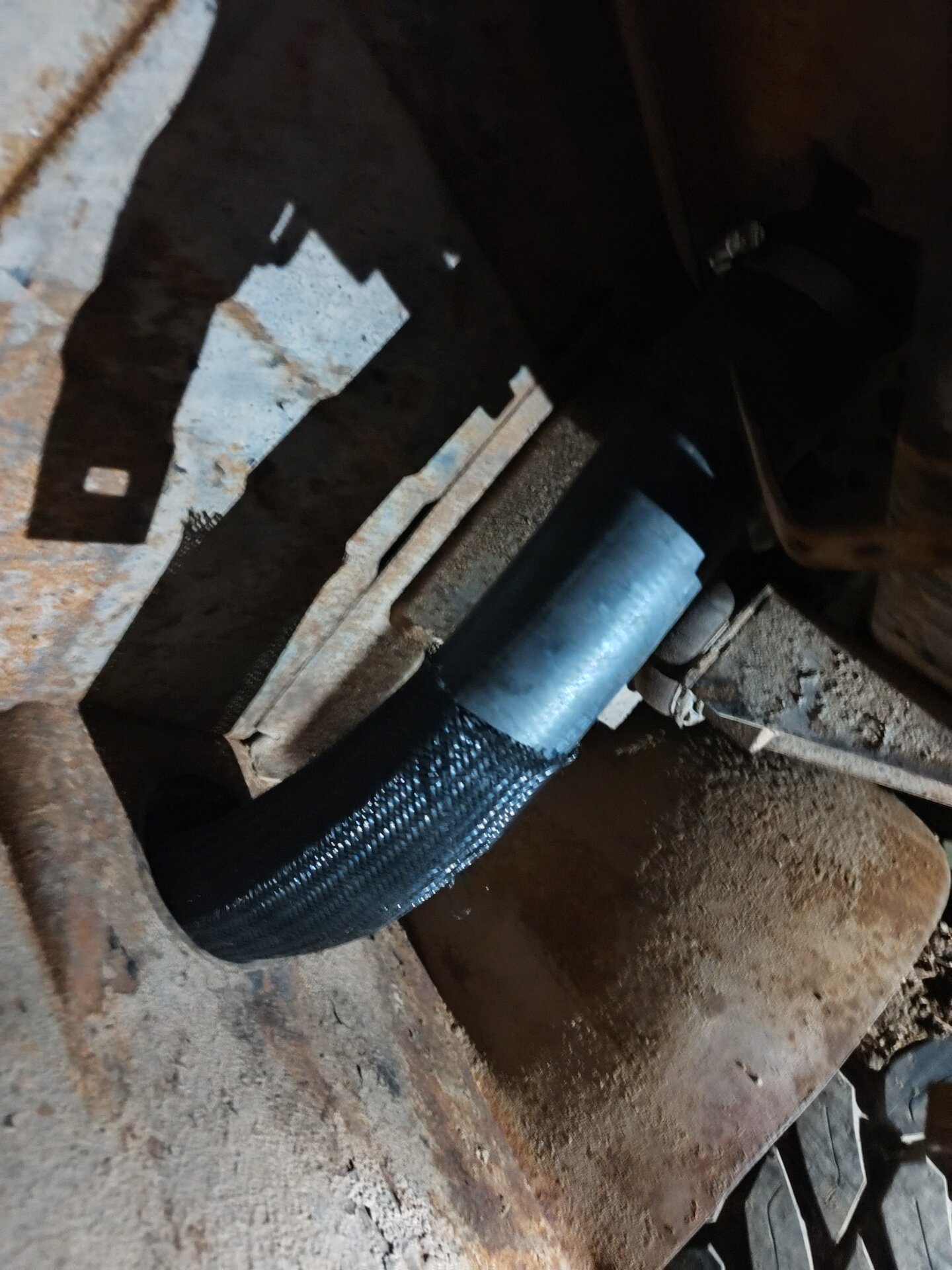

In the meantime. I searched all my local spots and found a radiator hose that will work until I get replacement actual fuel line one. Confirmed fuel to the pump, just nothing from pump to carb. i think the pump has given up, and I will be ordering the rebuild kit as well. Another baby step

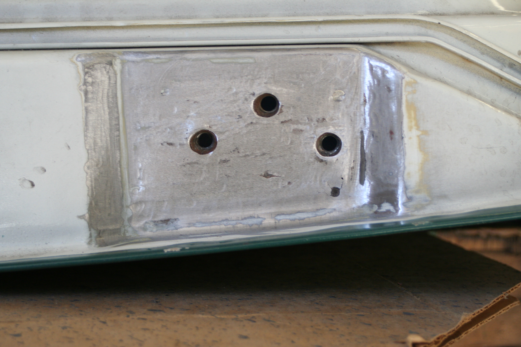

In the meantime. The passenger side bottom hinge has ripped the sheet metal out. Best option would be replace door I assume? Or cut up the spare rear door I have?

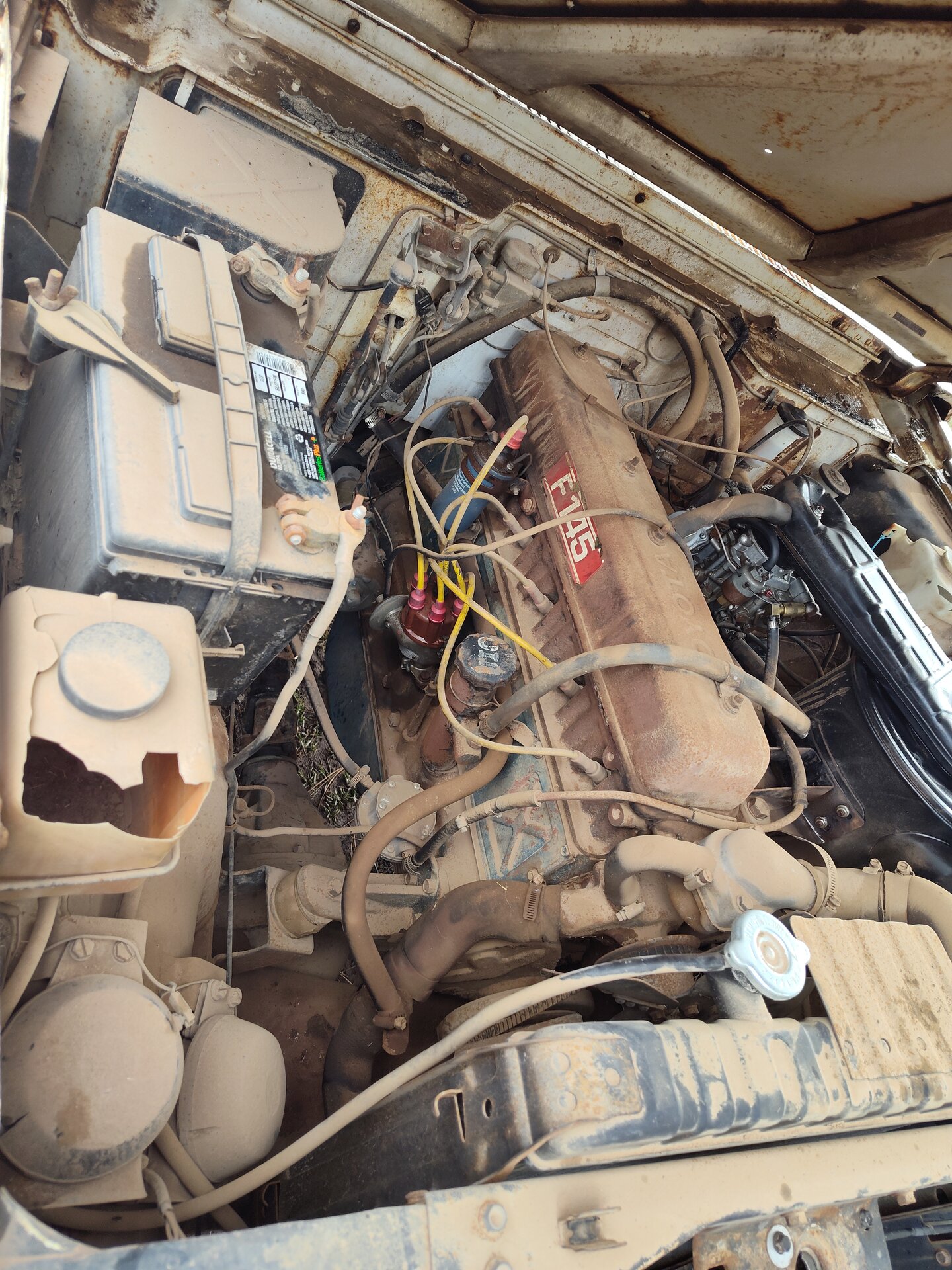

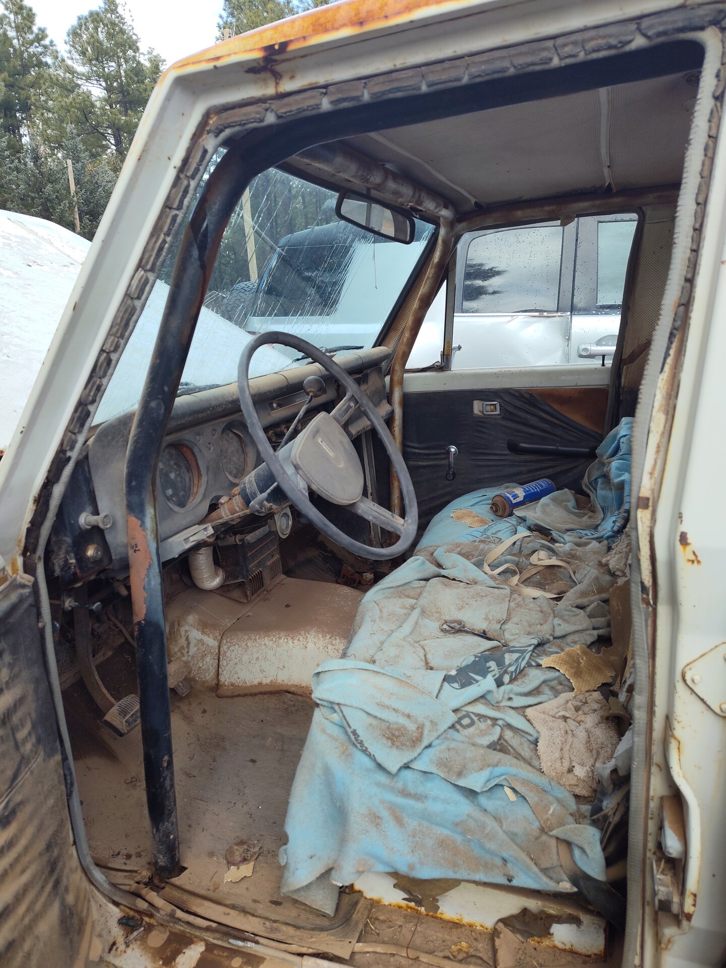

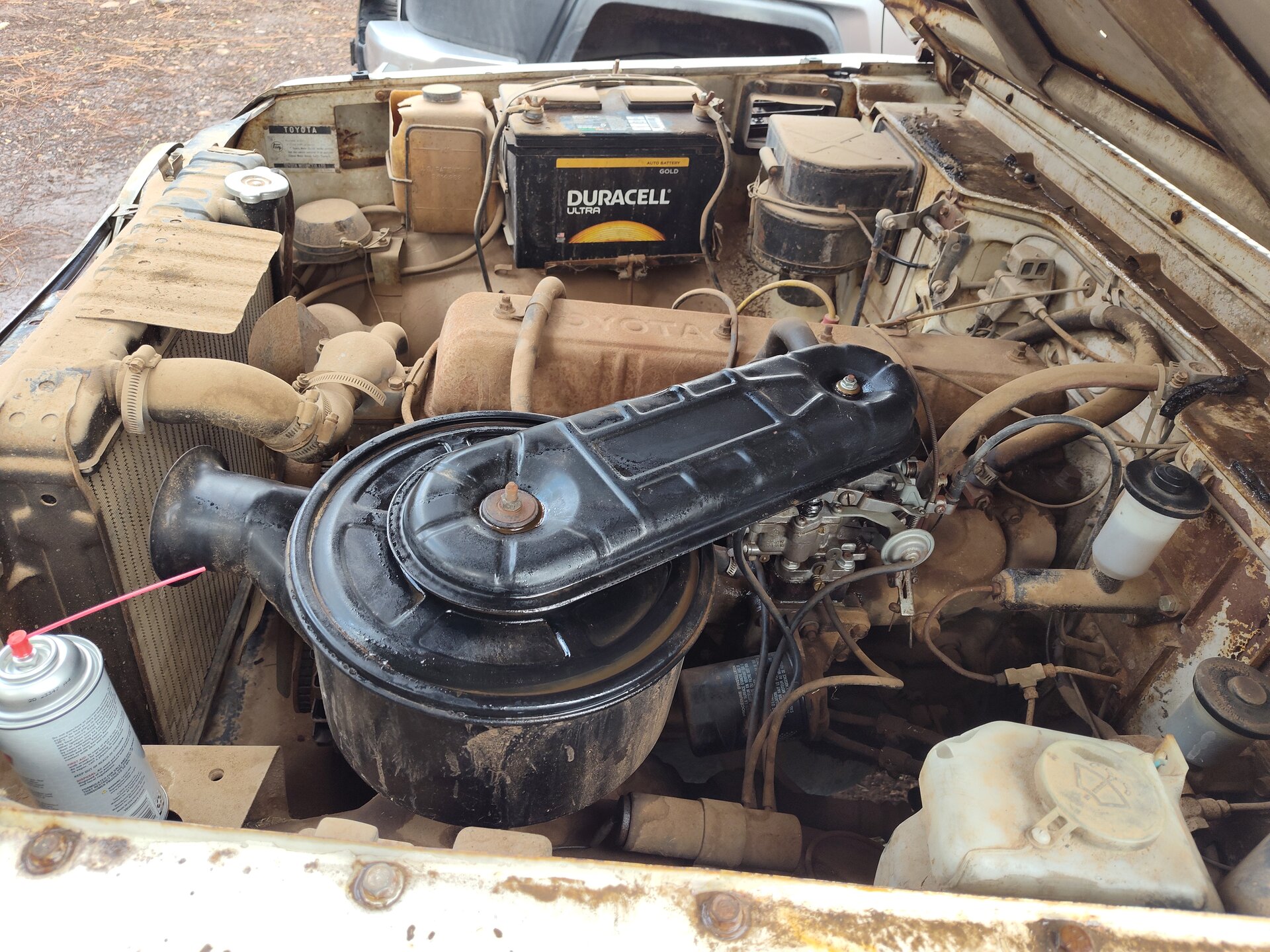

Well here it is. I started spraying off some of the engine bay. I replaced the right rear door, fixed the inner handle on the passenger front door, fixed the hood latch, unstuck the ignition, cleaned the carb, fixed literally ALL of the wiring (nothing would turn on, none of the fuses had contact). Next I buy a battery and make it turn on. there are some more door handle issues I need to fix, and the rear tailgate handle is busted off. But I have lots of spare parts, and its so easy to work on it only took me about 6 hours to fix the stuff ive done so far without ever touching a LC before lol Once I get it to turn on, I will take it down the street for a DEEP cleaning. Throw some mexican blankets over the seats and drive it to and from work until I decide to do more crap to it.

I used a replacement gas filler hose recommended quite awhile ago by @PabloCruise. Can find the source or part number but perhaps TJ could come up with it. Worked perfectly...after trimming a few inches off one end. Correct bends in the hose.
I was just going to start looking for that thread Jim! Glad it helped...
