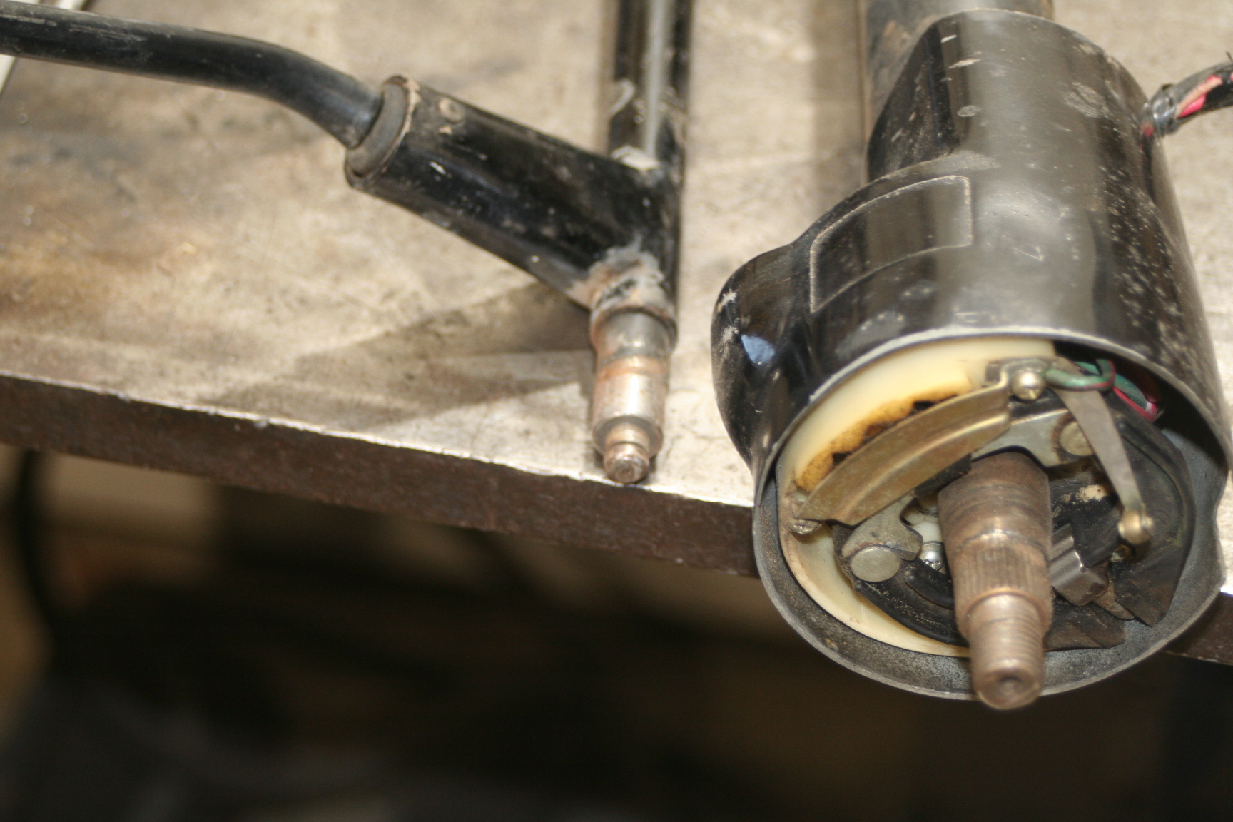

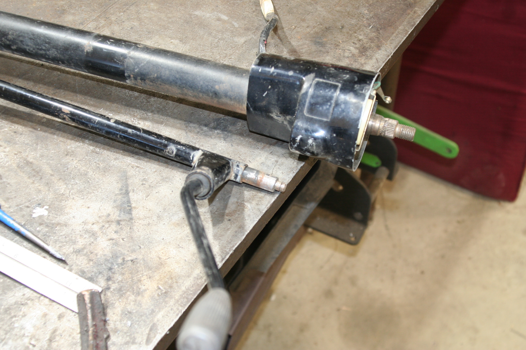

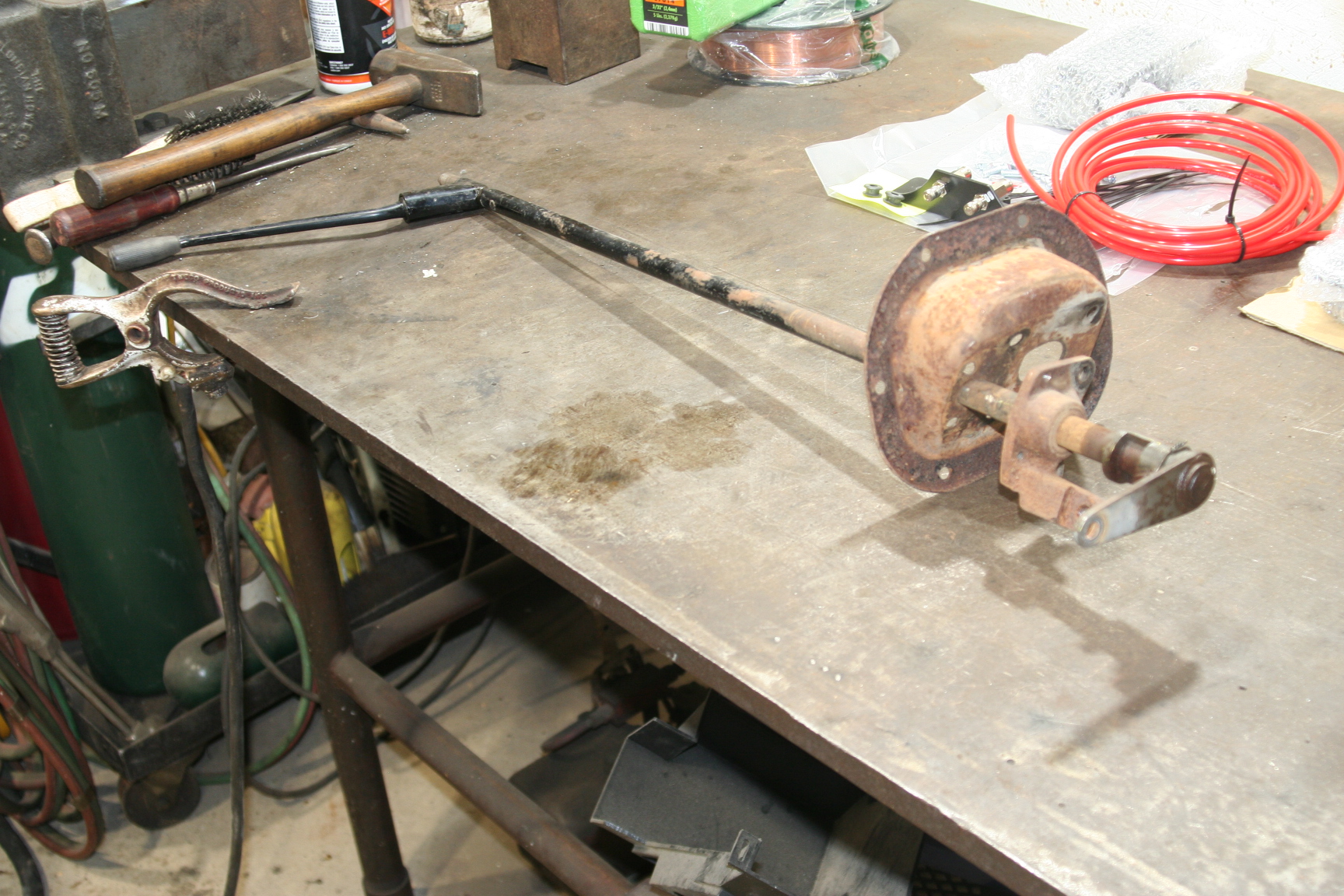

Thanks Tim for reminding me to take pictures. Wish those fiches had pictures. I'm not real sure if something is missing on mine?
So when you pull the shifter lever out, the piece with the C clip looking end should come separate and thats whats broken on mine. But yours isnt threaded, and im not sure if mine is but the hump on the side of the column part looks the same as mine.

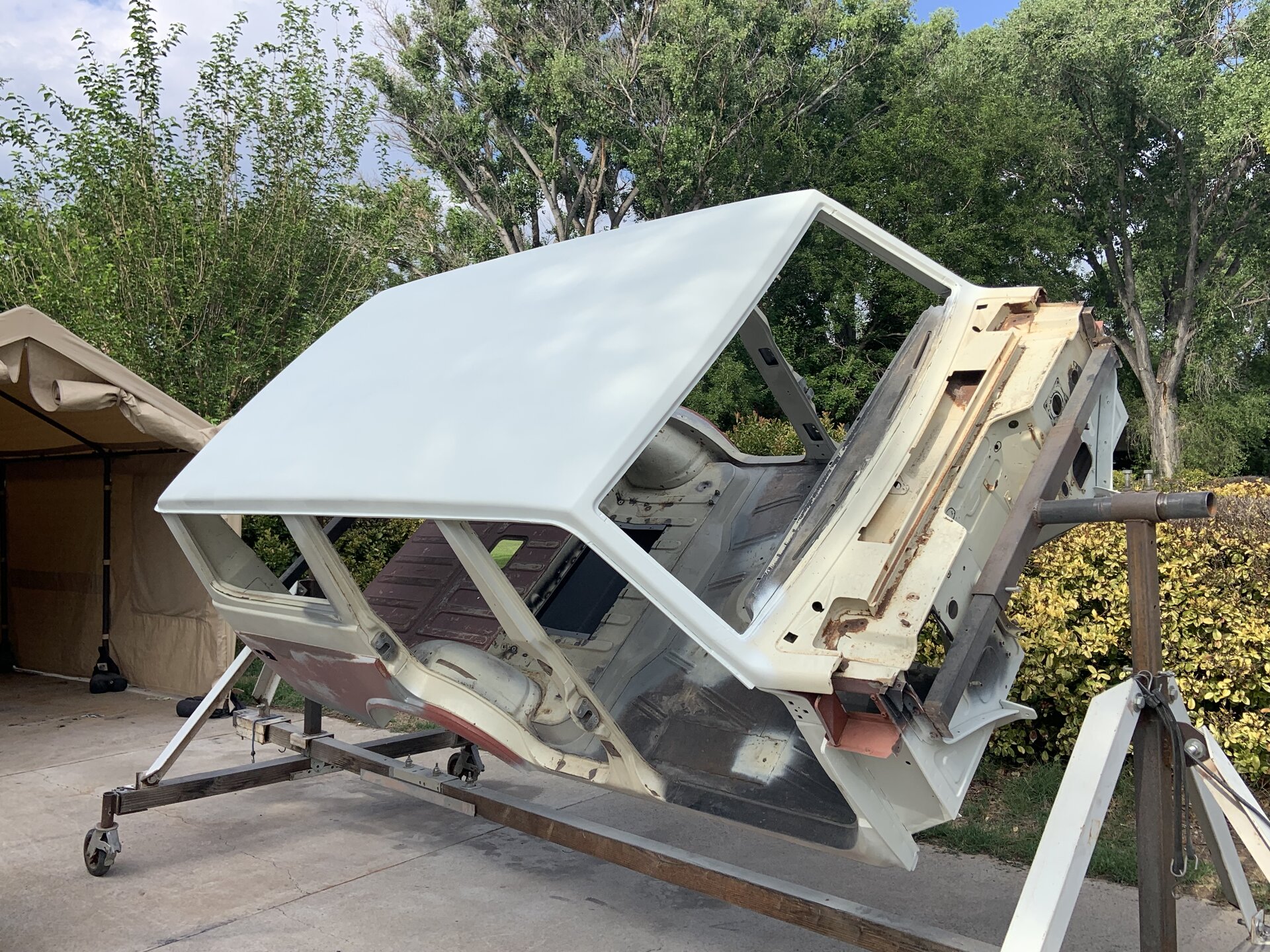

Just wait until you need to put it on a rotisserie
If I ever get to this point - someone put me out of my misery. LMFAO
What year is yours, mine's a 71. I can send you that shifter rod assembly if you need it.
Before I start cutting, have you tried to remove your shift handle off that rod? I knocked out one pin, but there's two more on that handle that I can't get without destroying it. I'm just making sure you will have a usable piece when done.
So the pin thing on the shifter - the pin is on a spring for the top and bottom - theres a video on youtube for it
