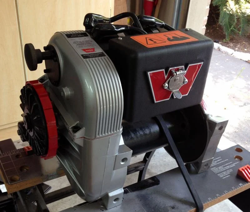

I bought a 37-year-old 8274 from Craiglist and rebuilt it; they are a simple yet sturdy mechanical design and it was easy to rebuild with ordinary tools and the threads here on Mud. A great winch, and the pulling power is underrated at 8,000 lbs. IMO. Since a new one goes for $1,800, yes it is worth the time and expense to rebuild an older one. Parts readily available from Warn distributors.
As purchased, for $300 (IIRC):
Finished rebuild/installation:
warn_redone-jpg.796825
