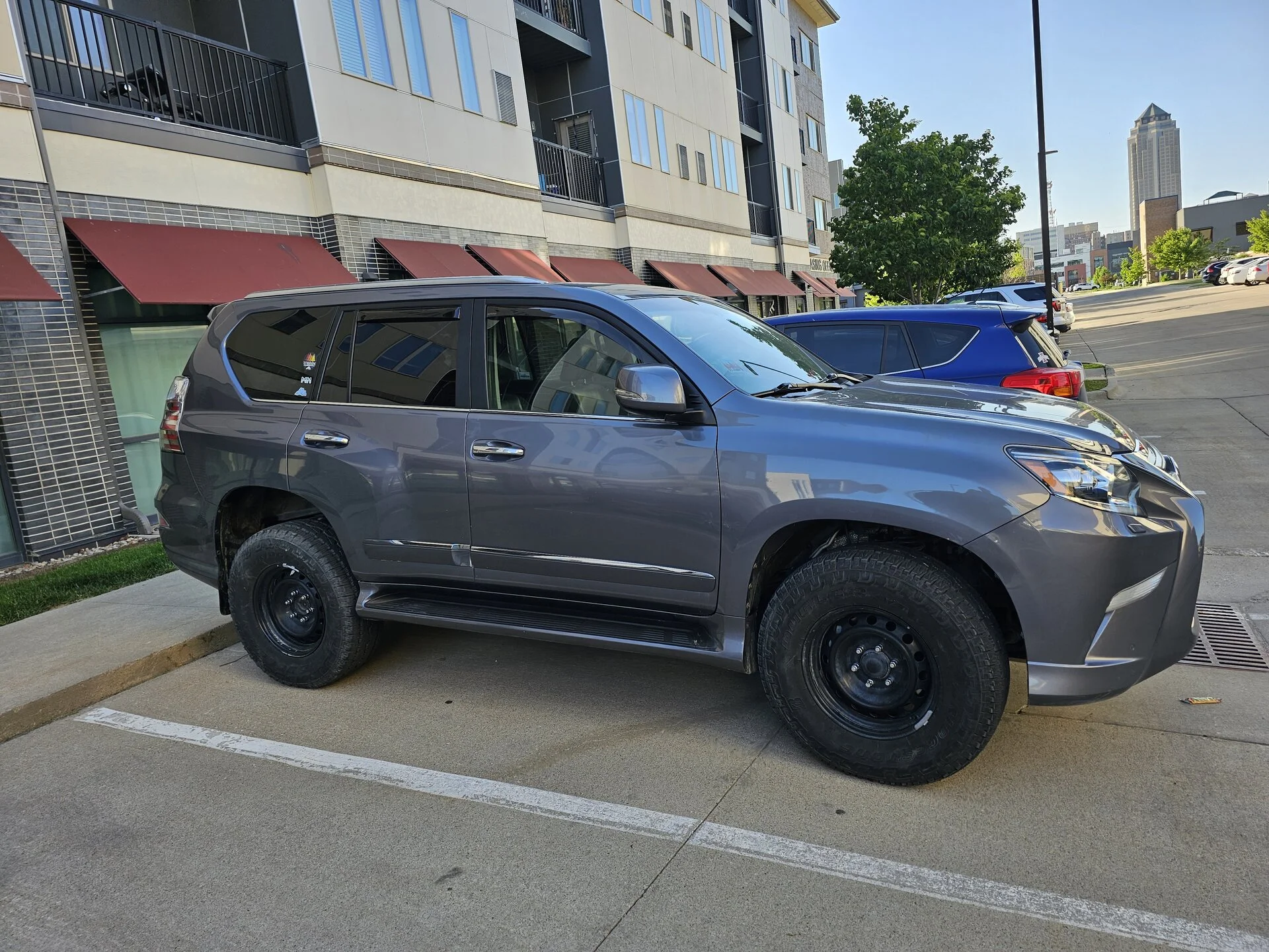

I have a gx460 !,# I just got my 5100s installed, and got a set of Revo3 lt285/70R17 on fj cruiser steelies
It rides amazingly well for E load range tires and night and day difference from my MTRs.
If you want some thing more capable then stock and also softer riding, for pennies compared to a long travel setup, I highly recommend my route as an intermediate step.
Des Moines has horrible streets and it really soaks them up with the digressive valving yet aren't so over dampened that they are jarring. The first 500 miles will be a little stiff but they slowly break in. Also, you can run the revo 3 LT tire at 35 psi and it has great ride quality for am LT tire.
I have done some mild wheeling with it and so far it's performance is equal to my MTRs, but I only do mild stuff, I do have skids ( ARB ) and use them, but just on washed out dirt roads.
Also, from what I have read it's easier to fit a 285/70, with the right factory offset wheels (not the trd pro wheels with more poke). If you must have poke, then down size accordingly to fit the wider scrub radius.
