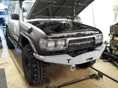

Alvaro, Id like to know what/where you trimmed, and how did you de-flare your rig so cleanly!?
Rear fenders were trimmed about 1 inch for the whole arc, fronts were trimmed a bit more than an inch, about 25 cms up from the lower rear end, that work in the front turned out really good. De-flaring was a couple of years ago before stepping up to 37s, let me find some pics I have, removed flares, OEM roof rack and side mouldings, have to fill all the holes and paint, almost ended up painting the whole truck!

Well I had the chance to test it after some weeks waiting, went for a local meet & greet at a test track, was soon out of action due to sliding into a ditch but before getting into trouble was able to do some testing, truck drives and feels good, I was expecting some serious rubbing but was glad that there's just a little in the front, inner tire side with radius arms when at full turn, and just a little in the rear when flexing the tire it rubs at the upper inner side of the wheel well, a few poser pics, will for sure do some hard trail to start aproaching the limits (hopefully without breaking anything)
