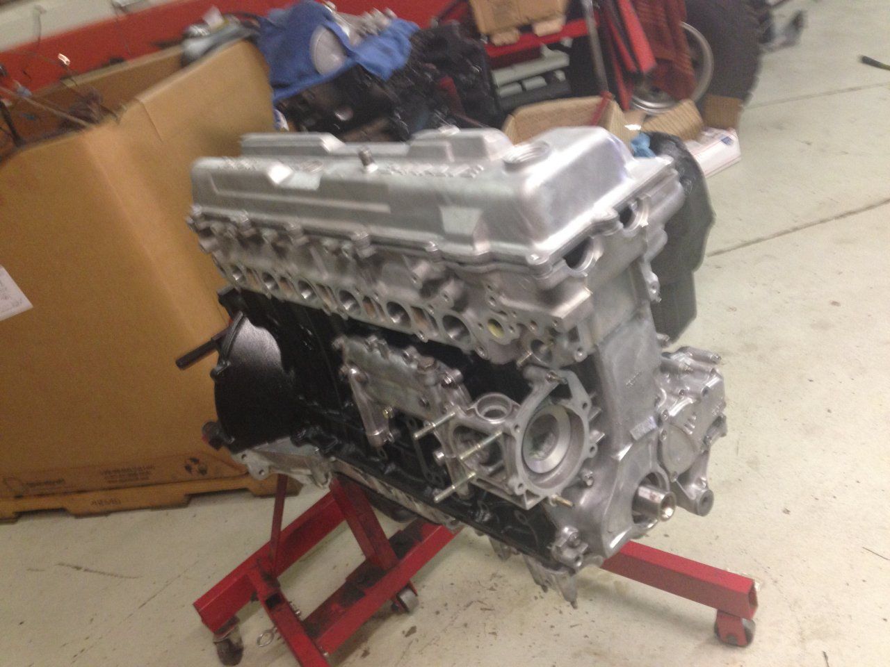

4.6L is accurate, but I round 8.7549 to an even 9" in conversation, too. :flipoff2:
+1mm, so think it's 4650ccs, but don't recall exactly.
That said, balanced, cryo'd, ported, polished, studded, HC....
If it can be done it was and damn pretty, too!!

That is a good looking engine for sure! Should move that little truck like no one's business!

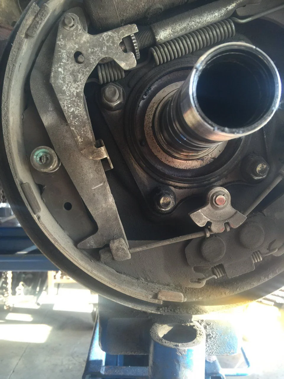

Swap is done.
Bit off more than time allowed on crap I didn't want to do, but "while you're in there" can't not.
Pinion seals swapped, front and rear axle rebuild, now morphing into a full blown brake job
and stud swap....
Prompted by the downtime waiting for bushings, having toasted a few burning pins....all on axles that were only supposed to be temporary, justified by the perception they'll be worth more when selling, I hope, soon.
