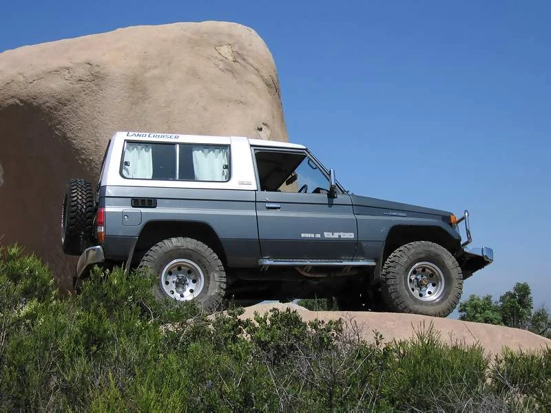

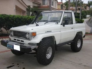

I have done 35" on 70's and 74's 74 series with Belton as well as Bobinsons suspensions. You will need to relocate the center pin or turn around the springs with the 2.5" lift from either, and depending on year you might have problem with front steering. Here are a few phots of them:
Cheers,
Michael

Hey I'm from Oz I have 35's on my BJ70 above and ran them fine with a 3b-II but have recently fitted Marks reduction gears wich have a 55% recuction in low and 8% in high to help with the bigger tyres and the combination is awesome. For high country work the reduction in low is the best mod Ive done bar lockers. Pretty exy though.
