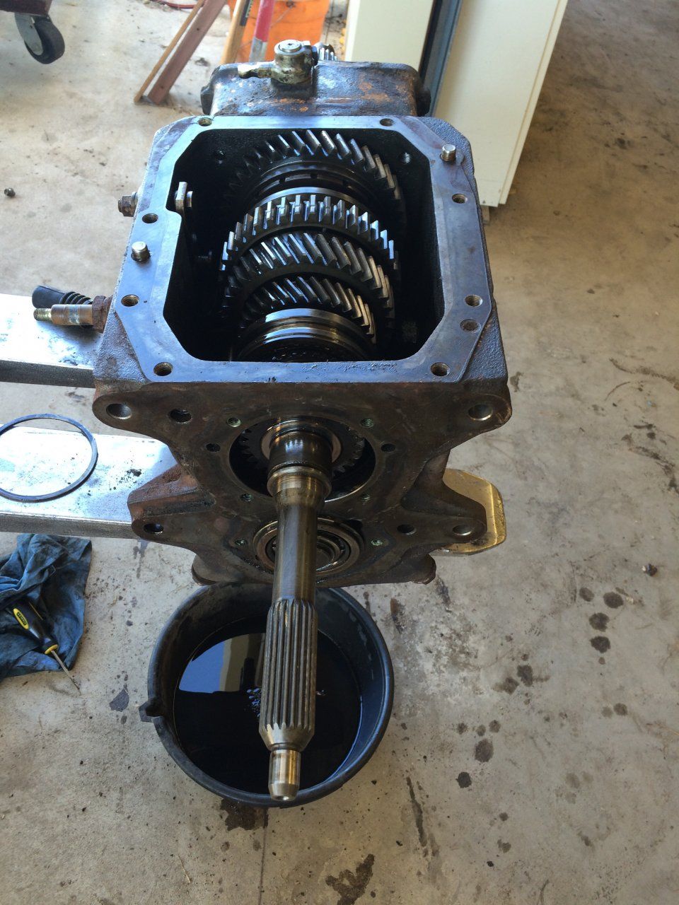

On the bench!

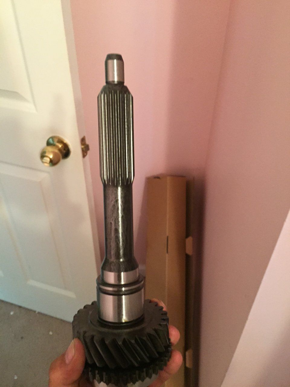

Coupla kits from the Can-Am crew (via retail partner's, of course) and input shaft from LCP&C, who feminized by fondling and manhandling it in a pink room...
and it's on like Donkey Kong.
Opted to run the H55/Split that came behind the VM (F/H input shaft, oddly) since there can't be too much carnage, considering the whopping 52HP the VM put out.
Hope to have it swapped later this month, then digging out the Ruff Stuff housings, getting cut down, and ready to prep to run.
