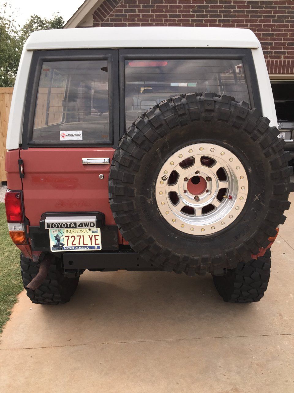

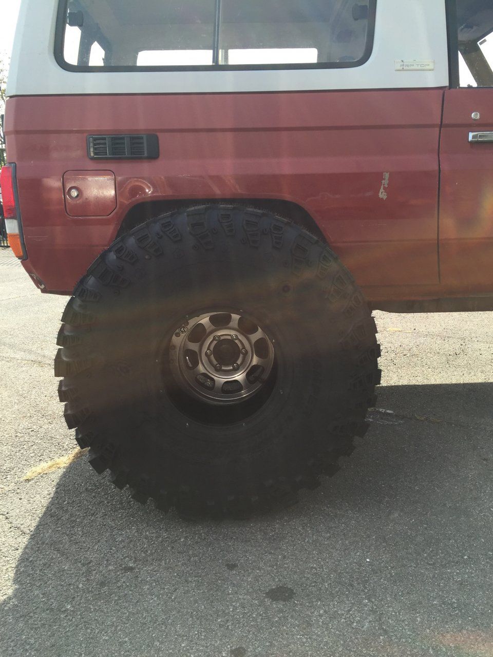

Damn what size are those ?
42s
Mike had at his shop so rolled out to take a gander at and they're biggens.
Been running all morning with her and can't get over how easily she turns the 37s.

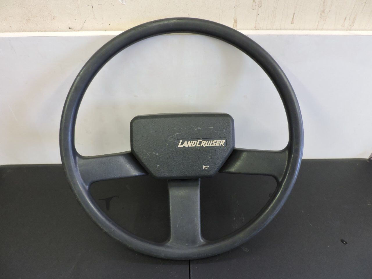

Carpet needs to be burned. Felt dirty touching and STILL can't get the funk off the steering wheel.
The interior of my Spanish 73 was like a dead body spent some time in there. The steering wheel could not be cleaned, had to be replaced with new OEM.
Man....just pulled the blood caked voodoo vial off the rear view, so gonna be worried about the spirits of POs past, now.
Nasty. Think the metal is infused with, even.
Picked up a wheel!!

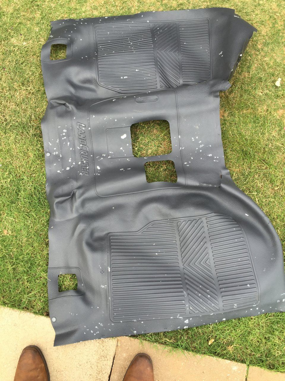

Have your front mat, Joe's gray carpet and hoing that'll mitigate noise until more determined, at least be rid of olfactory hues that make one question their preference, almost like a curse!!
Chris the carpets that I have are complete setups ,front ,rear and wheelwell covers in grey cloth.No more rubber ones :(
I know, which sucks....
The carpets will work fine, Joe. As long as five or six generations of barnyard animals haven't consummated their love on them, I can make them work!
Pretty much certain the rear tub is going to change, so doubtful I'd spend the money on new rubber if they were (or would, to store.....then sell later, if history proves..) but need something to combat the tin cannish resonation of the Krawlers.

Have something else to use Ward's floor mat on. ;)

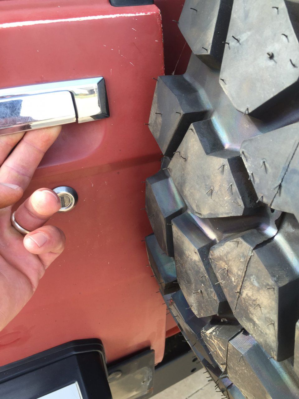

Does put the rear tire size in perspective.....
By chance, have you been missing that bewildering piece of automotive design ingenuity, being the rear washer filler deal?
Opened box for first time and found one in the bottom of the ocean of packing peanuts.
Wish the full floor were available...
Huh? Filler? Foto?
