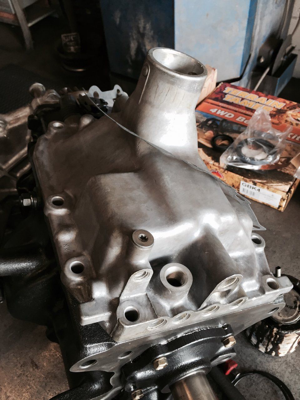

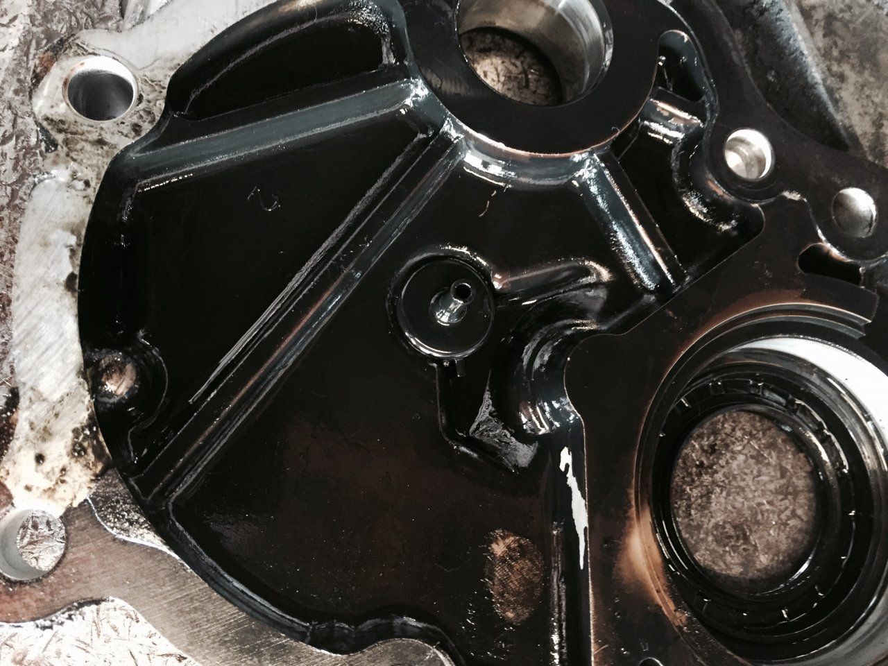

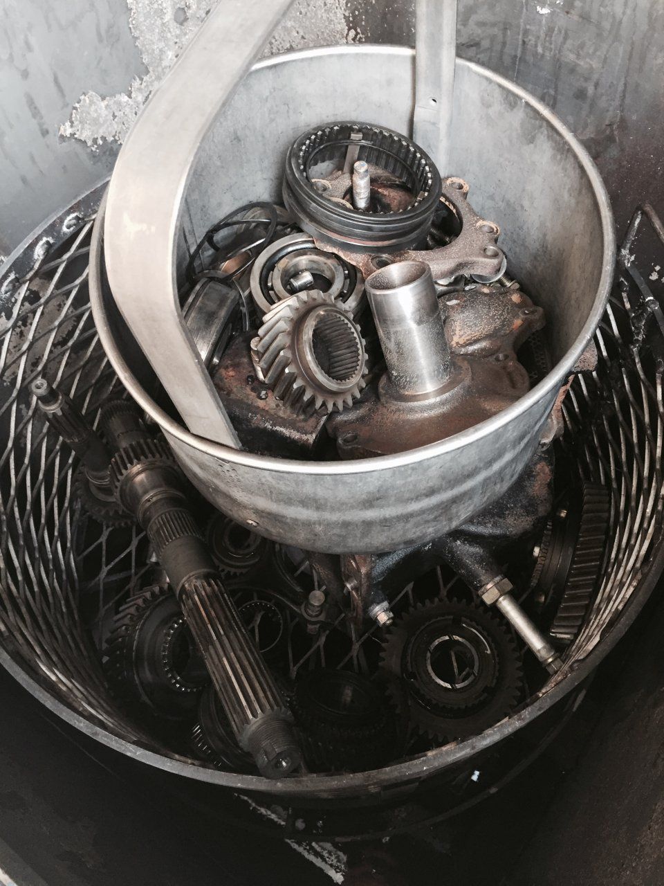

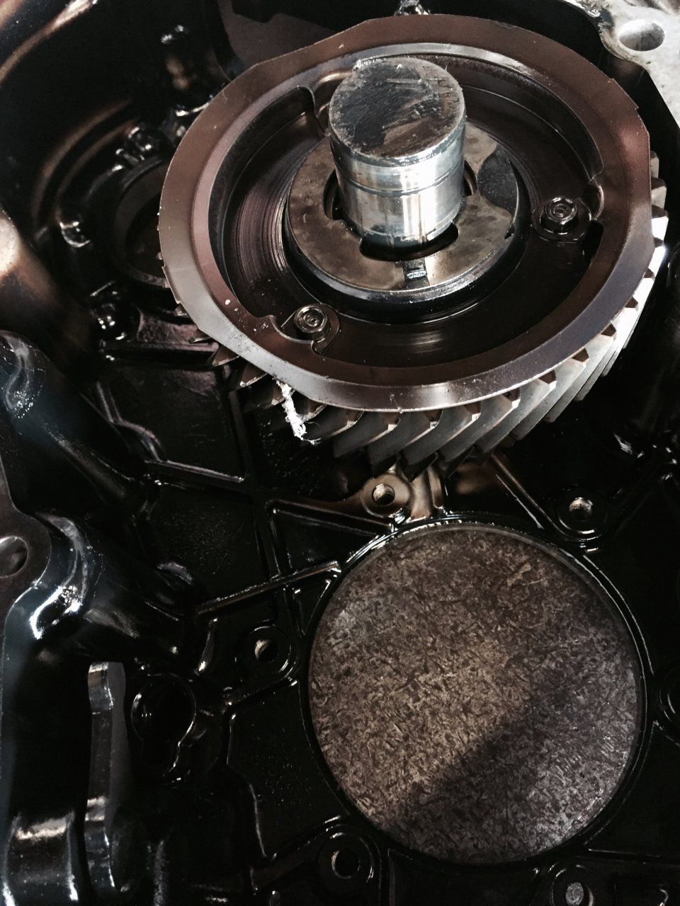

Started tear down, cleaning, inspecting the tranny/transfer yesterday.
Everything looks good, according to rebuilder, who added the bearings prolly don't even need to be replaced, the icing on the top of the craptastic, 52HP VM engine.
At first, it appeared the main shaft had substantial wear, to my uneducated eyes, but it's all in good shape the deception from fluid residue.
Inside of TC is caked, too, which is going to require stripping.
