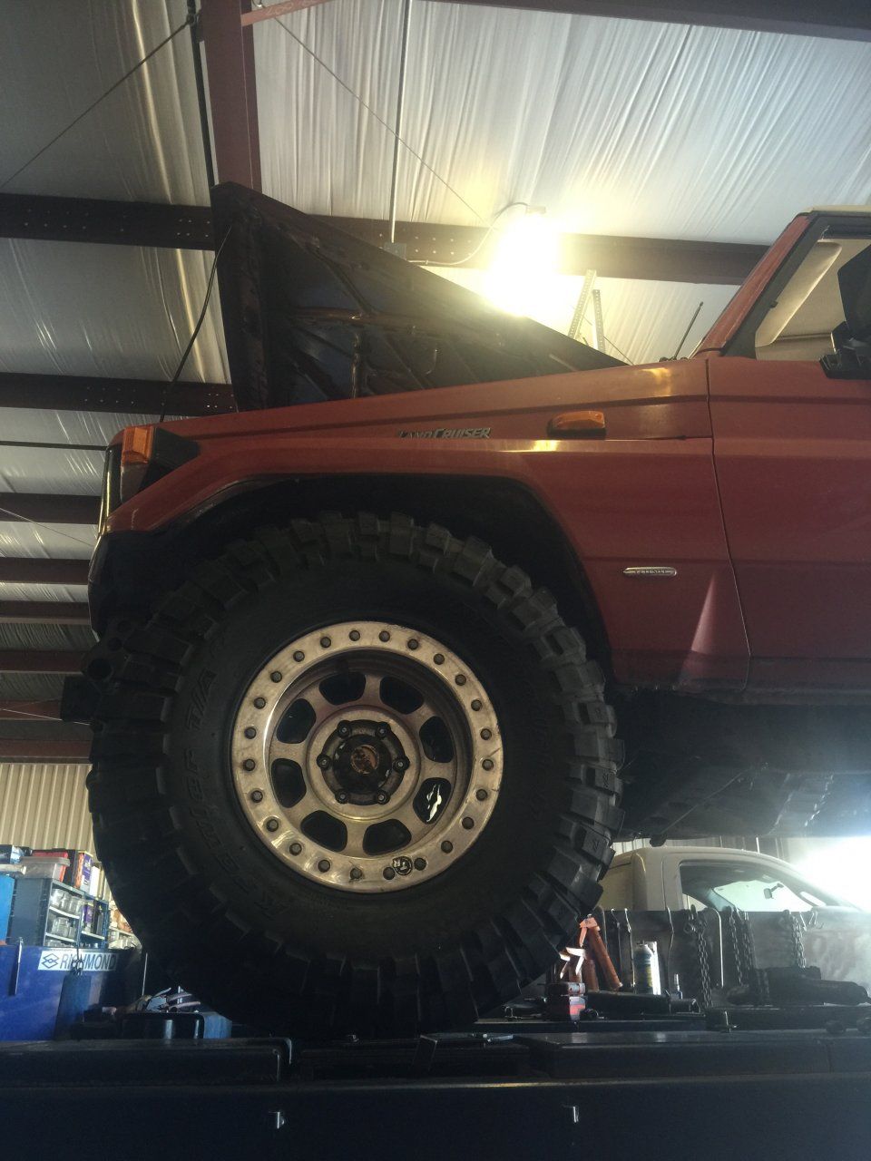

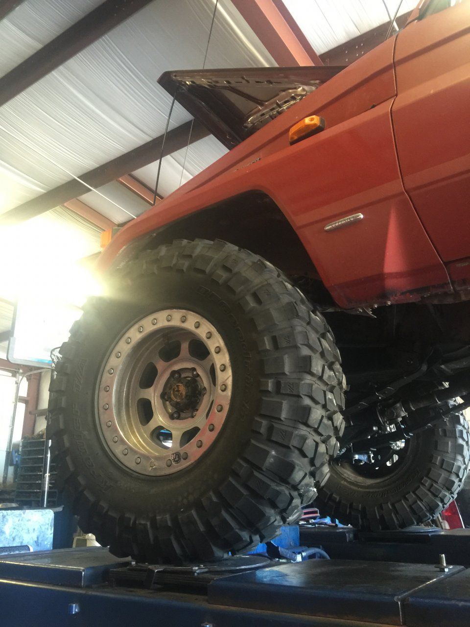

Wheels are too thick to engage enough threads to feel warm and fuzzy about, short by 20mm minimum.
Same issue on the LX, which the IS300 studs worked perfectly on, but this hub is different.
Gonna run them like they are, after all..

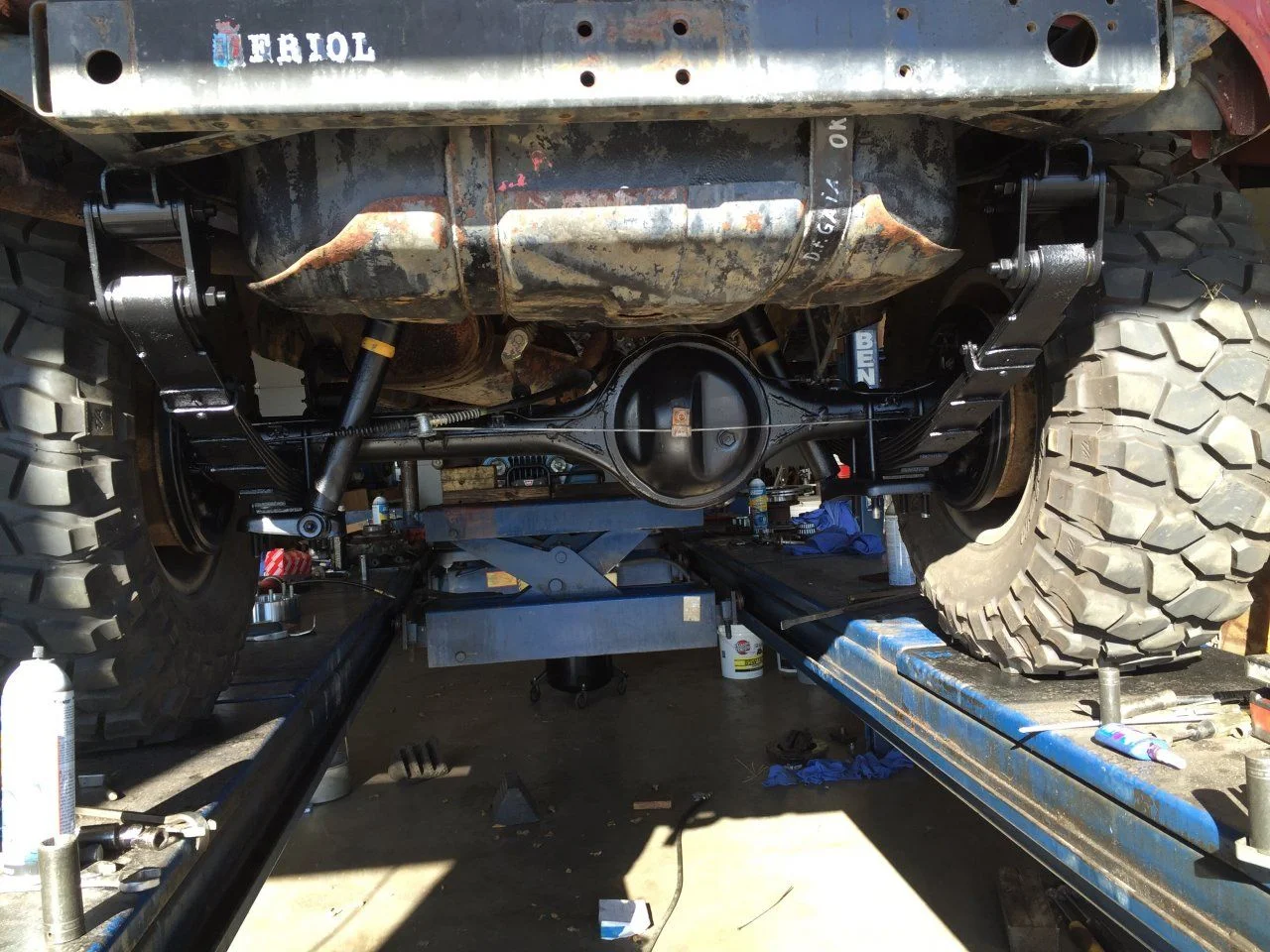

Intend 80 width Ruff Stuff housed axles for following:
I have front and rear uber built innards from the LX, languishing away in a state of cryo (everything was cryo'd except the housing. Hell, even cryo'd the brake pads!!...) that I plan to move to the RS axles, along with high steer (that I hope to not need, considering a limbo contestant is the goal).
Need the additional real estate between the relatively wide frame and tire for coil overs.
Need the additional strength of the housings for mounts.

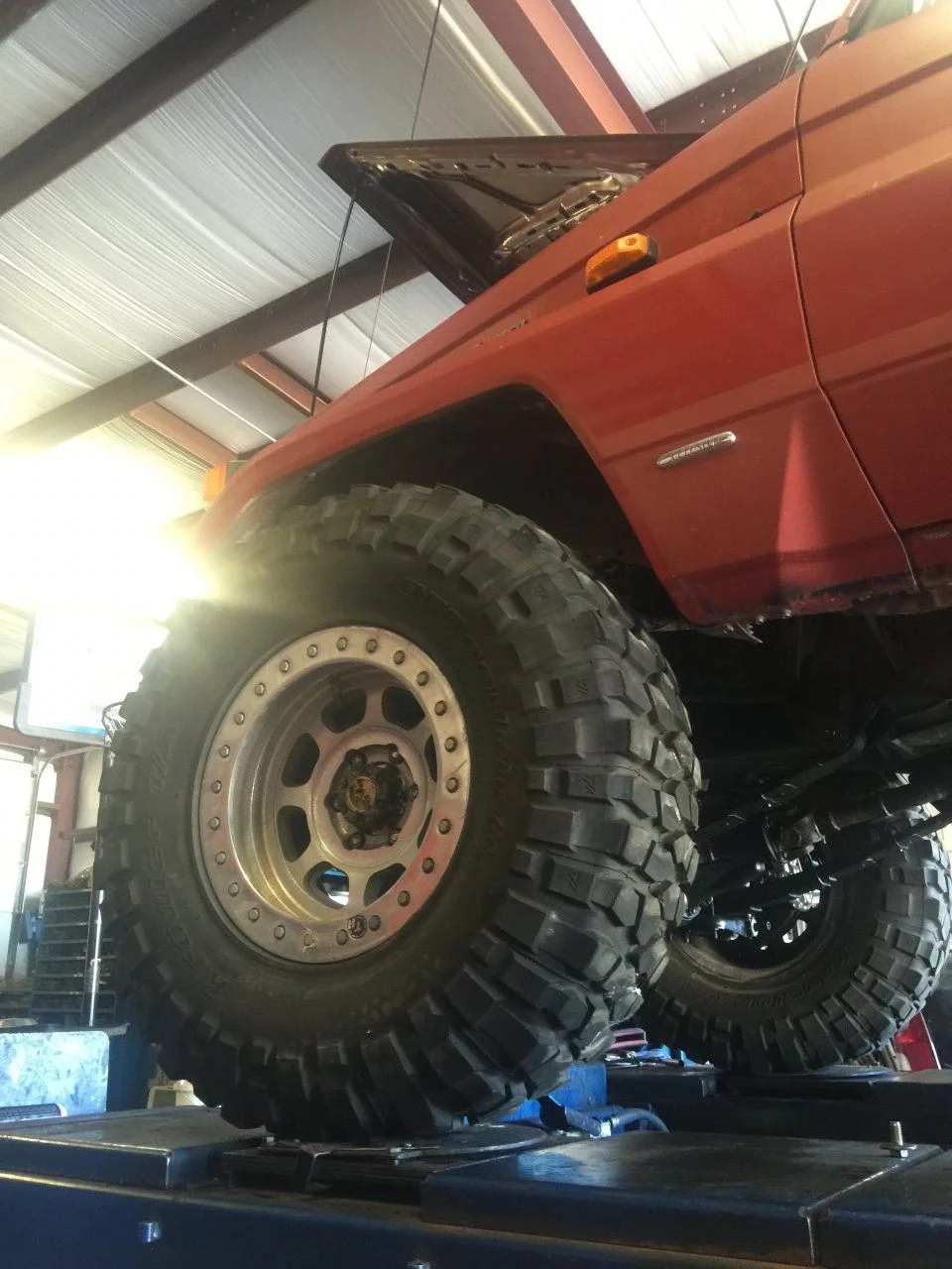

Why not install wheel spacers?
Wound up having to.... Front or rear of draglink didn't mitigate the tierod rubbing the inside of the Trail Ready's....
Had I known,I'd have put down the grinder sooner.
She's sitting 2" short of 80 WMS-WMS in the rear with the spacers.

I forgot that you were installing the PP80 axle innards in the RS housings.
If you just wanted track width then I would advise spacers.
But you want more than track width.
Carry on!

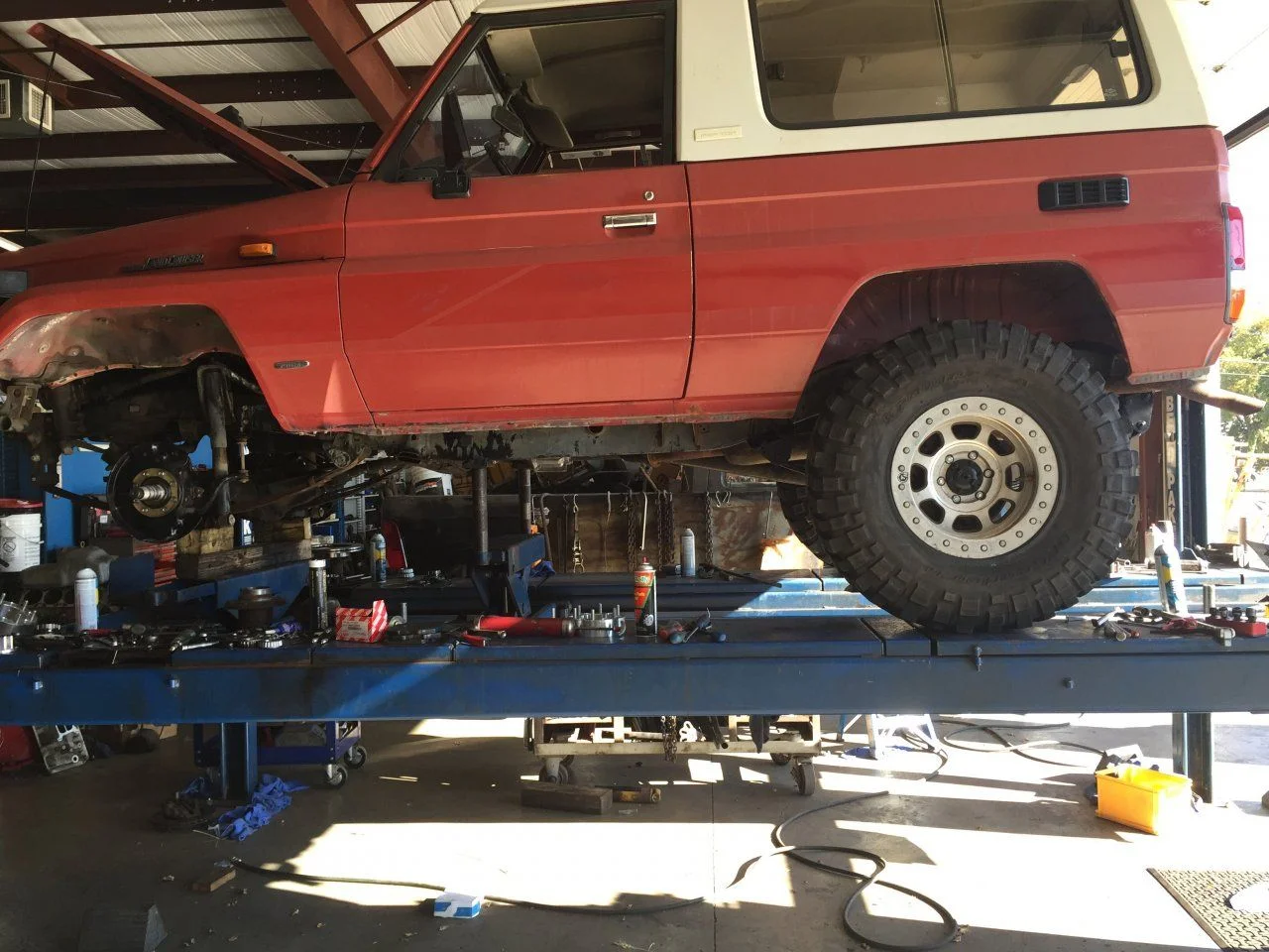

No full truck picture? Come on, you're holding out on us!
No room.....truck waiting on my junk to move is patiently parked closely, in next bay. Kinda saying "move your chit"....it being a work truck, a tinge of guilt, since my piss poor planning has led to this mini-saga..... prolly won't feel a tinge of guilt when paying rent.

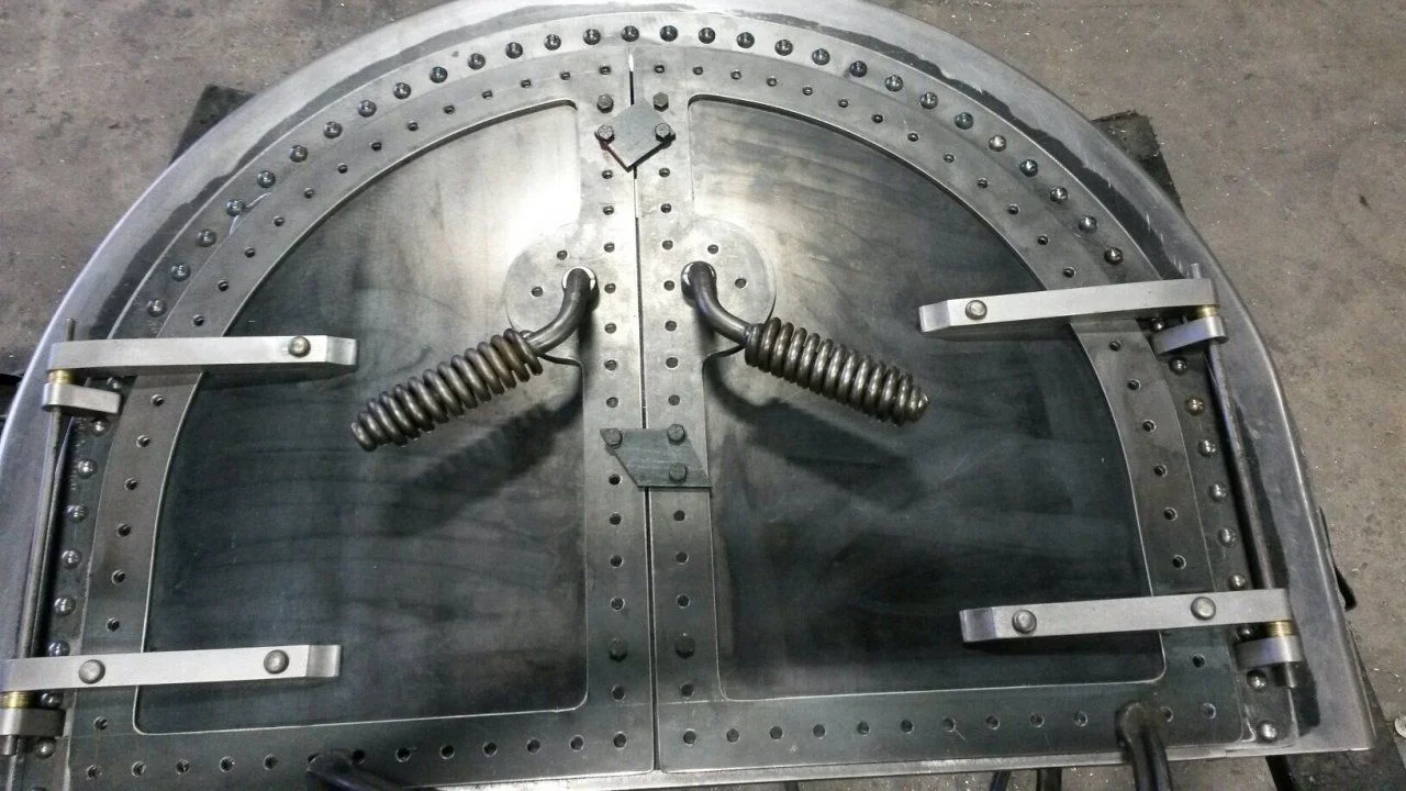

Chatted with metalangelo yesterday, checking on recovery and requesting "fix" pics. More than a little surprised with the current media, but not at all surprised with the awesomeness.
How I'd love to have a full sized set for the dungeon....
Bumped until next year and not at all disappointed since I've still a place in line.
Chatted with metalangelo yesterday.....
Magic takes time/patience... :)
