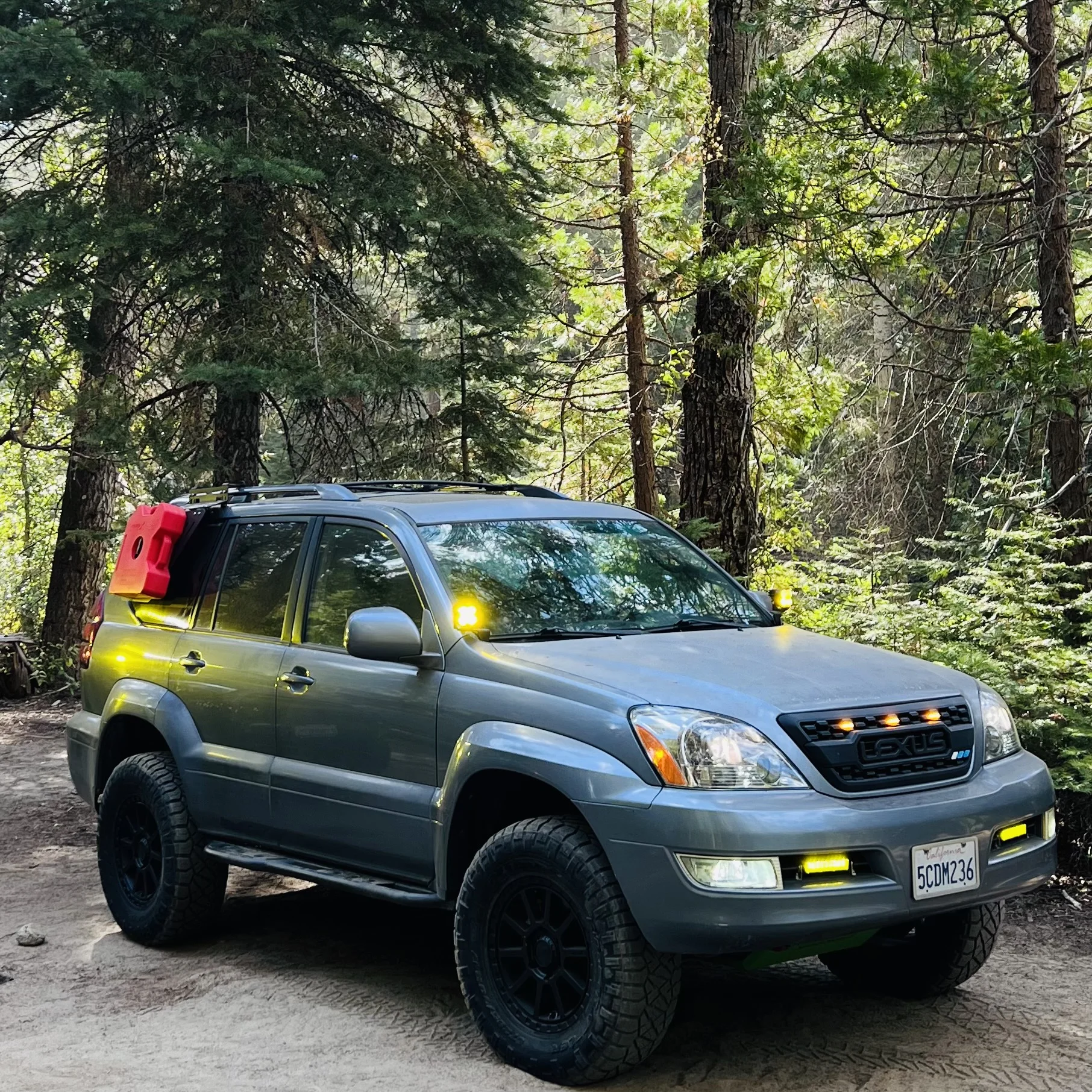

The engine is the most bulletproof component in the GX470, but it is expensive to maintain and repair.
I’ve spent over $12k in repairs and maintenance over 7.5 years of ownership including water pump, timing belt, integrated catalytic converters, tires, tie rods, LCAs, front calipers, rotors, brake pads, brake lines, radiator, alternator, fluid changes including two transmission drain and fills, windshield, etc.
However, all my parts were either Toyota, Lexus, or high quality Denso, Aisin, etc. never had a failure on the replacement parts. Knock on wood.
Plus another $11k in upgrades like 4.56 gears, 8.2” rear diff elocker, sport headlights, skid plates, sliders, rear long travel, extended front travel, Hd rear sway bar, wheels, etc.
My 2003 GX470 runs great right now, but it looks like a mild upgraded GX470.
If you don’t want to keep repairing the GX470, I would trade it into a dealer for a new car. Let the dealer sell it at auction.
