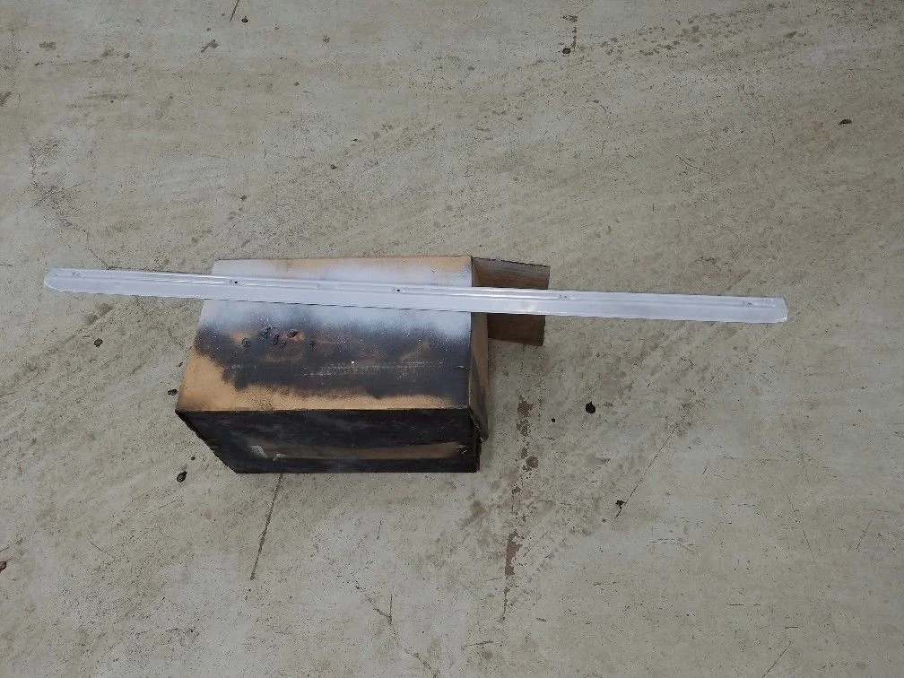

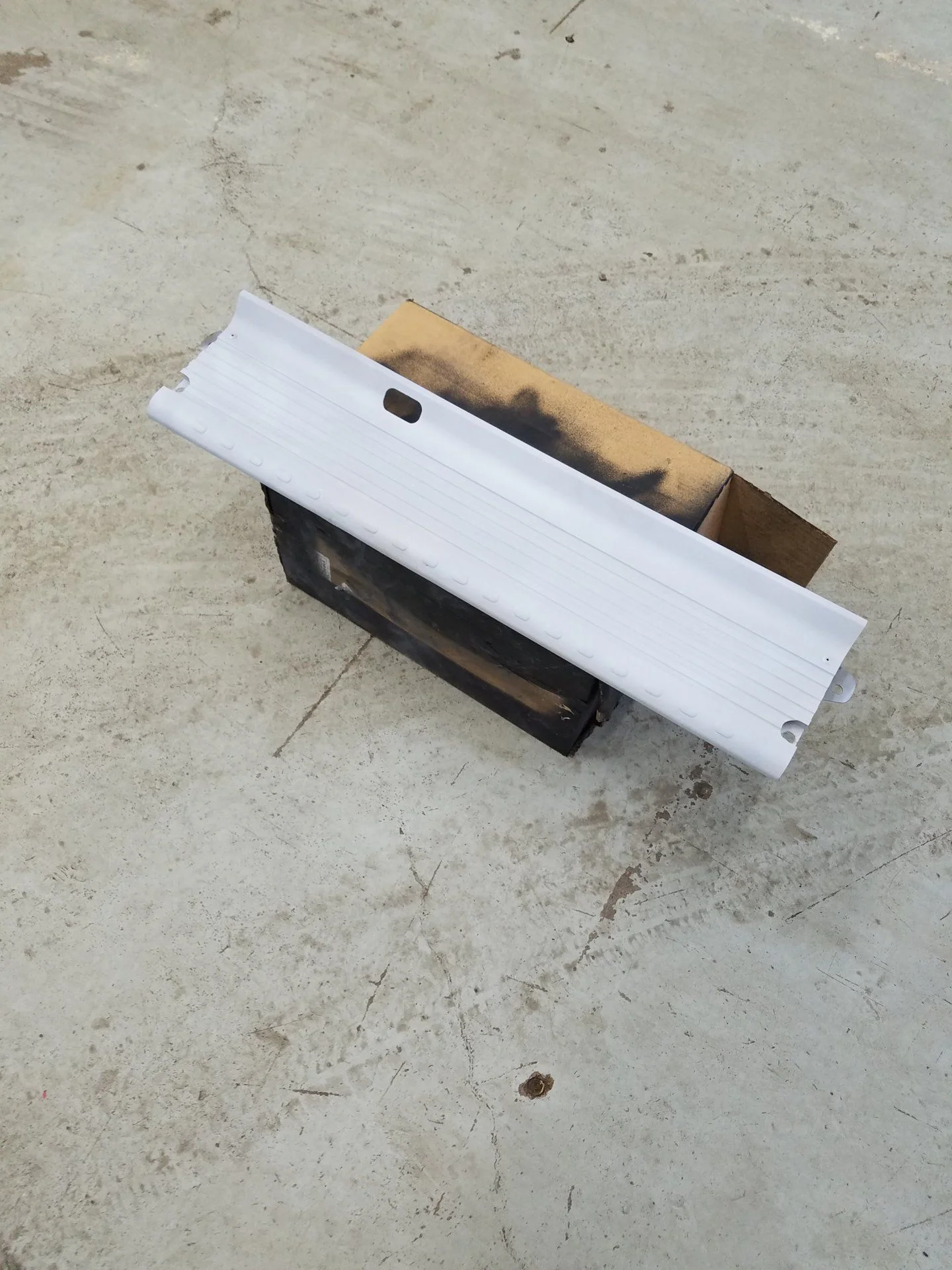

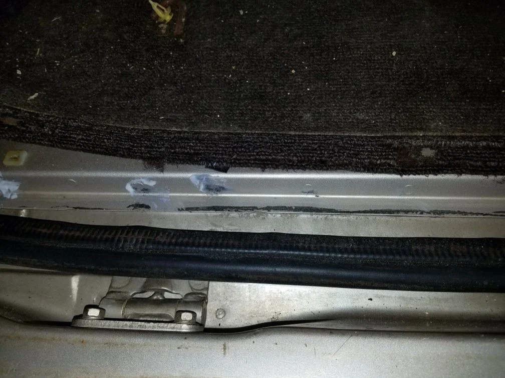

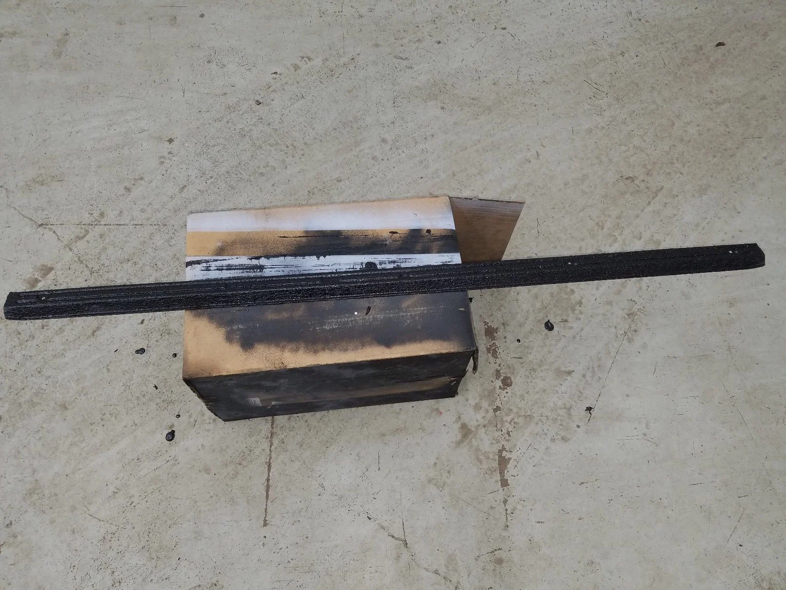

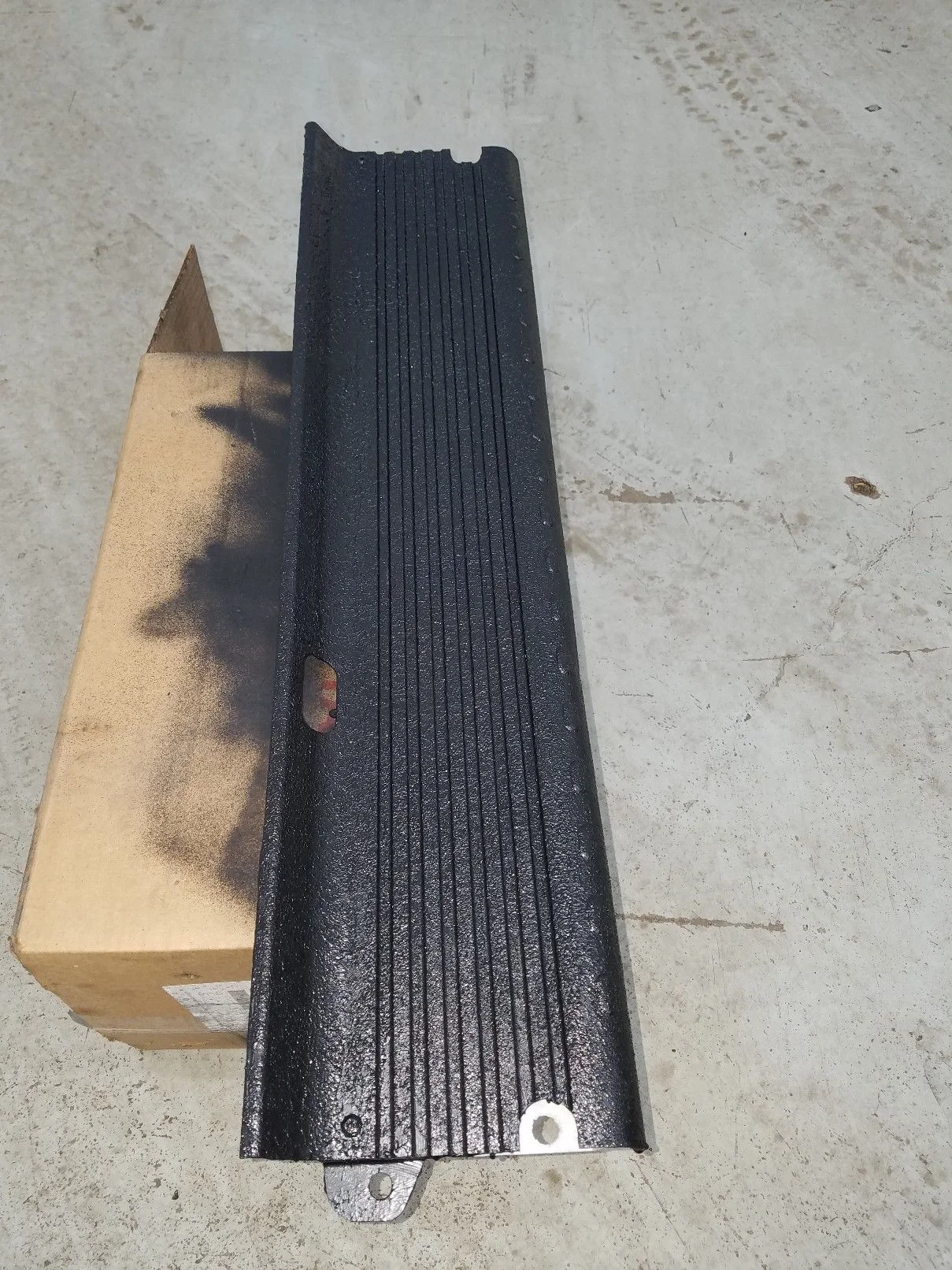

Applied bedliner to the rear step. Had a little left over so I did the tailgate/cargo sill. Found some rust under the sill so I ground it out, applied rust converter and painted over the top.

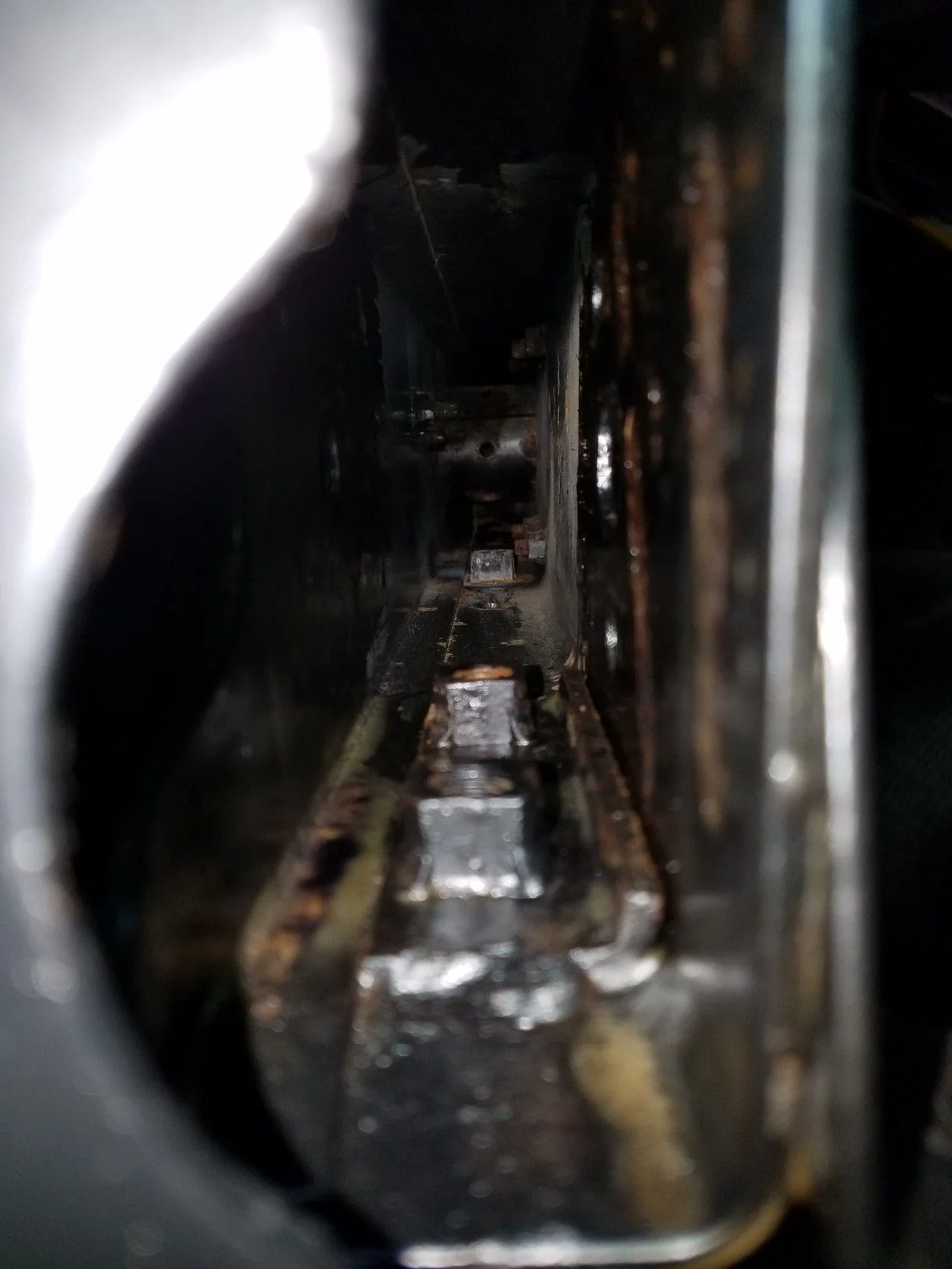

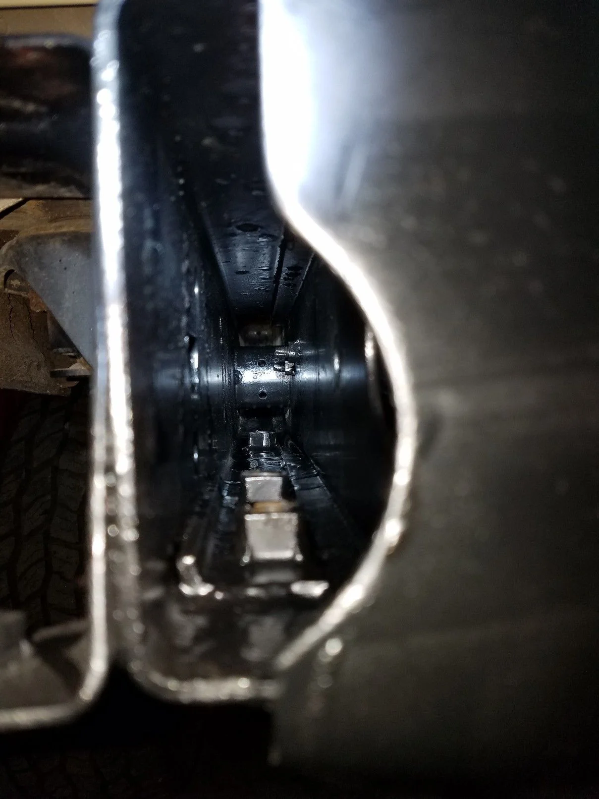

Blew out the inside of the frame rails. Then took some rust converter to the inside. After it dried I sprayed por15 into the inside of the frame rails. Before:
After:View attachment 1911547
just thought I would chime in and recommend an eastwood product for this type of application. Great stuff, goes on waxy and runs into crevaces.
That sounds like it's really good stuff. I may have to buy some of that for when I spray the inside of my rockers.

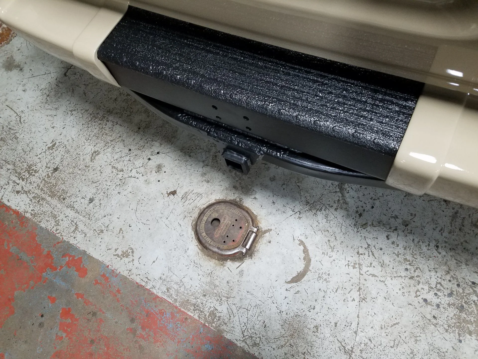

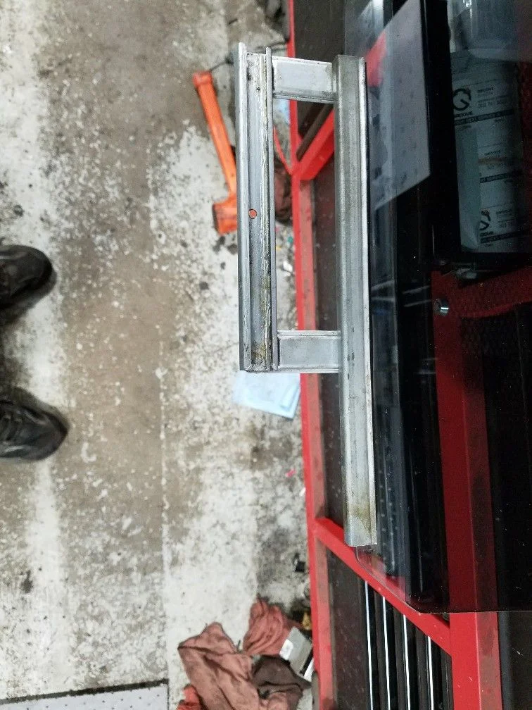

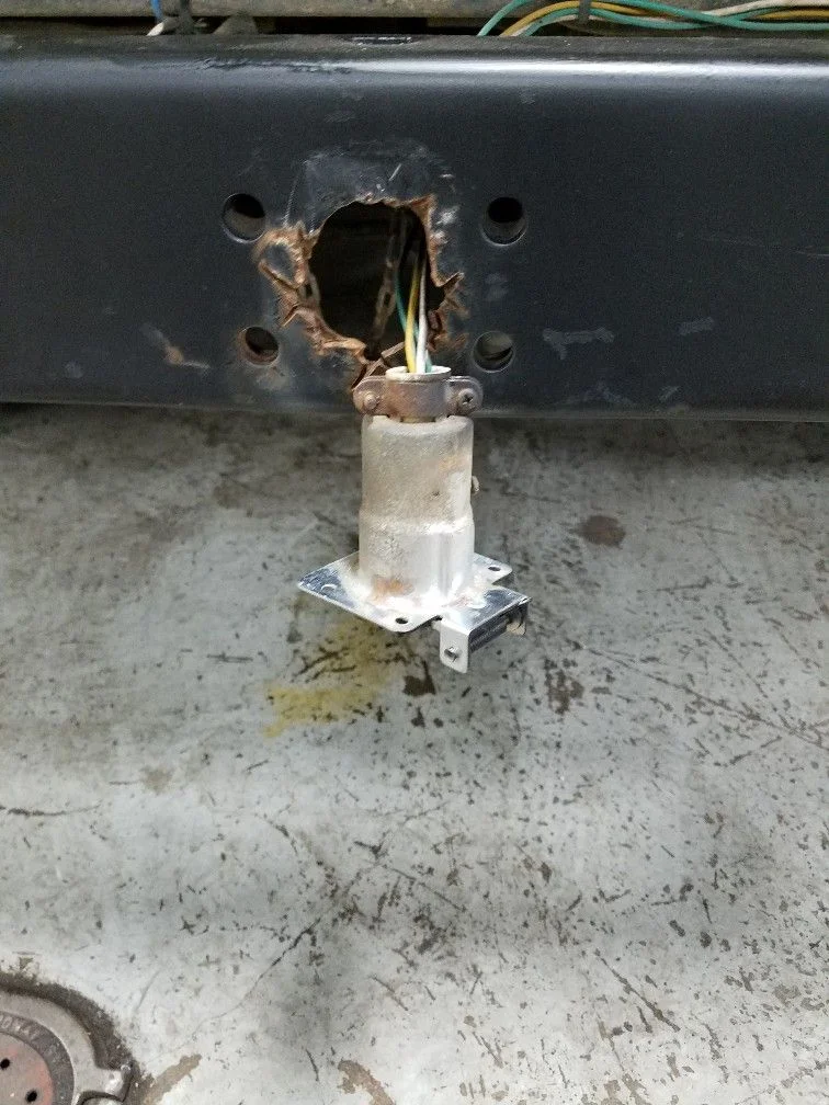

Rear bumper is all done. Cruise control is done except for lighting the factory cruise light and wiring a relay for the led brake bulbs. Was able to use the factory stalk which was something I really wanted to use. I also welded up the crossmember hole that was fairly chopped up.

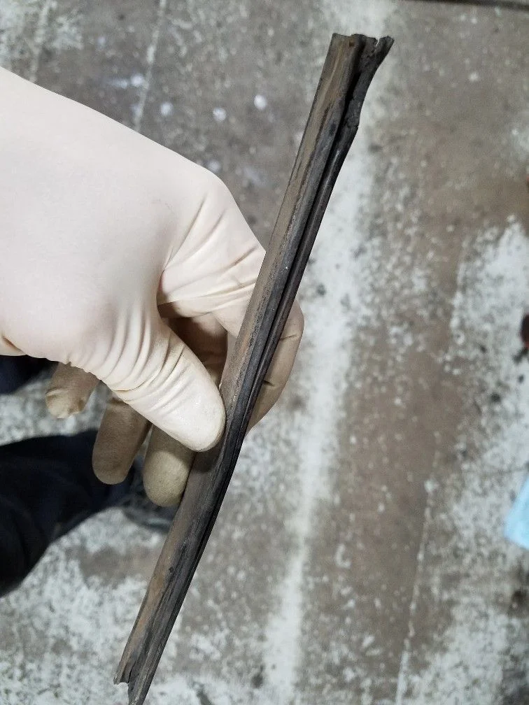

Put one of the rear door windows back in. The rubber that grabs the glass for the regulator was shot. Installed new, disassembled regulator, cleaned motor comutator, greased, cleaned out window run.

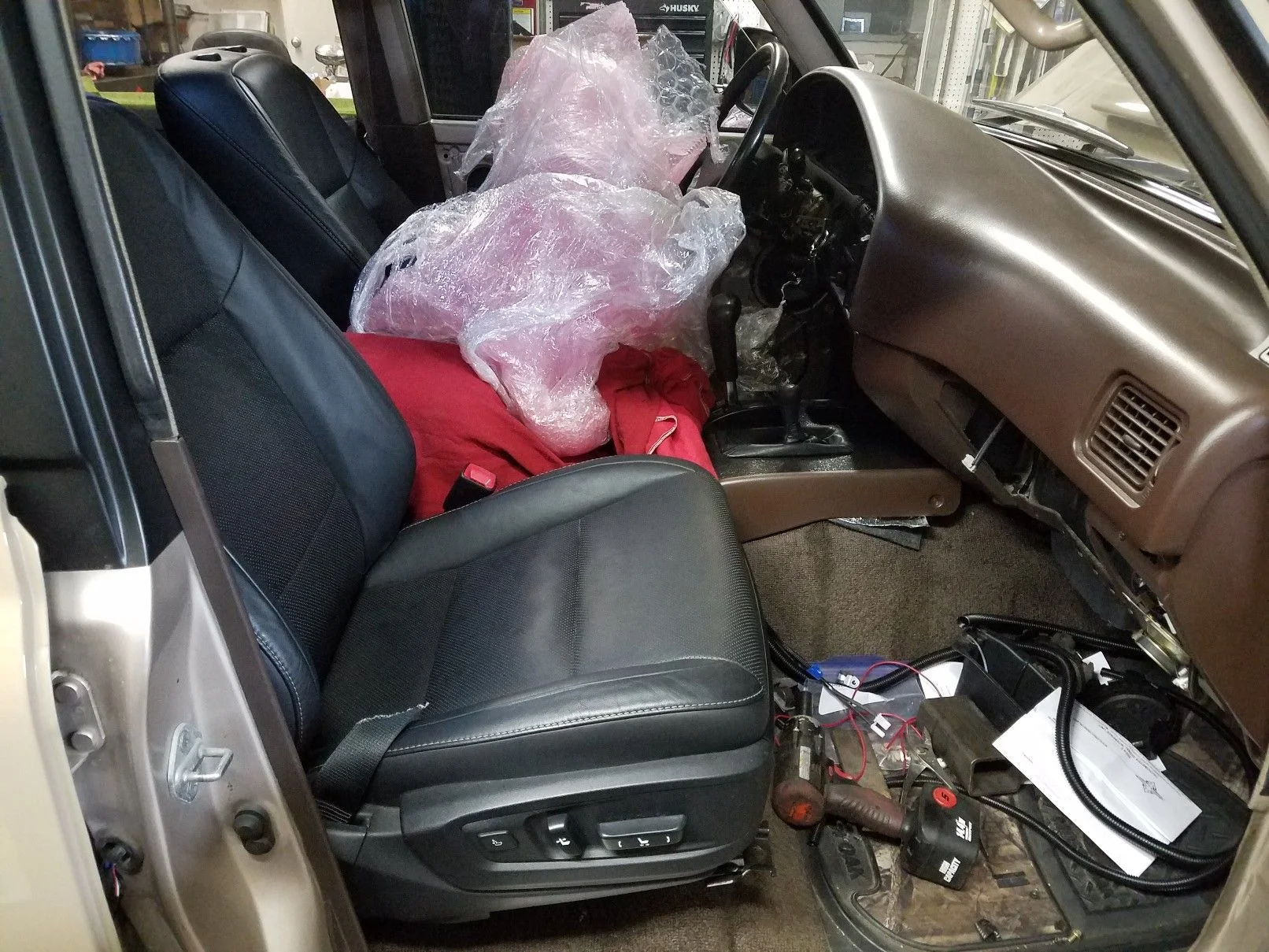

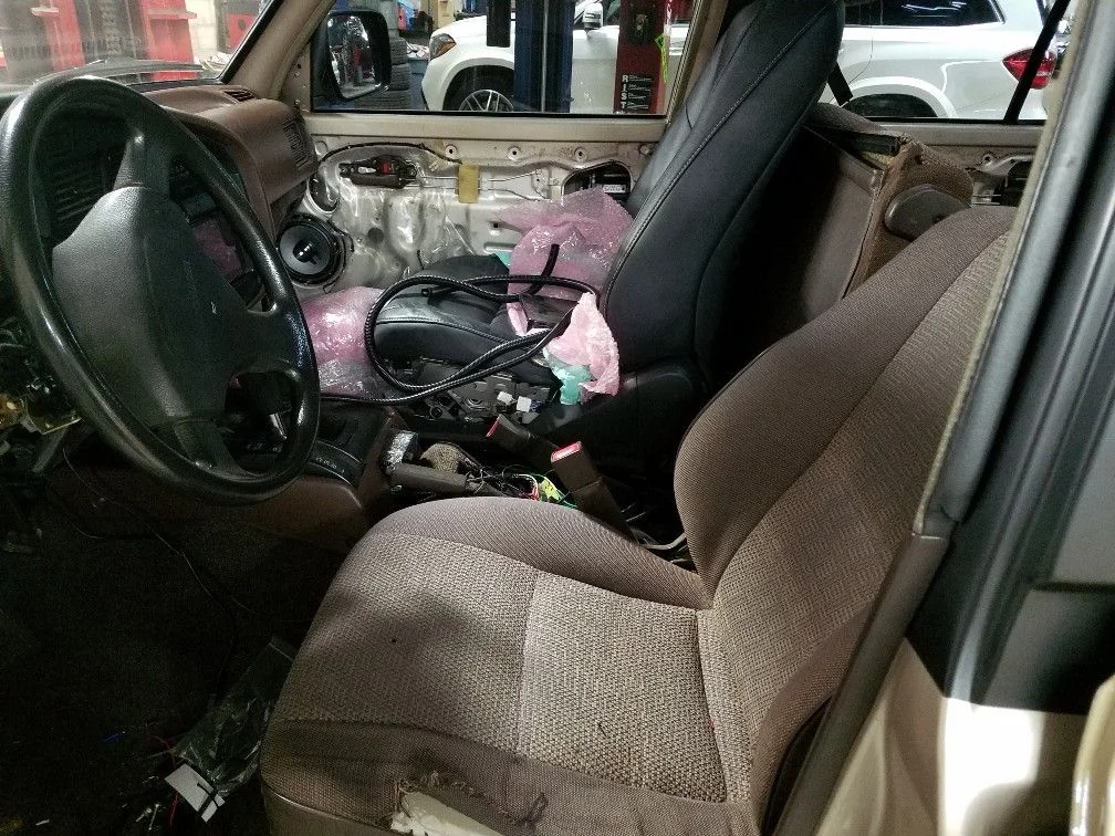

This weekend going to fab seat mounts. Drove truck around, im enjoying it. The stock suspension rides great. Cruise control is working great.

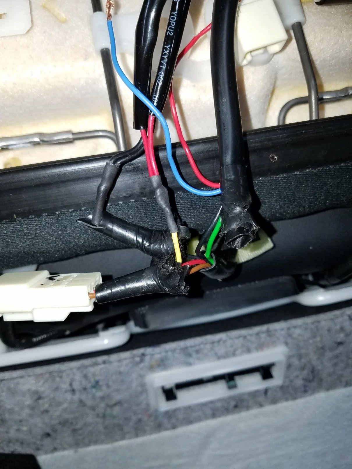

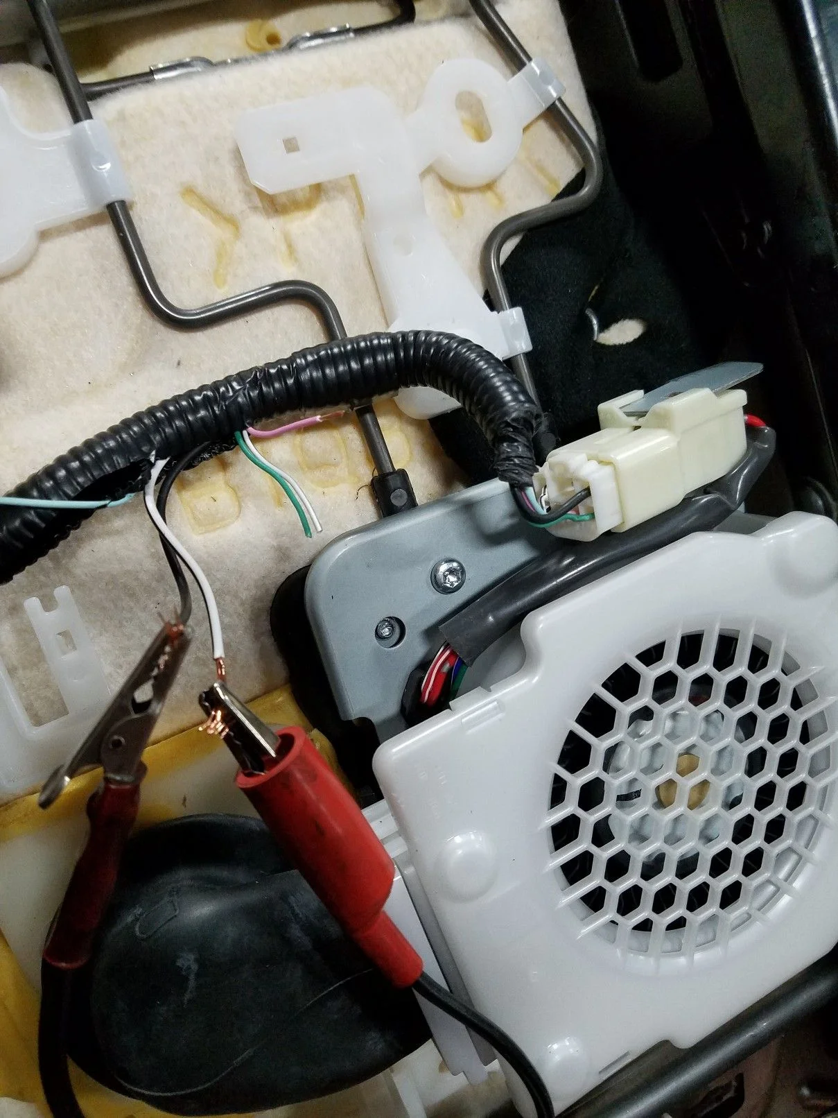

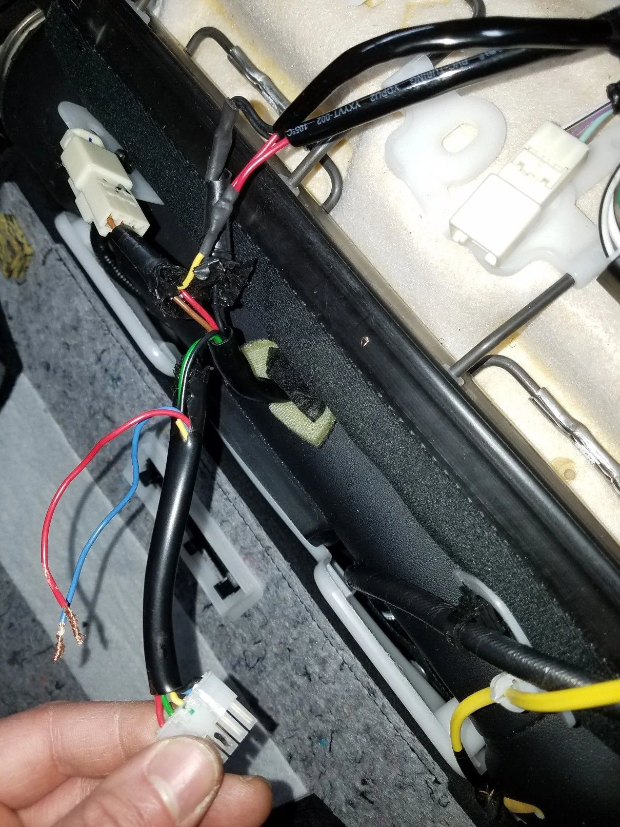

For seat back cooler they are the little wires, green and pink go together to red from switch. White with black stripe goes to black from switch.
For the bottom cushion blower motor pink and black go together to red switch wire. White with black stripe to black switch. Pink is signal wire for both blowers.
What are those seats out of?
Yes it is. Back seats are black too.
I'm liking the black seats in there. I just picked up some black leather seats out of a BMW 528 and I was wondering how they would look in my interior. My rear seat will stay stock though so I might still find some seat covers.
