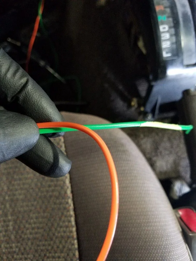

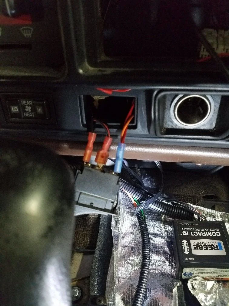

Heated/cooled switch illumination spliced into aux light switch here. Wire is orange.

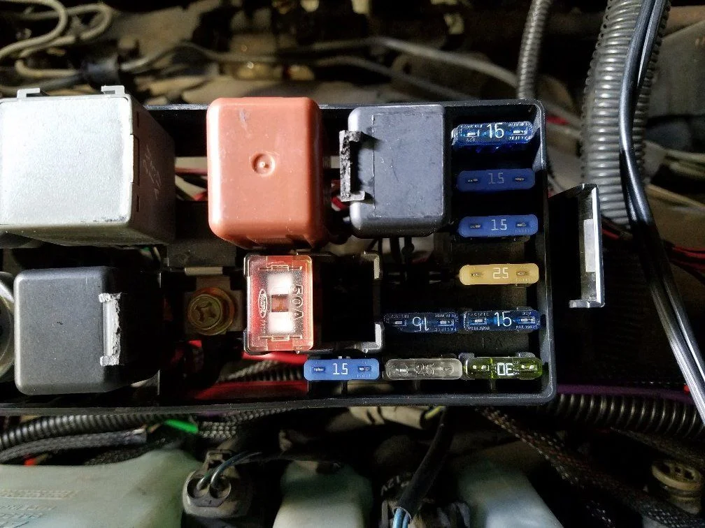

Orange wire from seat heaters/coolers spliced into under dash fuse block rear heater wire. Green power port wire to 15 amp fuse added in engine compartment fuse block.
Rear power ports go to 15 amp fuse on bottom left. Power seats go to 25 amp fuse at mid right.

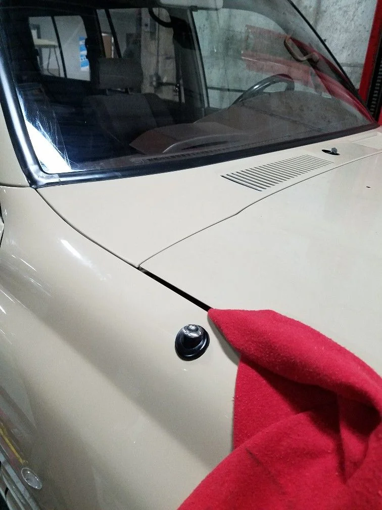

Anyway I made some progress on the 80. Got the windshield put in, cowl, and power antenna. I noticed the power antenna cable grommet to the cabin was trashed. Suspecting this could be a water leak, I installed a new grommet. It was hard to teach for sure. Wish I did it when the dash was out.

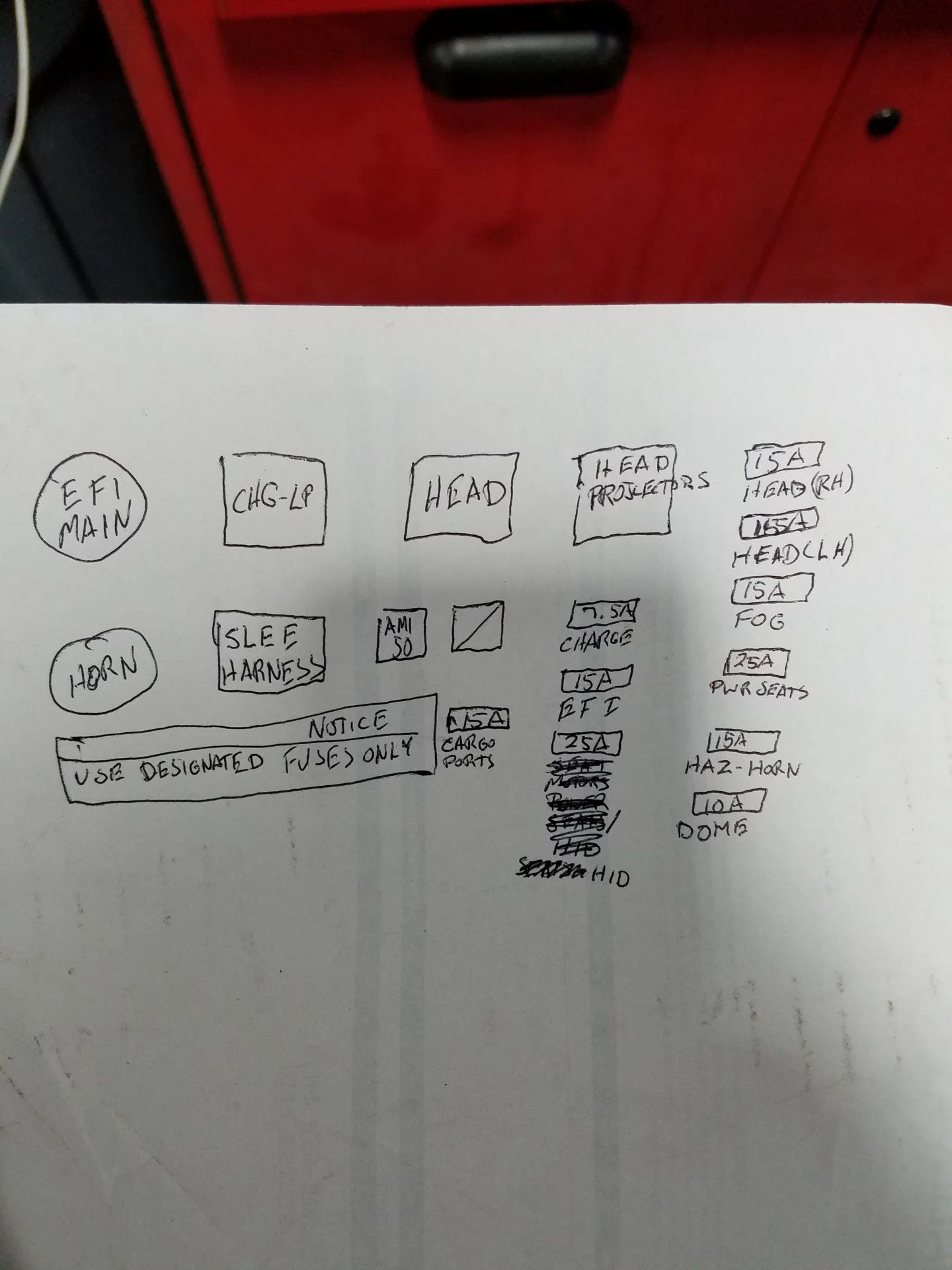

The overall dimensions of the fuse label is 6 1/8" x 2 3/4". Black background with white letters and pictures. Hopefully the label will be pretty durable as it will get fairly hot in the engine bay. Change CDS FAN to read SLEE HARNESS and change the shape of it from round to square similar to the HEAD and CHG-LP relay image since I changed to a square relay. The relay next to the HEAD relay needs to read as HEAD PROJECTORS. For fuses going from left to right of the ones changed from the factory image are: 15A CARGO PORT, 25A HID, 15A FOG, 25A PWR SEATS. Sorry my drawing is so crappy and stuff isn't lined up too well but hopefully you get the idea.

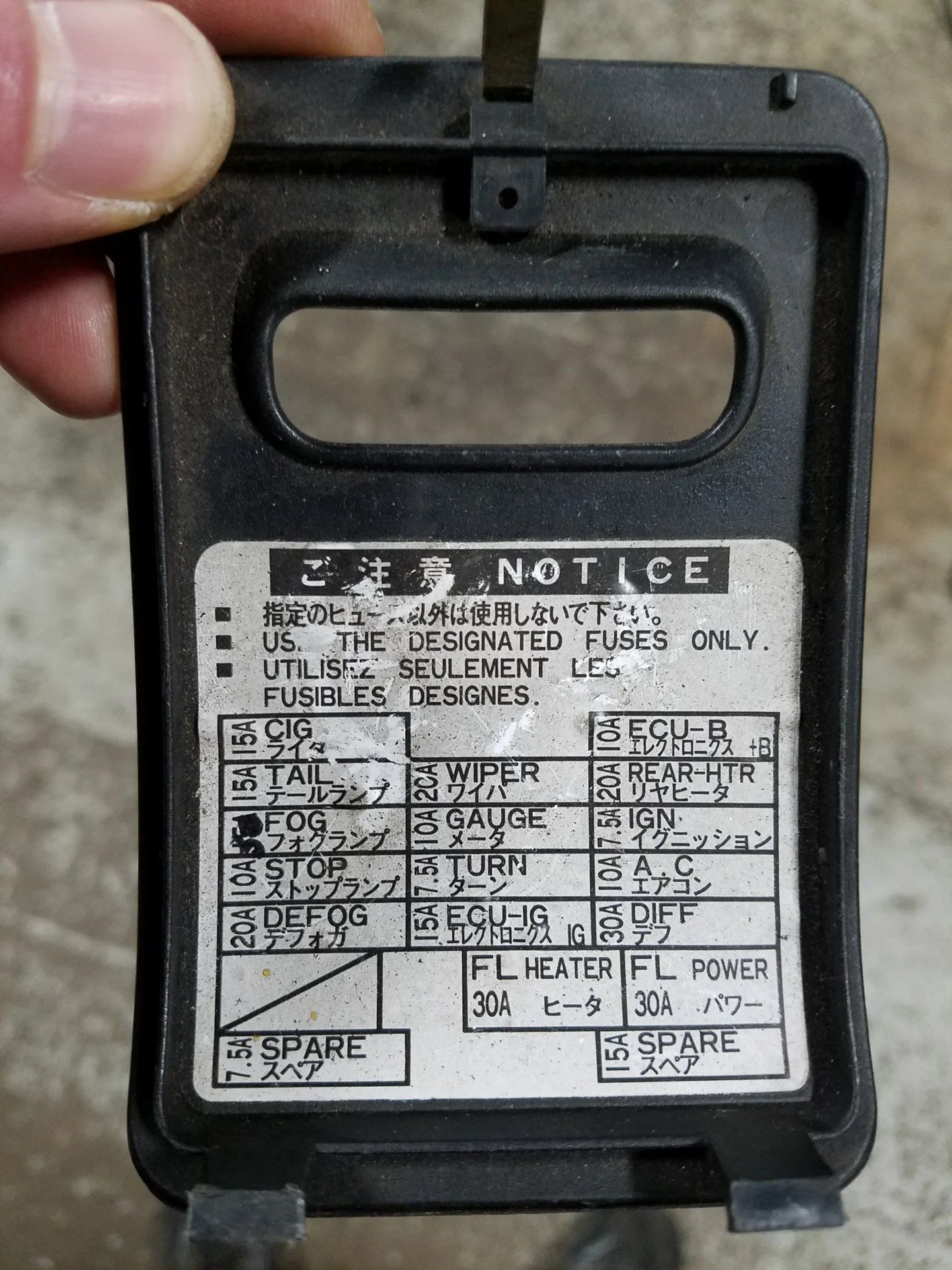

For the under dash fuse box label the dimensions are 2 3/8" tall x 2 1/2" wide white background with black letters. I just need FOG changed to 30A LOCKER.
