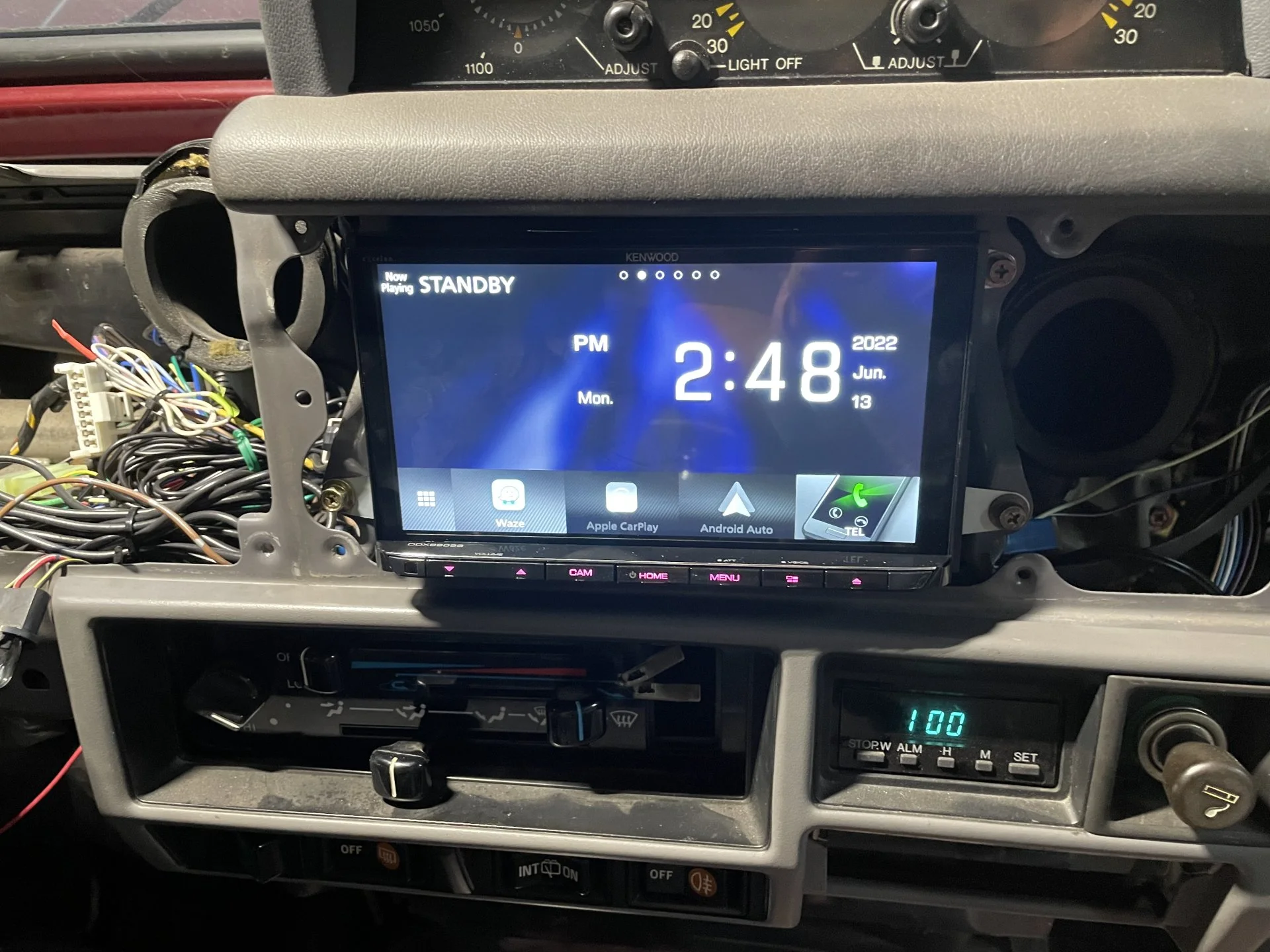

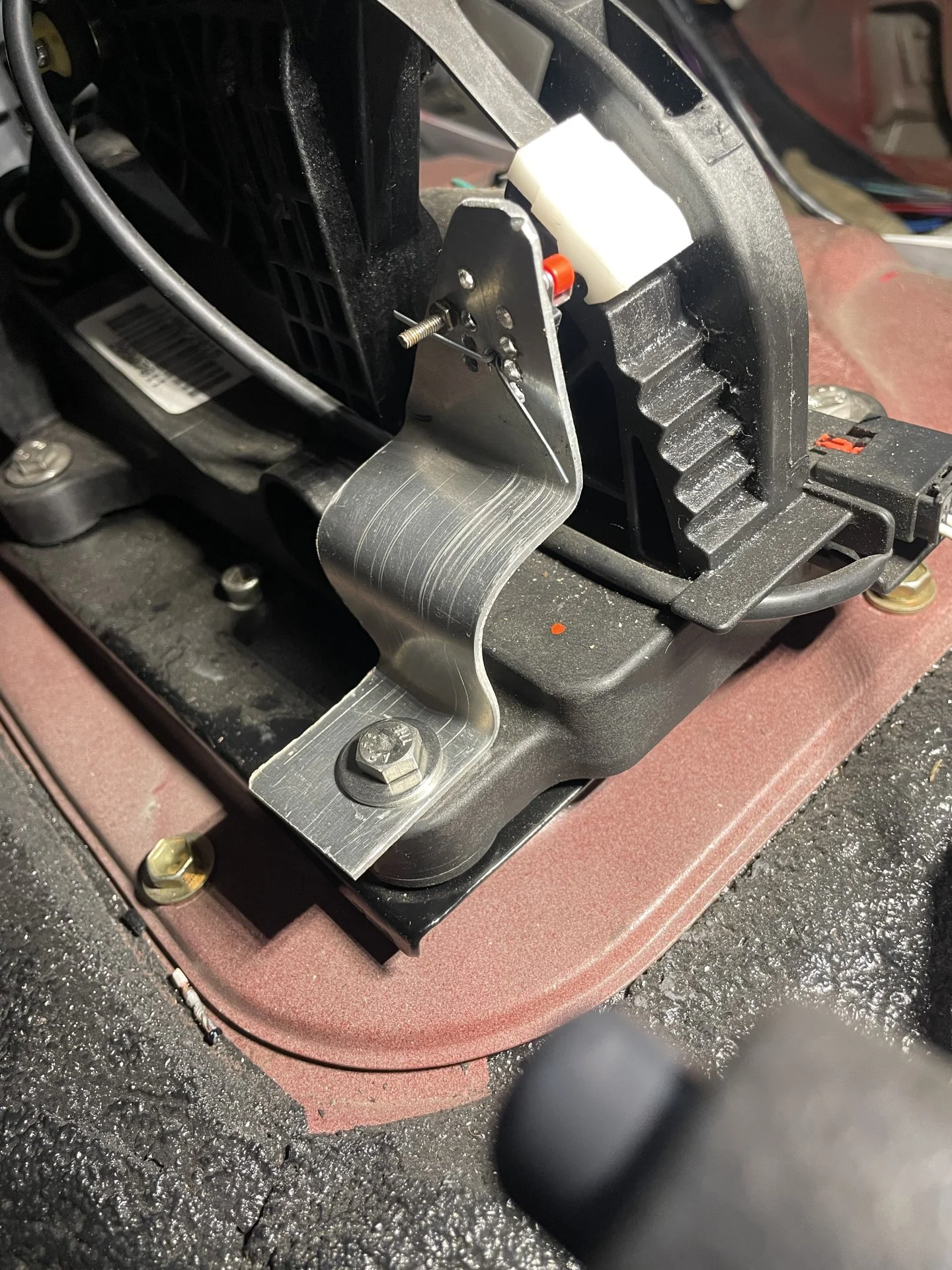

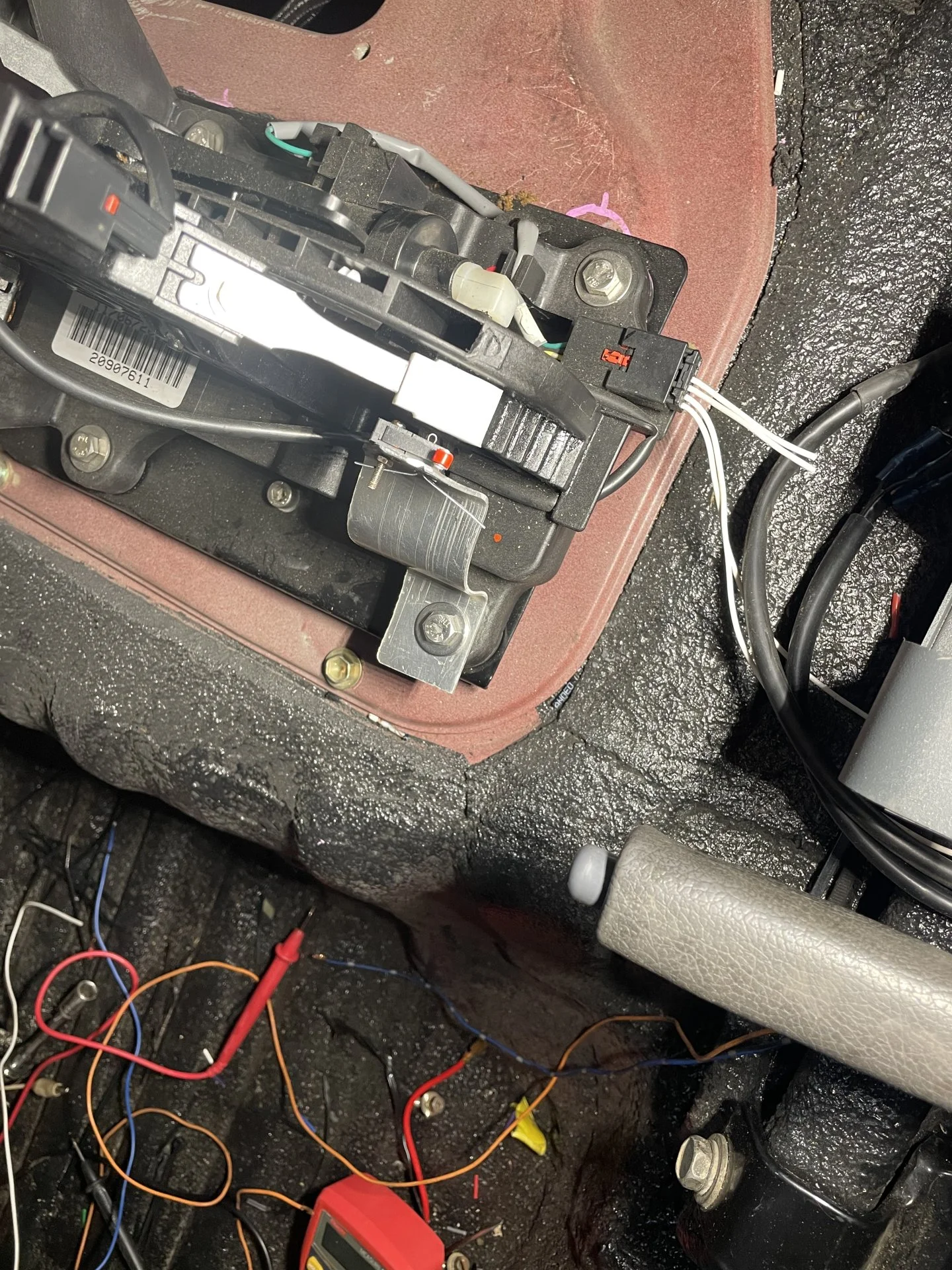

Been getting a lot of little wiring stuff done… radio in, and made a bracket for microswitch to turn on the reverse lights. My son is 3-D printed a piece to be glued to the white portion of that indicator that will engage the microswitch.

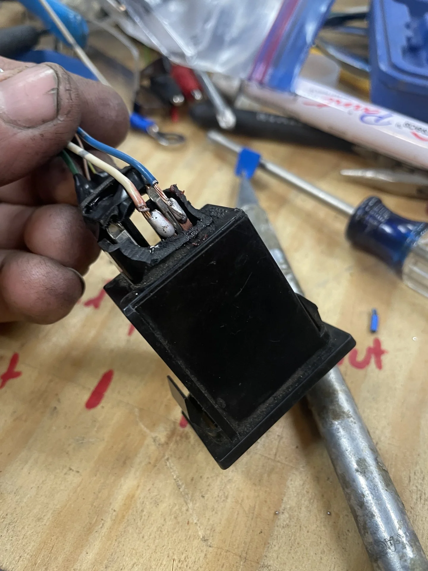

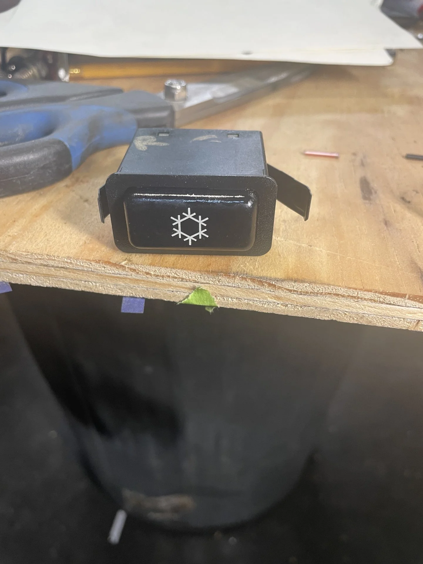

Then there was this simple little task…. The air conditioning switch would stick on so I took it apart to figure out what was causing the issue and as I did a little part flew across my shop with the spring…. That will never be found!!
So I took apart a rear defrost switch out of a 80 series that is similar sized, ground off the face and glued the original 73 series a/c face on.
Worked perfectly until I realized that it was a quarter inch too long to fit in the slot so had to remove the connection grind it down and solder on some wires.
Check out @Will Van's build, and his solution for his AC switch ;) Pretty clean.

Yes, I saw that last week. I really liked the existing button, so was trying to keep it... but similar idea to use new toyota button to make it work.

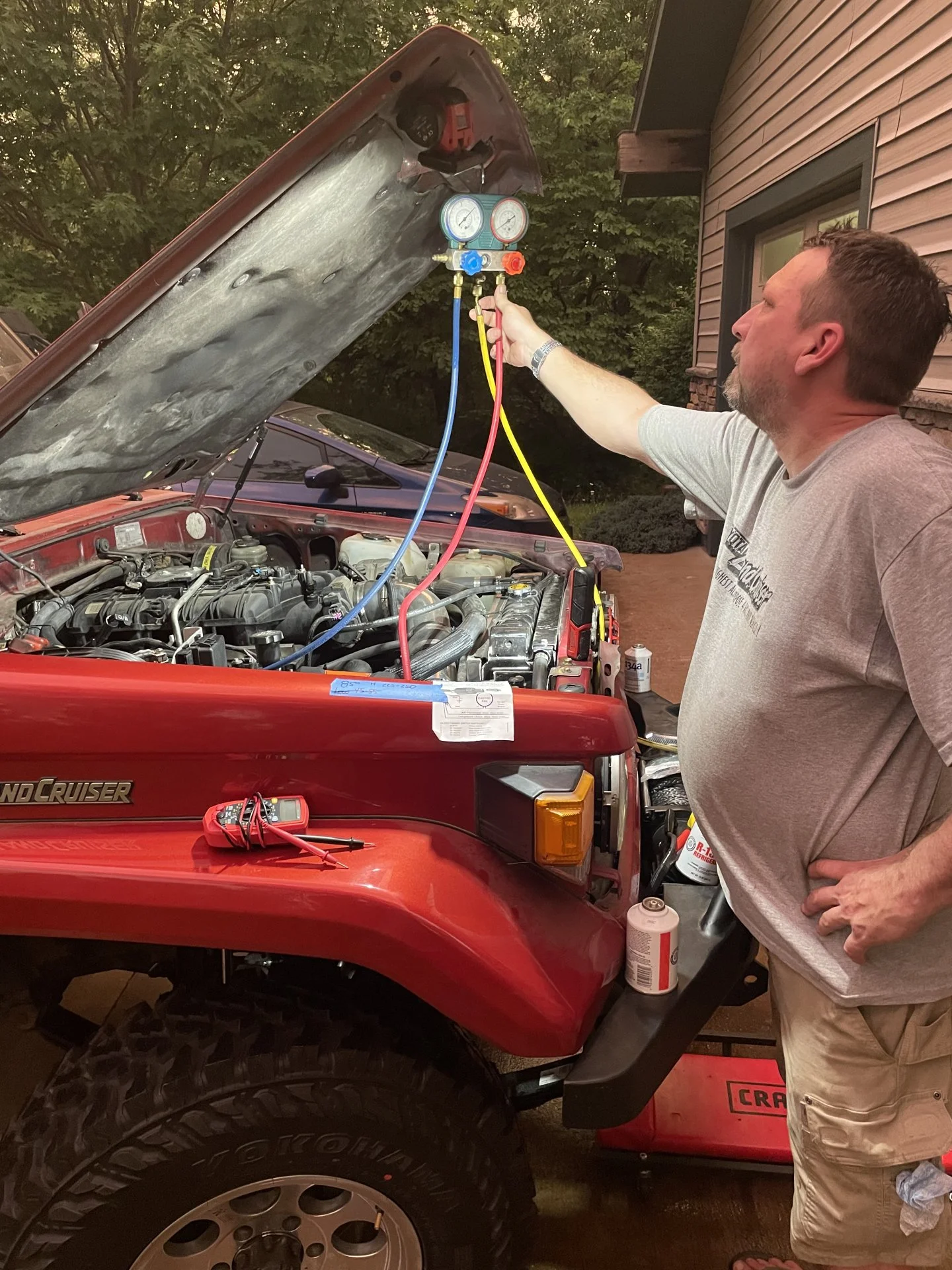

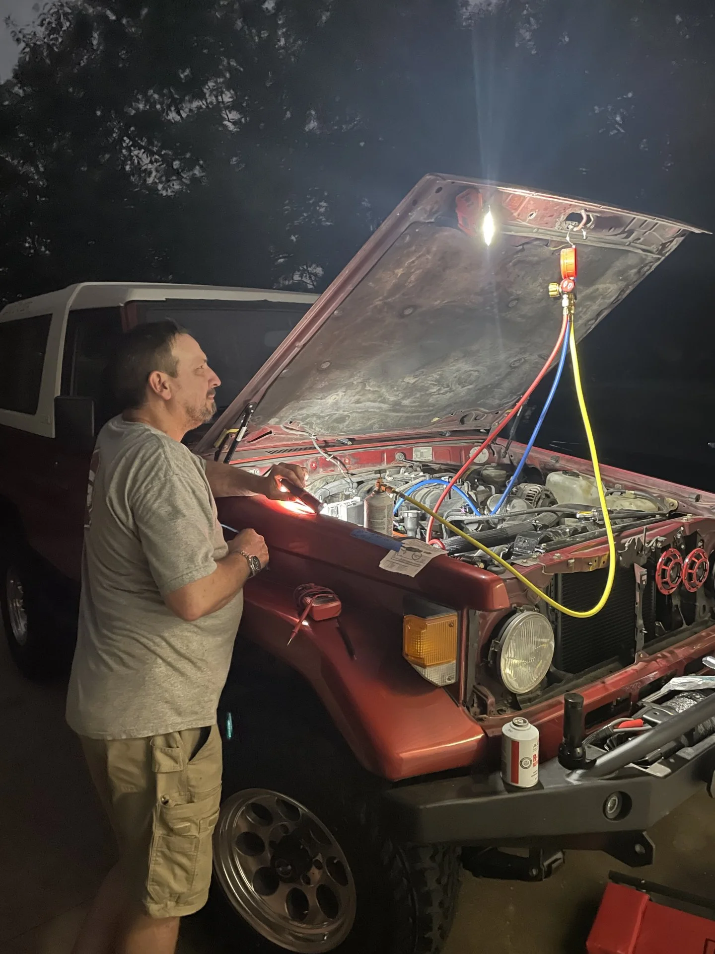

Real time …. @tornadoalleycruiser is here charging a/c. Made all custom lines tonight too.

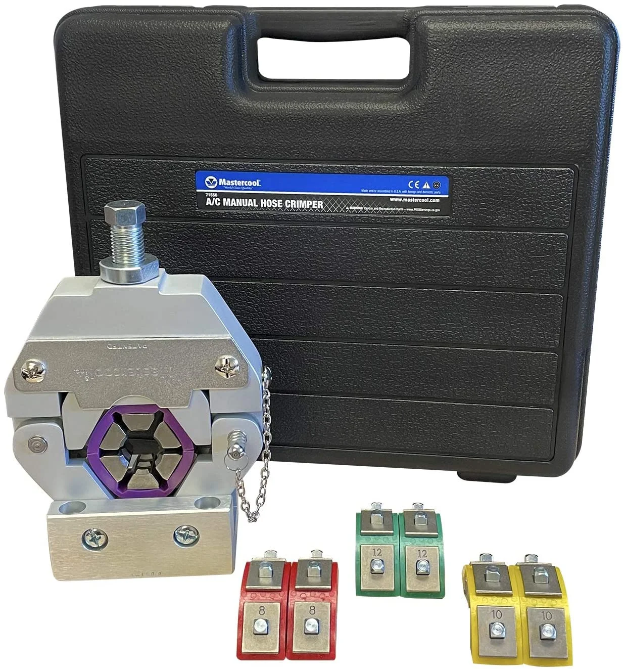

I hope it all works out for you. I bought generic line sets/fittings on Amazon and it ended up being too cheap made in China without enough depth on the barb fittings to make a seal............many carquest and Napa auto parts stores are able to crimp fittings. Old experienced guys can crimp an AC fitting with a hydraulic fitting crimper and get it right. I have good cold reliable AC now and am happy with it! good luck.
We bought all our fittings from the same place I got my hurricane air setup, old air products. Prices are pretty good, about $6 a fitting, and quality is great.
Charged up great last night, will see if it holds....
Used a Mastercool crimper instead of waiting for someone else to screw up the fittings for us.. easier to screw em up ourselves.. Went well.. Easier than trying to find someone to crimp for us and wasting a day running around. once i figured out i had my valve set with me it went much easier. For some reason Kelly's valve setup was reading weird.

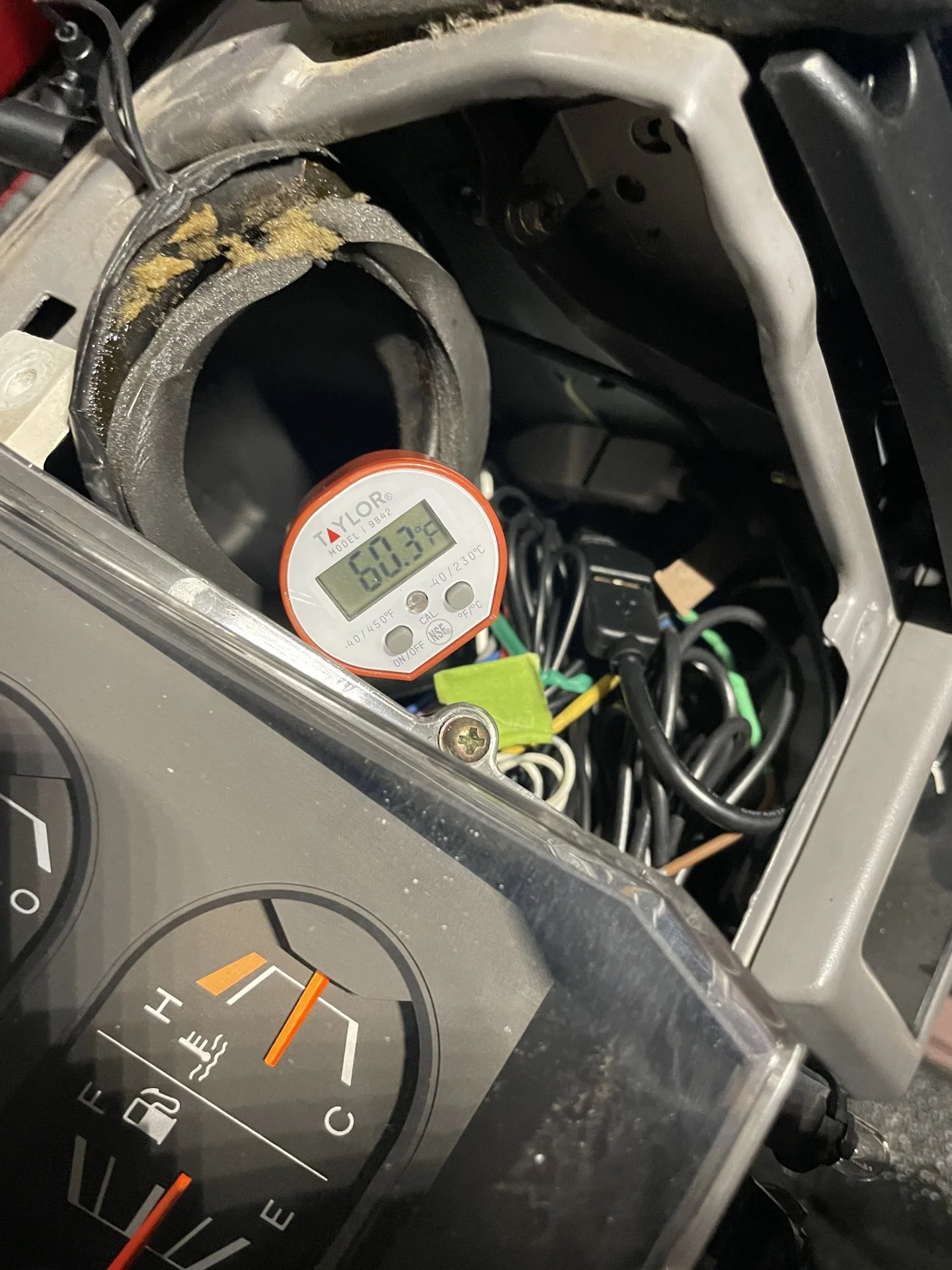

@2fpower 's truck has old Flare fitting style at the firewall (expansion valve and evaporator) and everything else converted to newer O-ring fitting. New dryer, trinary switch, new condenser etc. added a little UV dye to the system for diagnostics. Once the dash is back together it should be ready for a lot of test drives to work out the little bugs. if it needs more work we will find a new expansion valve. I really wanted to install one but not an option for now. I think on recycle it was reading 43? when we were finished for the evening. Didn't get the low and high pressures quite where i wanted them but it was functioning correctly.
Same kit we use. It works well.
