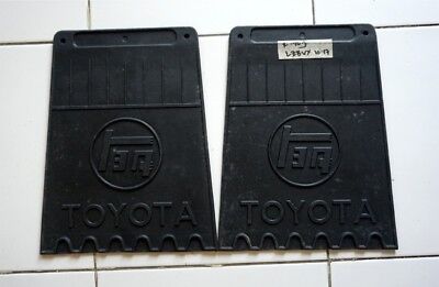

Got the bumper done. I wanted to add some really flexible easy to remove mudflaps.. My 4x4 labs bumper on my 80 gets full of mud flying off the tire and basically blasted by rocks, so this is my new solution....
I found these on ebay.. Should be perfect.
