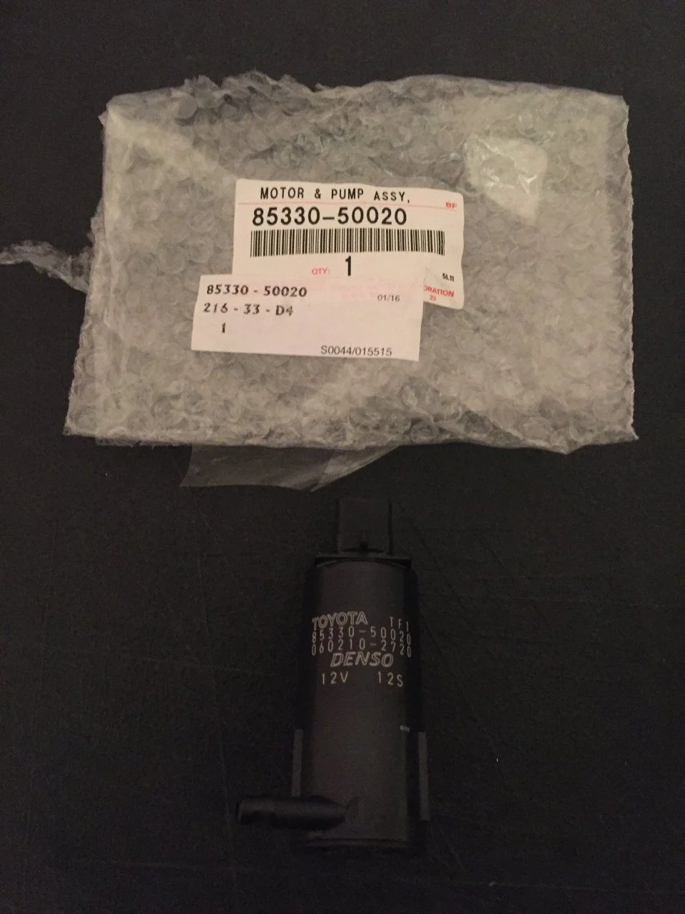

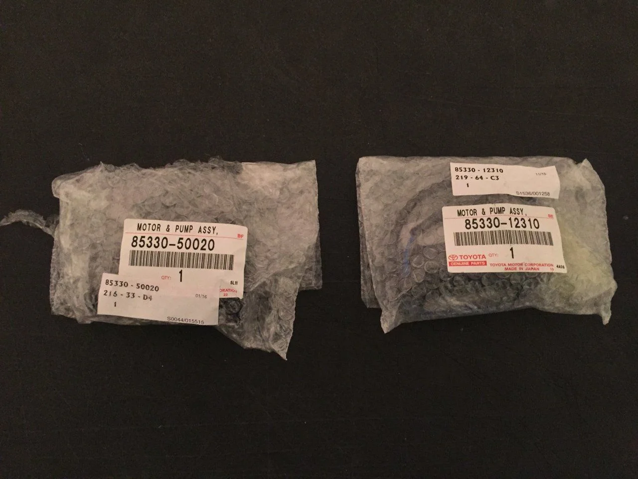

Received the 62 pump and here is the informatioN between the 62 pump and the now discontinued 60 pump:
62 pump on left, 60 on right:

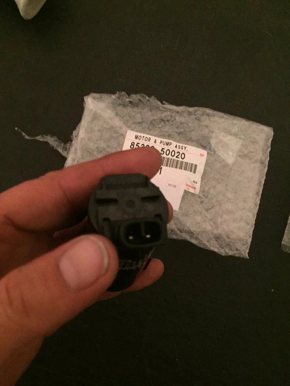

As stated, 62 pump is still available. Body of the pump is almost exactly identical but the electrical connection is different.
The harness side of a 60 would need to be adapted with a connector from a 62 setup and then I think the 62 pump can be used.
If anyone with a 62 can check for me to see if the harness side connector has a 5 digit number embossed on it that would then correspond with a 10 digit toyota part number.
That way 60 owners could modify their harness to accept a 62 pump with a new electrical connector and 2 splices.
