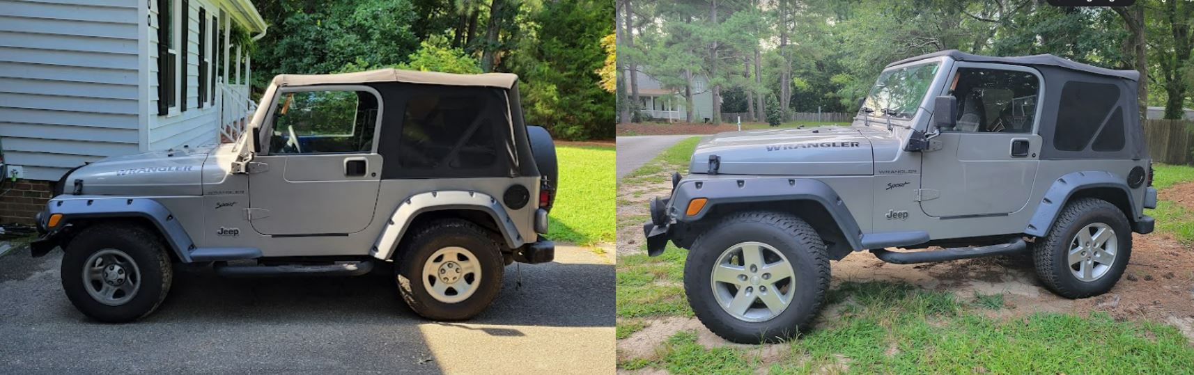

A small spacer lift to accommodate the tires. I didn't realize the 265/70/R17 would be so much bigger than the 31x10.5x15; certainly seemed a lot more than .63". Also used some wheel adaptors to fit the JK wheels (5x5) on the TJ hubs (5x4.5)

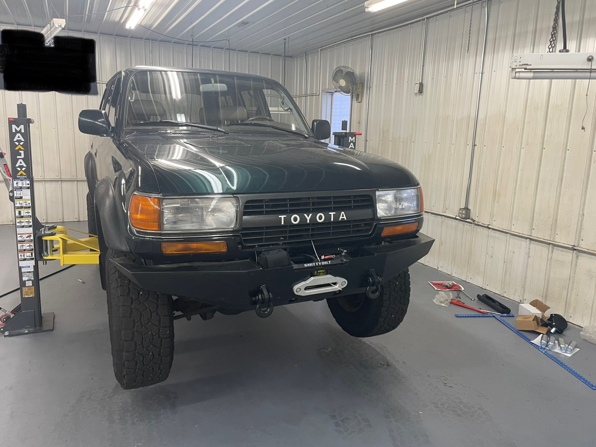

Finished up the little details and adjustments to complete my lift installation and did a successful first lift. The ceilings are only 10’ so I went with a “low profile lift”. I have enough room to lift the 80 series to the max height of the safety catches and still have 6-8” between the roof and the ceiling lights. Full lift gives about 50ish inches from the floor to the bottom of the frame rails…not enough to walk under, but no more hunching over or sitting on the floor to work on brakes/axles etc.

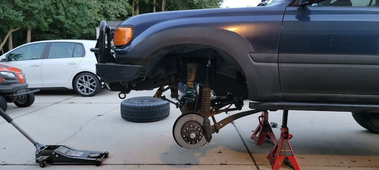

3.5" Dobinson VT coils lifted the front of the Cruiser 5.5" with dual batteries, ARB, and 10K winch. I contacted Dobinson and they asked for coil specs to make sure everything was correct. Wire diameter is 16mm and free height is 605 to 610mm depending on where it's measured. Everything checks out according to them so I debating whether to cut springs or look at other options. The Cruiser drives great but offroad it feels quite tippy.
While I'm in there, I've ordered some metal spacers to drop my front swaybar another 1/2". I currently have 1 1/2" drop blocks but the swaybar is still very close to the driveshaft.
In addition, I hope to get my 70 series bump stops for the rear. They are taller and more flexible than the stumpy 80 series bump stops. I'll be able to use the new bump stops without a giant spacer.

@Catskills Is this the lift you have, and that we saw in action on that 81?
Yes. I'm replacing it and selling it before I *probably* sell my 80. The truck sits so high and driving it can be scary.
I couldn't believe how much body roll that 81 had on the trails. Definitely not an asset when it's a rock on one side and a tree on the other.
