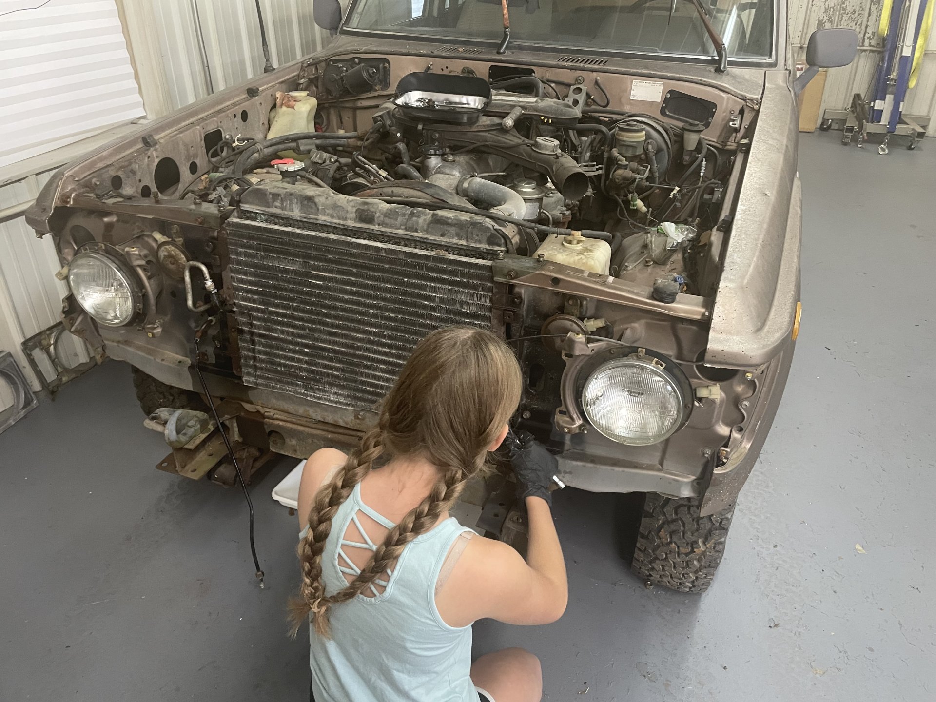

My oldest hung with me in the shop this afternoon and started work on her truck. Both our trucks were getting the front ends removed to prep for pulling the engines. Worked out well. I demonstrated on my truck and she followed along on hers. She caught on quick and got everything stripped away from around the engine. Didn’t get pics of the final product because we were both covered in PB Blaster and rusty grime…just wanted a shower and some dinner.

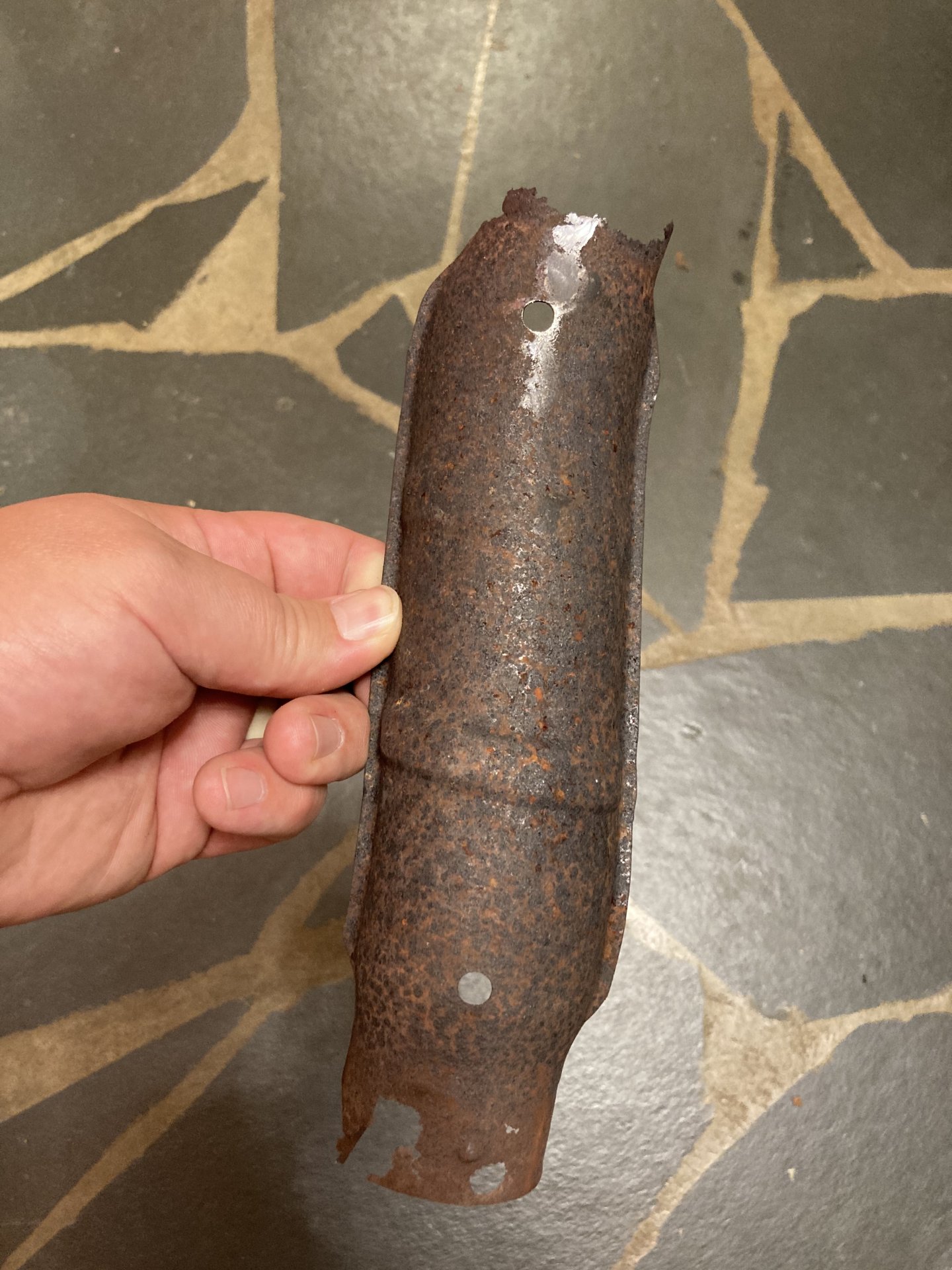

Hard to say from recording
First is starter
Second sounds like a loose mount or bad bushing allowing something to rattle or rub
Thanks - yeah, second sound seems so similar to that tinny flywheel grind, but I can't figure out how something other than starter would be contacting it. Motor/trans mounts wouldn't change what the flywheel would contact, but I'll check them out and see if something else is rattling down there.
Only happens when engine is still cold and accelerating from stop. Changes with throttle input intensity, goes away when you pull foot off the gas. I had a beater 100 series a few years ago with 320k, and it made the same sound in the same situation.
Heat shields on the exhaust probably have broken tabs. Wrap long worm drive clamps over them. Tighten till they strip and back them off a quarter turn.
