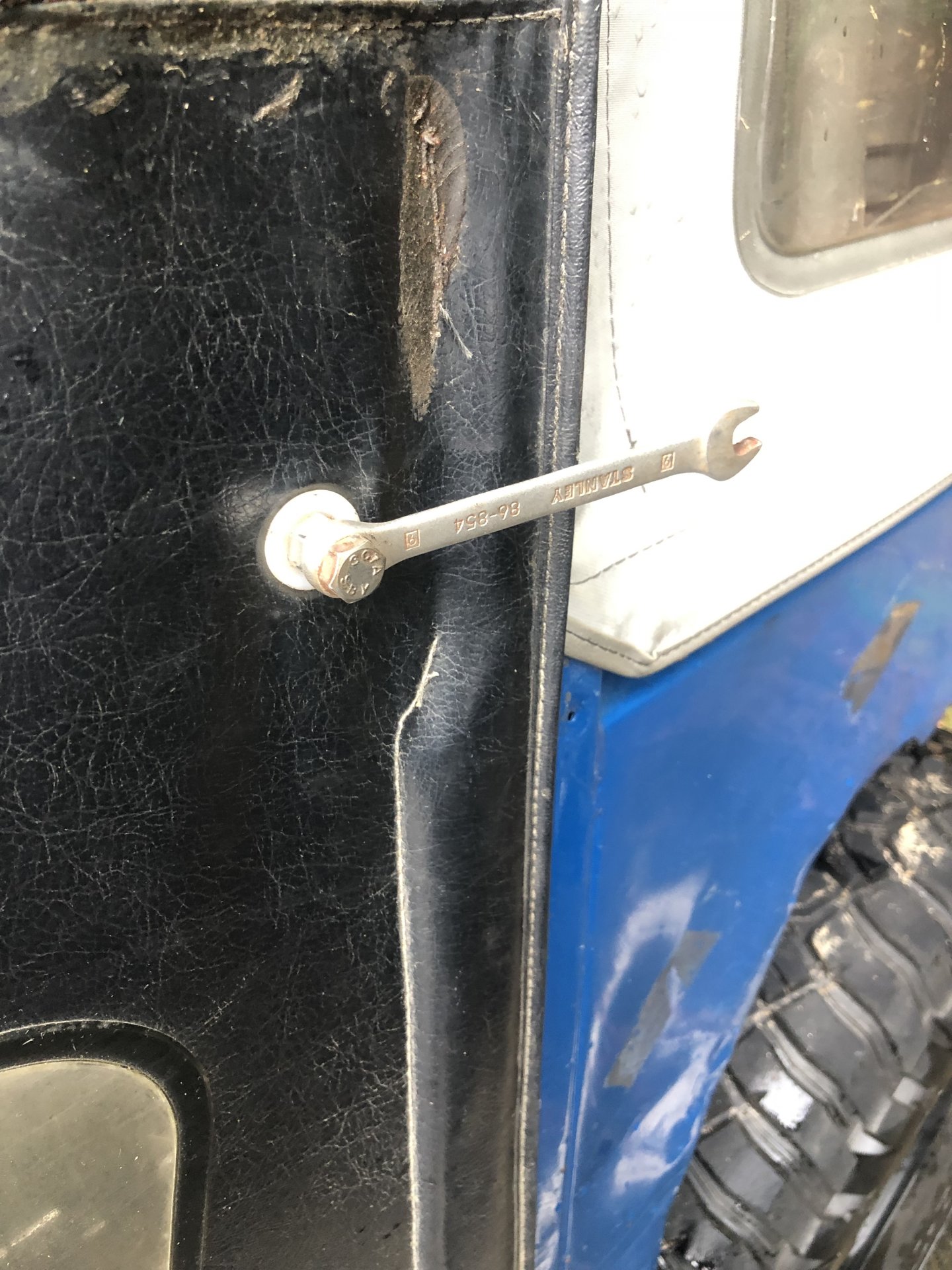

I present, the pinnacle of the redneck engineering I’ve done in my apartment parking lot in Clemson. Made only from the finest scavenged goods. Cheap angle iron I found 2 years ago in a trash pile on campus. Wrenches I found in a tool bag on the side of the road in the mountains. And nuts and bolts provided by the SC DOT street sign department. And now I can use my half doors!
And yes I filed down the nasty edge from my grinder cut job.
Oh to be young again... kudos.

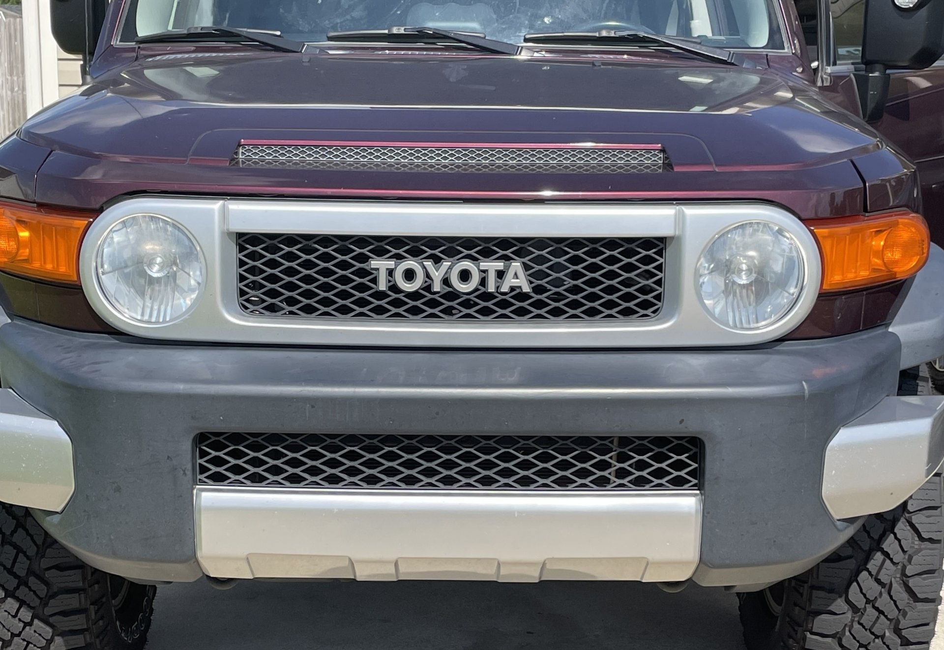

Well, I wasn’t planning on messing with the silver on the bumper since I plan on installing a ARB or something in the future. It looks kinda weird being mismatched for now though. :meh:View attachment 2731156View attachment 2731157
Well that didn’t last long. Had a used arb with 9.5k winch pop up on marketplace.
