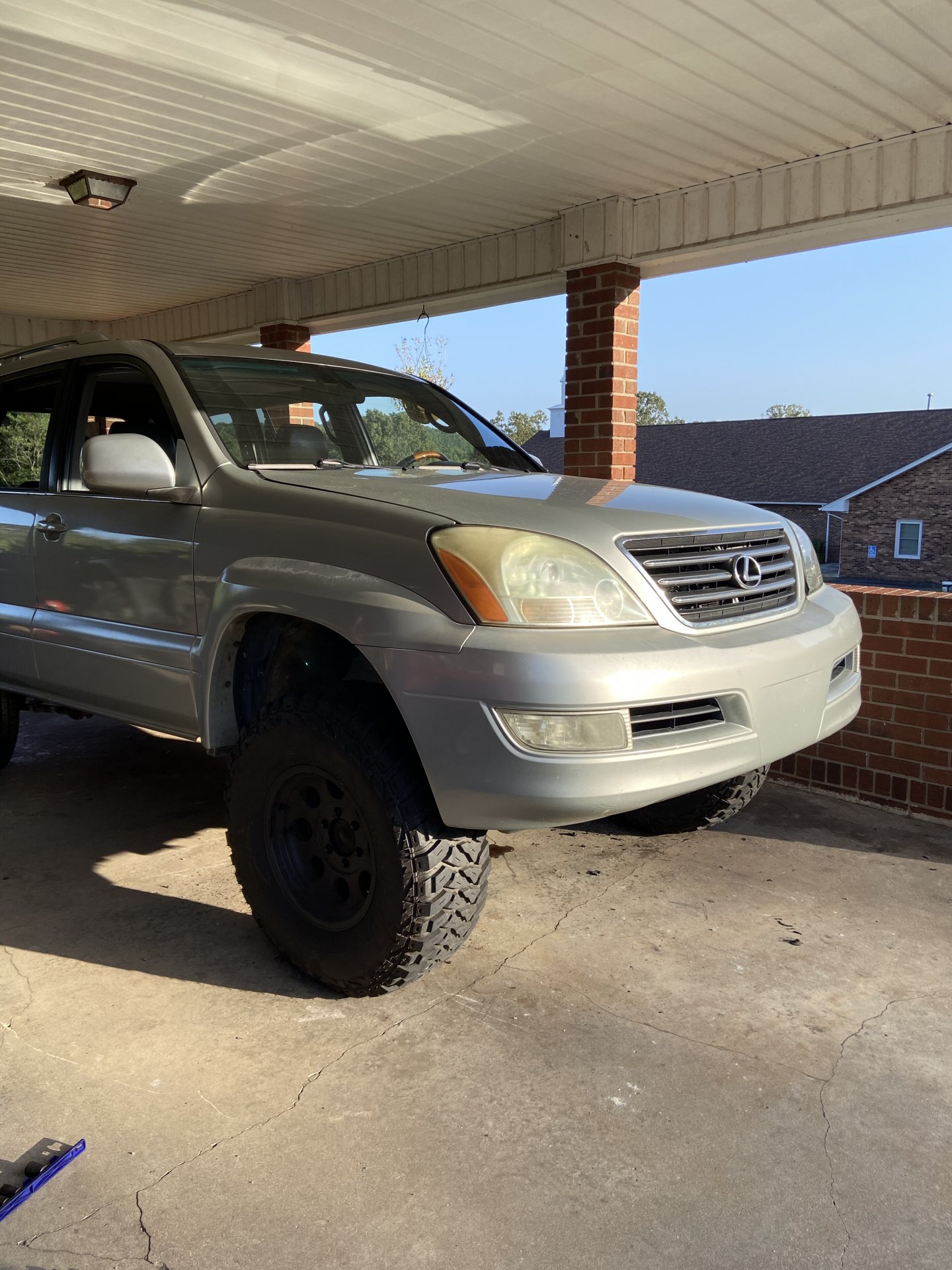

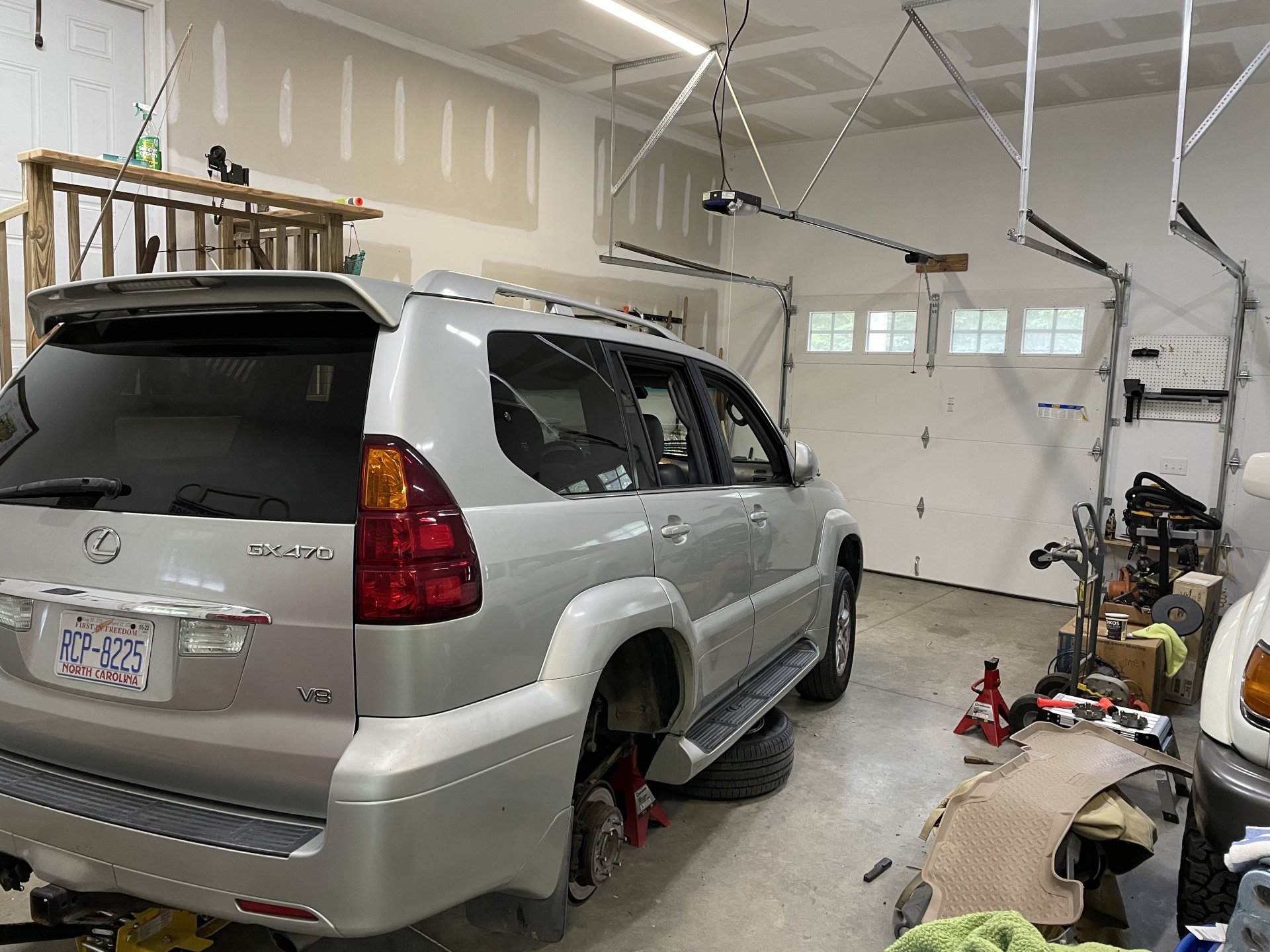

Started lifting a friends GX470 last night. Only brought it over to look at the rear brakes, next thing I know we’re in the process of installing the lift LOL. Removed the old airbag system and added Dobinsons shocks and ToyTec springs. Only got the rears done before it got too late, thankfully we started on the back so he didn’t have to drive home Carolina squat style :grinpimp:

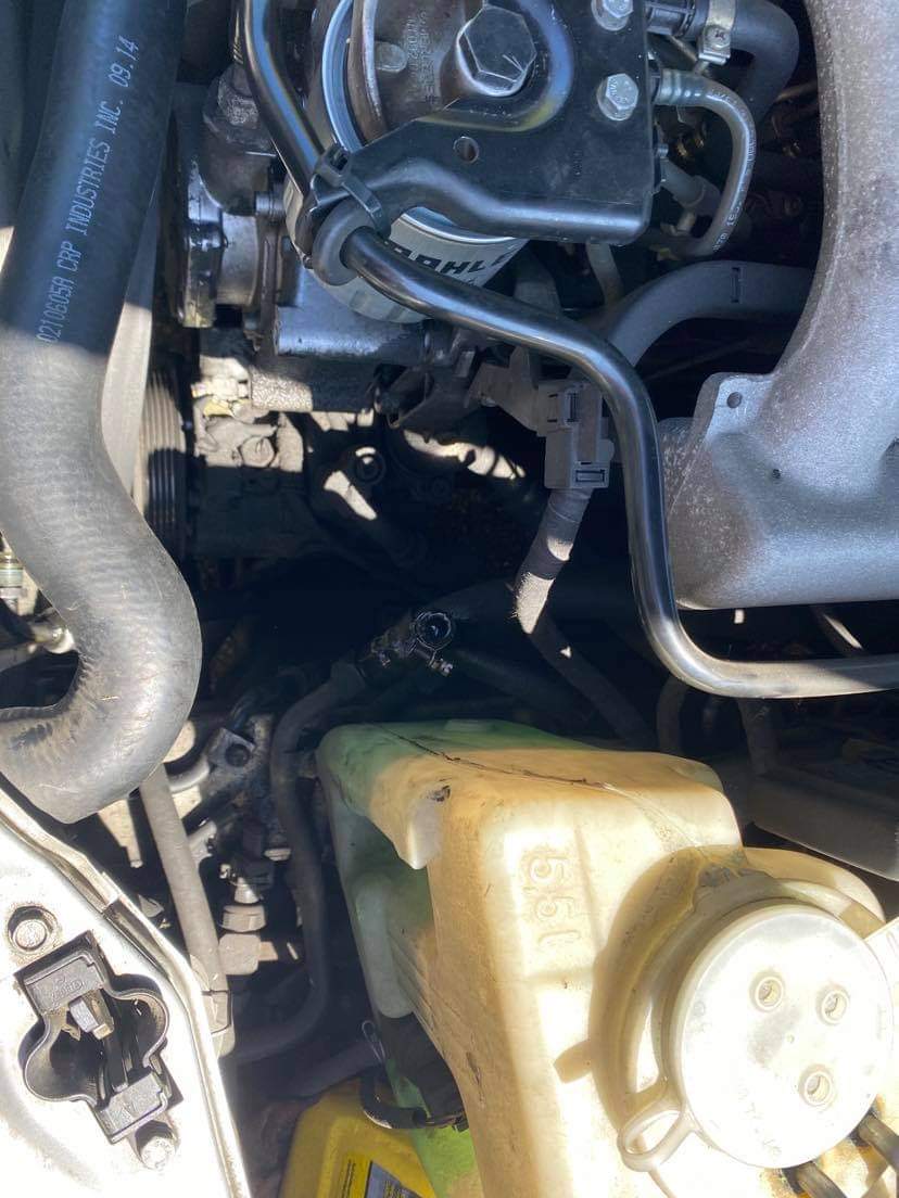

Troubleshooting the knock sensor CEL I have been getting for a few months. - I replaced the knock sensors, both 1 and 2, a while back but I knew the connection wasn’t great. Sure enough that was the issue.
fuel filter was finally replaced -we cut it opened and it wasn’t that bad inside. That was the first time the fuel filter has been replaced since I have owned the 80.

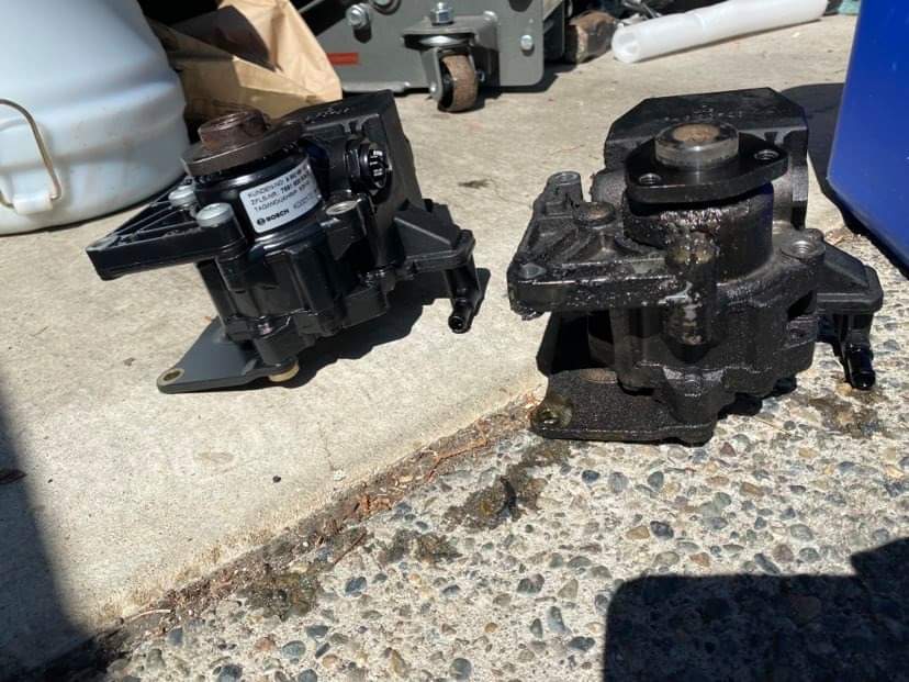

Not a huge amount of work but I did the front driver's wheel bearing on the mercedes along with a power steering pump replacement.

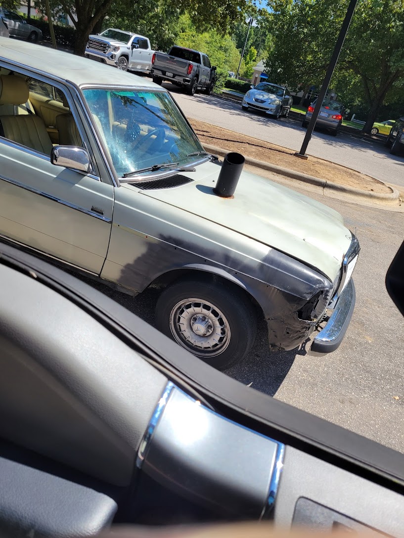

When I get home I look closer the ecu says stage two and a part number. I look it up and ask on some mercedes forums and it seems its a legit Sean Tracey ECU from the UK. The manifold turns out to be a twin scroll job from kangaroo racing In the EU.
So now all I need is a hx35 turbo to make out the little 3 ltr engine's pump to 300hp and 385 ft/lbs. If I get a bigger element pump then 400whp and 500wtq is on the menu with no other mods. Higher if I send the ecu back to tune for the specific pump.

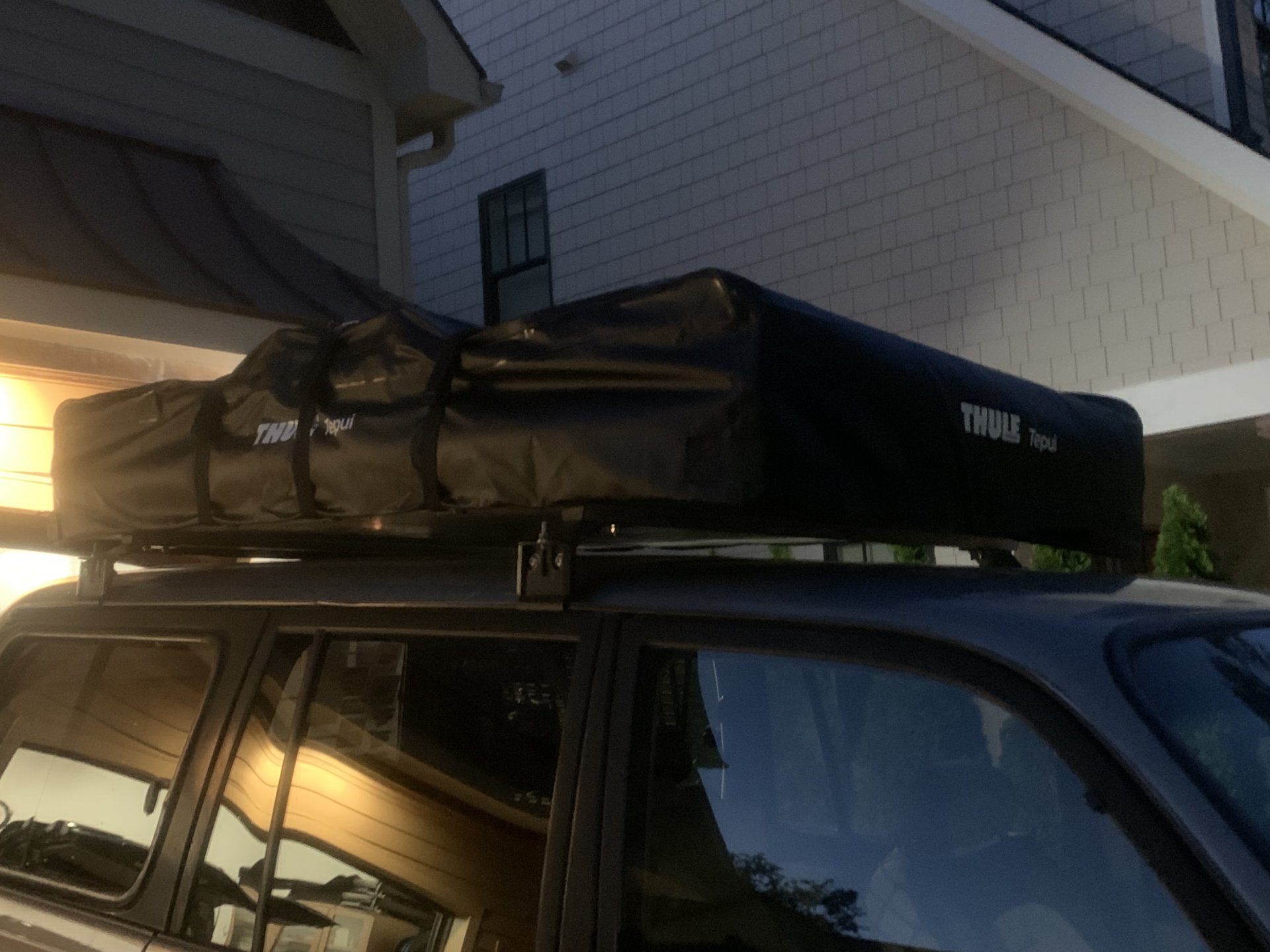

No much wrenching but it took a big load off my shoulders. When we had the Rtt group buy, some people were proactive and bought the extra cover in case the cover that came with the tent break or damage. The reviews were that the zippers were bad and the cove was low quality. I didn’t, i thought that i was never going to need to Replace it. Well, last trip the sucker broke. The zipper broke and we had to tie the sucker down to get home. I try ordering from Mombasa but they are out. I research and research and finally i found the Thule tepuy with the same dimensions. I installed it tonight and it fits like it was made for it. So i am back in business. My tent decided it was not going to be a Mombasa any more, it feels better as a Thule.
