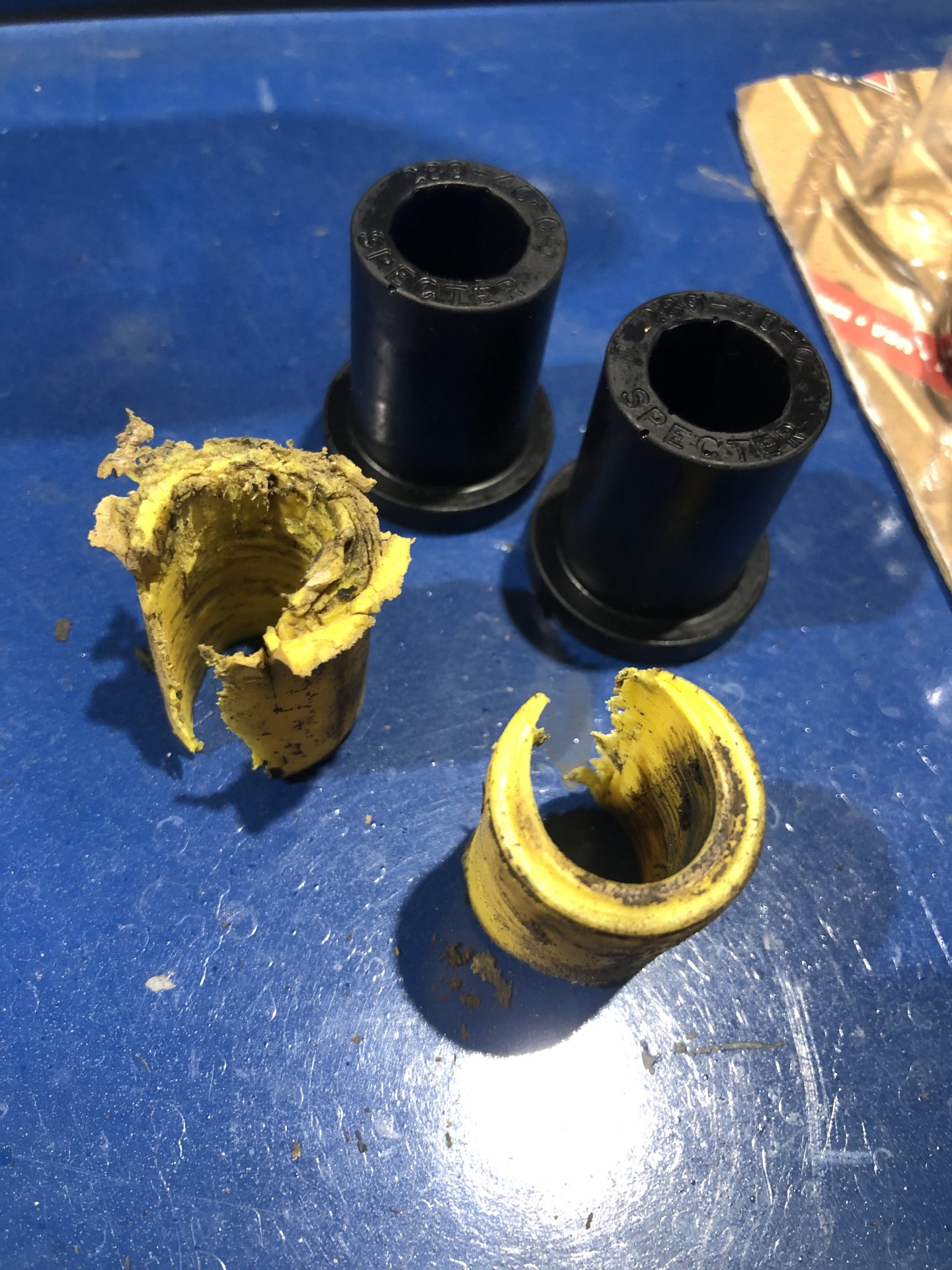

Never updated here, threw new poly bushings in the front suspension on the blue 40, made a huge difference. Less noise, and more importantly it now turns right AND left. The axle was so off centered before it was all out of whack. It’s still 1/2” off center because I think the frame isn’t straight from years of wheeling and a tweaked drivers front leaf spring. But good enough for me. Hopefully the last money spent on leaf springs until I link it!

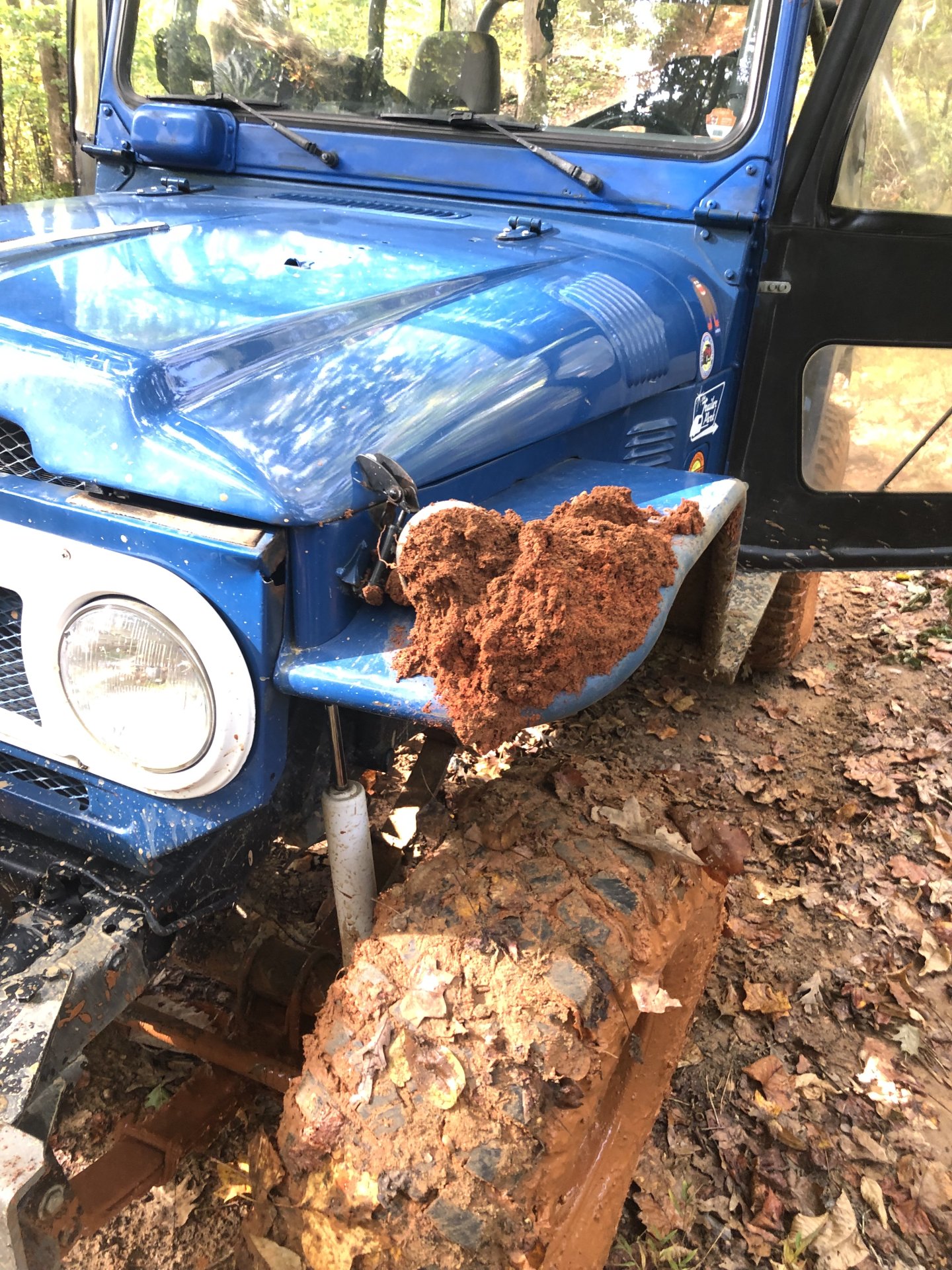

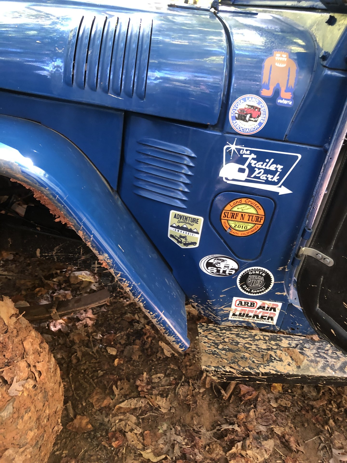

This past weekend the Clemson Off-road Club went to Beasley Knob, it was a slop fest even after it had supposedly not rained there in almost two weeks. I had a small altercation with a clay wall, may or may not have managed to put the full weight of the 40 into the wall on the drivers fender. The fender is tube and beefy, but poorly tied in to the frame. So the fender just pushed back into the tub. Got it straightened up pretty well Monday though! Next step is more frame tie ins, also going to add a tie in across the engine fender to fender.
