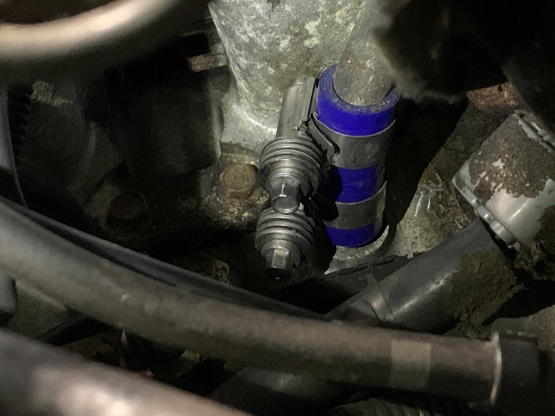

Getting close to wrapping up under the hood of the 80-series. All new gaskets and seals, vacuum hose, OEM radiator hoses where I can, gates green stripe where I can’t, WP, and fan clutch.
As I was up in the wheel well replacing the radiator hose that goes under the intake to the block, I noticed this….
I assume that’s the PHH everyone talks about. Those don’t look like factory hose clamps. I guess someone beat me to it.
That is the PHH. That's some good silicone hose by the look of it, and quality constant-torque clamps.
Yeah don't mess with it. It looks recently done within a few yrs.

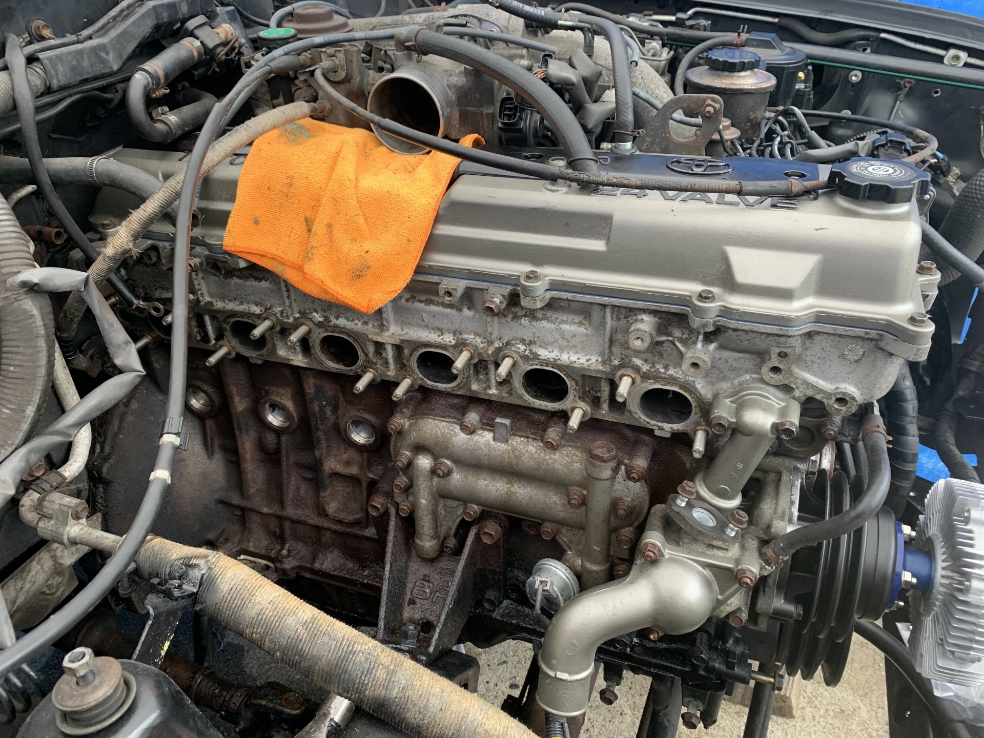

I think Ive earned my "rights of passage" or for a different audience "my first blood wings" 🤪
It took me two days to remove upper plenum, all new vacuum hoses, new WRX injectors, new injector connectors, new wires, new spark plugs, and complete Landtank's up-scaled MAF for the SC.
Ran into some hiccups alone the way, but its all back together. Cant give results yet, because Im chasing down a rough idle that started Monday.

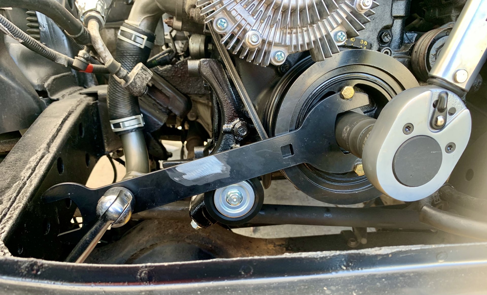

“On today’s episode of Ghetto Fabulous Fabrication”…crank pulley final installation.
Not wanting to pay or wait for a specific tool hold the pulley, I found a “universal fan clutch tool” at the local Pep Boys clearance. Not being wide enough to just drill matching holes for the pulley, I used the plasma cutter to notch the edges enough to get the bolts in place yet still hold the pulley. That linked to a 1/2” drive breaker bar to reach the frame rail and boom…Bob’s your Uncle. Not gonna lie..300+ ft/lbs took a little mor “ummph” than I expected. It’s done now and I know it’s right…moving on.
I think one more problem solved with the plasma cutter and I’ll to tell my wife “see I told you it was a good idea”….it may or may not be said out loud.

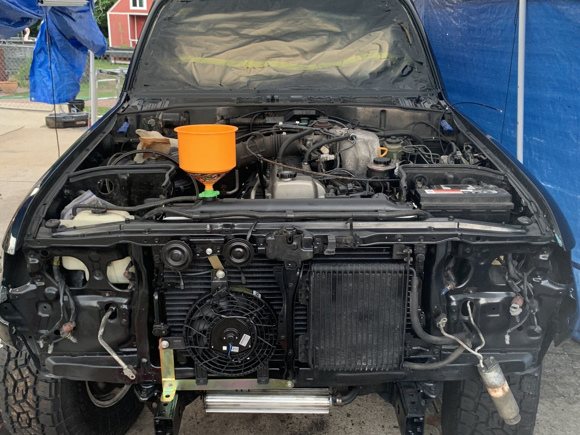

Finally got all the important parts of the front end installed. New radiator, heater control valve, a/c condenser, @LandCruiserPhil aux fan kit, PS battery box, hood release cable, and every inch of radiator hose and vacuum line under the hood. This is going slow with all the rust remediation and some fabrication of new small pieces that got broken or rusted beyond saving. On a side note...if you break the special sleeved bolts that pass through the rubber upper radiator isolator, you can cut down a brake caliper bolt sleeve from a early 2000s F350 and it fits perfectly with an M10 bolt passed through it.
