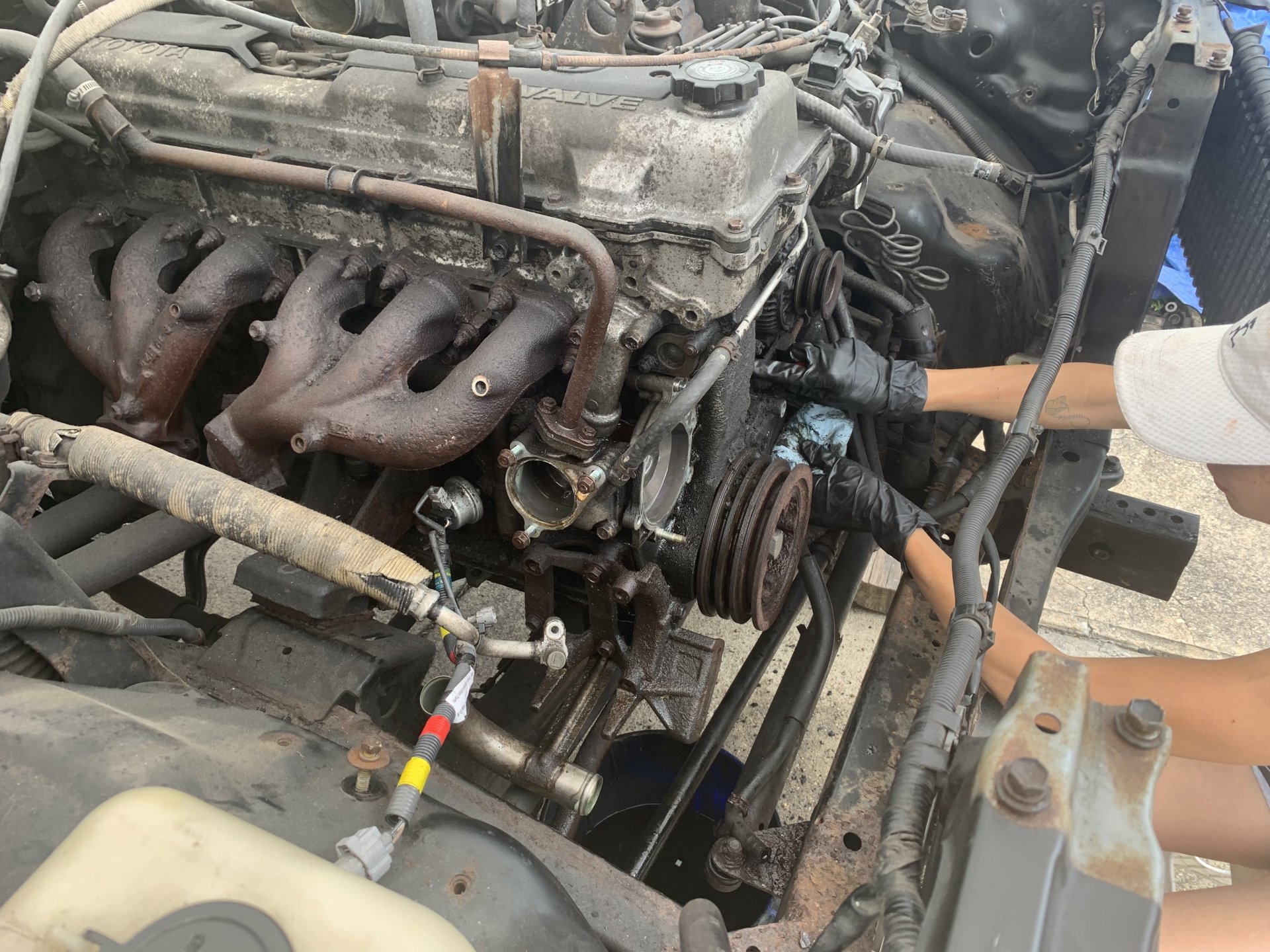

With help from @MyWhiteSheep today, we got the front end torn apart and started going after the usual 80 series oil leak culprits and staging for new parts install. Pretty uneventful overall...just 2 oil pump cover screws needed to be drilled out...but it felt good to make some meaningful progress today.

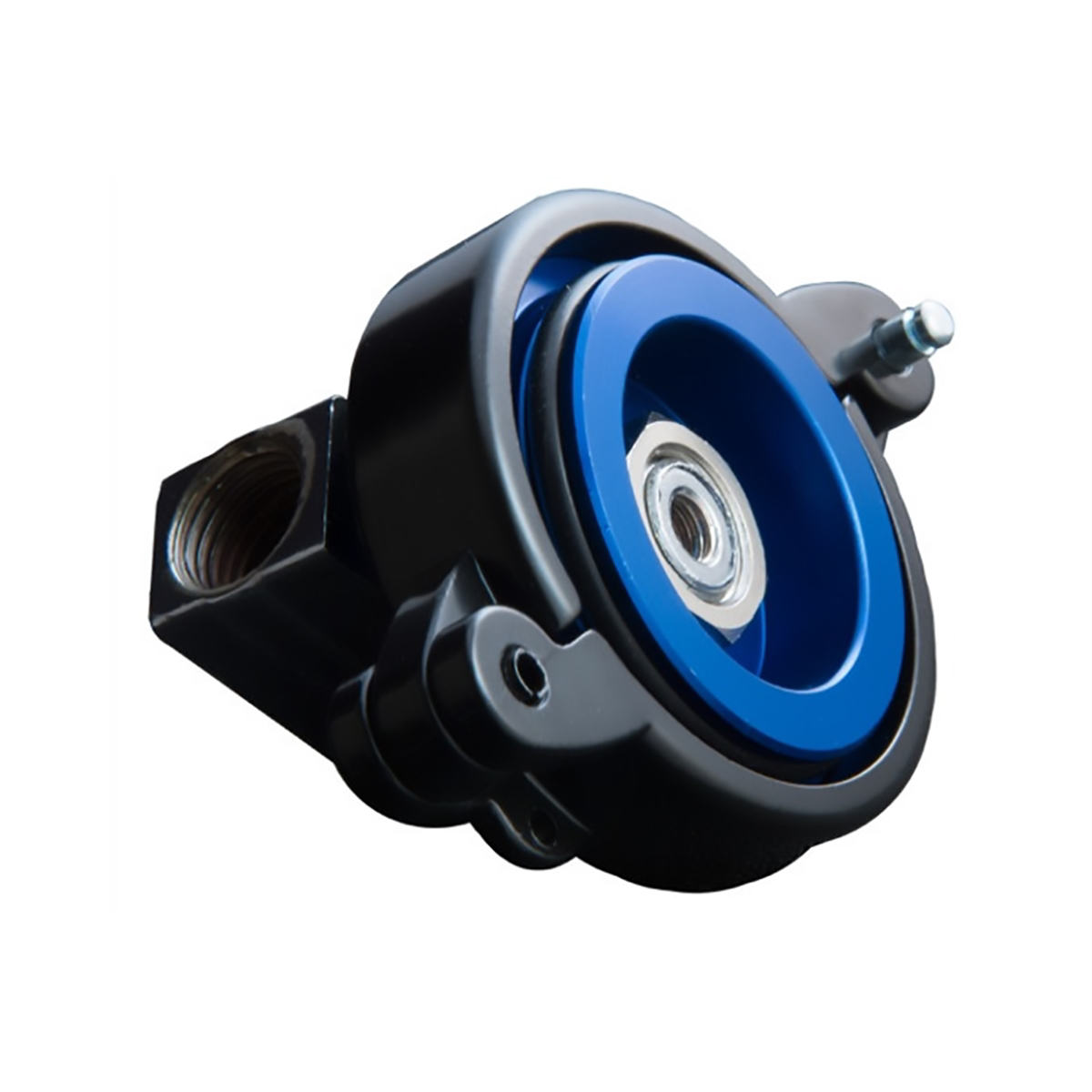

Get a motive power bleeder. Worth its weight in gold.

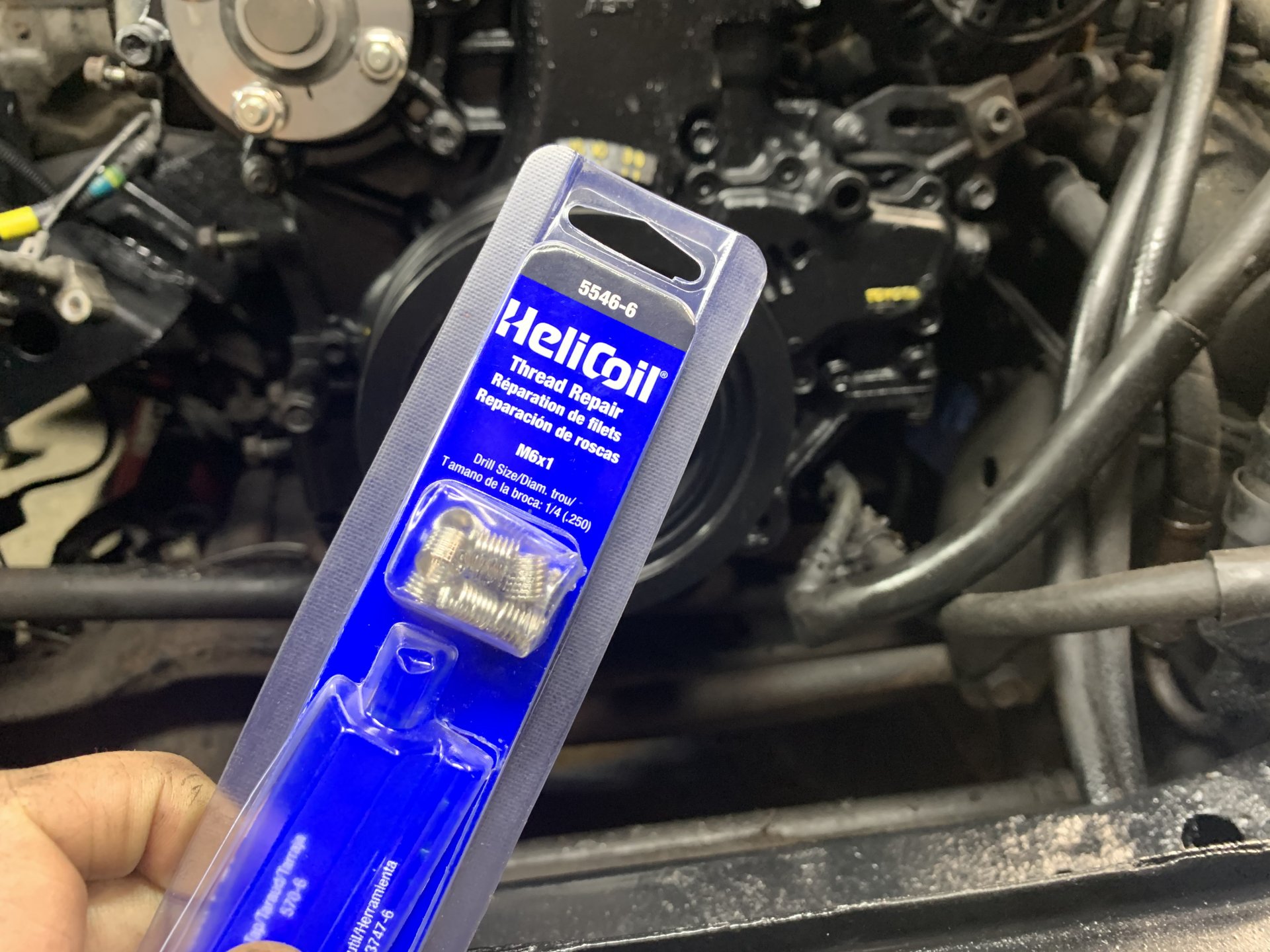

I acquired a new tool today that allowed me to convert a factory oil pump cover bolt hole into a $30 oil pump cover bolt hole!!
I also managed to install the new water pump, put on a new crank pulley, and clean a lot while everything is out of the way. Tomorrow should be valve cover gasket, dizzy gasket, and put things back together.

not sure what adapter you have for the power bleeder but, this one has served me well over the years
The 18B fits the 80 series size MC cap. Anyone have a part # for one that fits the 60?
Not sure about the 60 but I do know there are some vehicles that don't have one yet. I had to build my own for the LS430
Same here. Works great on the 80’s, when I can find whoever I’ve lent it to! I probably purchased it at your recommendation.
