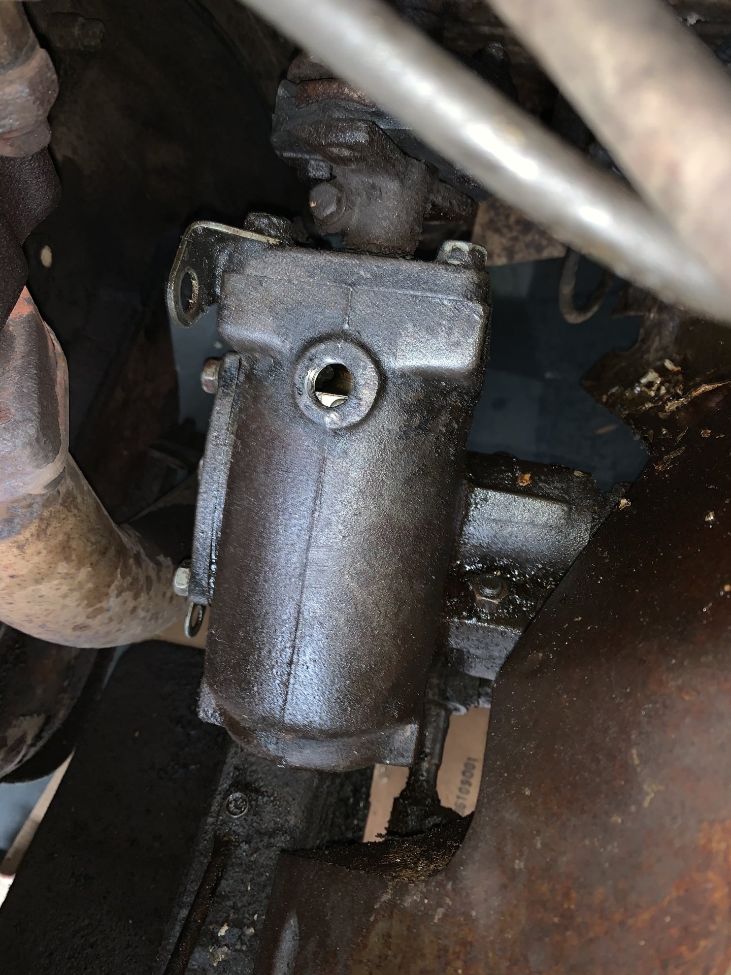

CRR prepping... Got a little motivated with the 40 now that the weather is perfect... first charged up the battery, cleaned out the whole interior that had become a small storage unit.. then drove her to get coffee Friday am... the experience was amazing but I quickly remembered why I fear for my life about 45mph... the dreaded death wobble

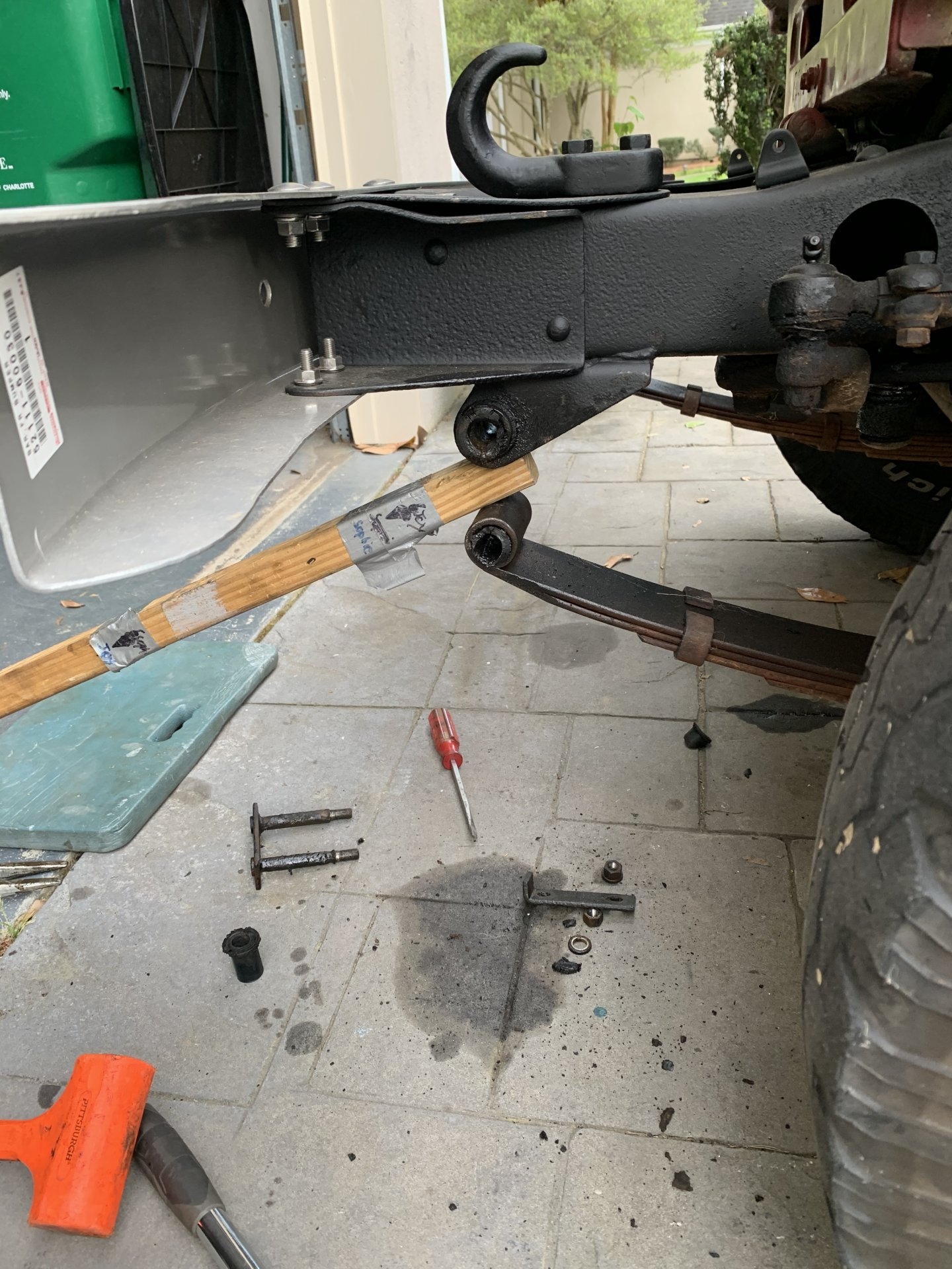

So Friday night I finally got around to tackling a project that @fj40alex and I started a year ago that @FJinTegaCay so graciously sponsored with a baggie encrusted with red and white labels on it.. swapped out the brittle black dust that once were called leaf spring bushings for some oem rubber ones... was so proud I tackeled this by myself and then quickly went for a test ride... sadly no change, the death wobble continued... so started diving deep into the depths of mud research
Saturday decided to tackle my loose steering since I had never tried to tighten it up and since I don’t have any new TRE’s laying around... went against the mud wisdom and went the hack route by tightening up the adjustable screw on the steering box... well I did that after about two hrs later after a lot of degreasing, pb blasting and rust reforming... then filled it with a bunch of 90w gear oil courtesy of @MBest75
proud to say that I took it for a test drive and the steering is way way way better and tighter at low speeds, and the best part is I’m fairly sure that it also cured my death wobble much to my surprise! Why didn’t I do this years ago? Simple and free!

I think there’s a steering box under that 43 yr old mound of gunk
all cleaned up... tons of degreasing and wire brushing and then I could finally see what lutked
initially I never thought I’d use this stuff but it came in completely clutch... and man my box was dry...

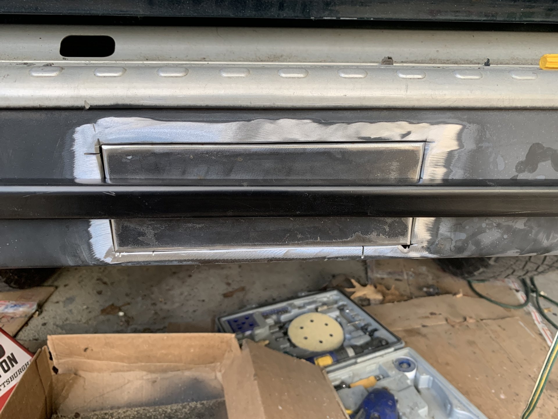

Not many wrenches involved today, but a lot of cutting and welding. After poking at it, a small rust spot on the frame became a big one on the 80. The hard part was that it extended up under the front lower control arm mount. After trying to figure out a way to avoid it, I finally decided the only way to do it right was to cut the mount off and get in after all the bad metal. Not sure if I could have done it as easily without the plasma cutter I picked up last year.
This is part of what came out of the bottom of the frame.
A couple hours later of cutting, grinding, welding, and grinding we’re good as new...our at least better than it was yesterday.
I’ll be happy if it’s a long, long time until I have to weld while laying on my back in confined space.
