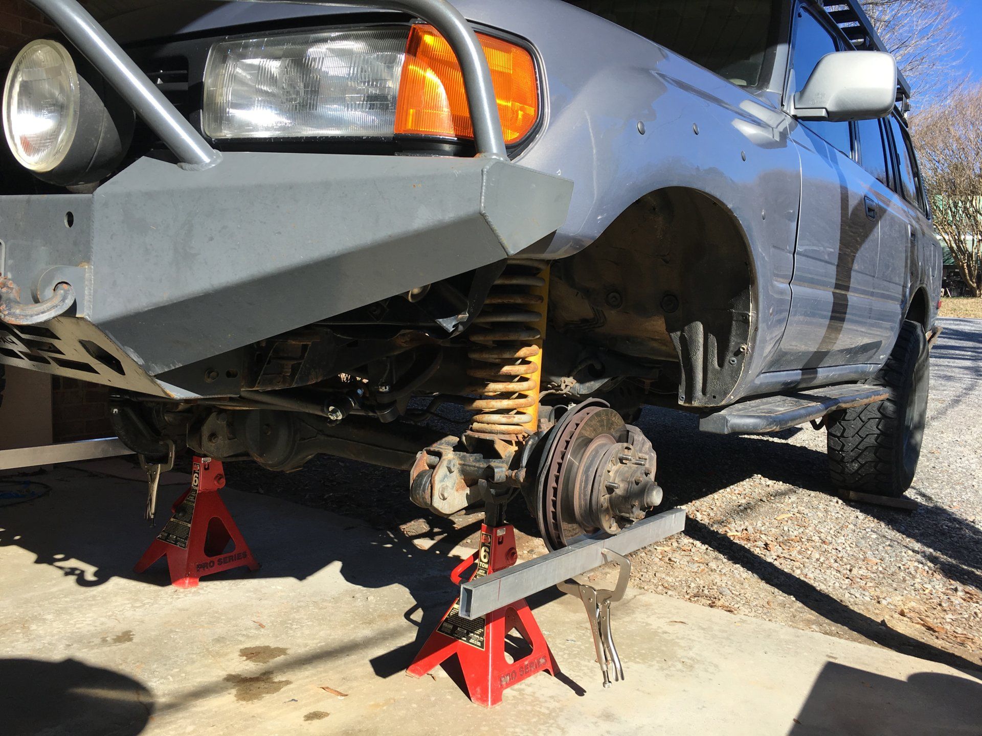

Factory fsm says 1/8” toe so assuming 32” tire stock i measured 16” fore and aft and marked the locations as well as the centerline on a couple straight edges. Align centerline with middle of hub and clamp to rotor. Use level to level jig each side. Measure back side, mark to mark. And front side, mark to mark. The difference is your toe. Adjust back tie rod link to get toe set as desired.
that's how i do it.
I do it with two push pins and a tape measure. I don’t even pull the wheels off. Put the pins in the tread at the front of the tire. Measure. Back up truck until push pins circle around to the rear of the tire. Measure. Subtract the difference. Tah da! Not as accurate, but my method works fine for me. No issues so far.
I'll do you one better. Measure from inside shoulder lug on the tire to inside shoulder lug on the other tire, where the sidewall tread meets the road tread. Eyeball center height. Rotate tire 180*, eyeball again. :hillbilly:
The bar stock trick is the bees knees, just requires tire removal. No bueno for lazy people :lol:
Useless knowledge of the day....That's one of the two reasons why nascrap cars have bullet shaped cups on their front and rear hub assemblies. 1. Is to help slide the wheel onto the hub easier, and 2. Its so they can measure toe by sliding a bar over them.
Hows that work on your swampers? :)
But agreed. However then math is involved lol. And maybe a second set of hands to pull tape tight over 5’. 1/8” toe on edge of a 35/7 wont be the same as 1/8” toe for a 31/2” tire. Plus tires were off for tie rod ends and i was half way there.
All that said i Feel i could use a little more and ill probably measure as you described for the adjust.

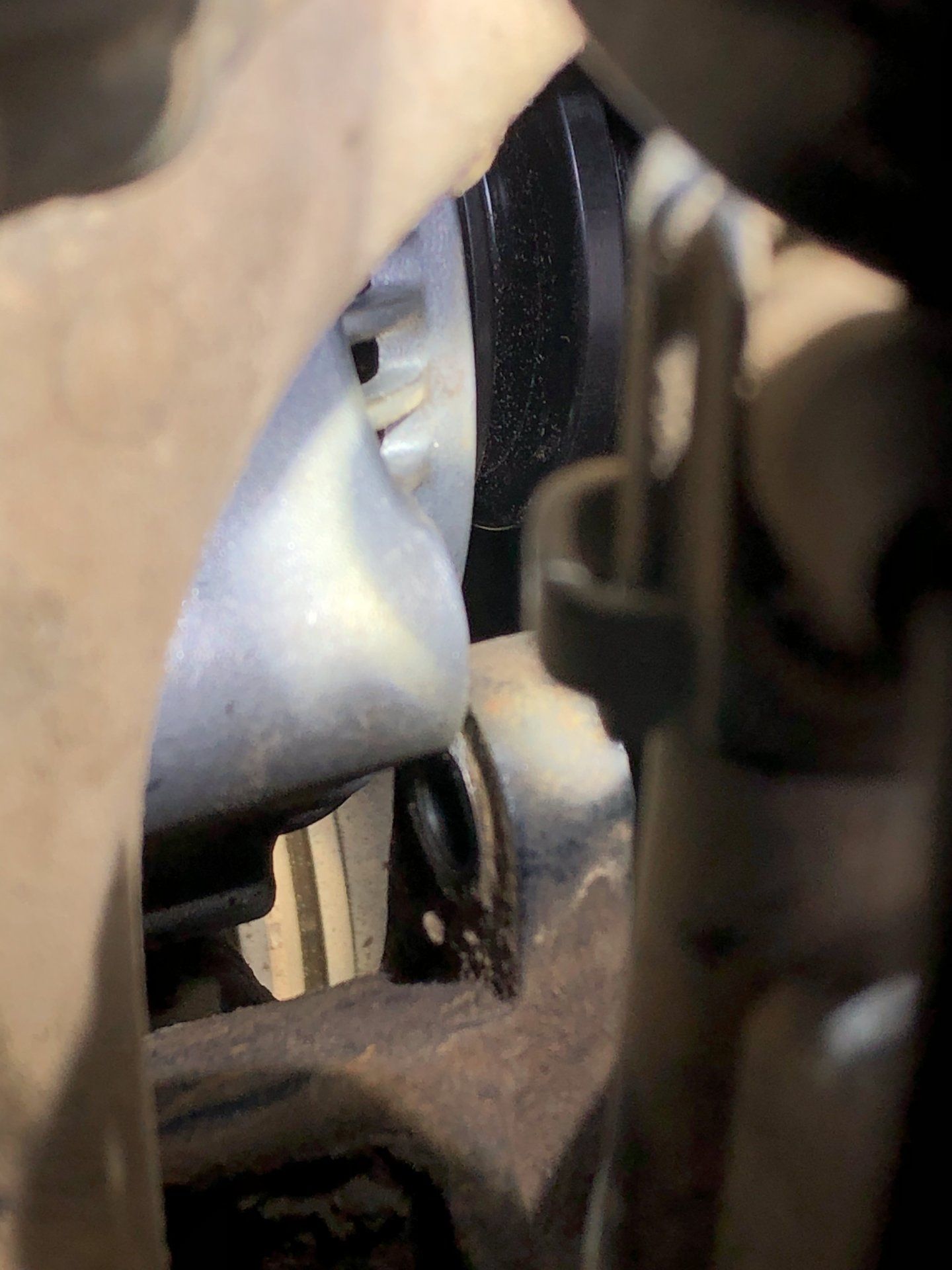

Real time help. I’m in the process of replacing the alternator on the 80 and I am having a hell of a time getting the new alternator back in the bracket that holds the top bolt. Any tips or tricks?
