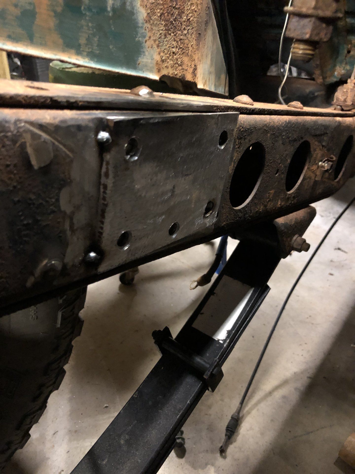

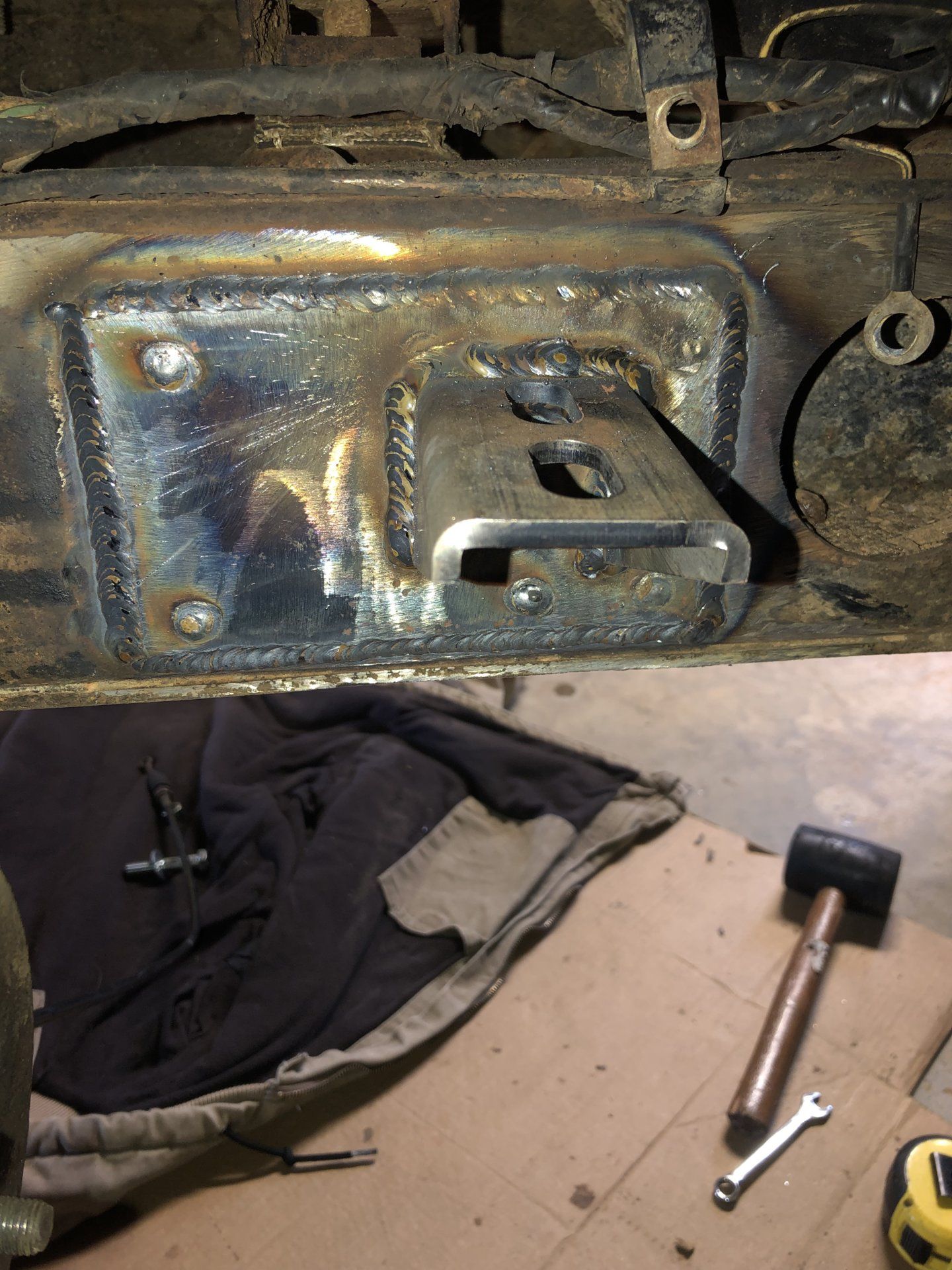

Rusty pig wrenching. This body mount wasn't doing much mounting! It was mostly crispy bacon bits.

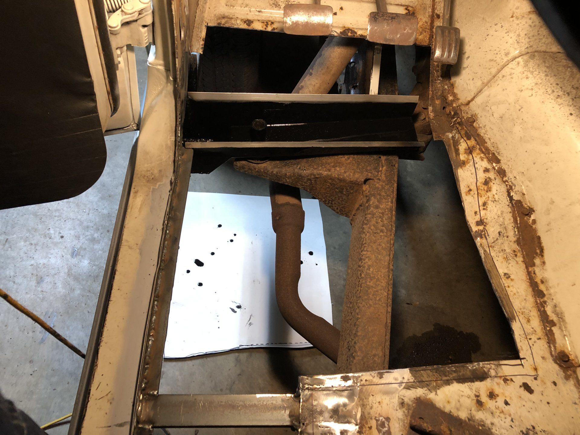

When I pulled the DS front fender, I found a bit of rot in the door frame. Order of operation is: Cut, weld, POR-15. Cut, weld, POR-15. Repeat ad infinitum. Oh yeah...grinding. A whole lotta grinding!

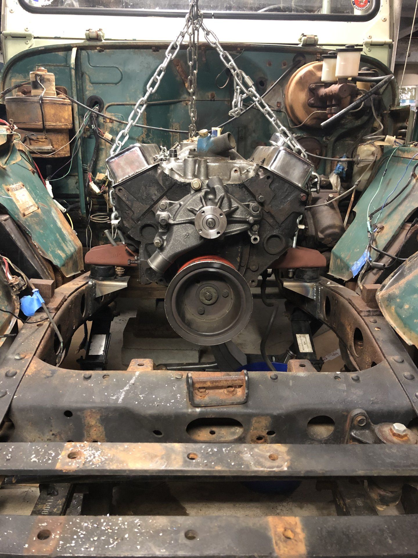

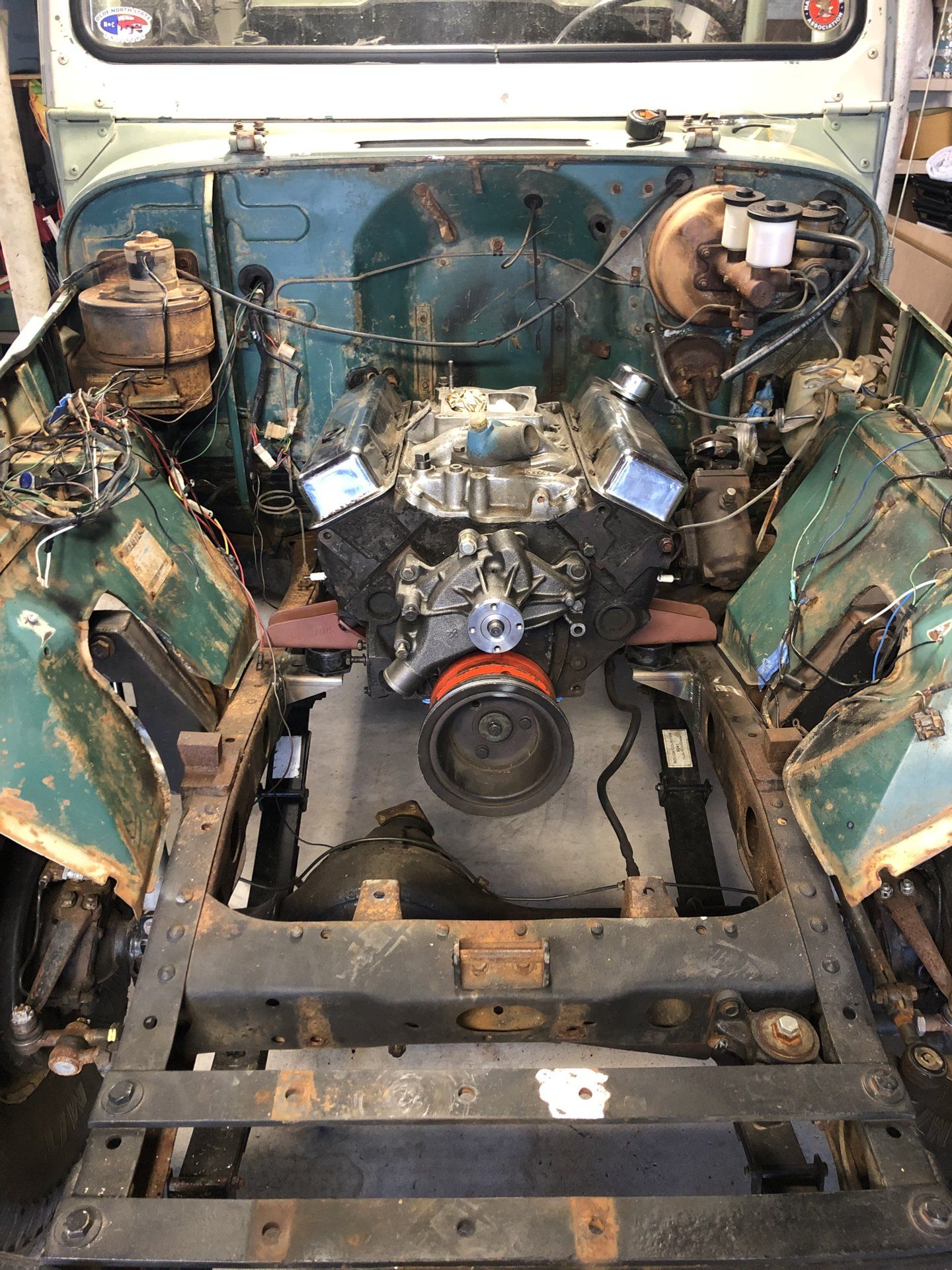

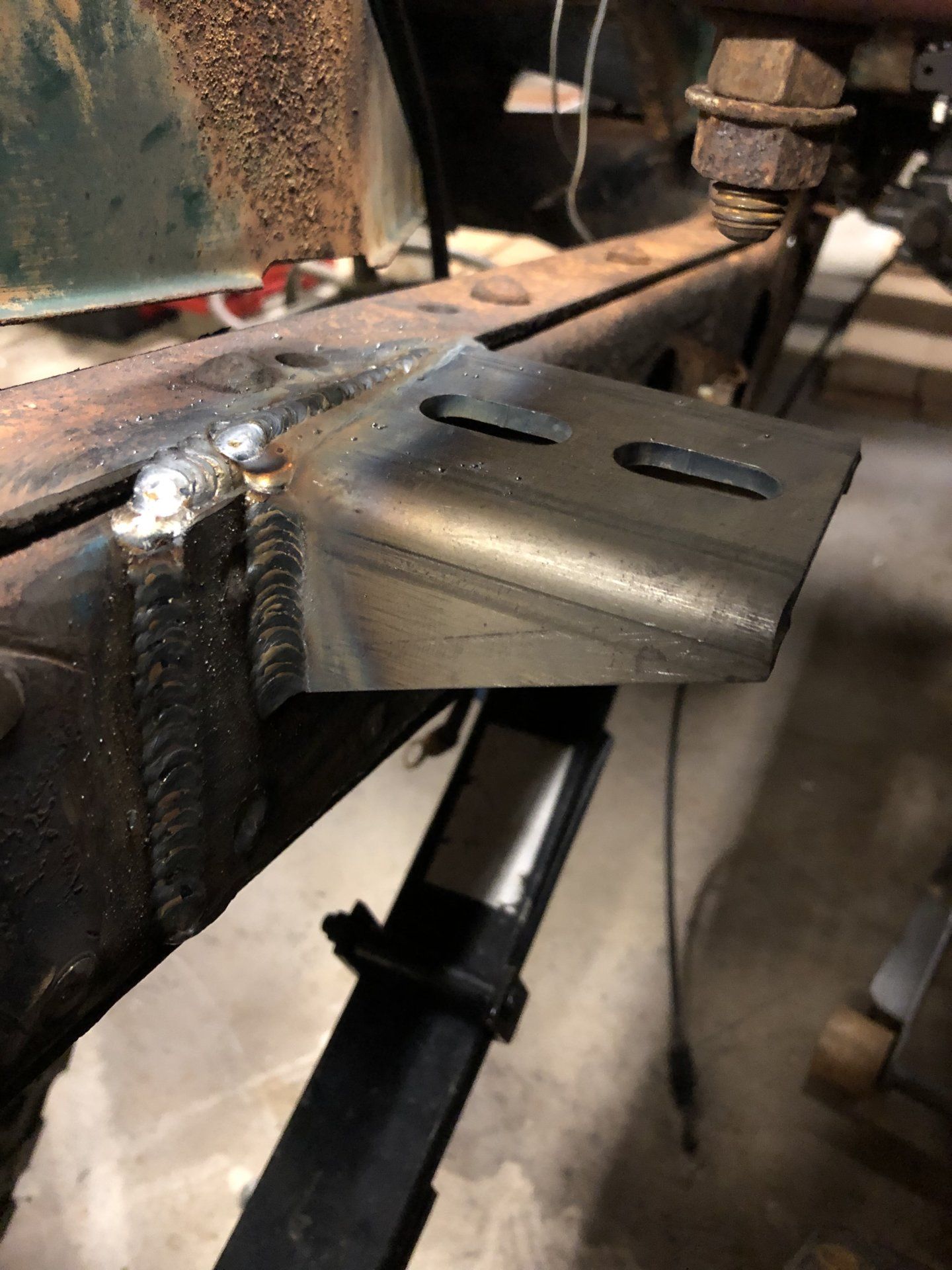

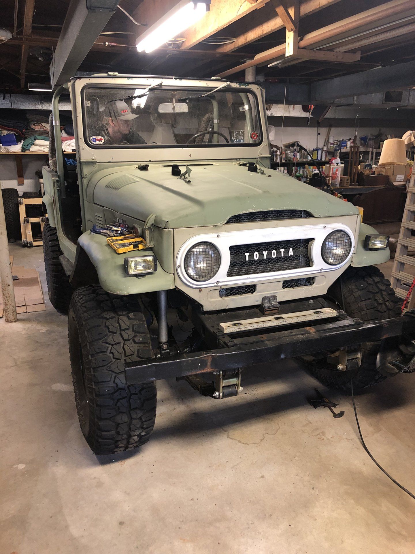

And we’re in! The engine is completely mounted. Both driveshafts fit well. And have so far installed the starter, fuel pump, carb, and air cleaner. And we fabricated 75% of our radiator mount.

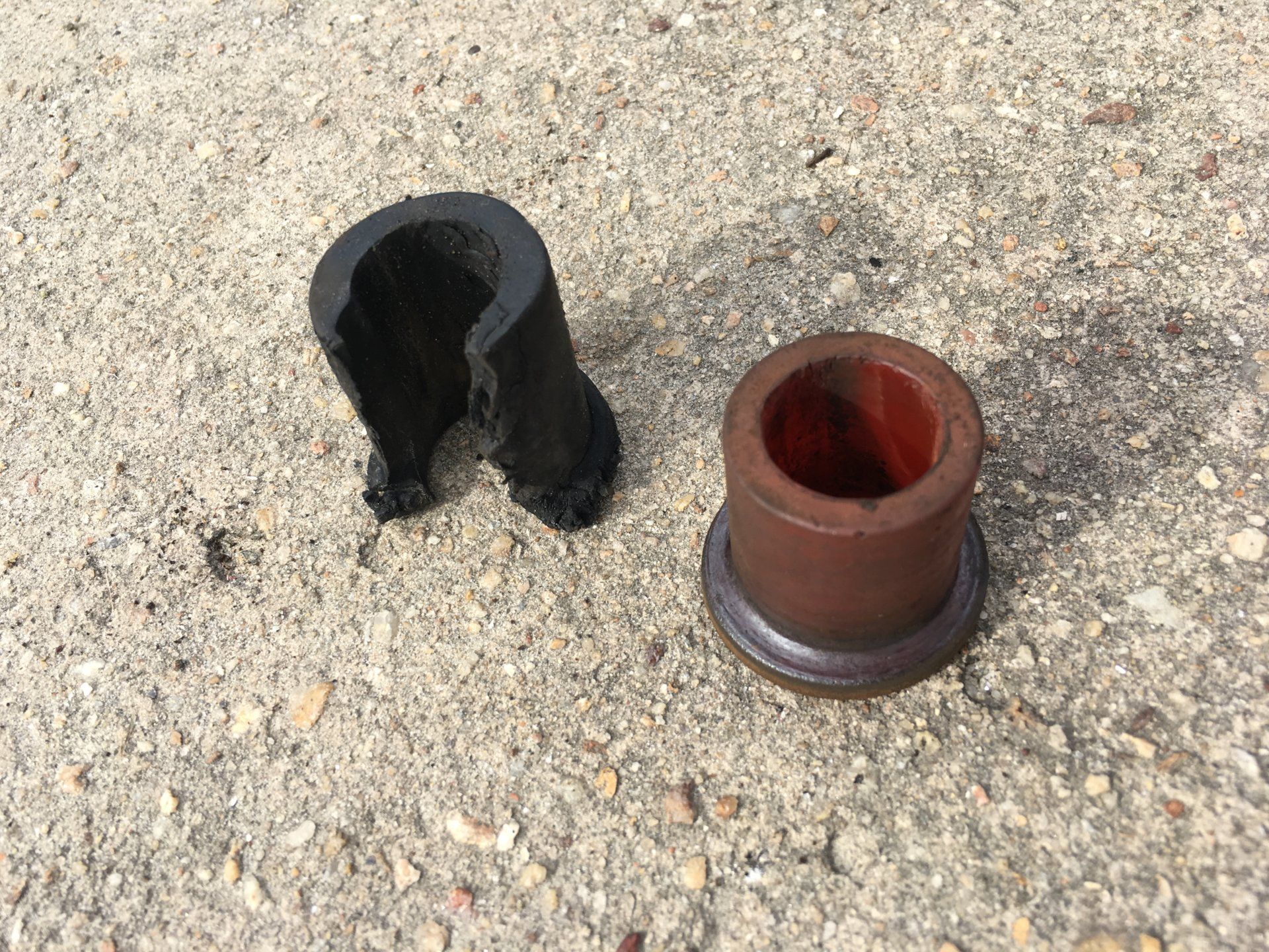

Wrong front shackle bushings delivered for the 45 but got the shackle side rear spring bushings done and the frame side of fronts.
Had to throw in new turn lenses just for a small victory in the day lol
80 got a new battery tie down and a rust discovery and slow bandaid

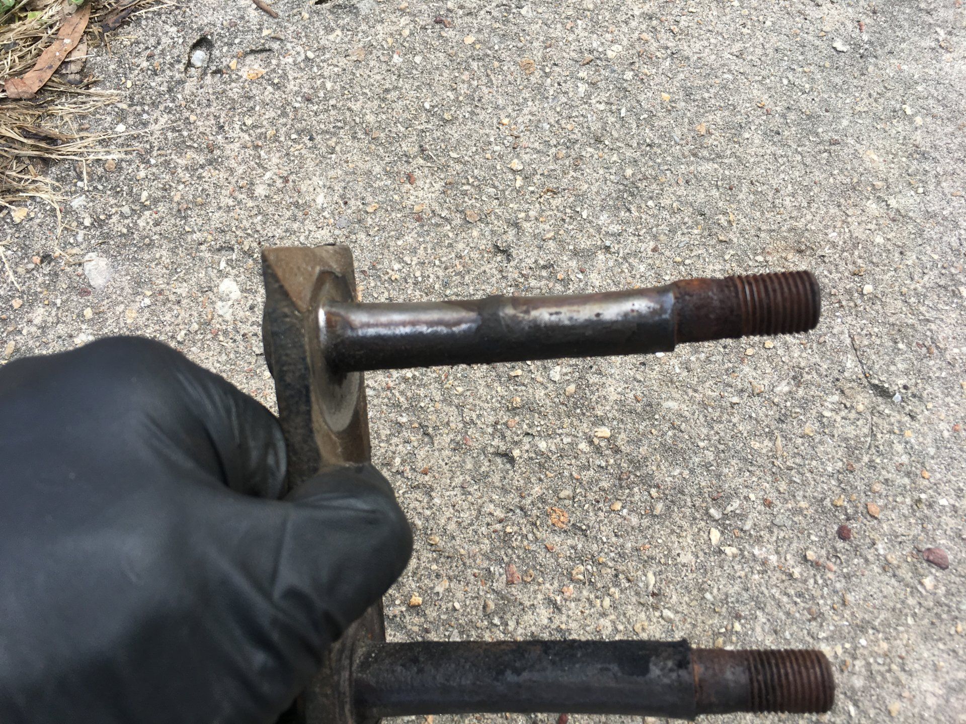

Interesting note. Energy susp poly bushings survived 10+ yrs and look to be in good shape vs 4 yr old rubber but they did take their toll on the shackle pins.

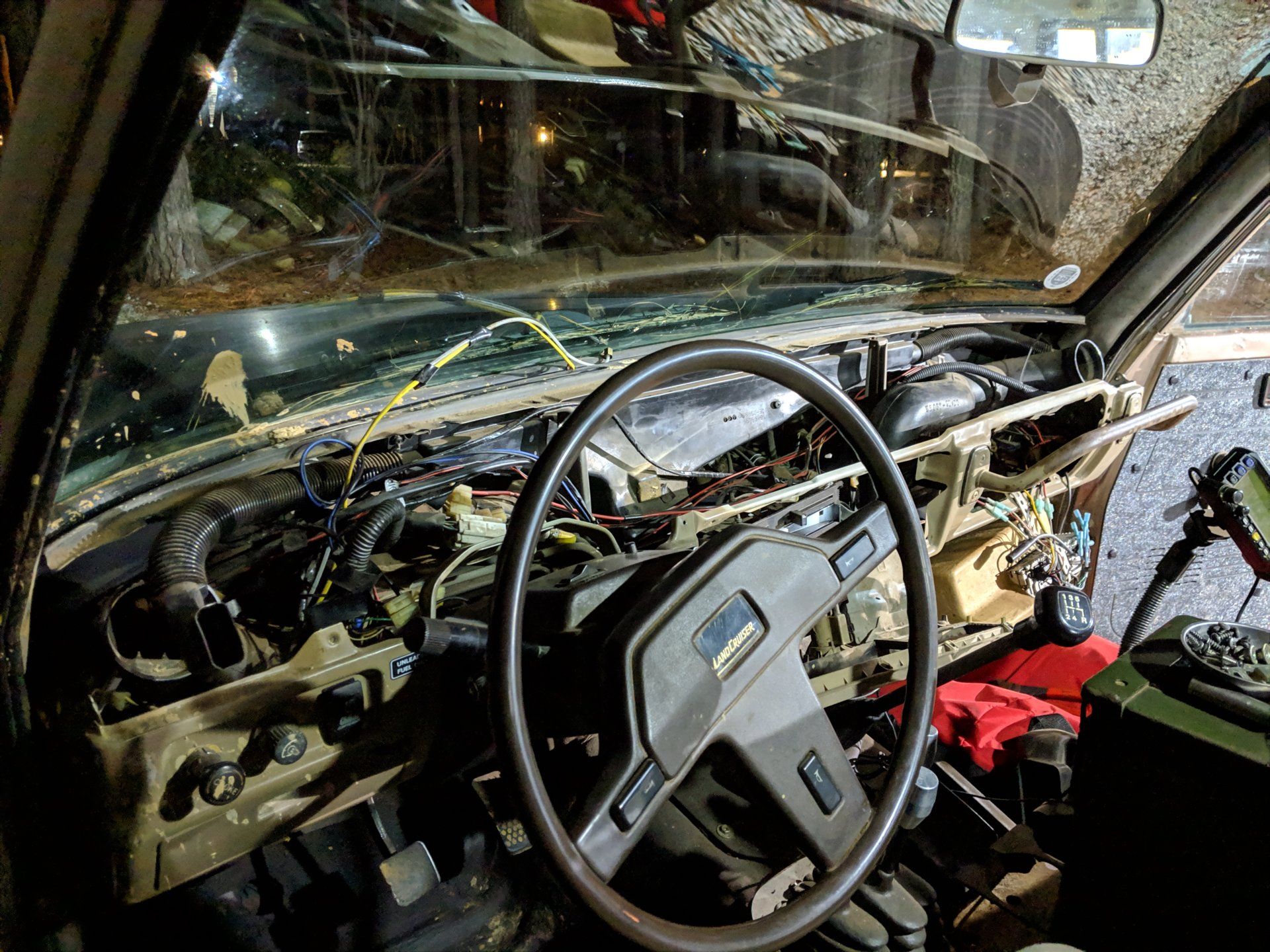

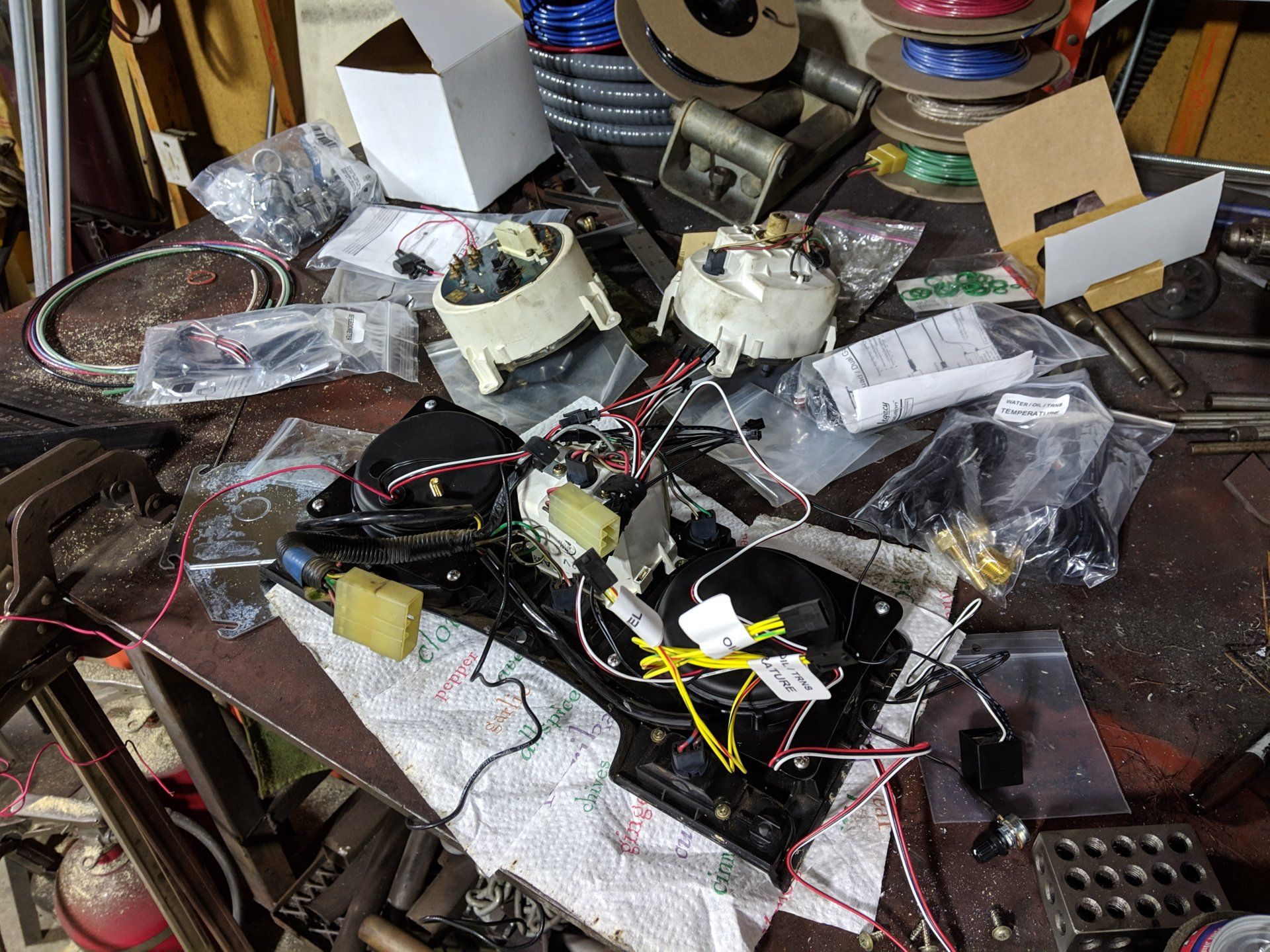

Hopefully quick project on moonshine started today, new gauges and wiring clean up.
Looking good JC. Really dig the new gauges. That's oil pressure on the right in the cluster?
Yessir. Comes with senders, everything but fuel level. Fuel level gauge has a procedure to calibrate it to whatever tank/sender you've got.
