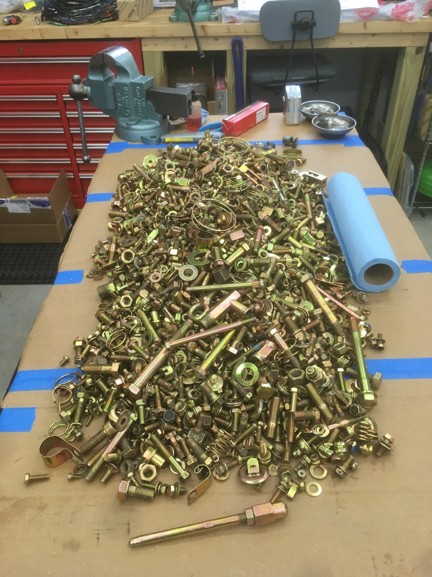

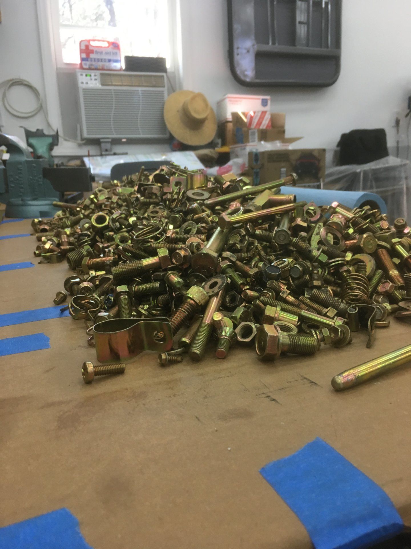

How the hell do you know what bolt goes to what?
Memory?
Pictures?
Some sort of labeling you use?
I would love to fill a bucket of bolts off of my 40 and get them plated but there is no way in hell I would be able to remember what bolt goes where.
Memory?
Pictures?
Pics plus memory plus some luck. The bolts on the older trucks have unique markings on the heads so those are the ones I care the most about. There is also a spreadsheet somewhere that documents the size / length / use that helps too.
I likely won’t use half of these putting my yellow truck back together but I couldn’t bring myself to throw away good old hardware!
Looks like there's some non OE stuff in there as well? Man, that's about as close to the TEQ original as I've seen - is it that good as I think the pics look? That's a hell of a deal.
Definitely some SAE and random stuff in there.
Some of it is super nice but some got tossed. First time having plating done and wasn’t sure how well stuff would clean up.
I would tumble a batch with walnut shells for maybe 24 hours then blow them off with compressed air. That got most of the dirt, grease and rust off but did t take all the paint off all the bolt heads. The plating brings out the imperfections and won’t stick to paint so some don’t look great.
The plating company tumble washes them in a high ph and hot cleaning solution then tumbles them in hydrochloric acid which also aids in rust removal. They then do whatever is required for the zinc plating (ac/dc current s***) and finally add the yellow chromate coloring. I can’t recall if they baked them afterwards or not.
If I had glass beaded each bolt/nut/washer they would’ve come out flawless...but I ain’t got time for all that! Overall they came out better then I anticipated.
