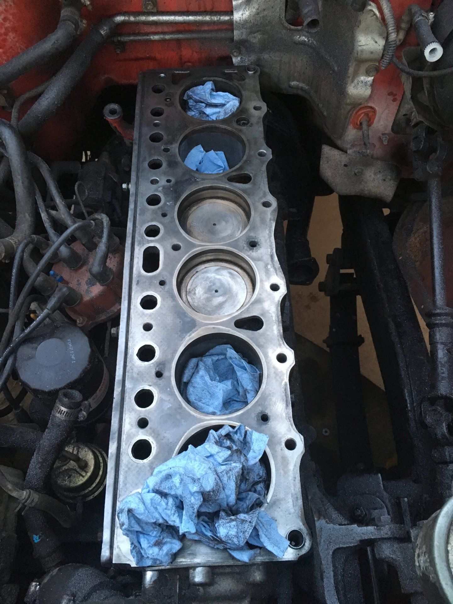

Got everything off the head and head pulled peeping the block while the paint drys on the new head that’s been patiently waiting to go in since the trip last December to the machine shop.

@fj40z Yeah man I was on a roll and then slowed down some when getting the gasket off the block brought the kids out but they had a blast messing with it and asked if we could do it tomorrow so that’s a win.

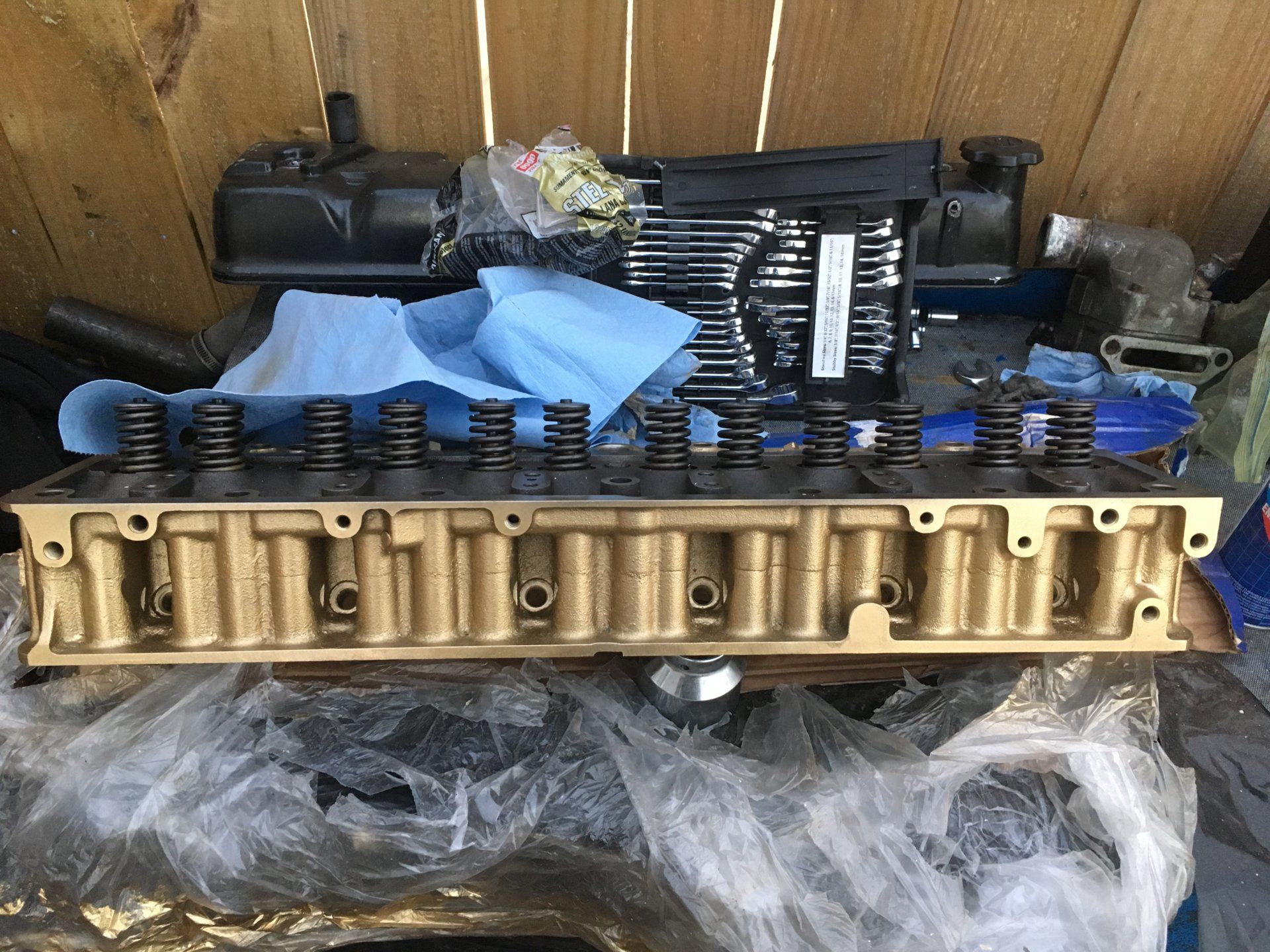

New head is prepped and I almost forgot to put the new seals in so that’ll be done tonight. (Wife doesn’t know it’ll happen inside yet....sorry hun). Everything else will hopefully be finnished up tomorrow.
Laughed with Stephen about the gold adding 20 horsepower and I thought what makes it better... tiger stripes... especially crappy ones. :grinpimp:
All done! Everything went together great all up until I started the motor forgot I was down a gallon of coolant..... luckily I happen to go check the temp and it was hot but not to hot cut it off and let it cool down added coolant and it ran like a champ temp never came back up I already ordered a test kit so I can try it after a tank of gas and see if I might have screwed up worse than I though.

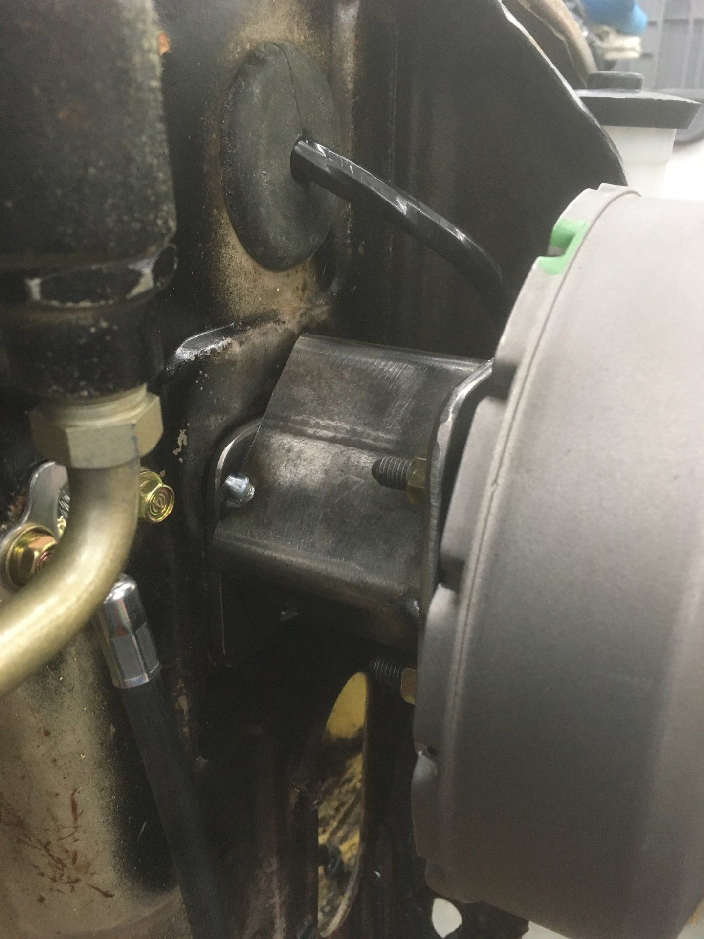

Also ‘fabbed’ (term used very loosely!) a bracket for the Geo Metro booster. I ended up using square tube vs round for the spacer...firstly b/c it was all I had on hand...but it ended up working perfect. I mounted the spacer 45* off compare to vertical and it allowed me to easily get a socket on both the inside bolts to the firewall and the booster nuts. Pictures explain it better...
Rib clearance is .5 **** hair...almost too close. I’ll use some bath tub underlayment as a gasket on both ends and that will give me another 1/8” spacing.

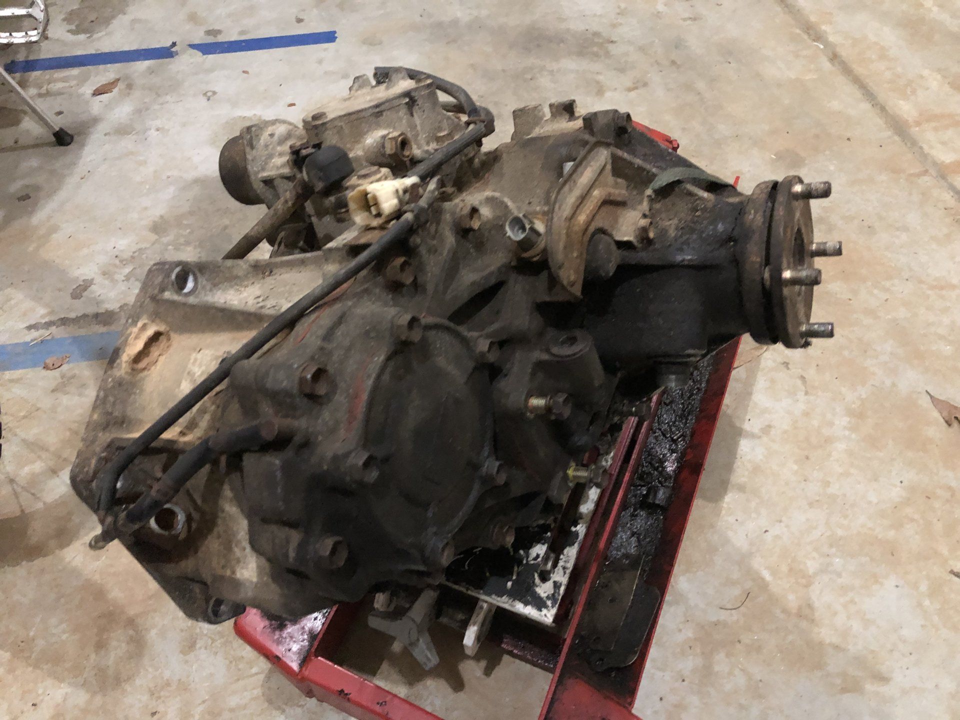

Though my own fault, I managed to screw my TCase last month.
Through lots of research and countless texts and calls to @GLTHFJ60 and him coming by a couple of times, we were able to get this beast out from under the truck. Beginning breakdown and full diagnosis this weekend.
Had to cut my exhaust off (custom routed) to get room to back off from the transmission.
While I’m in there, I realized I was leaking diff oil from the front drive shaft so that came off.
I’ll also be doing my Driver side axle rebuild at the same time.
Been a heck of a month, since this is my DD. I’m fortunate the the 👸 and I work together (and she actually likes me).
I managed to break off one of the six bolts (the lower of the two that bolt through the transmission from the front). But the other 5 came out mostly unscathed. Had to use head and Kroil on everything else.
Ran the gamut of emotions over the last few weeks. I was ready to tow it somewhere last week. Gave it one more shot and managed to get the rest of the bolts removed, but still couldn’t get it separated. With Johnny’s help, and some massive pry bars, it came lose and were able to get it out from under the truck.
Will post up more after the weekend.
