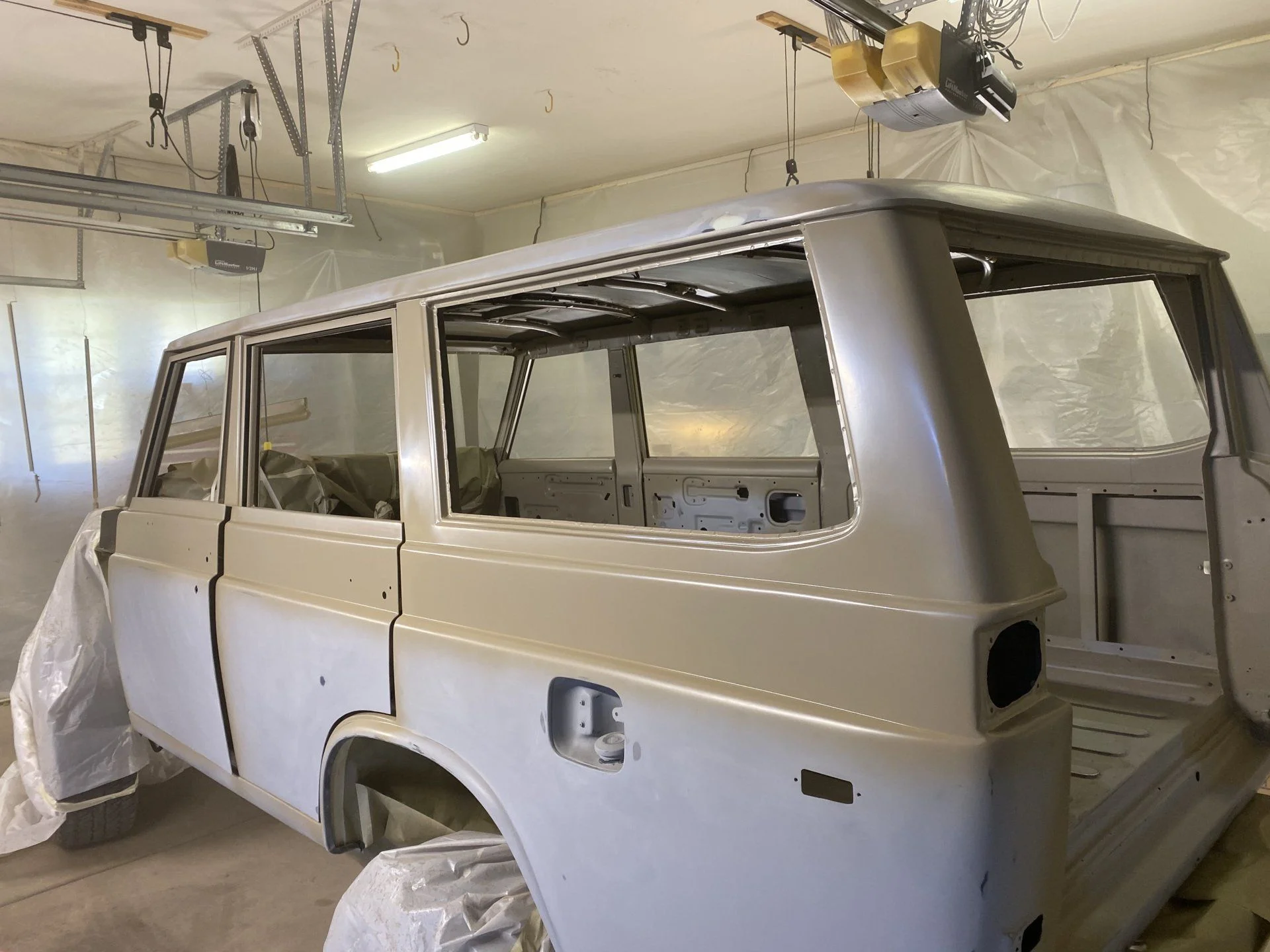

Having just completed painting, I agree with JMack. I sprayed what would be white first. The stock paint looked like they painted white first including door jams. Then tape off white to paint the darker color. Taping in the door jams can be a pain, but you can get things covered for a great look. You're doing doors off so that will be easier.

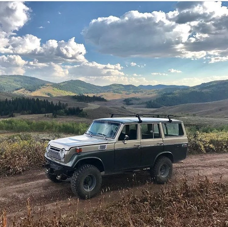

That's what i was thinking, but couldn't figure out why there was blue beneath all of the white area from factory. Sorry to disappoint you on painting over the green and gold @RUSH55. Back in 1991 my brother (16 yrs old) had a really nice Mustard '76 fj40 that he had painted. He chose a metallic green they were painting new jeeps at the time. Soon after he painted it I turned 16 and bought it from him because he bought an FJ45. We both thought the green was really cool at the time, but ever since wished he would have kept it mustard. He now has a 1976 Mustard 40 he is restoring.
I bought the 55 a few years back because it was one of the cleanest. rust free I had ever seen for sale - but it was that same metallic green, ha ha. Also, the body shop had filled the gutter with bondo and done some other dumb things. So while I'm fixing those issues, I decided to take it back to original. Blue and white honestly isn't my first choice, but it was the original and that's what mrs likes. So, since she puts up with my cruiser addiction i figured I'd run with it.

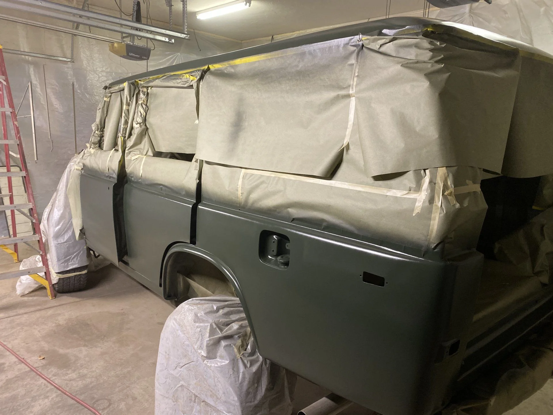

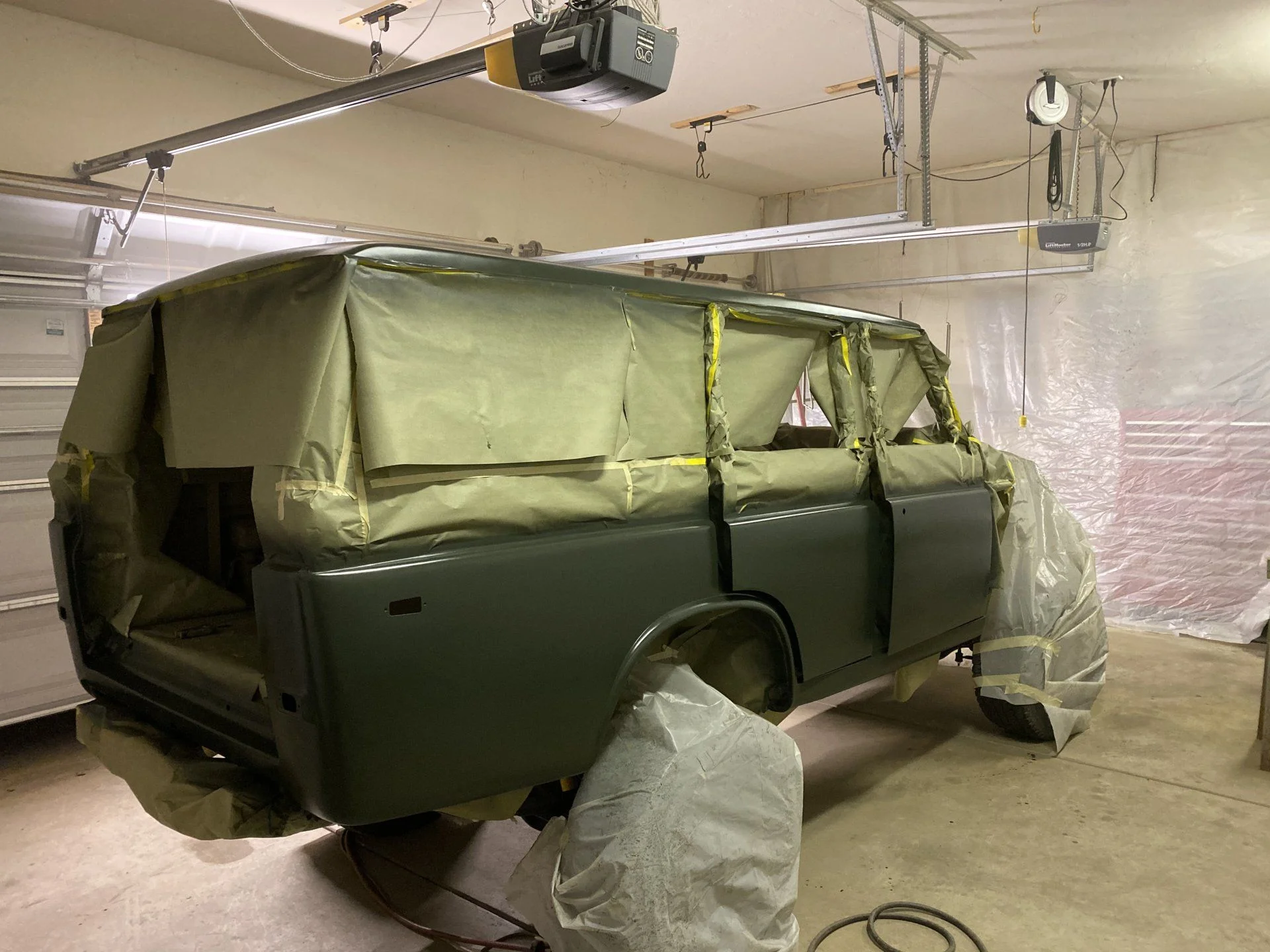

It's just a meticulous job of taping things off. By the time you're done and ready to spray you'll have taped off most of the interior of the door and part of the exterior. I also taped off the jams when I went to paint the darker color because I wanted clear and clean lines and not a bunch of over-spray. I still had some just because I got in a hurry to spray and didn't think about it.... and now I have do go back and touch things up.
yes, lots of taping! takes a long time to mask everything off.
@RUSH55 glad you got those. I'll take the same pics with the new paint when it's done then you'll have the two to reference, ha ha. Also, looks like @NikP painted his the colors mine used to be - just not metallic. looks great!

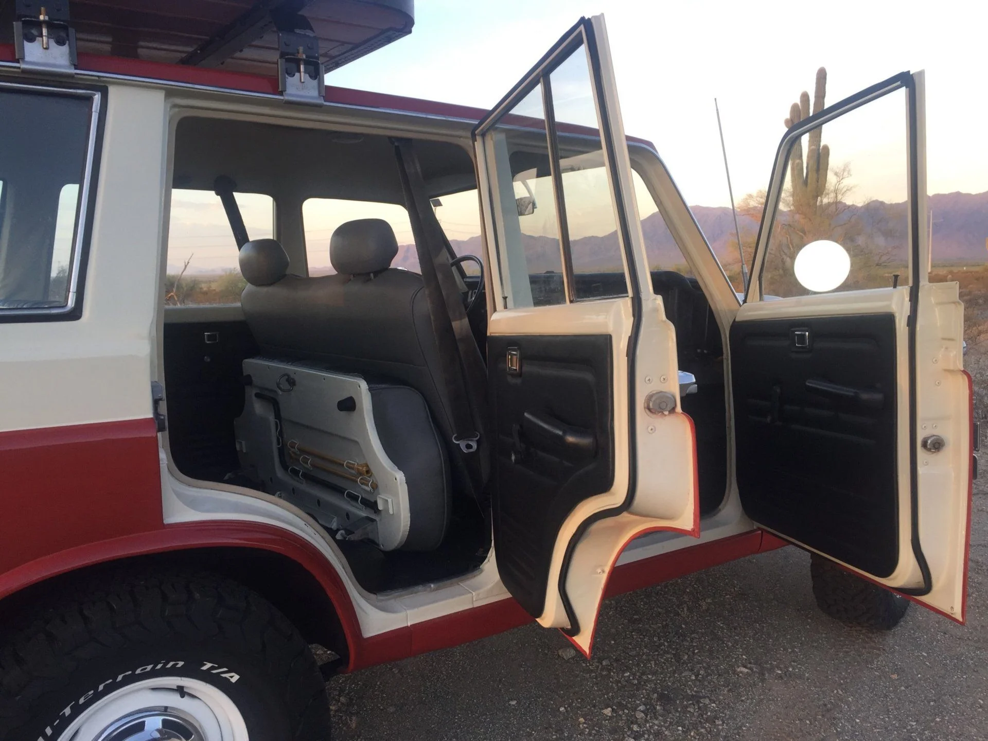

I've been looking at my pig as well as online photos of what are advertised as "original" paint pigs. They all show the white jambs between the doors and the body color with the doors closed. Of course you only see it straight on and it's a very thin, vertical line but it makes me wonder why they didn't split the paint on the jambs from the factory like the body. Interesting.
I mentally wrestled with that same issue. I don't like seeing a white jamb in the middle of my dark body panel. I thought about paint the jamb two-toned as well. As I was taping, it was just easier to do what the factor did and live with the "see through" area.

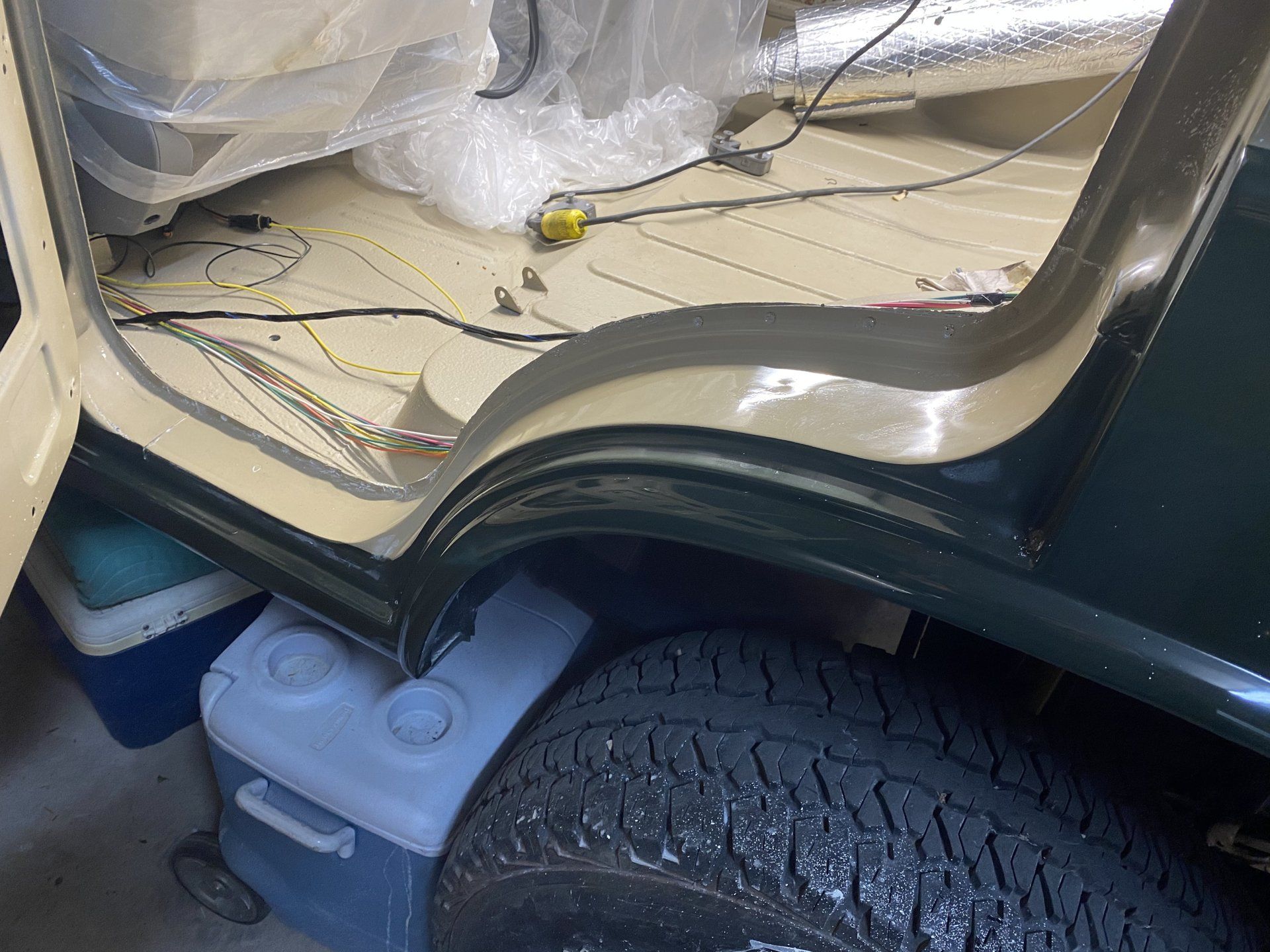

I think they looked like this:
Here's what I did to avoid seeing the white (or lighter color) from the side view. I followed inner Panel line.
