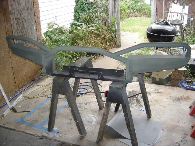

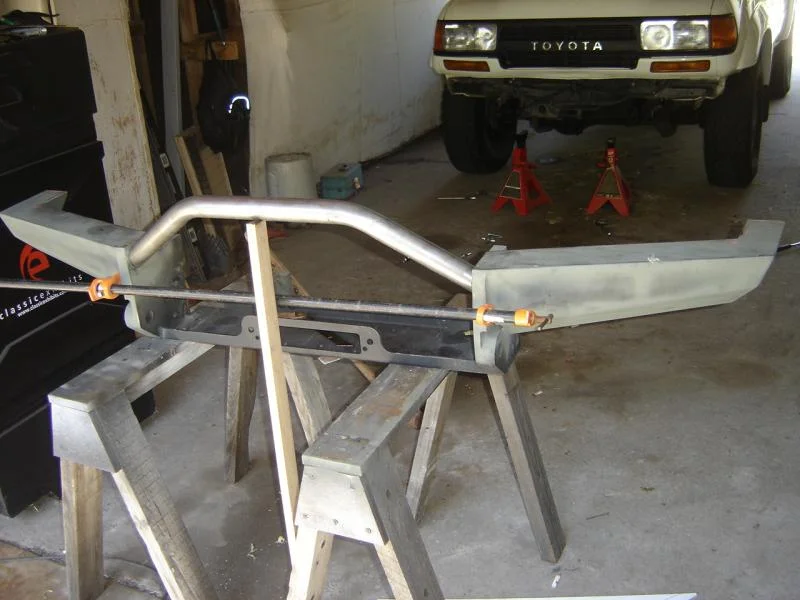

Well, the tubing isn't on the bumper yet.
I'm building a Slee Short Bus knock-off.
All the flat metal is done, and I cut the
center bent section to fit, but my local
welder decided to knock off early today.
I have to have it at least tacked in place
in order to cut the side bends and cope ends.
The clamp and stick are there to keep the center tube
in place.

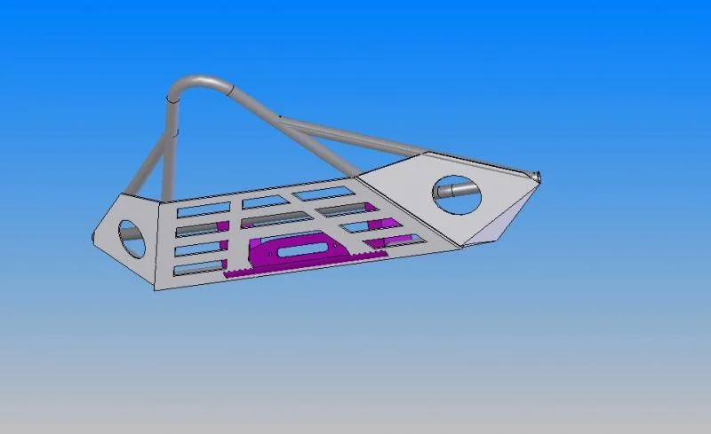

That is a great looking bumper.
What will the final savings be vs. buying from Slee?
in place.
JJ
Looks really good! I'd leave the stick, call it a trowell bumper...
I've probably got 250.00 in materials and 150.00 in welding, and,
of course, I work for free, so about a 600.00 savings.
I used the HF "Universal" winch mount to leave my options open
for whatever winch I can find. If I need to, I can build a little higher platforn on it to accomodate a larger winch.
Where the mounting holes are now, the tranny cooler is my limiting factor for winch height.
JJ

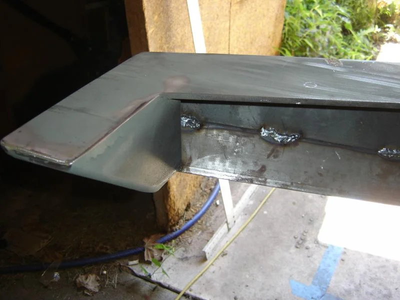

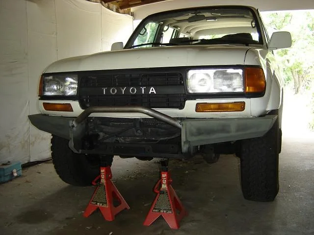

Center tube tacked on...
Jack stands come in pretty handy getting this thing on and off.
I gotta say, I SUCK at tube notching. But I made a jig that keeps
the outer tubes at the proper level, so everything is going to
even out. Decided 45 degrees looks pretty good for the center tube
leaning out, and 38 degrees for the side tubes.

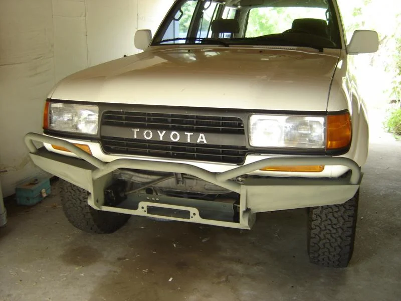

Getting everything welded together after work today. Shouldn't be
much grinding involved before priming.
Waiting for the primer to dry...
Can hardly wait to get it on the truck.
And the money shots...

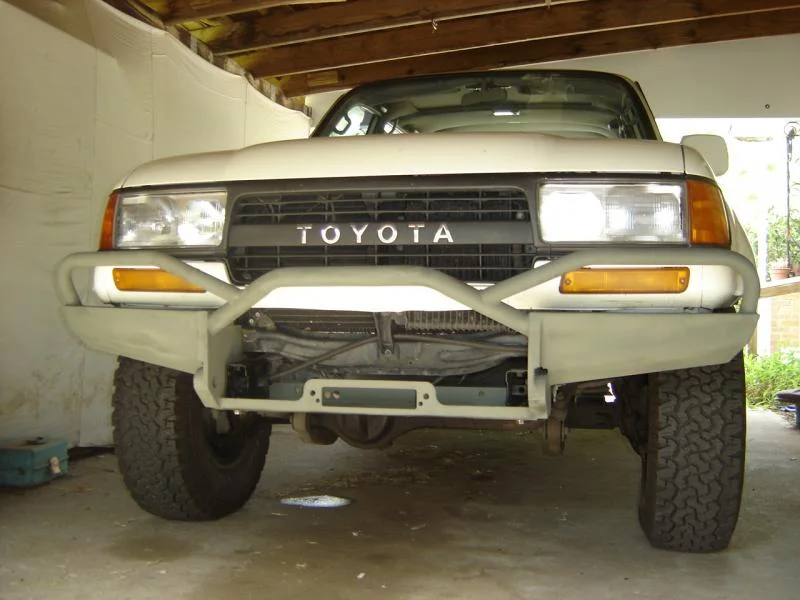

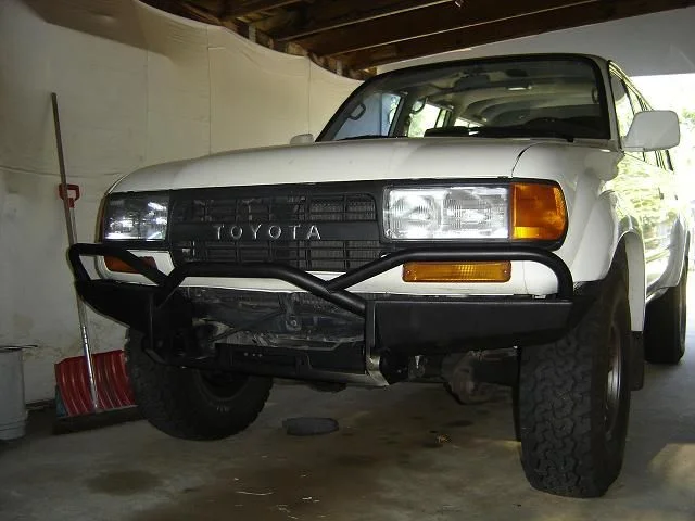

I'm pretty happy with the finished product. If I had to do it over,
I'd make the side tubes straight horizontally for about 4-5 more
inches to make the "parking lamps a little more visible. I switched
the sockets around a long time ago, so my side markers are my
turn signals.
looks good - I even like the color!
It'll look even better when you fill that big blank space.... my space has been blank for years
After a couple of coats of Rustoleum rattle can truck bed liner...
Yeah, I kinda liked the color of the primer, too. Had just a touch of green to it.
I think the black makes the "blank spot" less
noticeable. I stripped two of the bottom mounting bolts over the
course of mounting/remounting 7 or 8 times.
