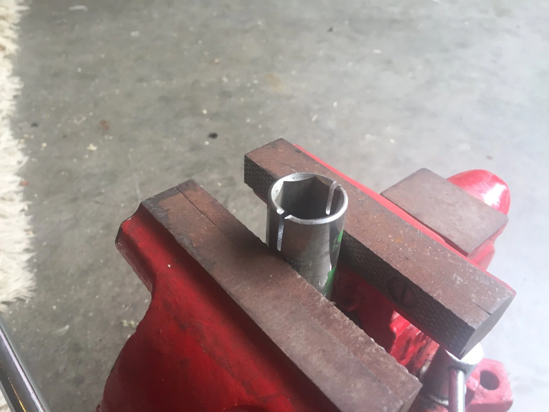

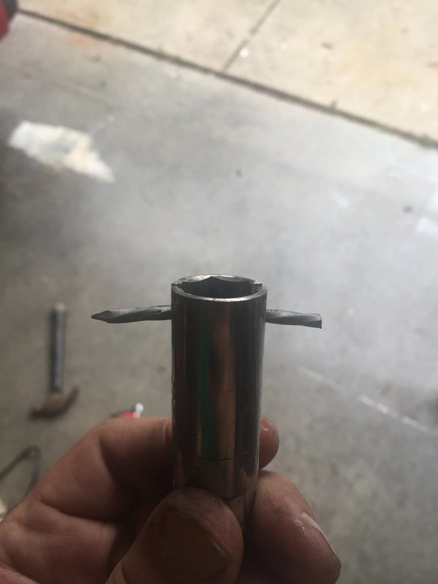

Anyone guess why I took a crap old 5/8 socket to a grinding wheel and stuck a nail in the resulting slot?
Tire carrier winch SST ?
We have a winner.
And it worked too.
