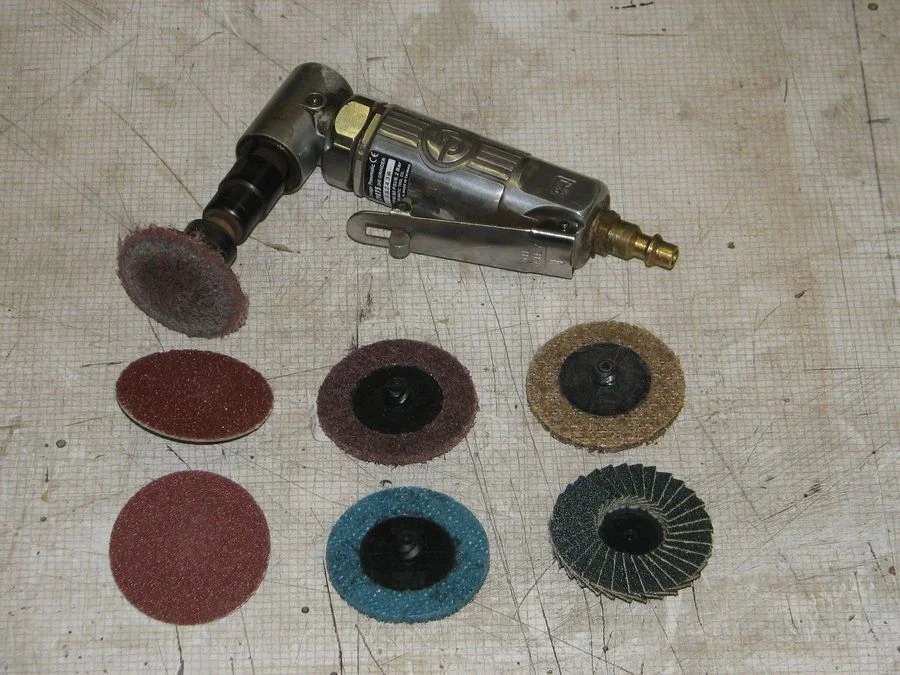

This is about the sweetest thing there is when it comes to welding prep. Tons of choices for abrasives to use depending on the job.
I'd love to have air set up - I need to do that next for the garage. I may have to get brand recommendations when I do that.
