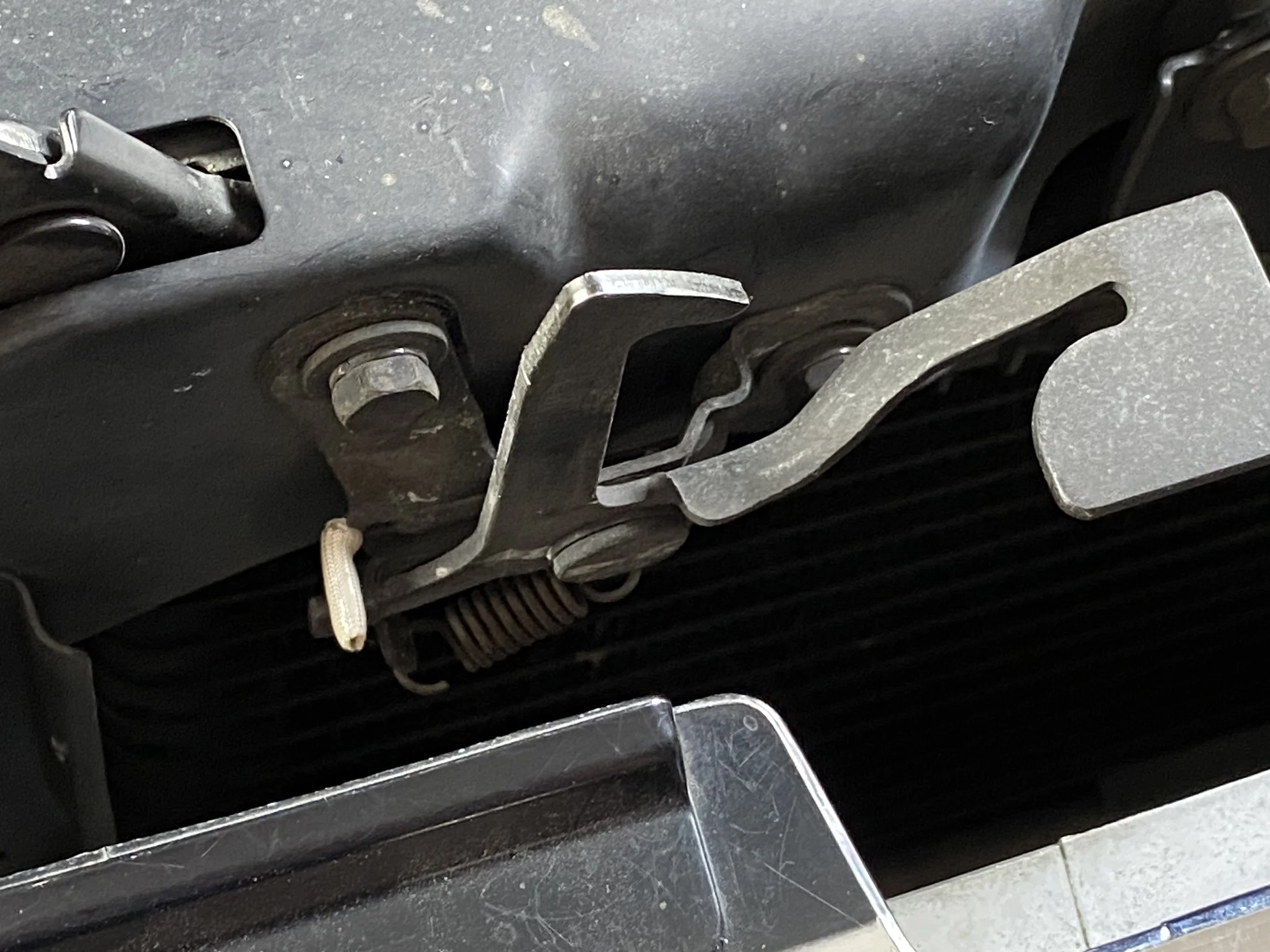

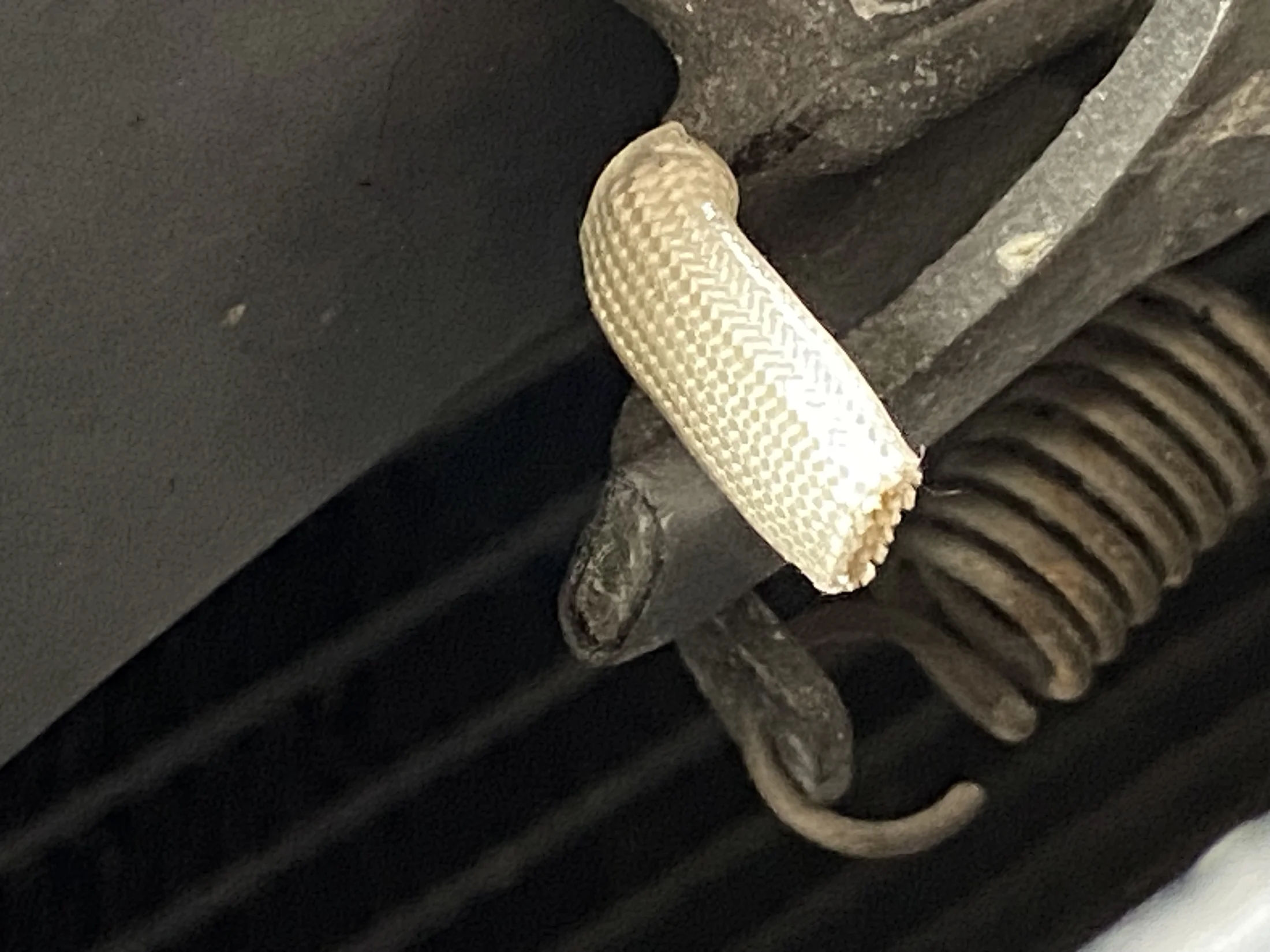

Solved.
It was the hood latch safety. The “heel” of the latch was rubbing back and forth against its stop, like a tiny violin.
I put a little length of shrink tube on both parts that touch, sound gone.
I guess hood was moving up and down just a little, causing this safety to move around too. Tightened up the rubber hood stops as well.
Solved.
