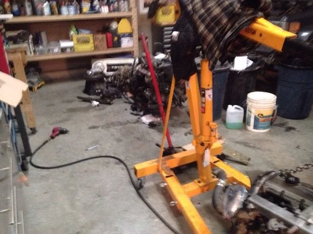

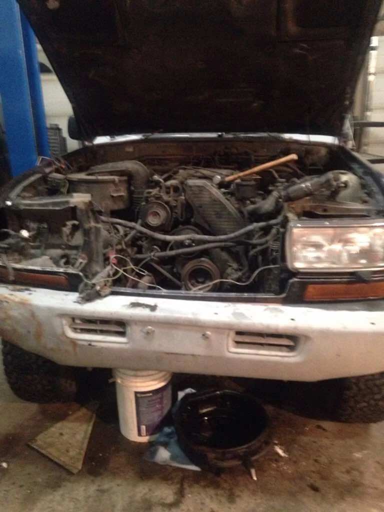

Lots of work done today. Pulled 80
Engine.
Pulled troopy engine and driveline.
Tore down t case
Removed trans and black box
Removed engine.
Removed turbo and other stuff.

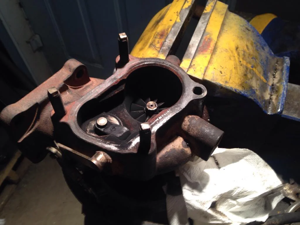

Then on my g turbo disaster struck. Broken or cross threaded exhaust stud.... We went to work extracting it and got it out scot free
Paul came and helped out today. He was a life saver in typical Paul fashion Particularly when I tried
To crush him with the trans and t case assembly.

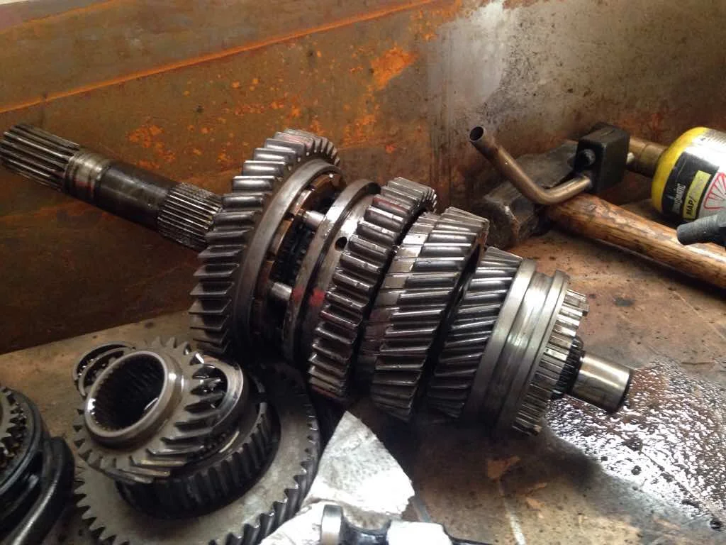

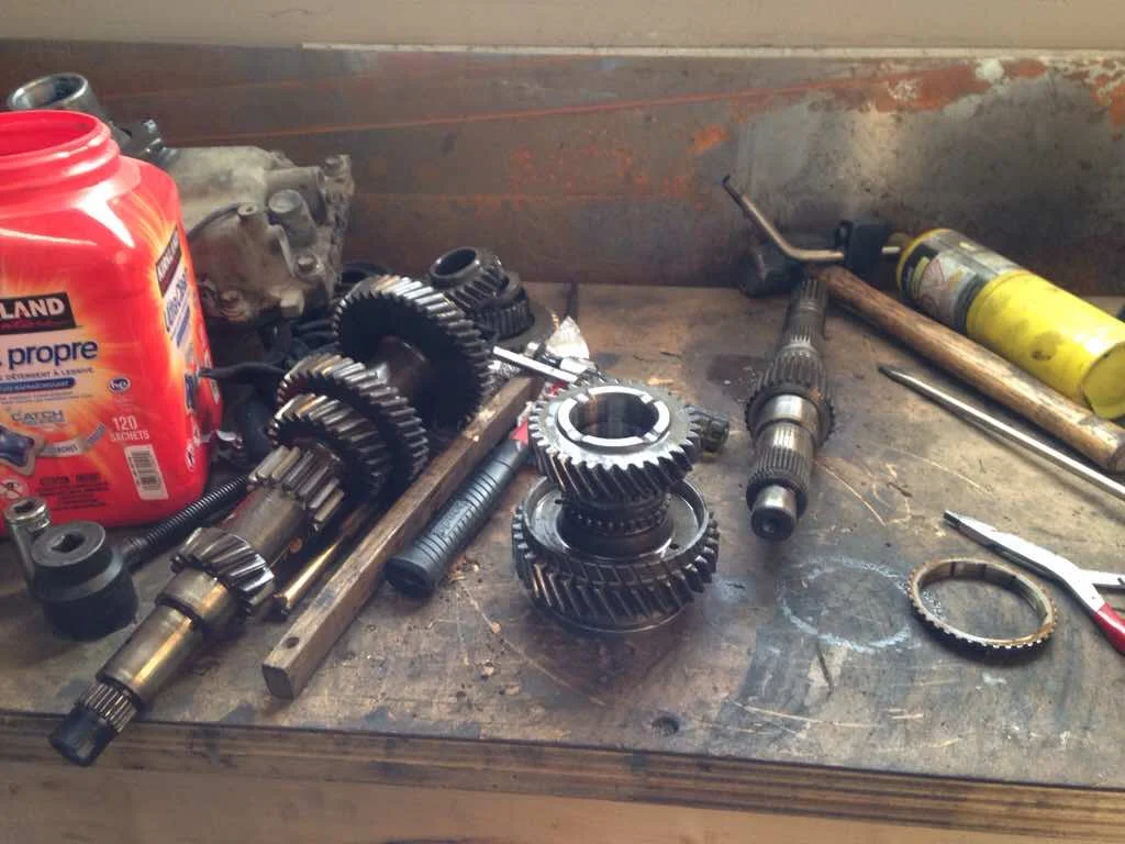

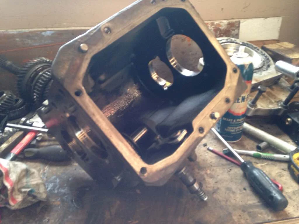

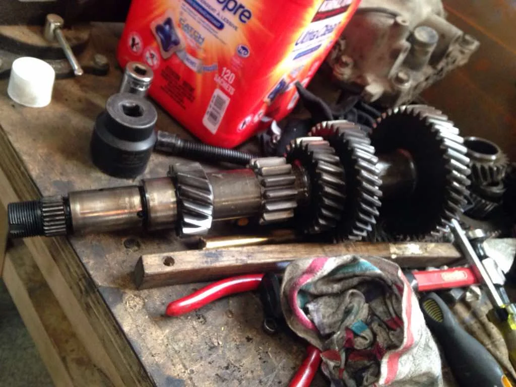

Well lots more tackles today. Tore the transmission down and most everything looks really good upon first inspection. Measured thrust clearance and they were all in spec on all gears. Started measuring a few other things though and closer inspection may have found my culprit of bad second gear shifts.
The 1-2 synchro assembly rides on a spline on the main shaft. This spline has some slop in it. Upon close inspection of the assembly female splines you could see some wear to the point a ridge had formed to one end. I suspect this allowed the assembly to either misalign or mis center when trying to shift.
I also found a worn 3rd gear bushing. Most of the synchro a looked really good but ordered all new anyway. It was an expensive bill for parts but I should have every last thing I need and a bunch of good spares.

The transmission again takes some special tooling and can be a bear. I had one bearing I had to weld my
Puller to but the rest came out really easily. That main shaft center bearing is a sticky one though. Same one I had trouble with on frenchy one transmission.
This is the 4th trans I've torn into in the past 18 months. Starting to learn the tricks.

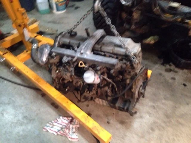

Also went after the 1hdt.
Stripped harness
Pulled transmission and converter
Pulled a few other odds and sods.
More progress tonight
Moved turbo to hdt
Moved alternator to hdt
Removed acsd and blocked off
Transferred oil pressure sensor and temp sensor
Tomorrow is flywheel and clutch and bell housing. I'll hold off on timing belt as it was done 60k ago. Beb will be easier once the engine is mounted again. Hopefully this weekend
