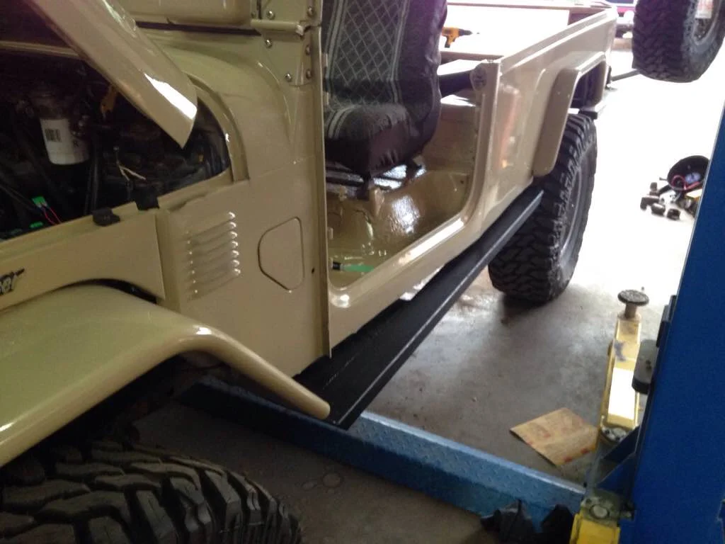

I sealed the other hard top side

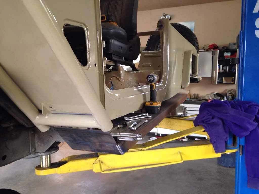

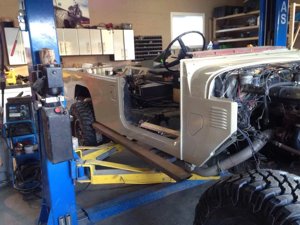

Then moved to sliders
These are only tacked into place until I see how they line up with fenders and flares.

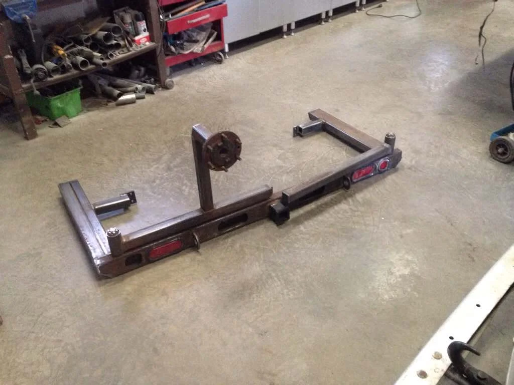

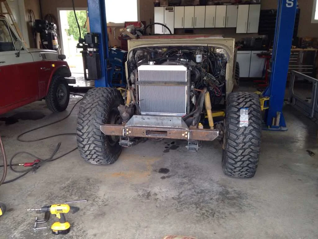

Rear bumper is finished and ready to prime
Front bumper is done and ready to prime

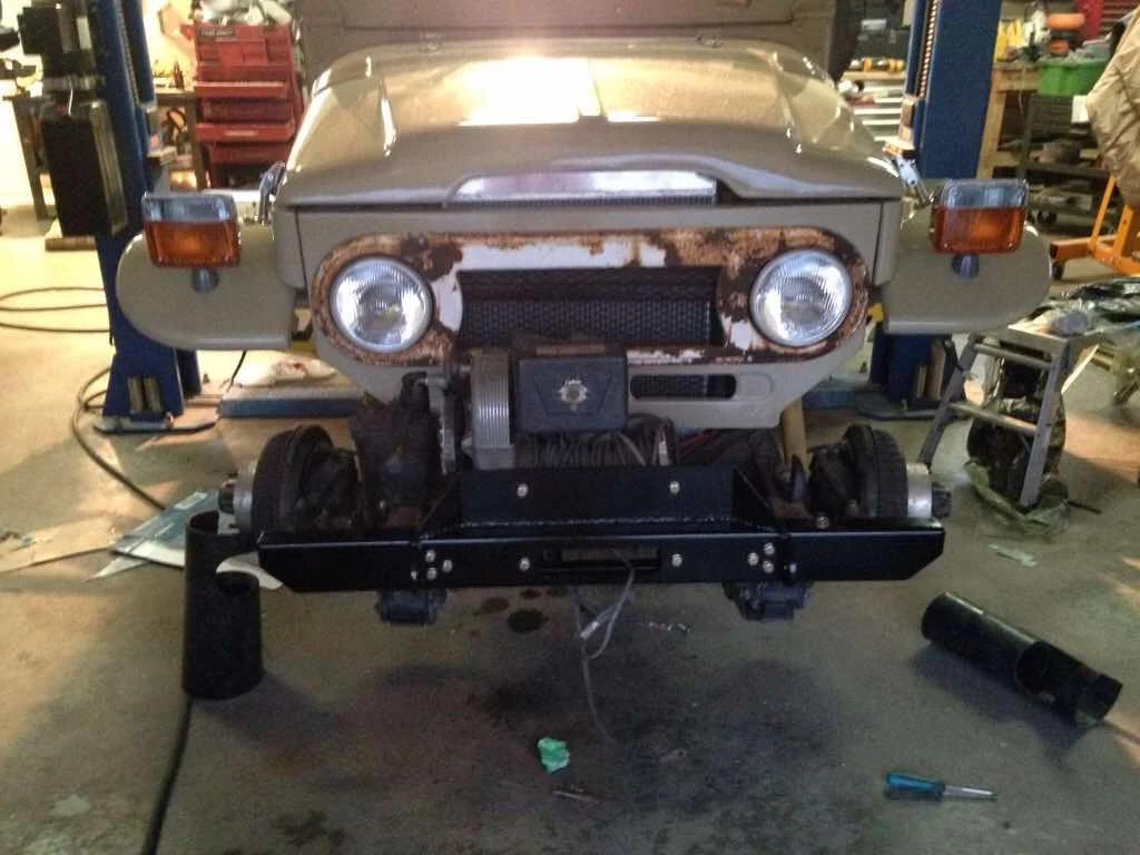

Front bumper. Ready for a winch!

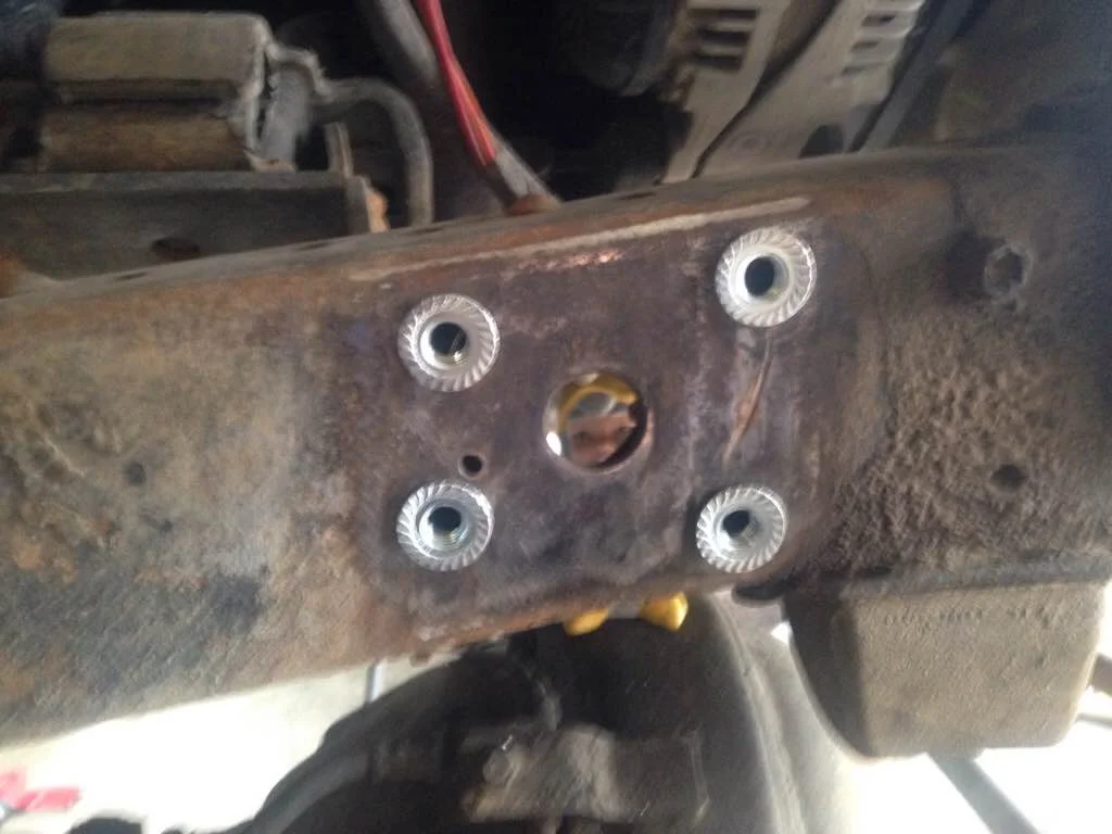

Fender nuts welded into place. The old ones were stripped out.

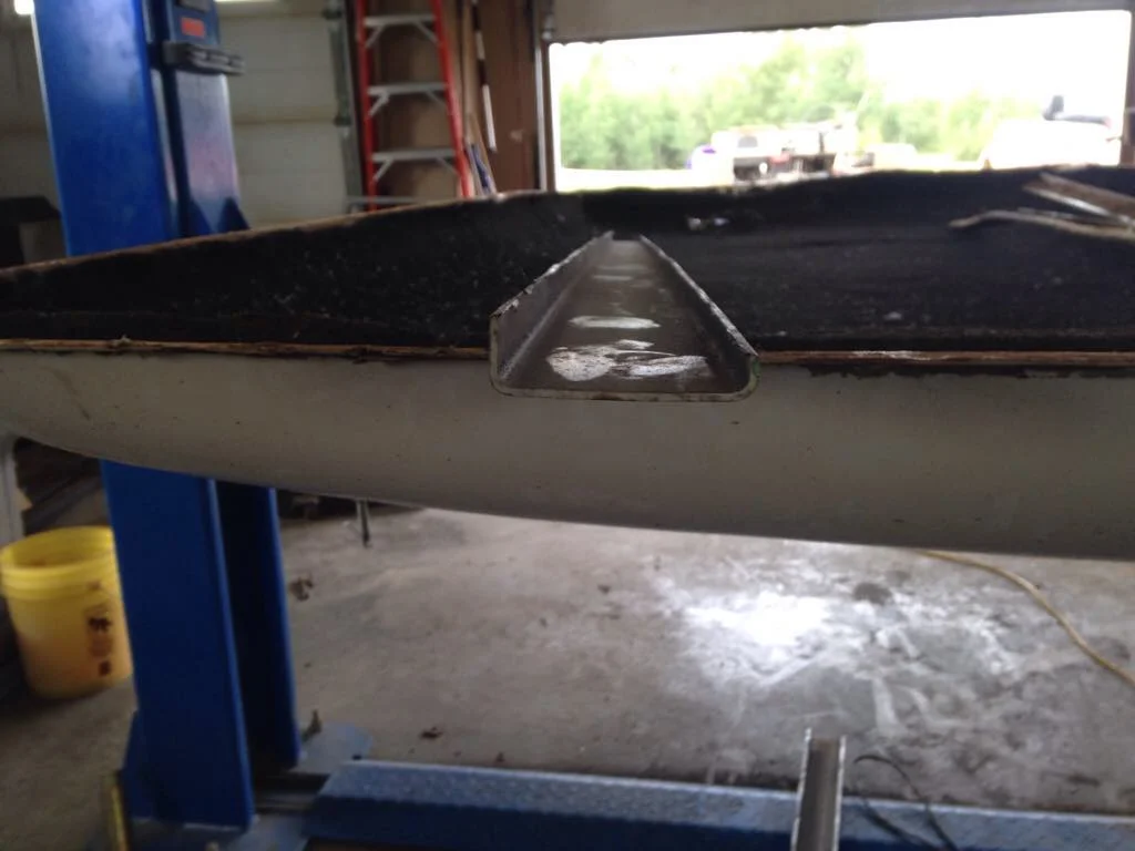

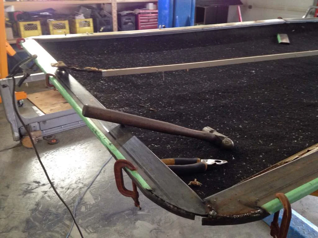

Profile of the drip rail
All new drip rails. Still needing finishing before ready for primer

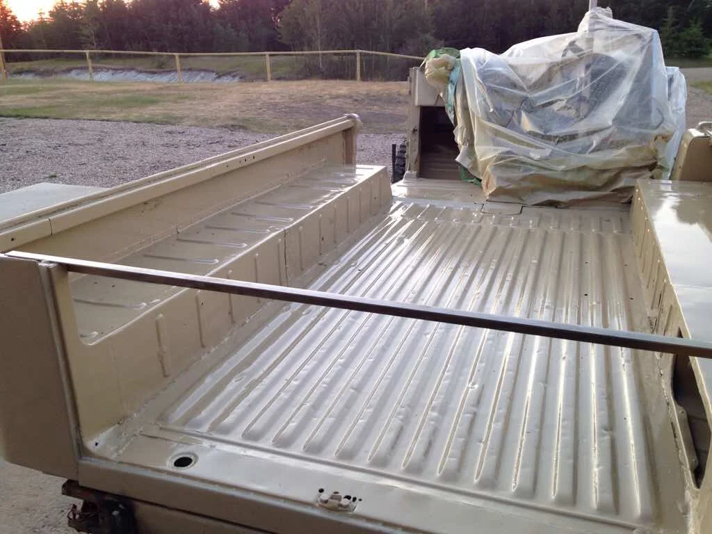

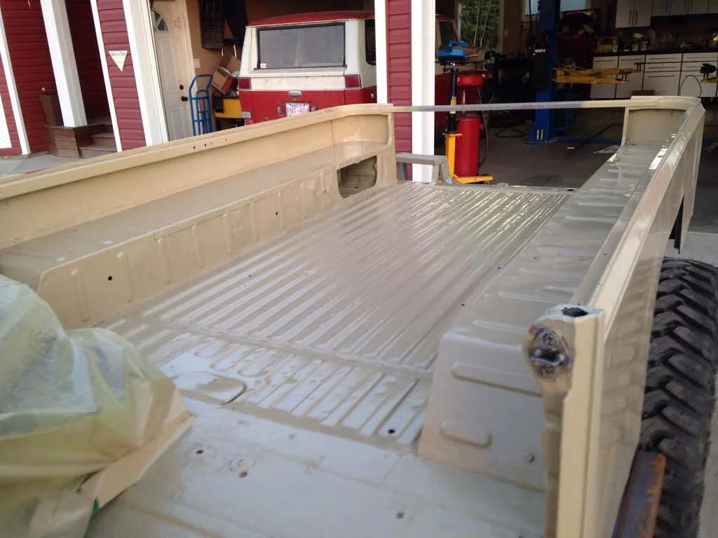

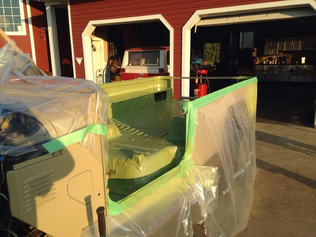

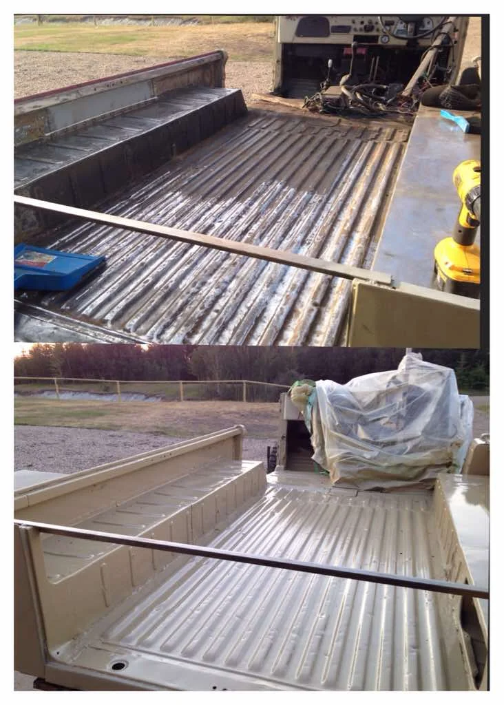

Speaking of primer I did my interior today in endura
Likely need one more quart to do the bumpers and rain gutter.
Not an exact match but close. Looks much much better anyhow!

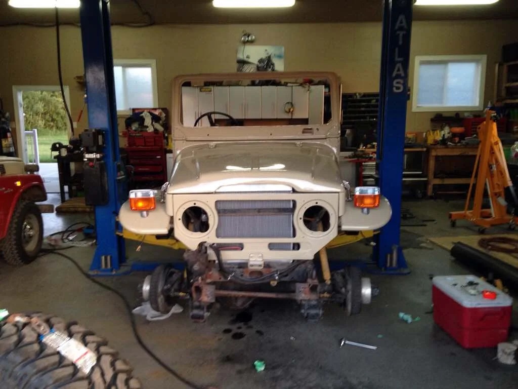

Well I've still been tinkering

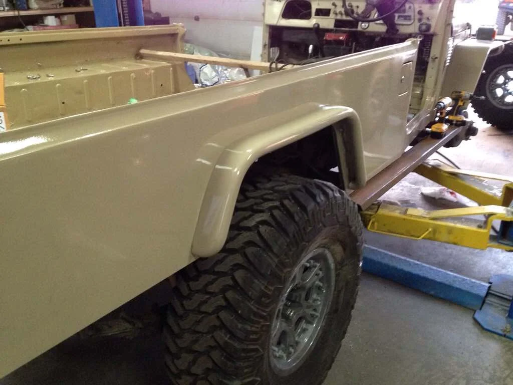

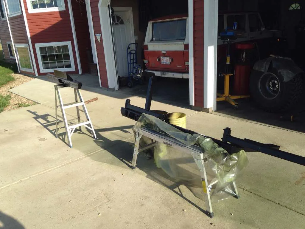

Bumpers painted
Rear flares
Might still paint the bezel

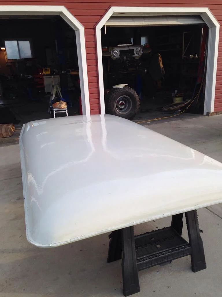

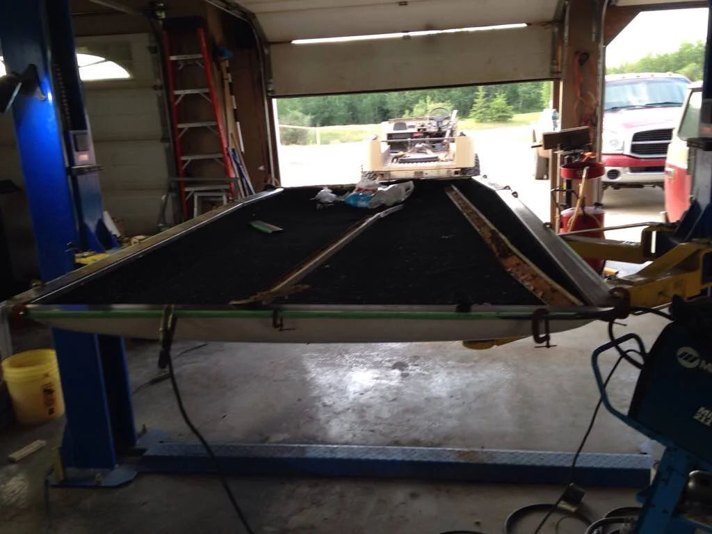

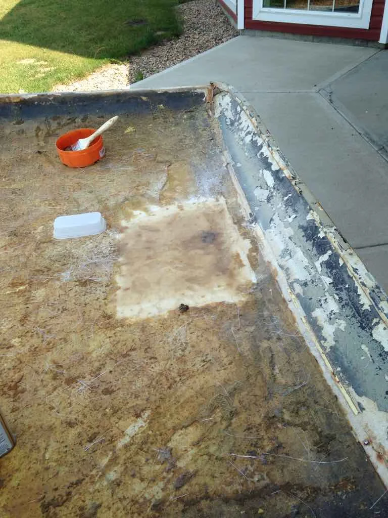

Roof repair
First coat on roof

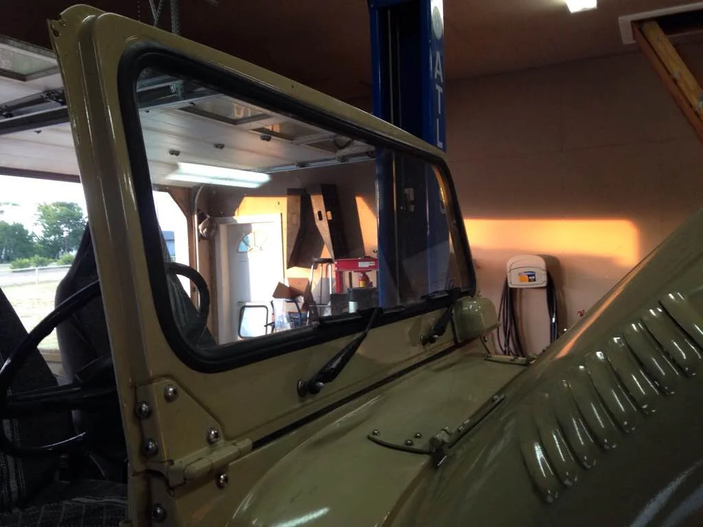

Re wiper park position... a quick search didn't find as much as I expected.
This thread seems to deal more with random park position: https://forum.ih8mud.com/threads/window-wiper-park-position.50987/
Another one: https://forum.ih8mud.com/threads/how-to-adjust-wiper-position.197719/
If they are stopping in a consistent position, can you remove the gear that drives the mechanism from the motor while the motor is in the park position and then move the wipers to the proper park position and reassemble? Don't simply remove and reinstall the arm(s), or you may be wiping your hood and scratching the fresh paint.
You have to clock the starting point on the wiper motor. That's how I broke mine as well. Too late, but the best way is to pay attention on disassembly
Got that sorted.

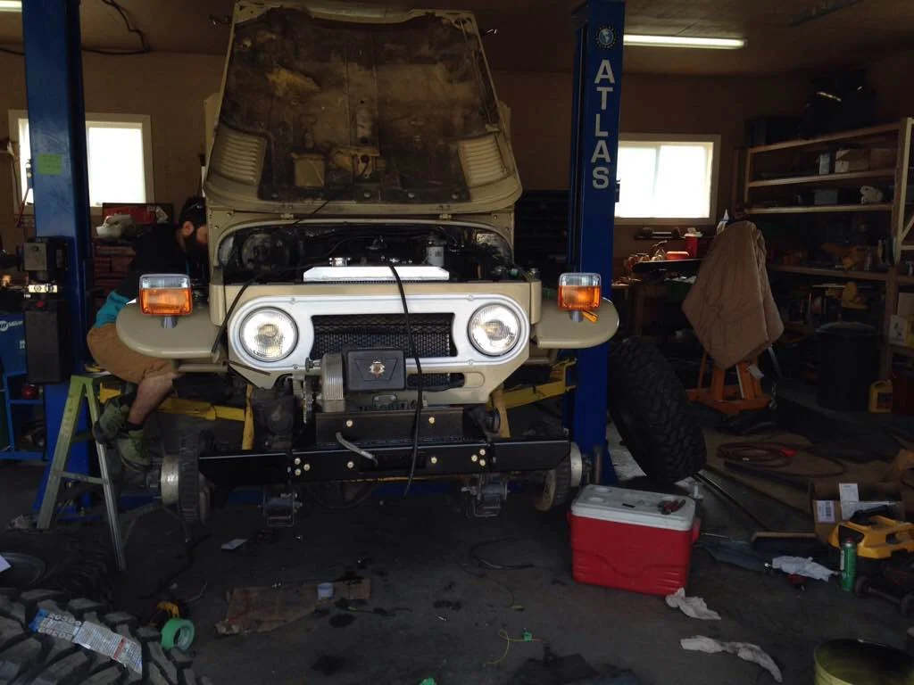

Slider painted

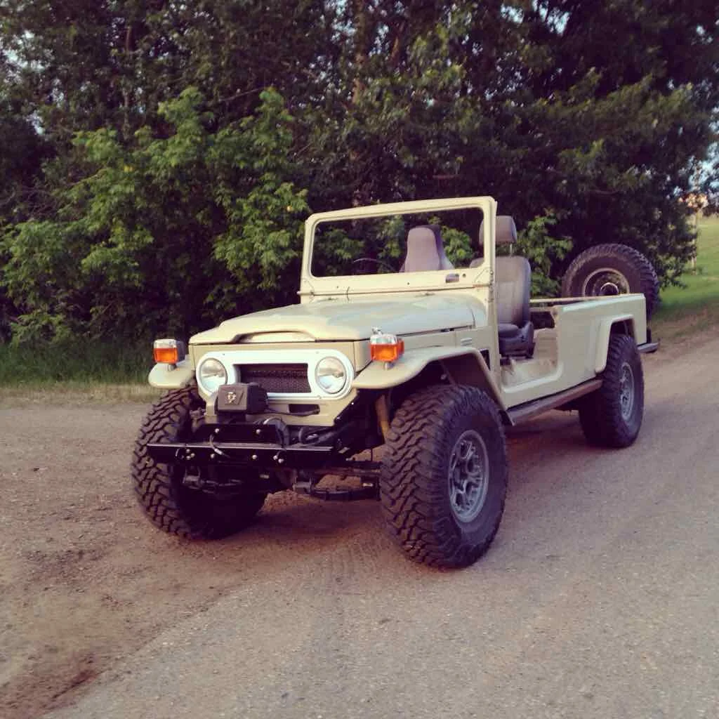

Lights lighting
